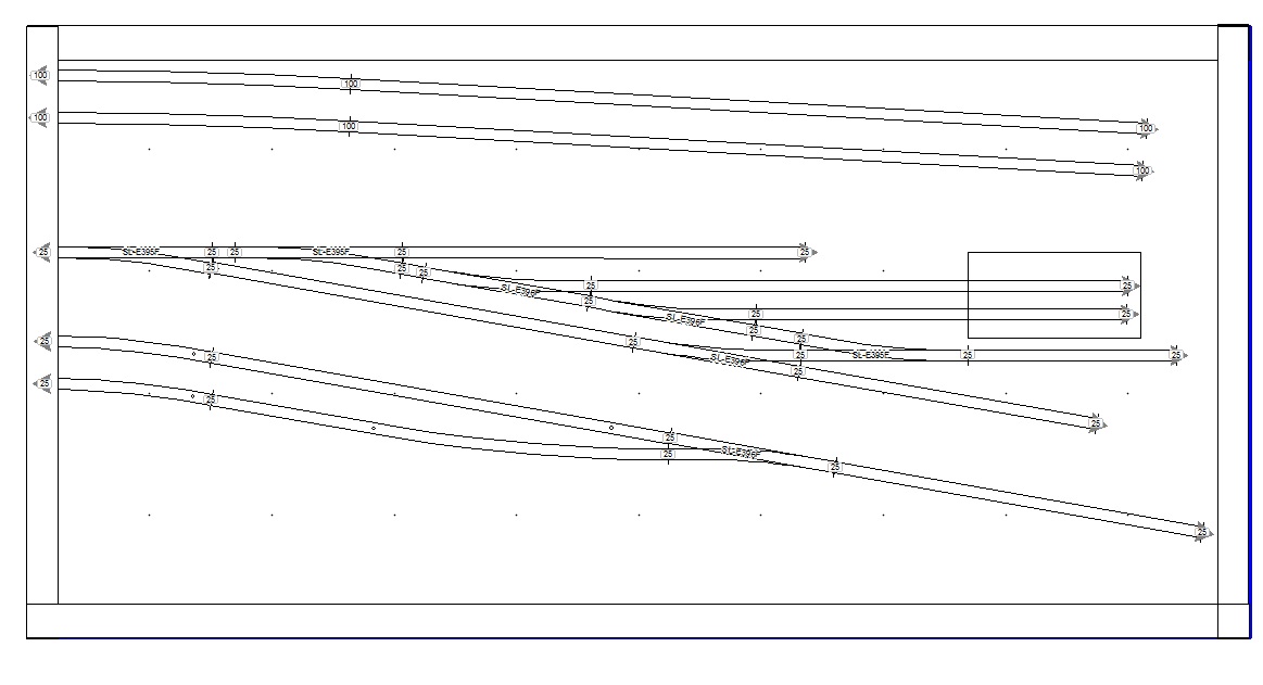

The layout of this, the scenic side of the plan, is actually three layouts in one. It represents the operating concept of my design, with each of the three sectors (working back of the layout to the front as viewed by the exhibition attendee) having a different way of working:
1) The two parallel (though not to the board edge) tracks at the back will terminate in a small station which will be raised above the rest of the track. This is to both add height to the layout and allow my controller / switch panel to fit underneath. DMUs will be the mainstay of this station (NSE themed of course!) and eventually I hope to have at least one track operating as a shuttle, this layout being designed to be operated by me alone.
2) The middle group of tracks will be the actual TMD. The building itself is to be the classic Peco trainshed (albeit modified) with 2x impection pits and as much internal detail as I can produce. Also incorporated will be a fuelling point, fuel tanks, run-round loop and plenty of hard-standing. Essentially this is to be what I wanted Filton TMD to be all along, had I actually planned it better!
3) The two tracks / single point at the front of the layout is supposed to represent the end of a much larger head-shunt  from an imaginary yard just "off stage" to the left. This will allow me to run small rakes which represent much longer trains which are only just poking out from under the scenic brake (currently planned to be a road bridge meeting the twin tracks at the back at 90 degrees, with a level crossing continuing the road over the station approach). I plan to operate this section using remote uncoupling, most likely Dapol easi-shunts, so the loco can bring its train from the left, de-couple, pull forward and then exit stage left to run-round its train.
With these three sections I hope to have enough operating potential to keep both myself and the viewing public entertained within the space of a layout which can fit inside my Ford Focus.

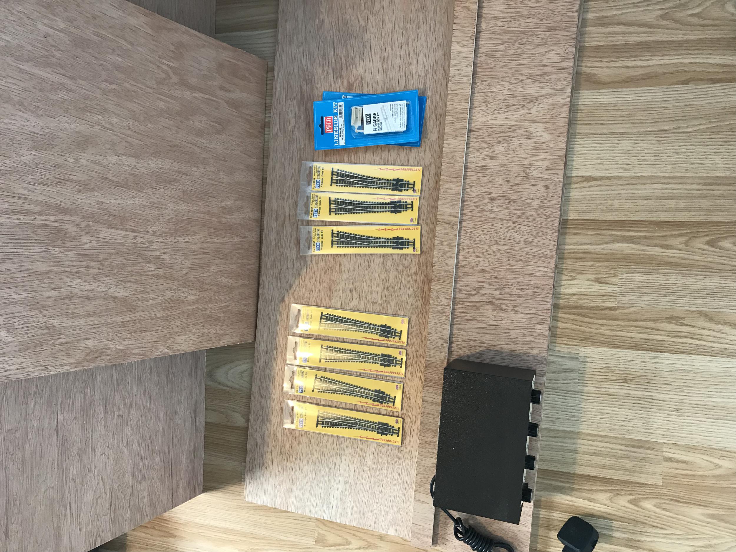

So, as of today (and a shopping trip), here is the state of play:
The proposed points layout of the TMD and head-shunt sections of the layout are shown (upper terminus station would be roughly above where my Gaugemaster DS controller is). The green wire is florist stuff, 60 pence so worth a shot.  It is also roughly positioned where it would run from the points to my control area. I have ordered some PTFE tubing from eBay and should start experimenting with that soon.
The blue 47 is positioned on the approximate location of the end of the depot run-round loop. The grey 47 is at the end of the yard run-round loop.
All being well I will start cutting baseboard battens tomorrow, as well as picking up some electrical components (this layout will be old-school DC). I have no idea when this will be exhibition ready, and have no intention in rushing.

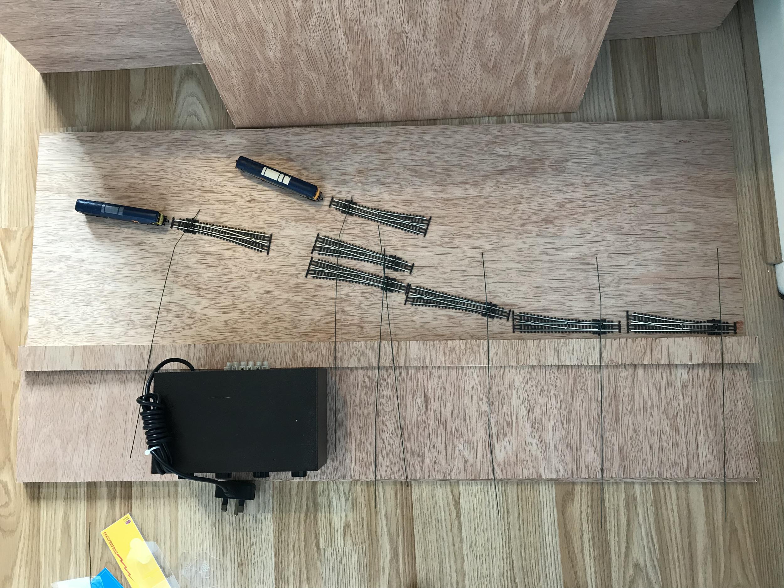

So a quick update on the fly, from the far better equipped workshop which I have borrowed for the day to start work on the layout proper.
First goal today was to manufacture the two pieces of batern which will form the joint between scenic and fiddle yards.
I have got some bullet alignment dowels for lateral and vertical alignment between the boards. Actual joining will be done by carriage bolts (with captive nuts).
As accuracy is very important for this, I have made use of a bench saw and pillar drill.
After much checking twice and cutting / drilling once, this is where I am as of this evening (plus the fiddle yard bracing and some extra supports cut after this was taken):
https://www.dropbox.com/s/rvrvfj2w21kc8z9/Photo%2029-03-2018%2C%2015%2035%2053.jpg?dl=0
Nothing is glued or screwed together yet and the scenic board is shown here up-side down with the controller shelf on the right and joint batern (with fiddle yard side test fitted) at the bottom.
