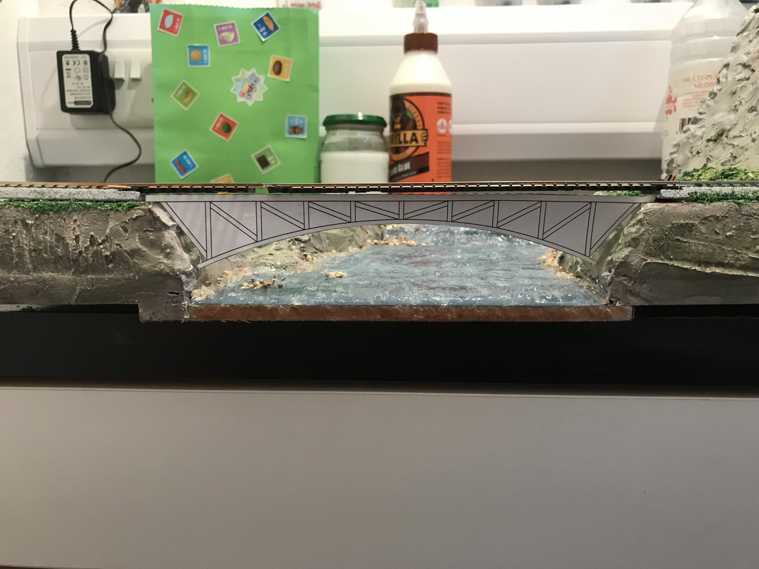

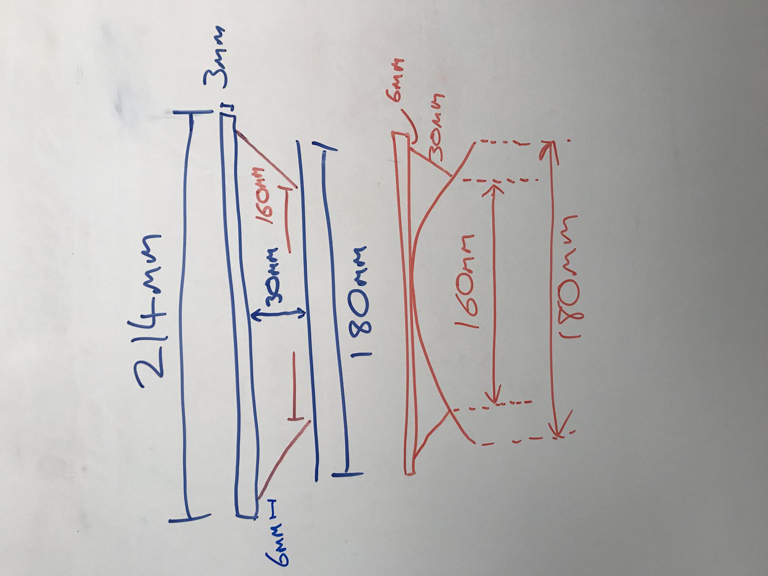

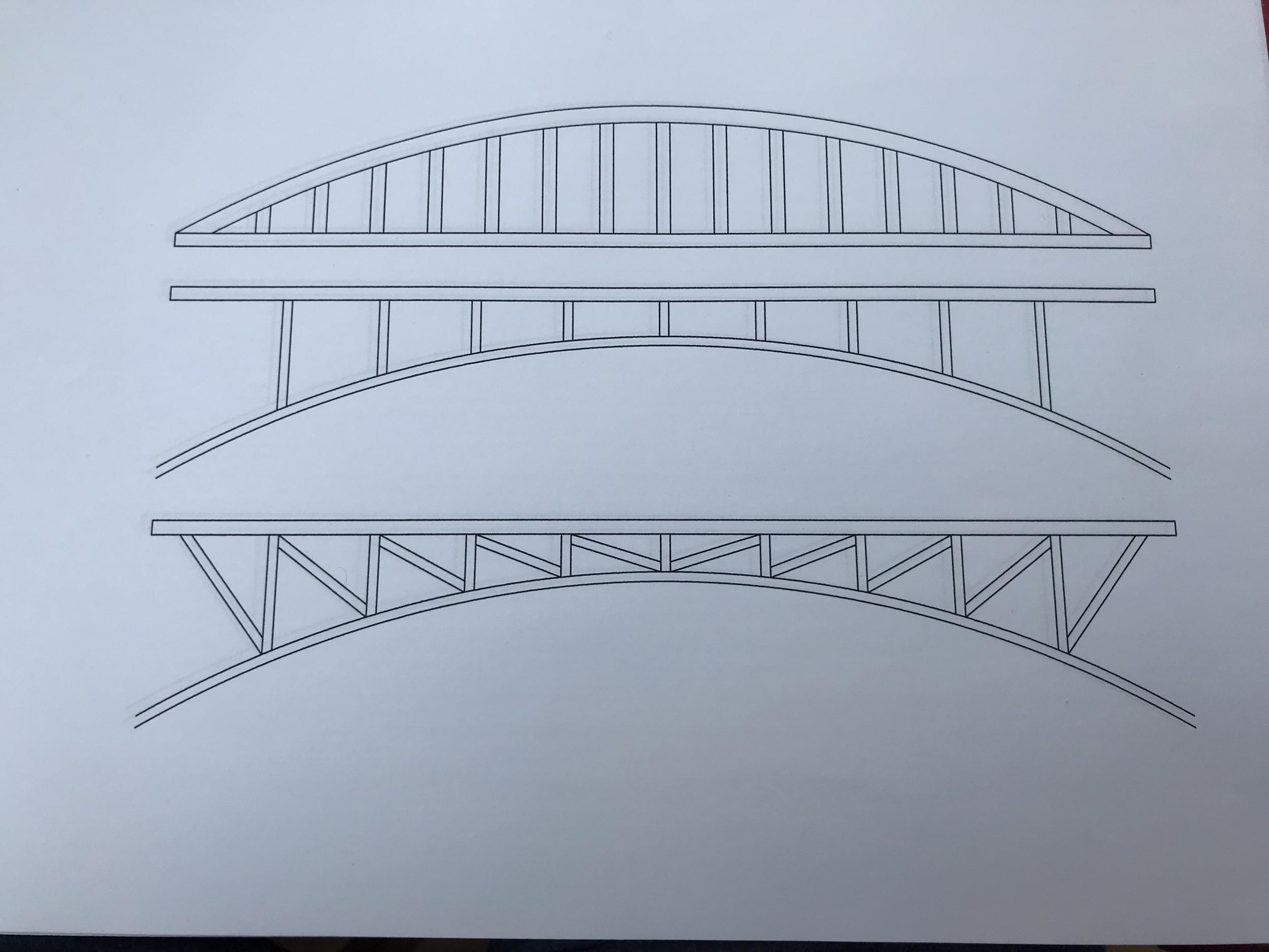

I've been itching to get started for a while but I've been waiting until everything else in the area is done. As it's being built completely from scratch I thought it would be easier to make the bridge fit the space rather than build the scenery around the bridge. So when I got to the point where I was ready I measured the critical dimensions;
I had an idea in my head of how I wanted it to look but it was never fully decided. I began by drawing 3 options in CAD and printing them out;

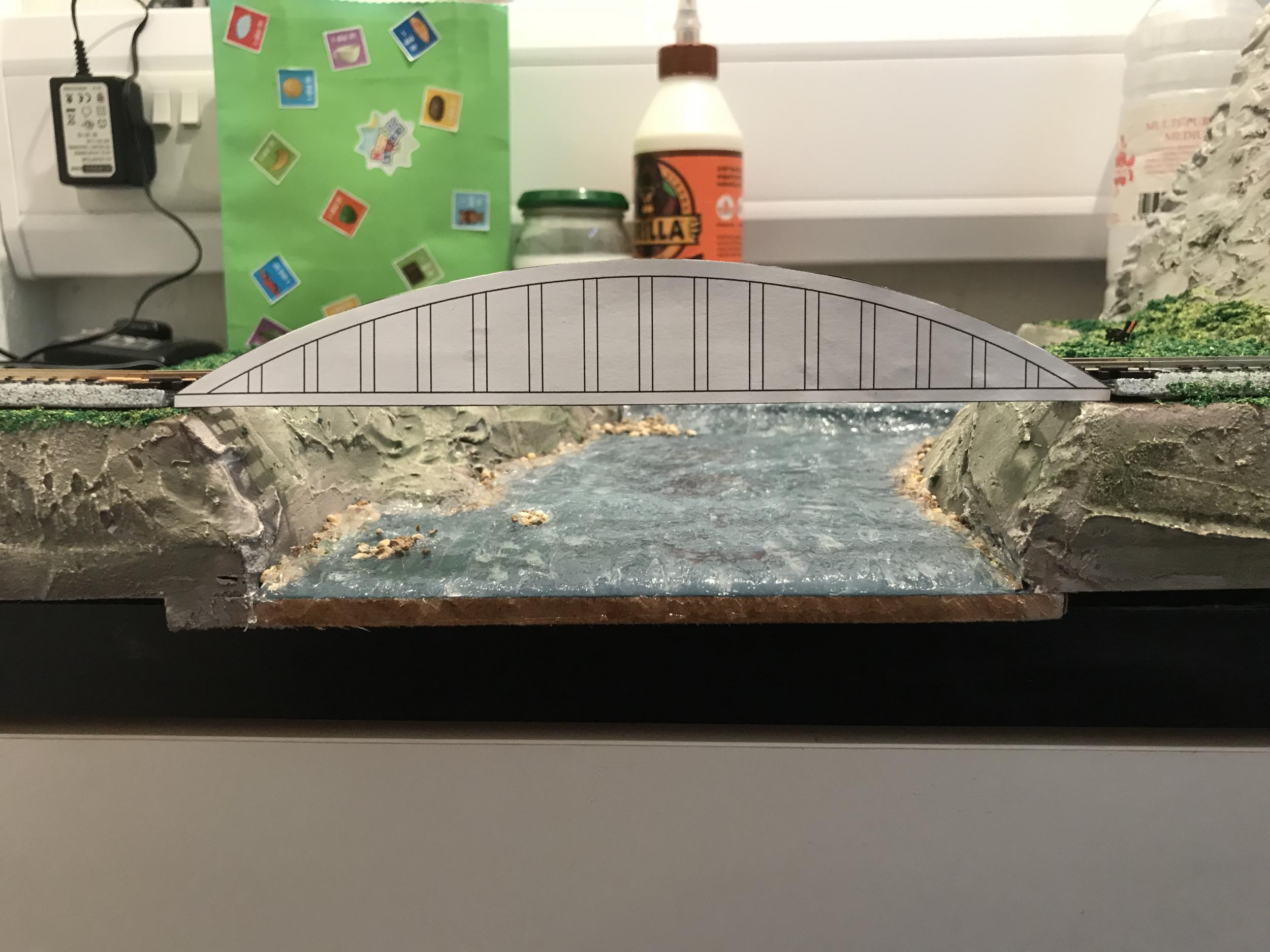

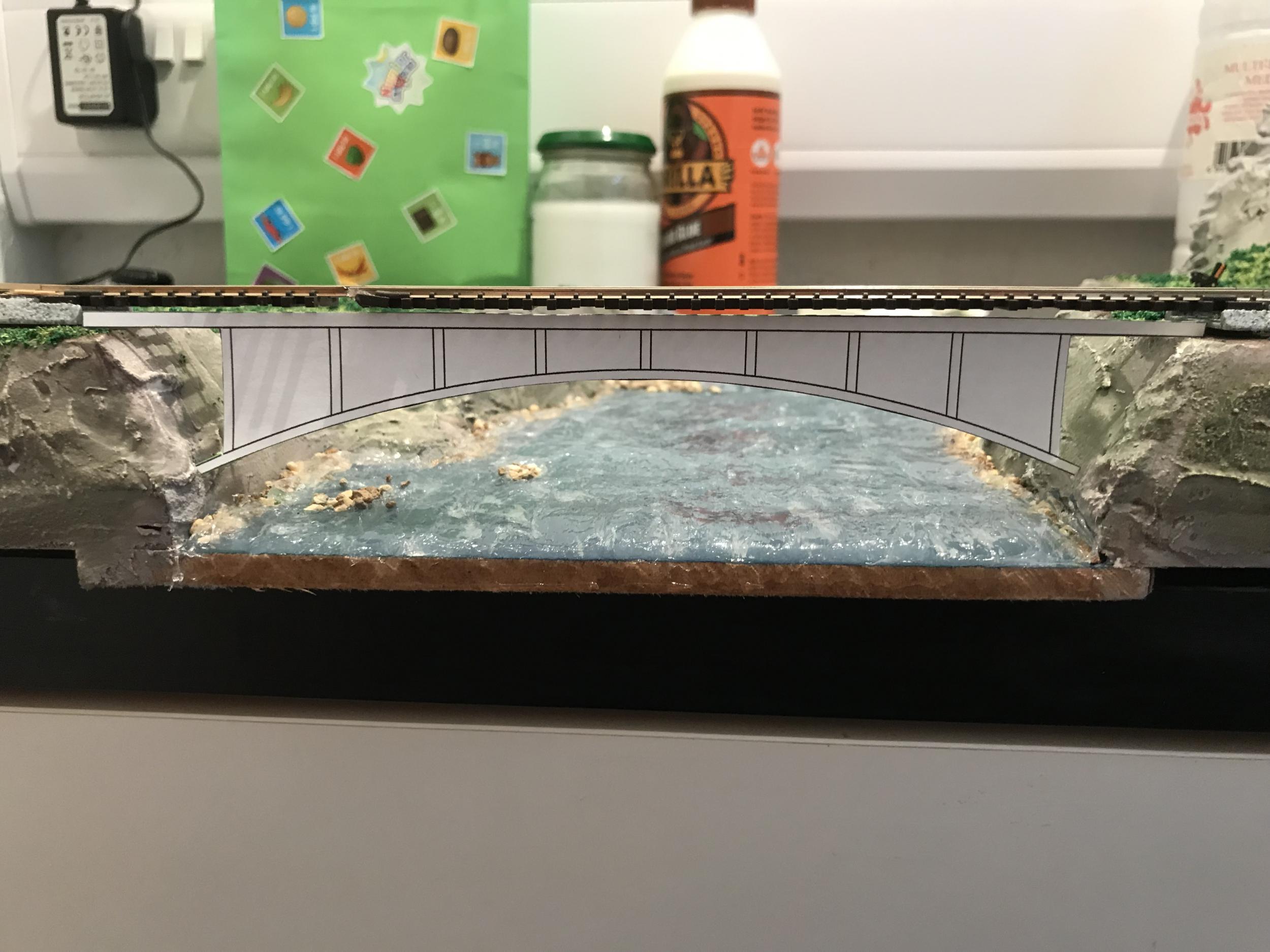

I cut out the outline of each and mounted them on card to see how they looked on the layout;
Option 1;
Option 2;
Option 3;
After seeing these in position I decided on option 1. Typically this was the fiddliest and most time consuming but it was the clear favorite for me.

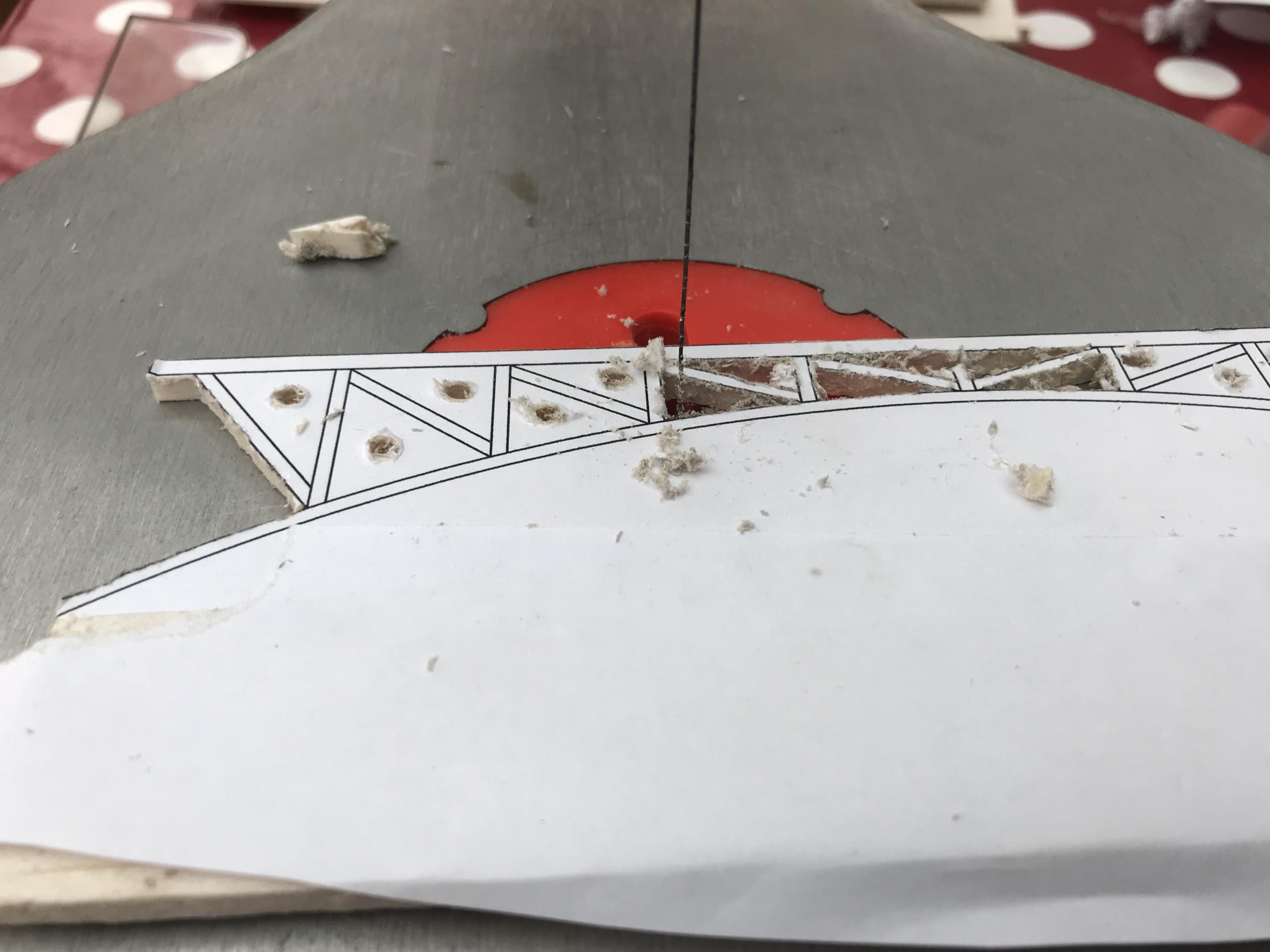

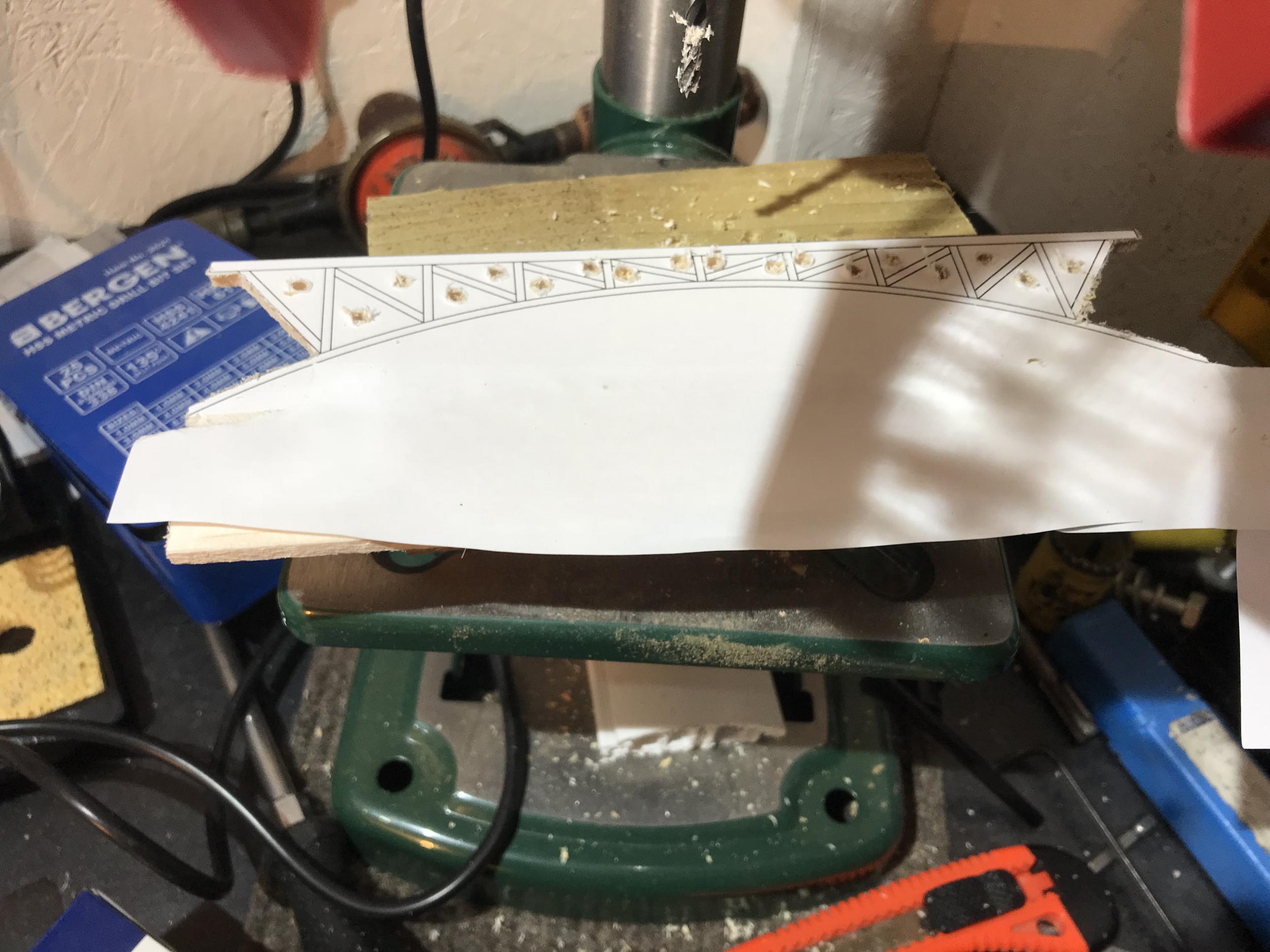

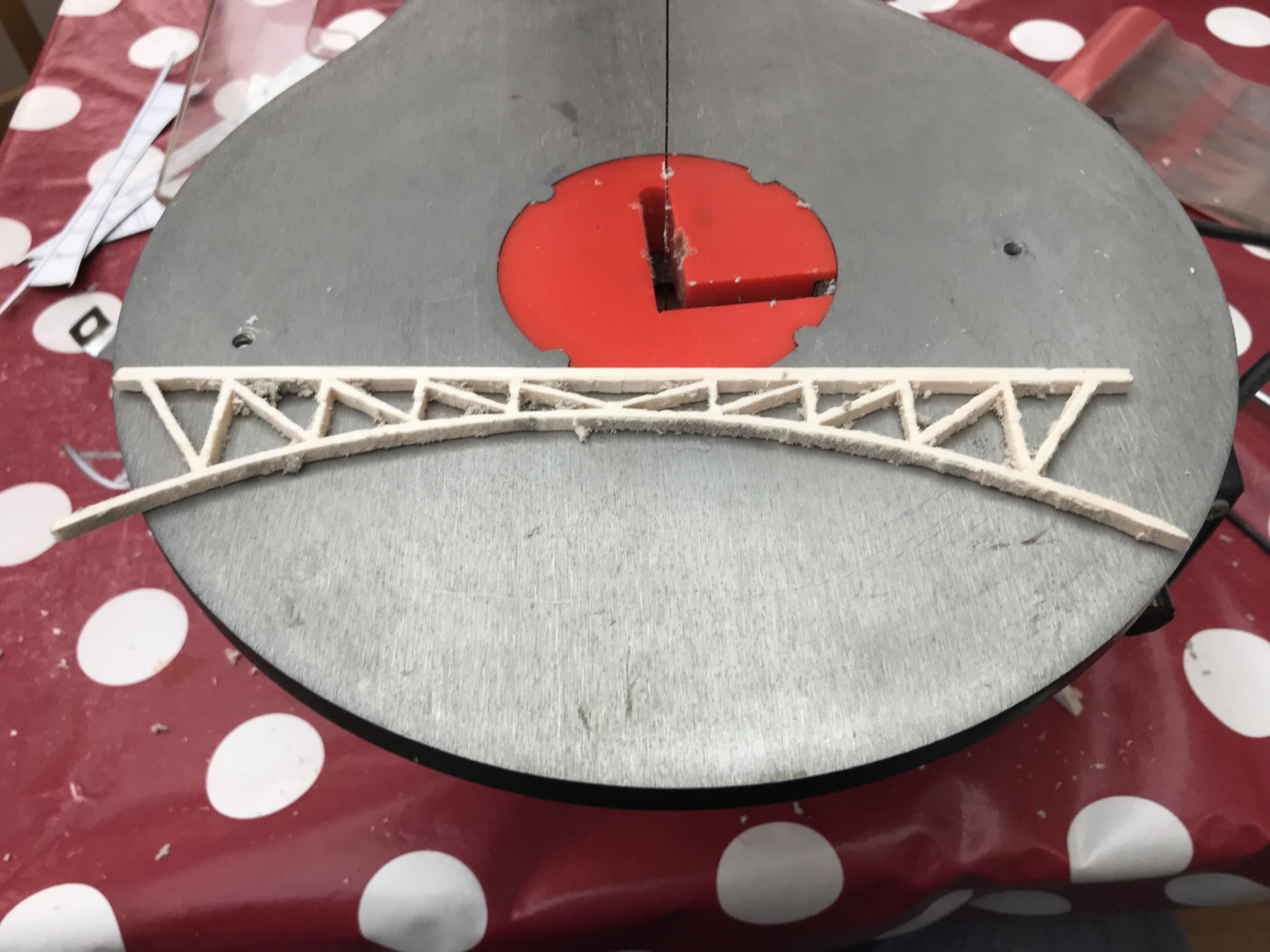

For the construction I will be cutting both side pieces as a whole piece and then adding a top piece for the track bed and some cross pieces (matchsticks or cocktail sticks maybe). The scroll saw was to be the weapon of choice so I started by sticking the printout to a piece of wood and drilling a hole in the sections to be removed;
And then onto the scroll saw;
Once I'd found a rhythm and after many cycles of remove blade, insert bridge piece, replace blade.... it looked like this;
After some very delicate sanding it fitted and looked (in my opinion) pretty good;

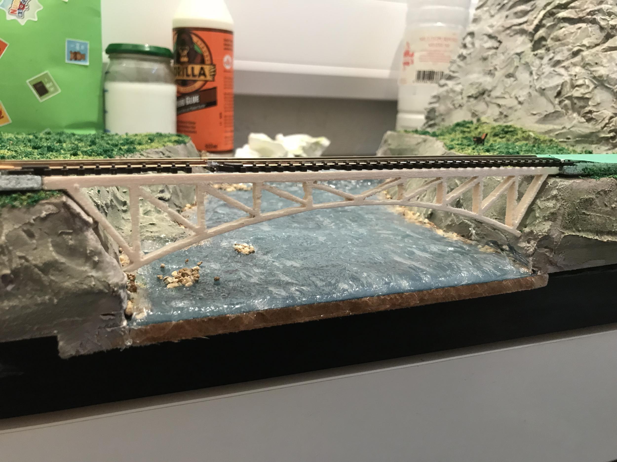

To be totally honest, when I was drawing this one I imagined it as metal. Iíll have a play and see what I can come up with. Itís so delicate that Iím nervous of sanding/filing too much. The joints are very weak when twisted.
After another failed attempt at the second piece I was getting nervous but third time lucky it was done!
Now I have the start of a kit of parts. I just need to work out the best way of putting it all together. Glue is the obvious choice but I need to think about how to hold it all together as it dries.  :hmmm:
All in all Iím very happy with todayís work!

« Reply #5 on: February 10, 2018, 09:49:54 PM »
Quote
2 bits of wood  like the track bed as packers at the mid point and top,but not glued in,and a few elastic bands to hold it all tight?

Iíd favour holding it together with elastic bands (not too tight!) during gluing/ assembly. Looking good.

 :thankyousign: for all the replies and ideas. I cut some simple support pieces this morning to give it some structural support.
Iím hoping to get some time this evening to start gluing it up.

I opted for a combination of the advice above. Lightly clamped with a packer lower down.
After a couple of hours in the clamps Iíve taken the packers out and glued in the supports. These are really tight so no need for clamps.
After a day or 2 Iíll have a go at more precise sanding/filing. Then Iíll get the primer out. Iím thinking metal but Iíll decide once the first primer coat is on.
Thanks again for all the comments.
