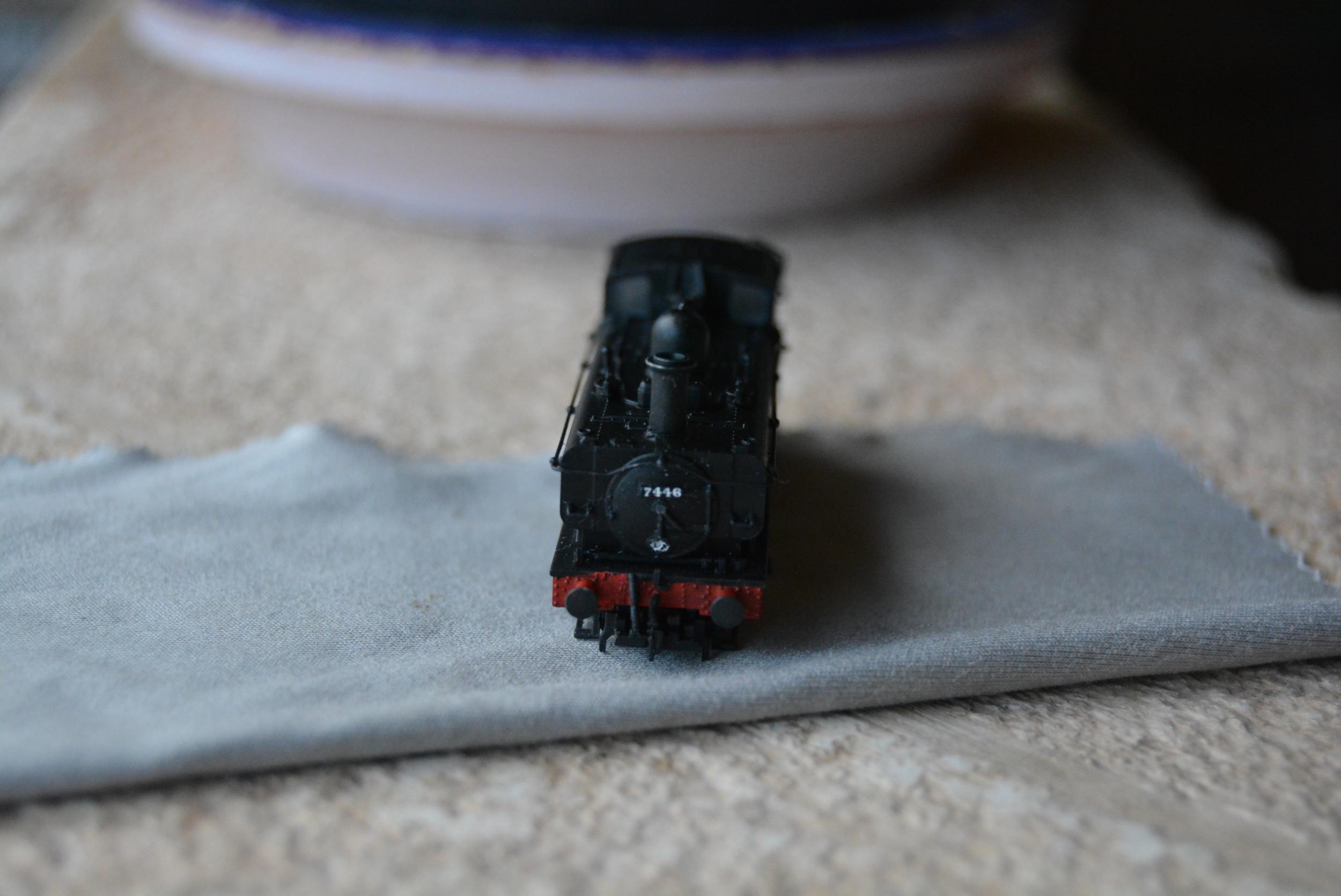

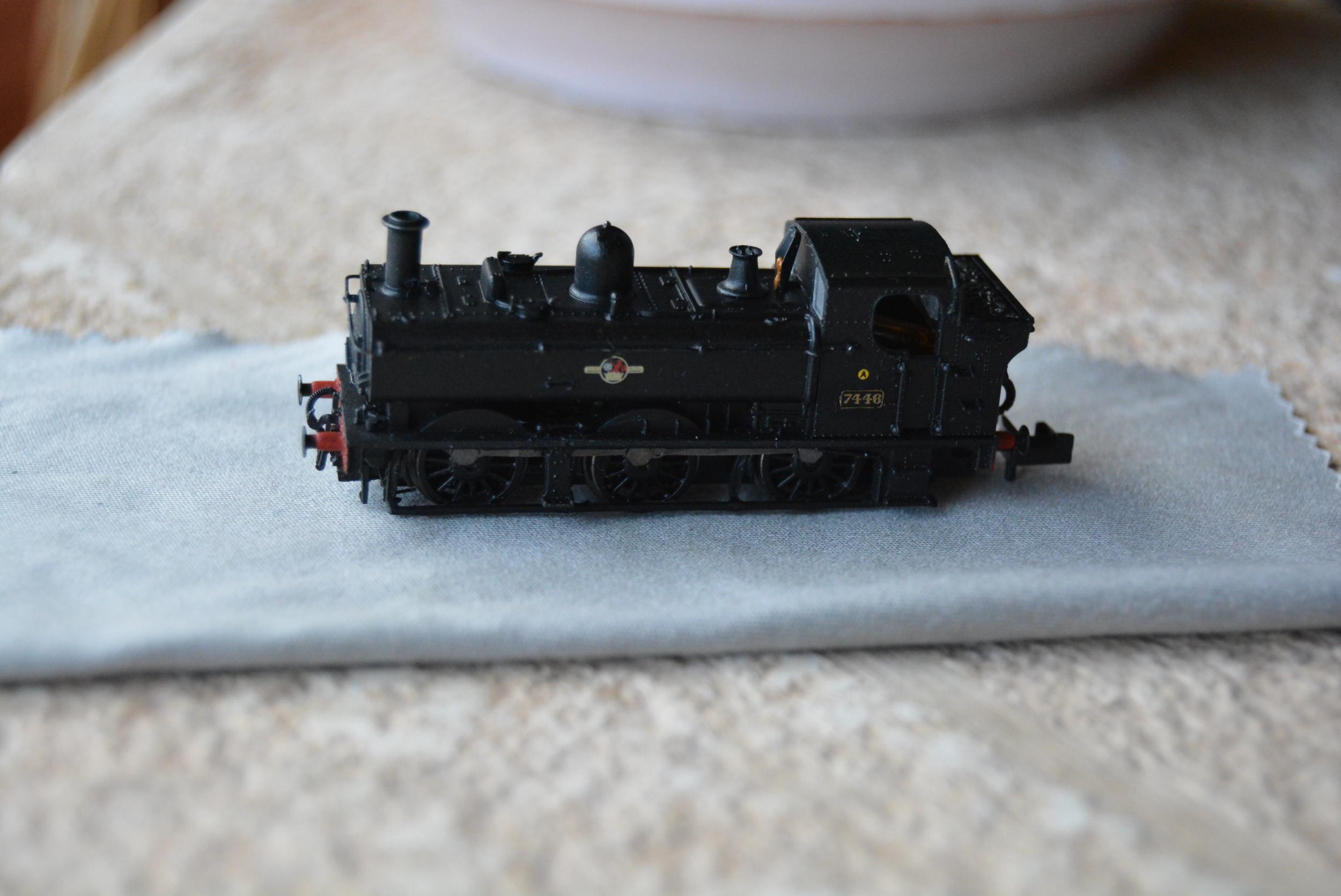

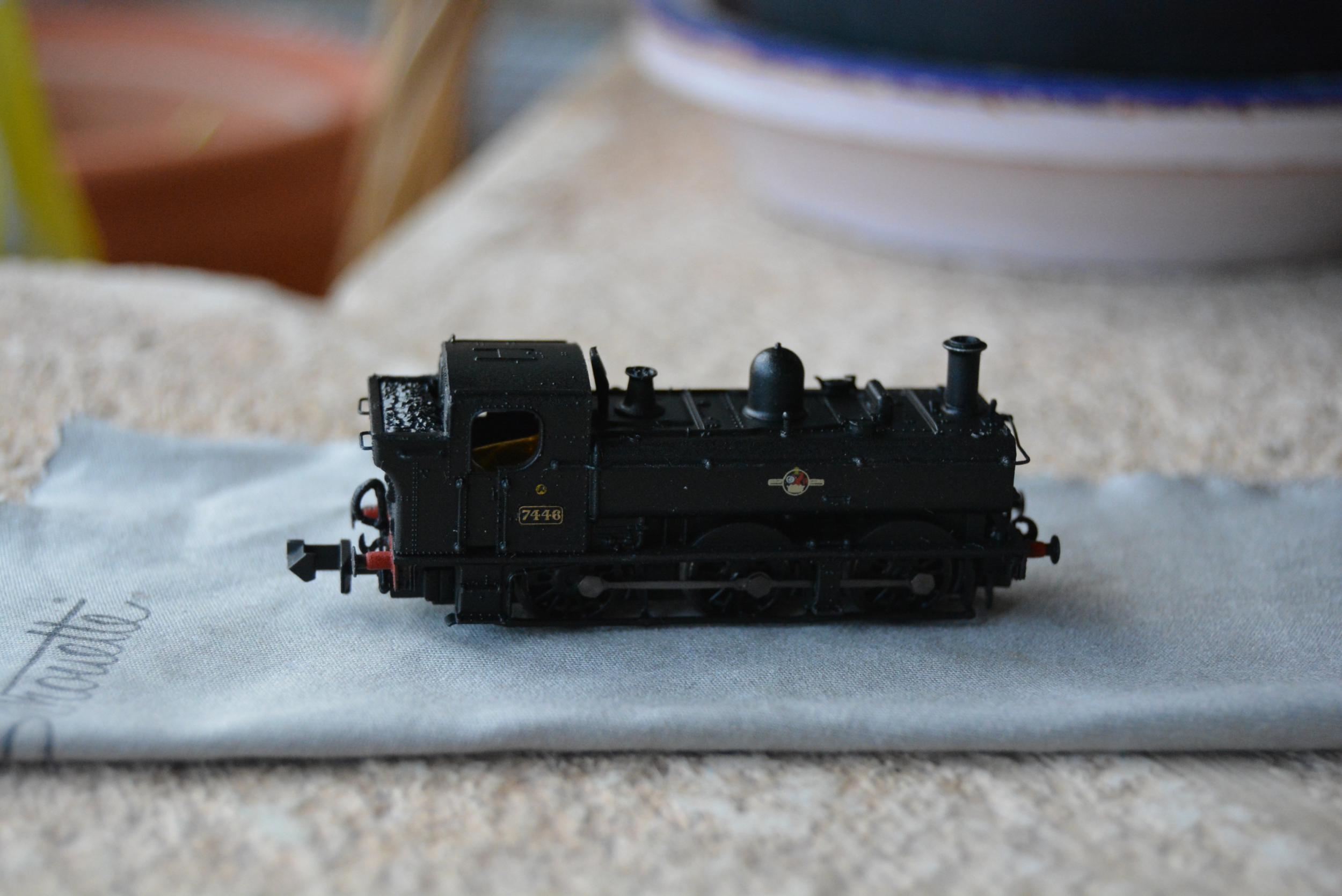

Well long time and no updates, so here goes, first up is the 64xx to 74xx conversion that I did for Chris in Prague, which basically consists of removing the auto gear from the buffer beam, squaring off the curve of the bunker to make a right angle and adding the beading and adding hand rails to the running plate.

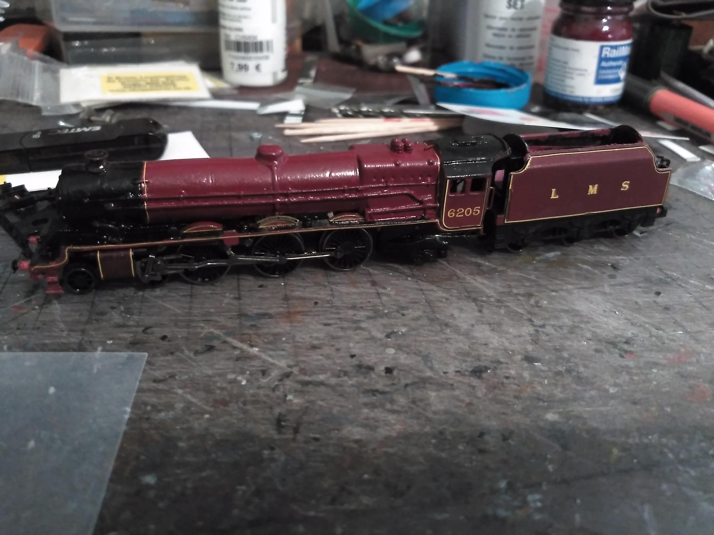

Next up was this Stainer Princess kit (BH Enterprises) I bought from Hattons for 10, and it even had name plates also! Bought a second hand duchess chassis and modded everything to  fit, railmatch paint sprayed on, fox lining.

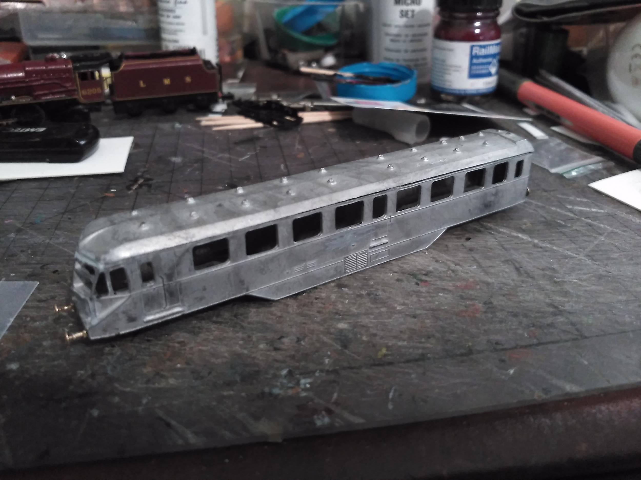

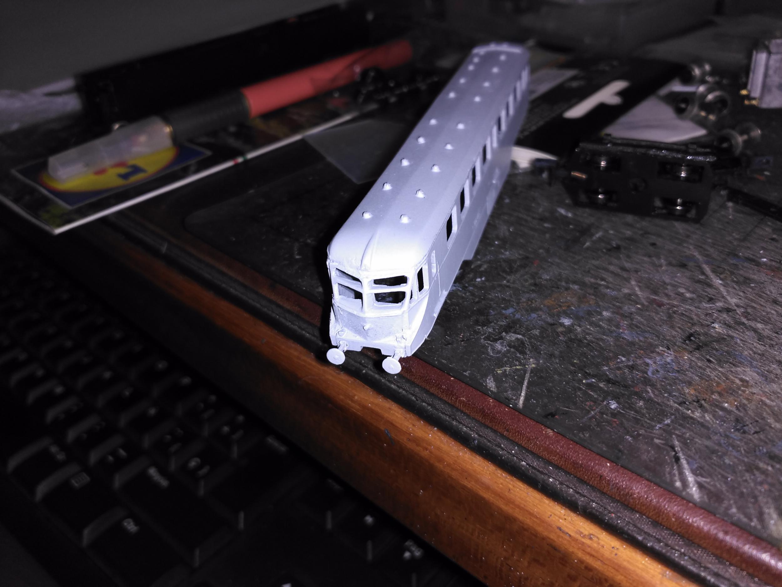

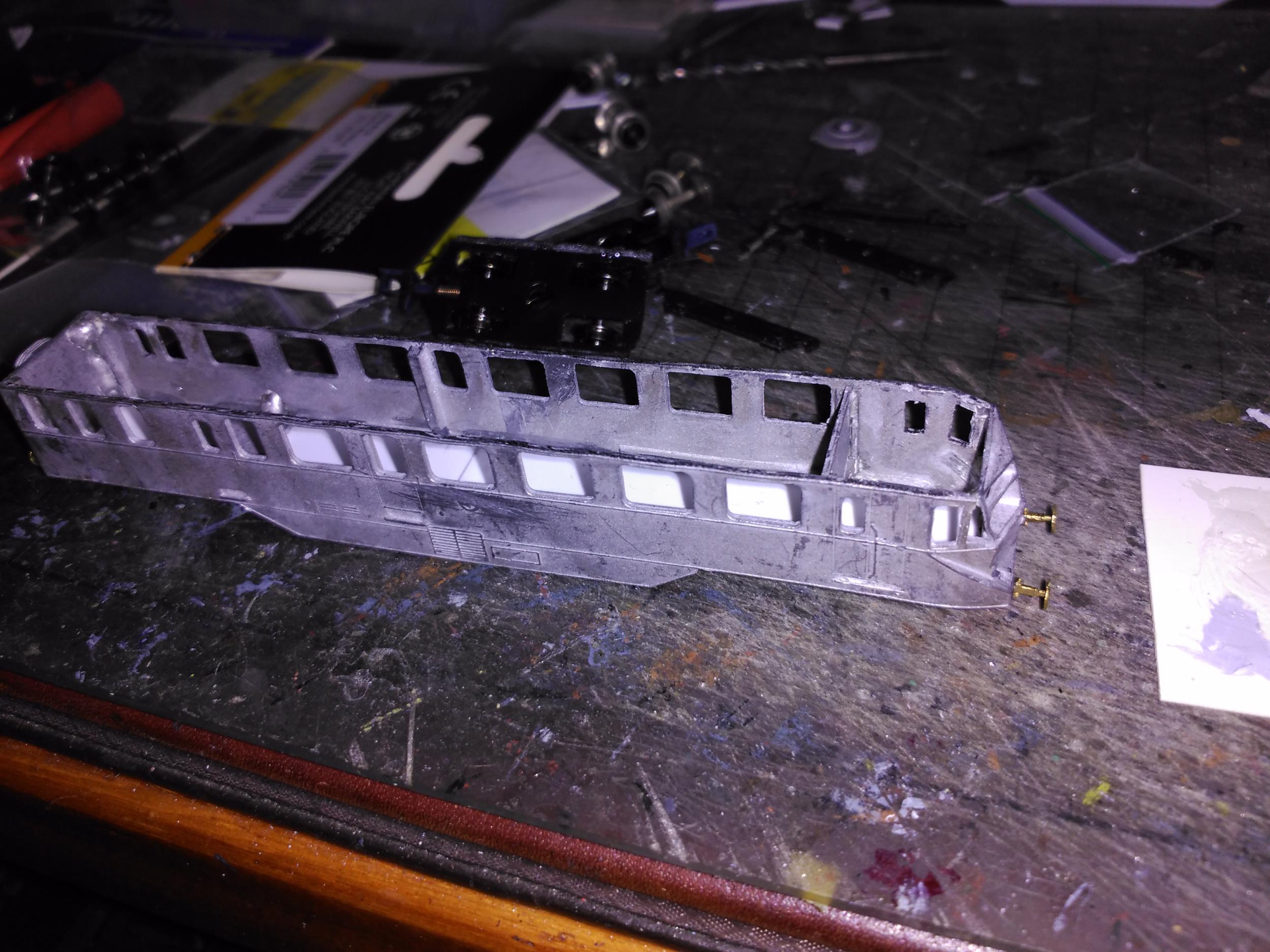

Next is a project that I am still working on, which is a Langley twin rail car.
Still some more filling and priming to be done.
The trailer car, I have made a Plastikard floor up for this, as the white metal one included in the kit was going to make way too heavy.

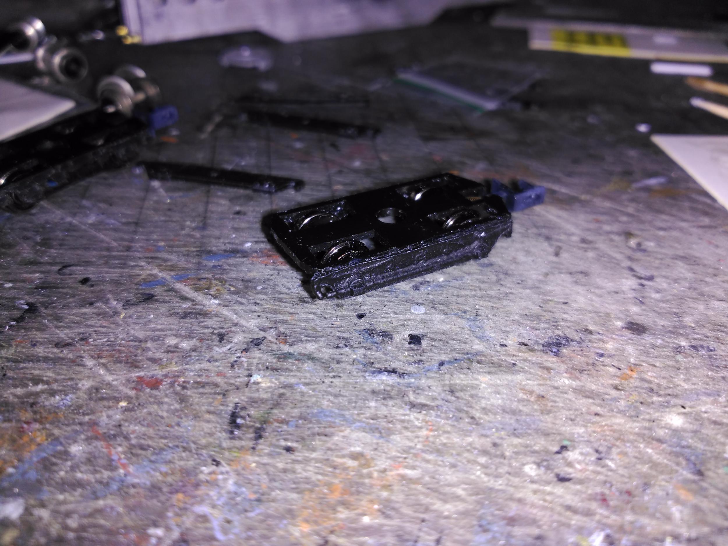

Trailing car bogie with white metal overlay glued on.
Regards Tony

Many thanks for this update, Tony. You did a superb job on the 64xx to 74xx (7446, of 83E, St. Blazey, 8/50-4/62) conversion. Thanks a lot.
The Stainer Princess looks very good, too. You must be very pleased with it.
Very good progress on the Langley ex-GWR twin diesel railcar set using a Graham Farish ex-GWR diesel railcar chassis, too. It should be W33W plus W38W but I'm wondering whether its final livery was the original, lighter BR DMU green ('malachite') or the later dark green? I always thought that it was the darker green.

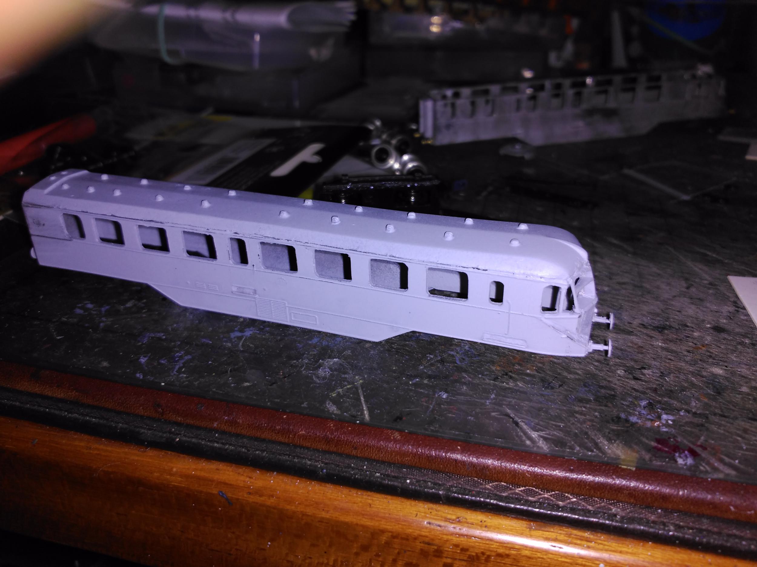

well, I realised there was a problem with the Langley Rail car, and that is that the top lights for the windows are not there!, so have started to make them from styrene.
One side done!
Other side half done
Chassis with its insulating tape coat
Jig for getting the spacing correct, also the graphite acts as a release agent.
Test fit of chassis to body

Many thanks, Tony, for this update. I had not realised that the top lights for the windows are not included. Your rig and, especially, the use of graphite is ingenious.
