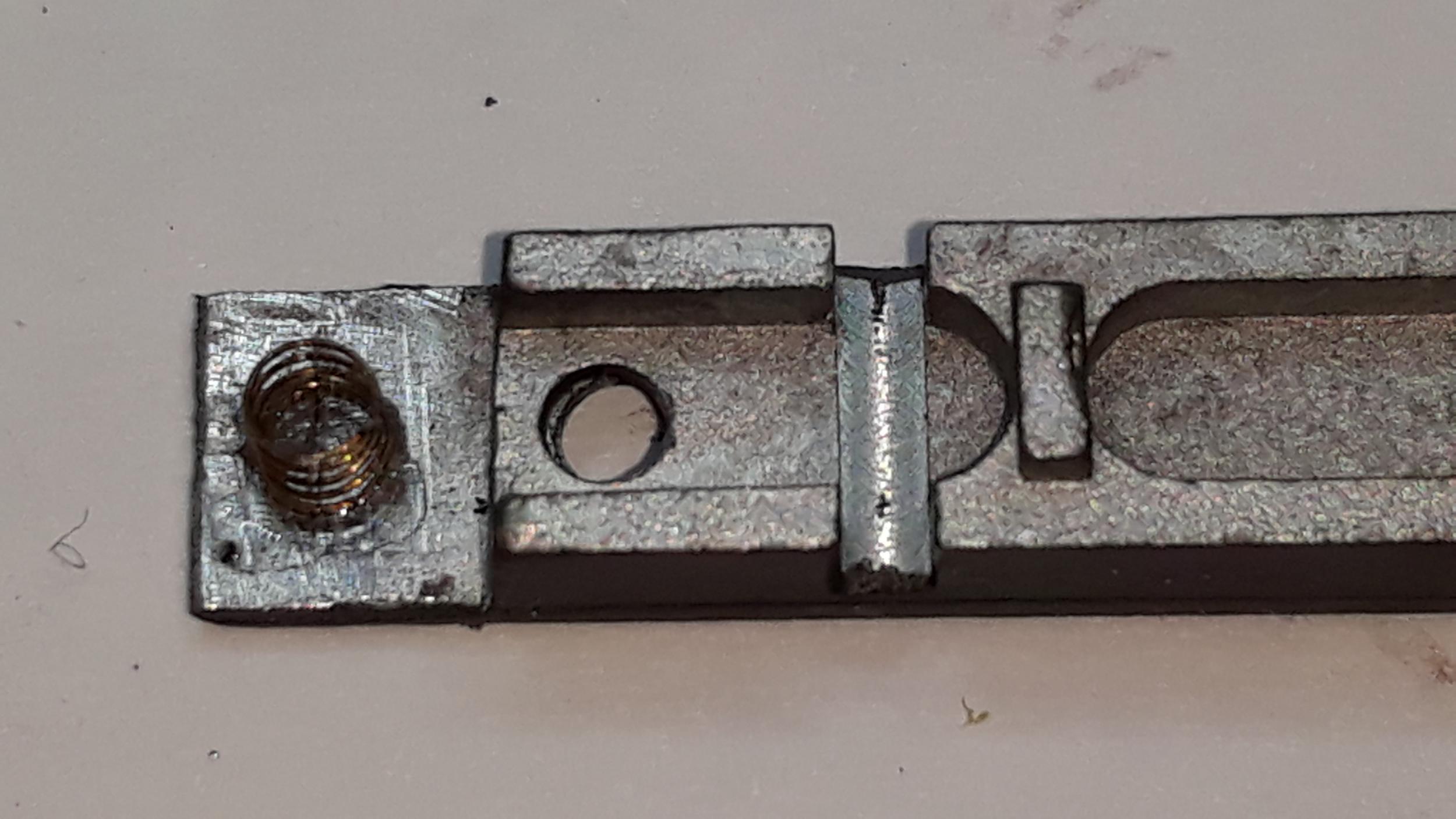

Remove coupling and spring and then cut the spring in half using cutters or scissors.
Clean the end of the keeper plate and scratch a mark 3.5mm from the shoulder of keeper plate as shown.  This will ensure the spring is located in the correct place.
Glue the half spring in place using superglue. Put aside to dry.

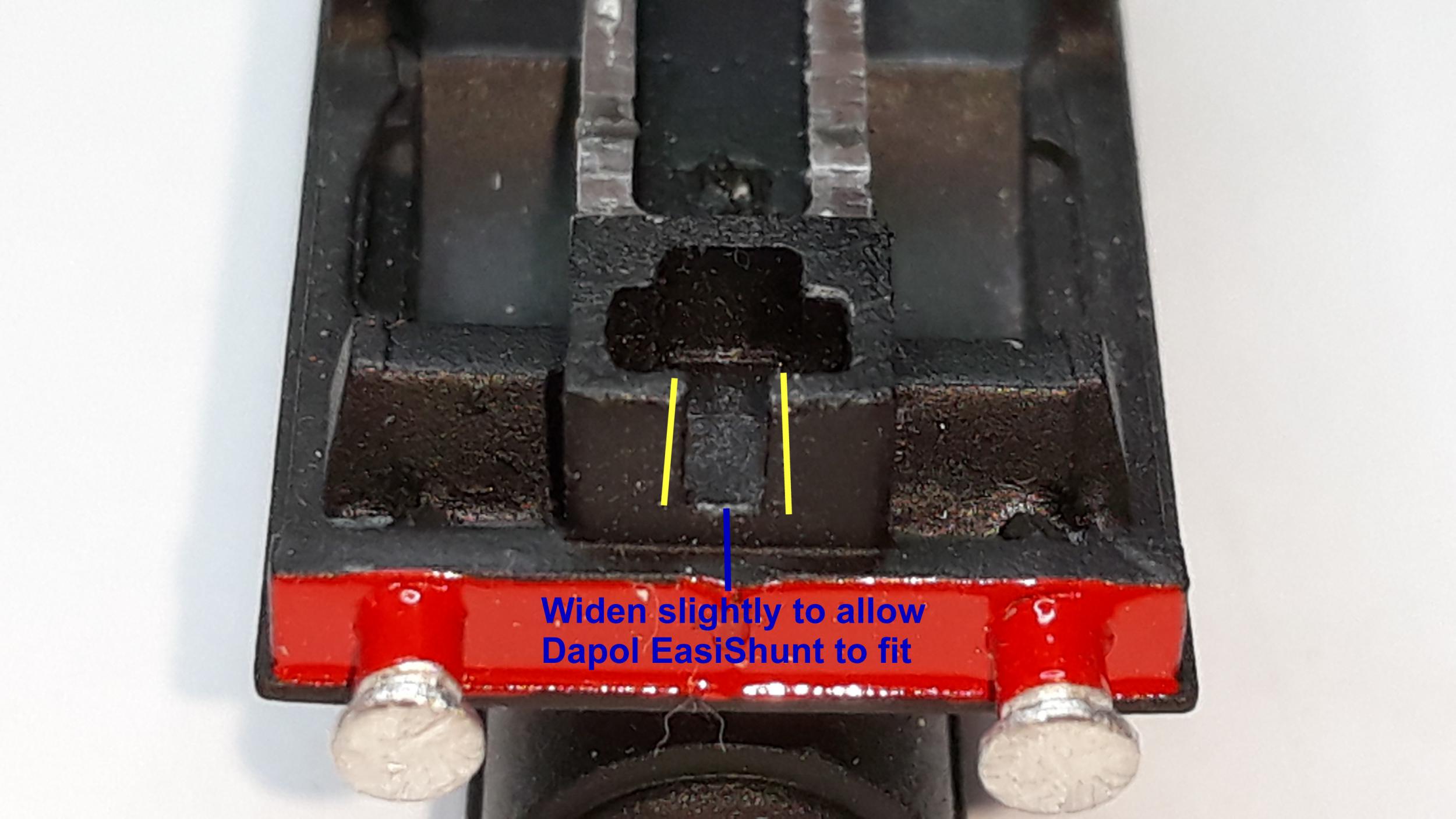

You need to open out the throat of the coupling pocket to accept the wider Dapol EasiShunt shank.  Use a small old craft knife start at the top and carefully pare it down making it slightly wider at the bottom as it helps retain the new coupling in place prior to refitting the keeper plate and spring.
DON’T try and do the cutting in one go as if you make it too wide the coupling will fall out, little by little with a slight undercut at the base checking the fit as you go.
It should end up like this
Refit wheels and keeper plate with its new coupler retaining spring, job done.

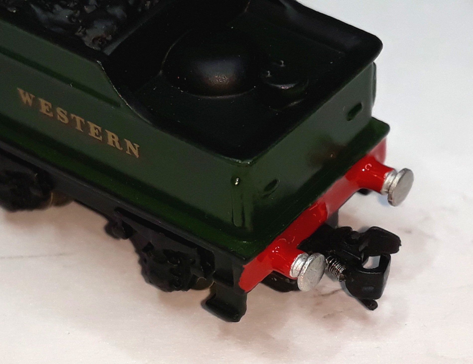

Same for the tender, remove keeper plate, save the spring in case you lose the other half you already have, clean the keeper plate where the spring is to be glued. Glue spring in place and put to one side to allow glue to set.
Same as loco, open out the coupler pocket to accept the Dapol EasiShunt, don’t forget, pare away little by little so you don’t take to much off, check shank fits into the bottom of the coupler pocket ok.
Fit coupling and refit keeper plate with its retention spring, again job done.
