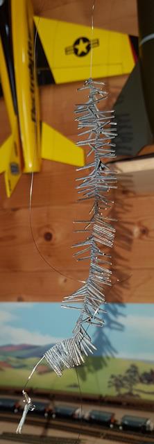

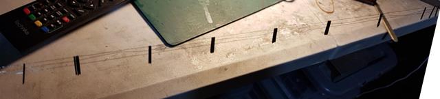

The Tora Bora Line....Wire Fencing
« Reply #93 on: July 19, 2018, 11:48:18 AM »
Attempt 1 with 100+ fence posts on 0.3mm wire :worried: :confused1::
That first go at making a metre of fencing was going well until I tried threading the third wire through the posts.  A couple of kinks developed and the wire broke when I tried to straighten them.  However I now have 2 lengths approx 400 and 600 mm long ready for future use somewhere else.
I tried a different method for the second attempt using fishing weights and elastic bands to keep tension on the wires to stop curling/kinking.  This has worked much better  :)
Now it is a case of evenly spacing the posts and locking them in place on the wires with some thin CA wicked into the holes.
Approx 8 hours work so far on both attempts and I'm not finished yet  :'(
A labour of love but I reckon it will look really good

Taa-daah.
Finished. another 2 hours and 1.1m of wire fence ready to go
I'm also pleased to say that compulsive threading is in fact treatable  :D
Now just have to drill lots of shallow holes for the posts to sit in.
Is that an R/C EDF jet hanging in the background?
Some situations in life are like dairy cows. When you see 'em you just gotta milk 'em.
Offline Dizz
  • N Gauge Society Number: 26050
  • Posts: 272
Re: The Tora Bora Line
« Reply #100 on: July 23, 2018, 11:43:12 AM »
It is indeed Chris.  My other hobby is model aircraft flying, although it has taken a back seat recently.
That Electra is basically a BVM Bandit look-a-like.  Small and fast an 4S; have only flown it once and it got too small too quickly!   :goggleeyes:
To the right is an Estes V2 model rocket  ;)
