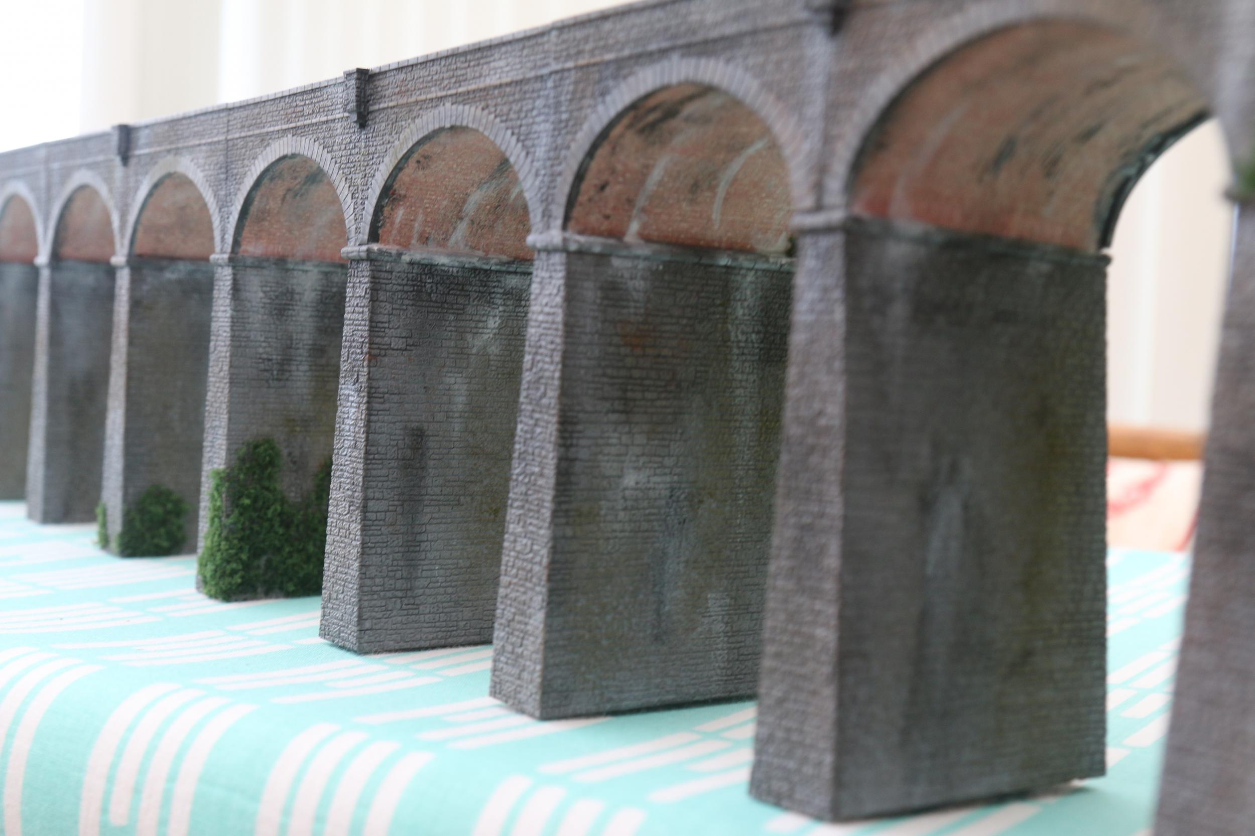

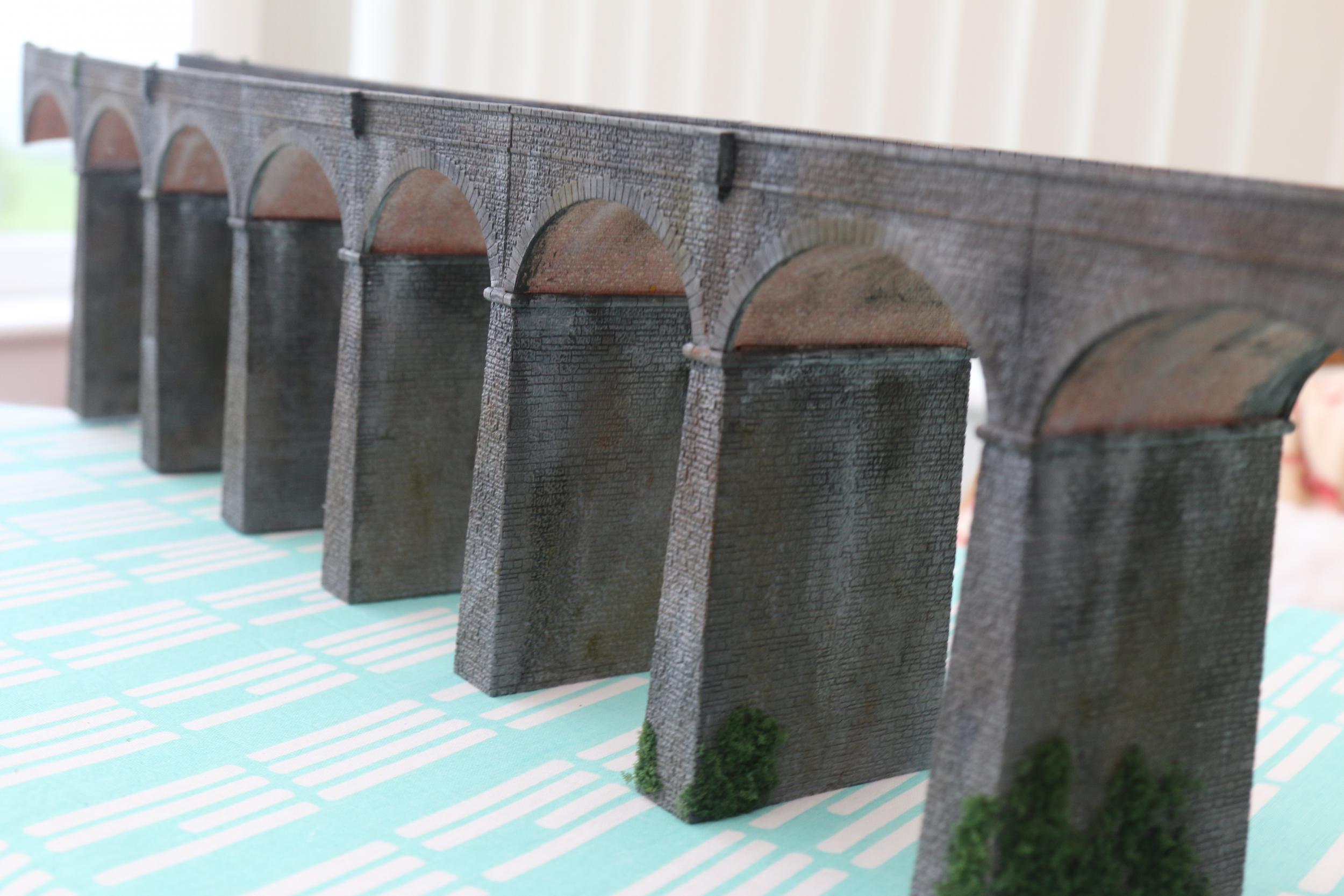

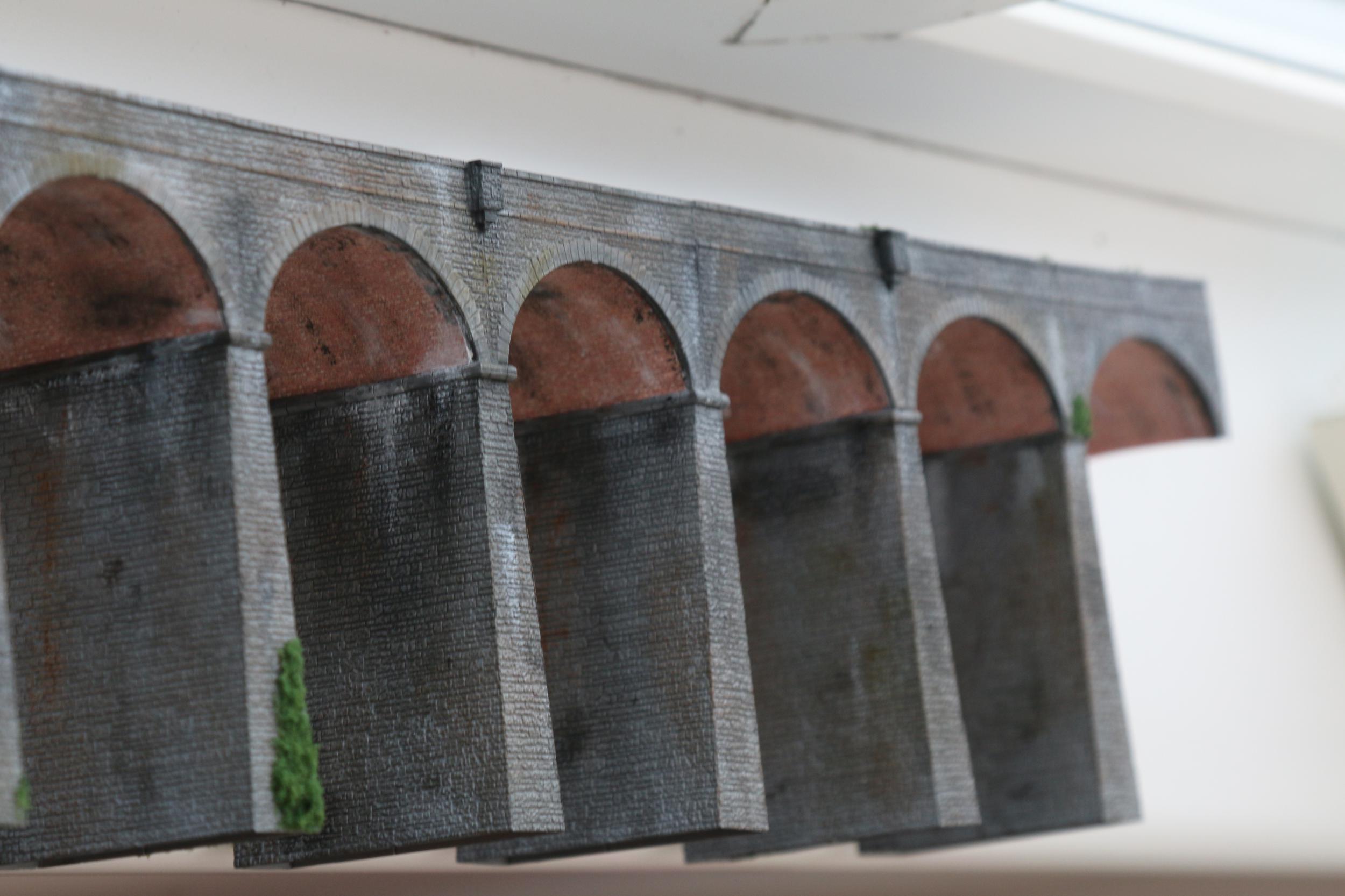

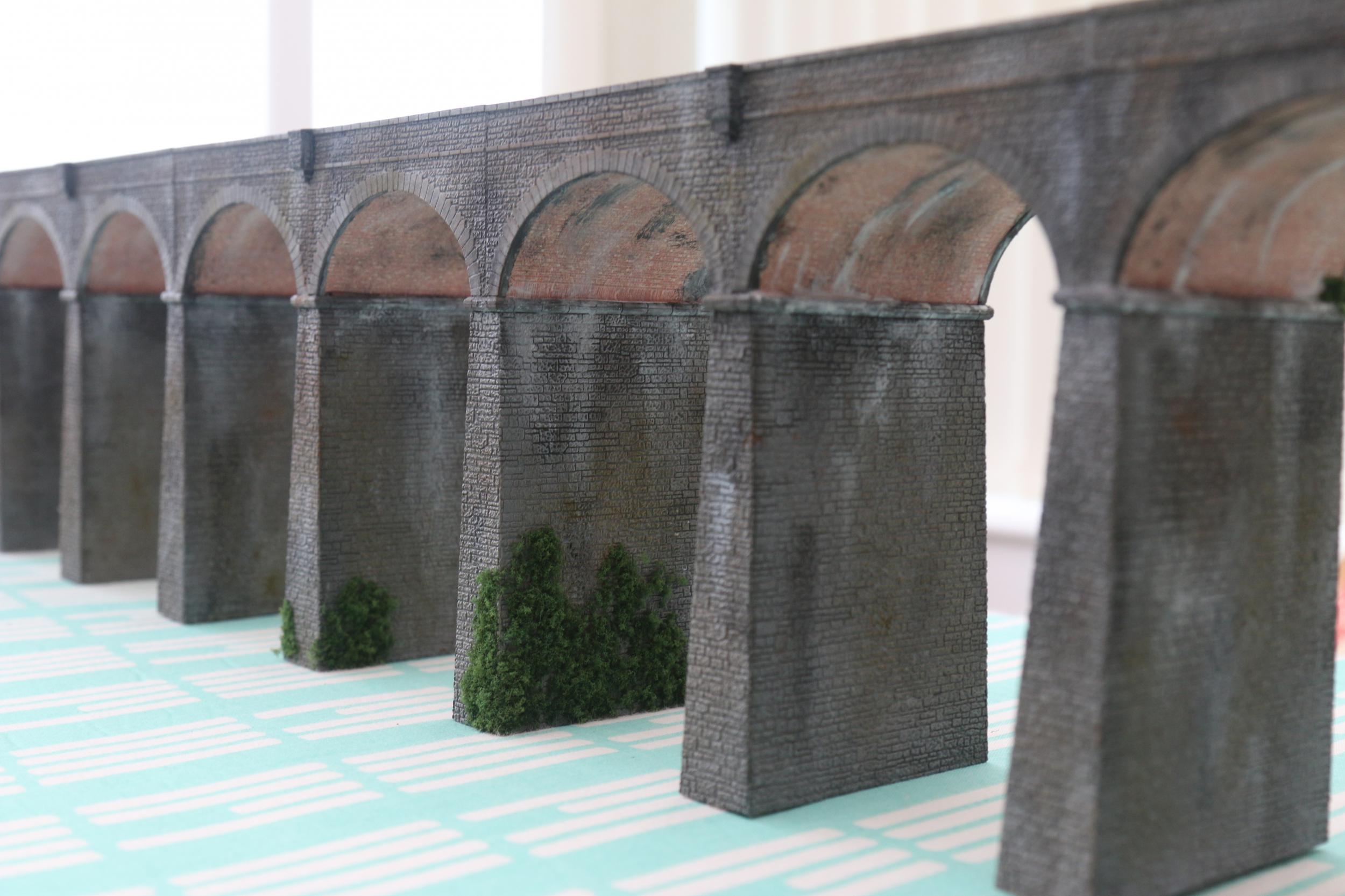

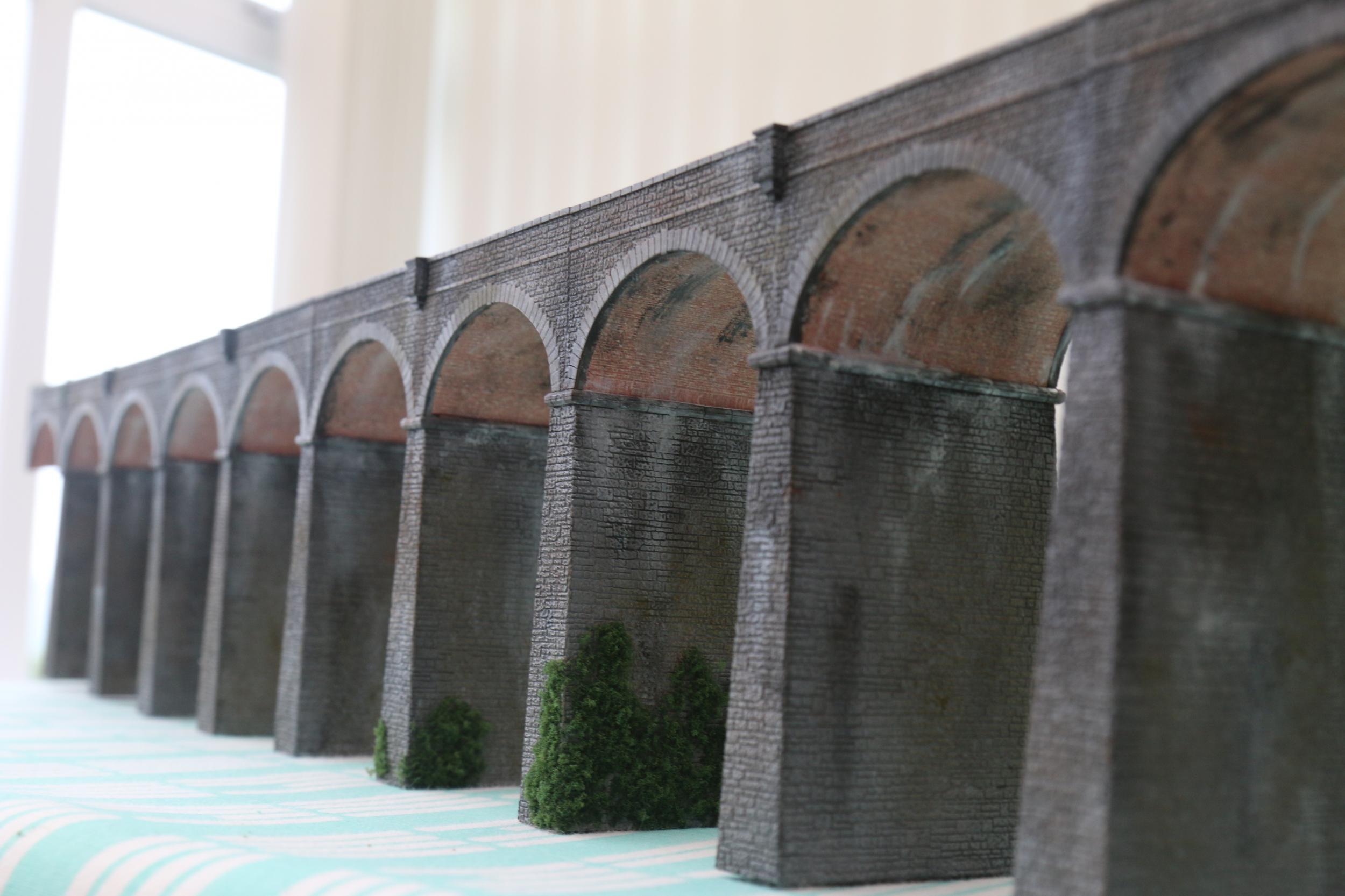

Thanks for all the kind comments. I did a bit of track laying again today in the shed for an hour but it's been a cold near freezing day today so decided to go indoors & do some work to finish off the viaduct instead.
Re; the viaduct, it's been a right pain to build, many of the curved brick arches I found the plastic very brittle & broke a few trying to get a curve on them, so ended up using plasticard instead & then covering them all in brick paper which has worked out ok.
The prototype viaduct has refuge buttresses along its length, I decided to try & replicate them by making some out of some scrap bits of plastic stone walling & plasticard. On the prototype they are cut away, but I didn't really want to start hacking away the main structure on my viaduct so decided just to glue them along the sides instead. Not 100% accurate I know but I think it looks the part. Then a few washes of various colours & dry brushing staining etc to try & get it looking more stone like & weathered.
Here are a few pics of the results...
Cheers, Stu
