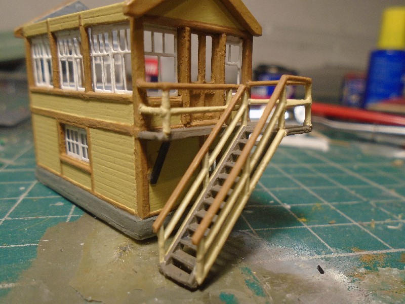

I've not put the street light in yet, as I have been waiting for some tiny red led's for the level crossing gates, and wanted to do all the electrics  together.
Instead, I have made a new signal box  :D
This is the one I have, a kit bashed Ratio one .....
Over time, working on the layout the windows have got really messed up, as well as the glazing not fitting correctly. Also the steps are a bit clunky, and the paint finish is not too good. Maybe I am being a bit over critical, but it is really noticeable in photos, and in real life as it is right at the front of the layout (although nothing is really that far away  ;) :D ;))
Anyway, while waiting for the electrics to arrive, which they have now, I decided to make a new signal box, but taking my time and not rushing it.

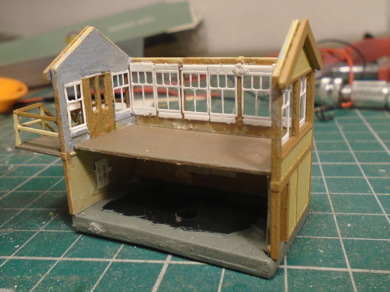

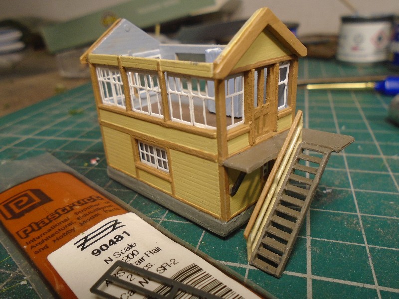

The first job was cutting the Ratio kit down to size ....
Then I assembled it, leaving the back off. It was then painted without any glazing in, so I would not dirty the glass.
There was no door in the end wall of the kit, so I put one in, and made steps and rails from "Plastruct" styrene bits .... thinner than the rod used before ....

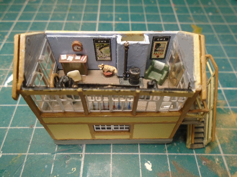

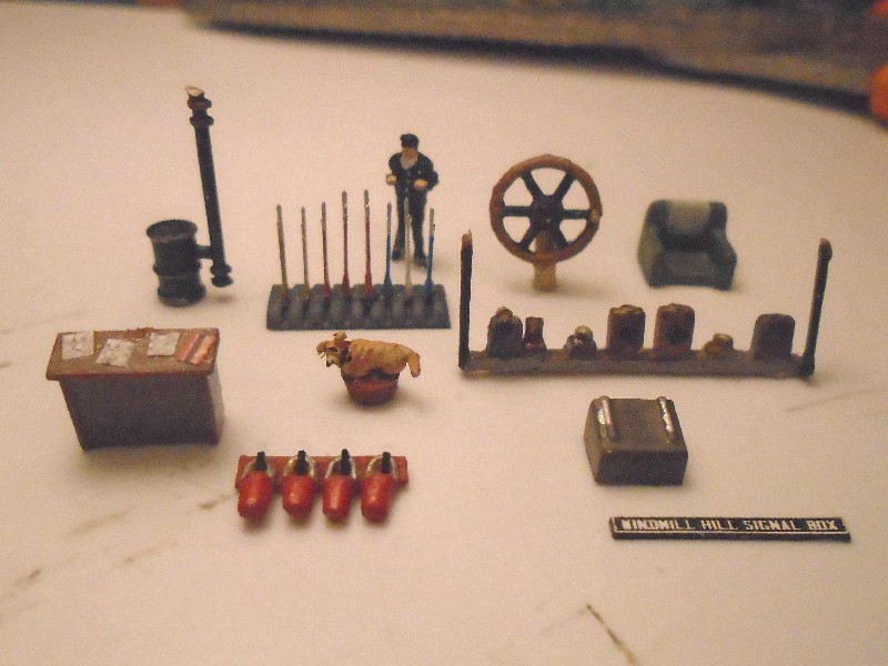

I then sorted the detailing. The signalmans dog was from a set of barbeque figures that included the deckchairs on the beach, and the barbeque the camper van girls are using. The signal box sign is etched on plastic from Scale Model Scenery, and the fire buckets from P & D Marsh.

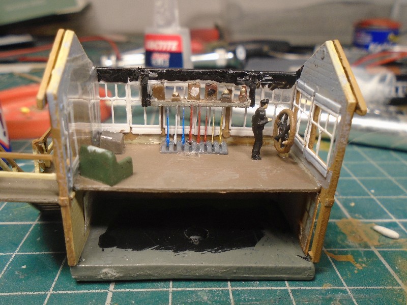

The glazing was the last to go in. The front window glazing was not glued, but set between the levers and the shelf of whatever they are. For some reason I left the shelf out of the old box, but was not noticeable as you couldn't see through the windows anyway  :D :no: :D
The glass on the end walls is held in with double sided tape, so it would not get clouded up with glue. The channel behind the stove is to hide the wires for the lighting, and the back window is covered over as it is directly against the embankment.

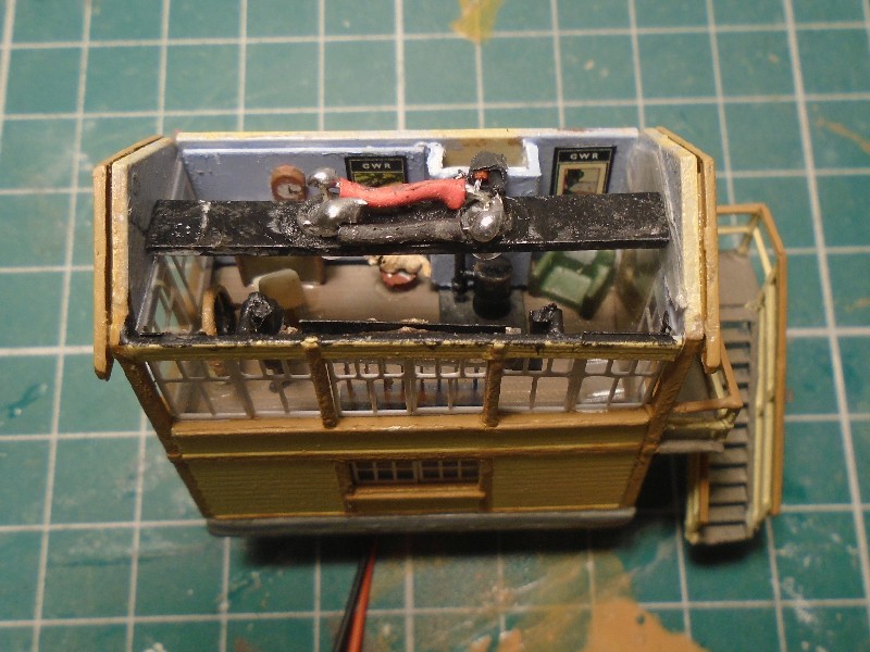

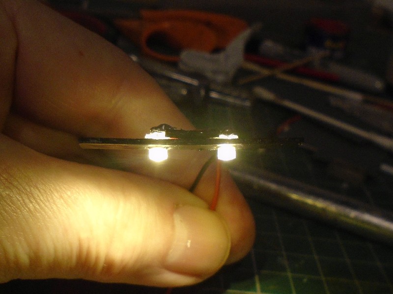

The lighting bar was then made ....
It fits between the end walls, the wires run down the channel behind the stove, and the resistor (I did remember it  :D :D :D) is downstairs.

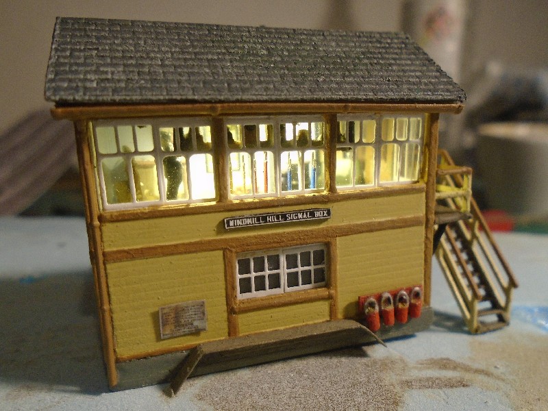

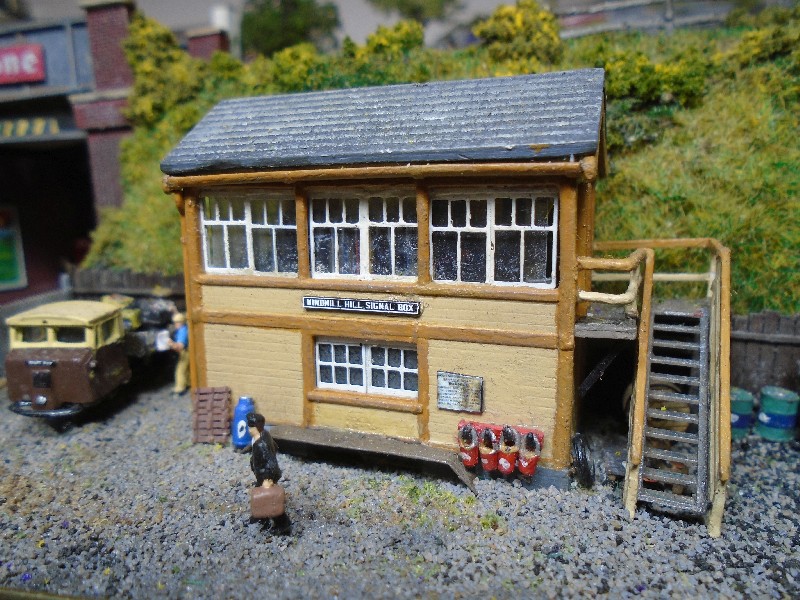

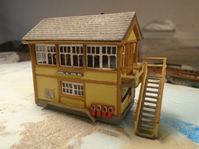

Then on with the roof .... with the front edge sanded down so as not to be as clunky as the last one, and gutters, downpipes and other bits added on ....
Hope you like the pics. I need to get some more ballast before I can set it on the layout. Until then it is in a very safe place so I don't faff around with it and spoil it. ;)

Excellent work, Kevin. Well worth all the detailing. I hope to achieve something like the same level of detailing and lighting, in future. The piece of wood on the front bottom with the ramps was to clear point rodding, which you do not have any of, so could be omitted. 8-)

That is stunning, Kevin. Smashing detail, down to the anti-macassar on the armchair. :goggleeyes:
One question please. Why does your signalman require a ships wheel? ;)

As far as the ship's wheel .... that's what I thought it was, and it had strayed in from a model pirate ship. Perhaps I should have given the signalman a parrot rather than a dog  ;D
Apparently it is to operate the level crossing gates, so is a bit redundant 'till I get them put back  :)

The 'whatever they are' on the shelf are called block instruments.  These are important to make sure that two trains do not end up on the same bit of railway at the same time.  It's (normally) slightly different with signal boxes on single lines of railway, but that need not trouble us in 1:148 scale.
The shelf itself is often called a 'block shelf'.
You have a splendid example of the third most important thing in any signal box; a distinctly dodgy armchair!
