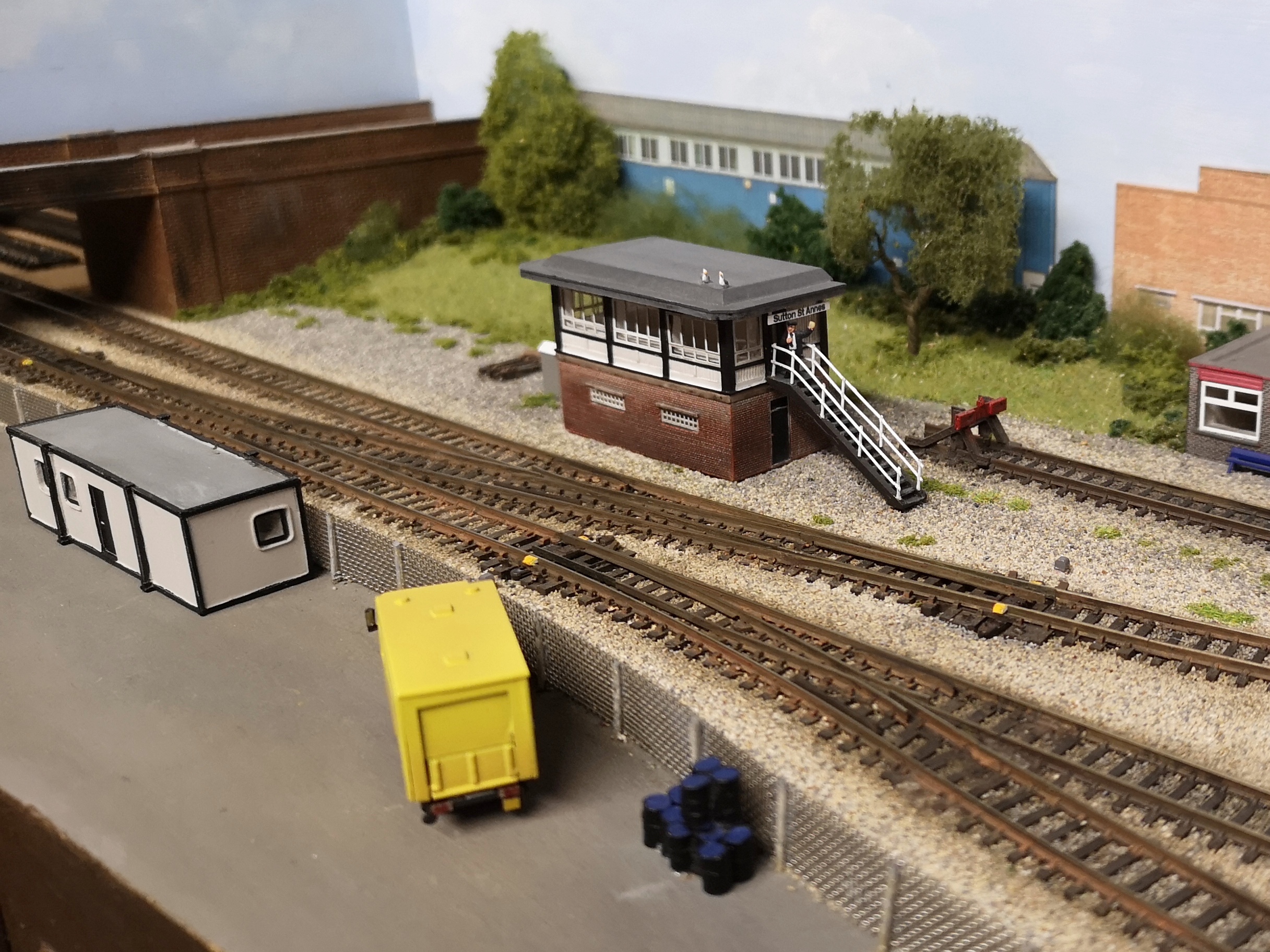

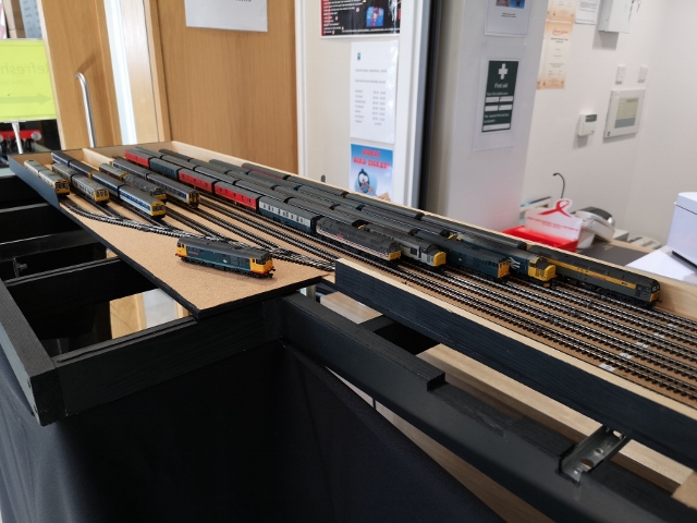

Here's a job I have been meaning to do since getting SSA onto the exhibition circuit - Adding an extension to the traverser board. Originally this was never intended to be exhibited, so I was happy with a 6 road traverser, but since completing 4 shows (with another 3 to do this year) it has become apparent that I really want to show off and run more trains, especially some more loco hauled stock and DMU's that I have in my collection.
So on Monday morning I set to and went into the garage to start planning the extension... After sipping lots of tea, scratching my head and vaping away on my pen, I finally came up with a plan! I also had a rummage through my spare (scrap) pieces of wood and came across a nice piece of MDF from another project, which by luck was virtually the size that I needed. I already had some set track points in stock, which are good enough for the extra sidings, so off I went butchering, measuring, sawing, gluing and screwing!
I made a frame out of standard 2x1, glued and screwed this together then securely fastened this to the traverser. Once I had cut the MDF to size, this was then placed over the top. Then it was tested for smoothness back and forth and finally securely fitted to the existing traverser base.
You can see that I have cut into the No. 1 road and installed a LH hand set track point, then added another 2 RH. I have ordered a third, hopefully this will be here tomorrow. The third in the photo is another LH point turned upside down (just to measure) The beauty with this is that I don't have to muck around adding further wiring or isolating sections. Insulfrog points have been used, so I will rely on those to isolate the sidings and the power feed will come off the existing No. 1 road. Simples... Finally cork was glued down and the track glued into place.
A quick photo of the progress so far. I will also be putting back the 'safety' beading around the edges, to prevent any falling incidents! Where the 108 and 153 sits, there will be another 2 roads going in here, once the last LH point has arrived. All being well, this will be complete for the Mountsorrel show this weekend :beers:

My last RH point arrived today :D However, I have found that I can fit one more in with ease! So ordered another :thumbsup: This will give me 5 roads now! This should be here tomorrow. So yes, all will be complete for Saturday, well hoping Friday night!

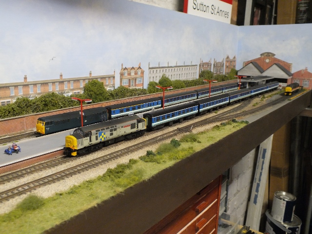

And we're all set :claphappy: Finally managed to get the re-working of the traverser board finished today. Even managed a lick of paint...
I have also been busy updating the front of layout blurb. Note that I have re-worked the Sutton St. Annes logo with a more authentic and appropriate type for the time period modelled. This style of station sign (with the Lancashire Rose) was very common on stations across the Fylde coast. Just whipped it up in publisher.

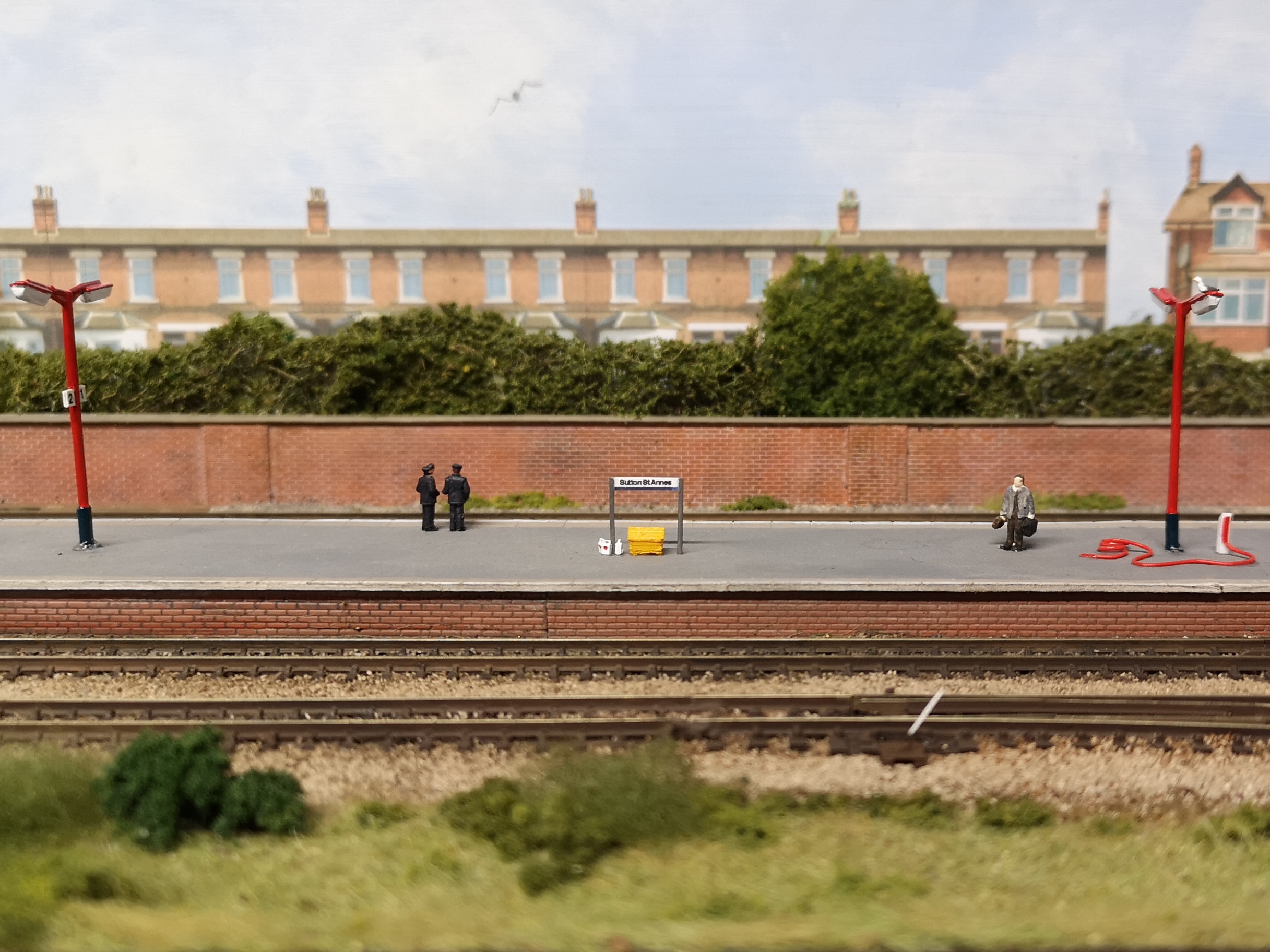

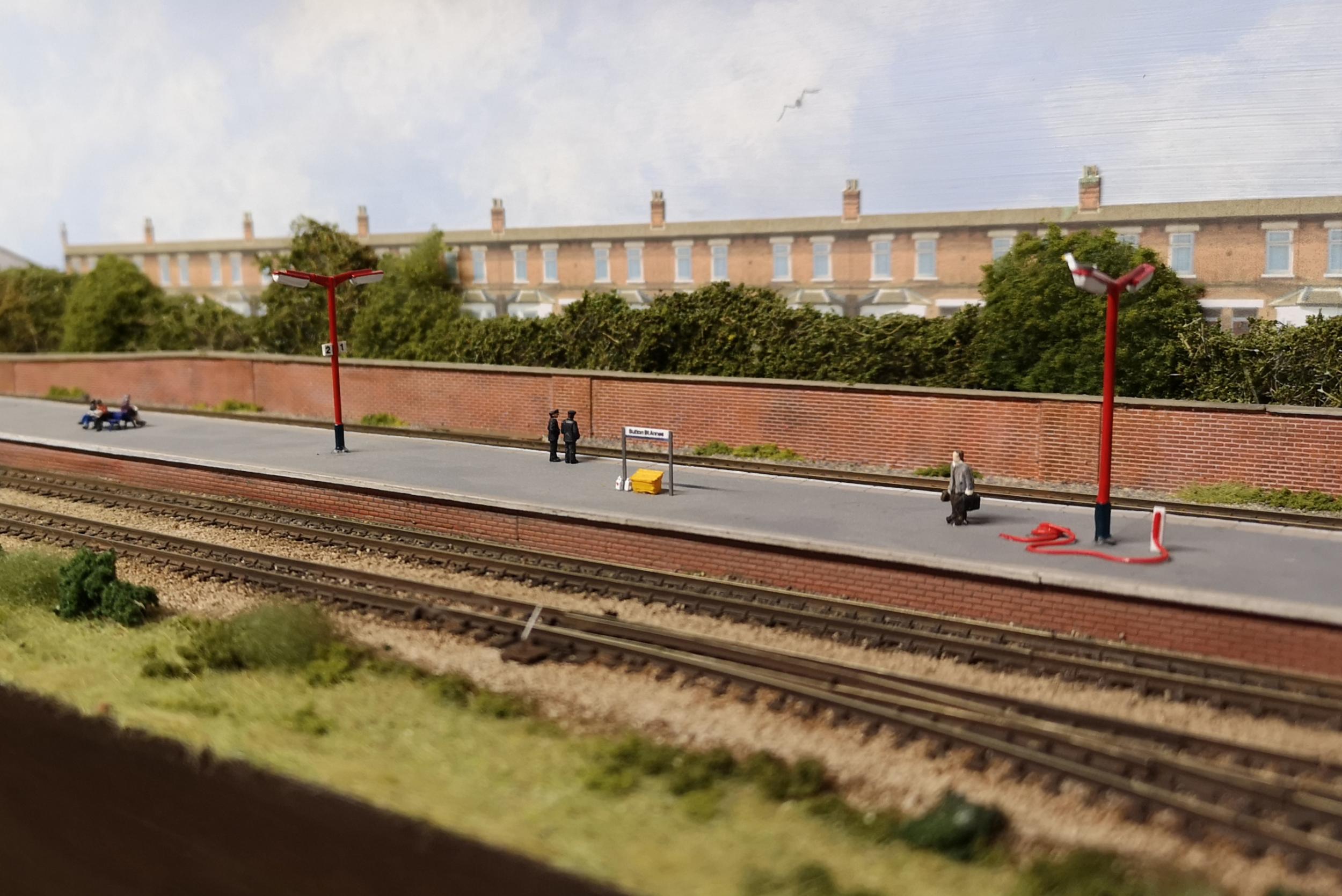

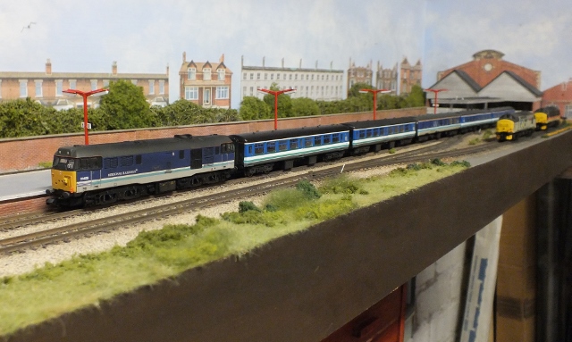

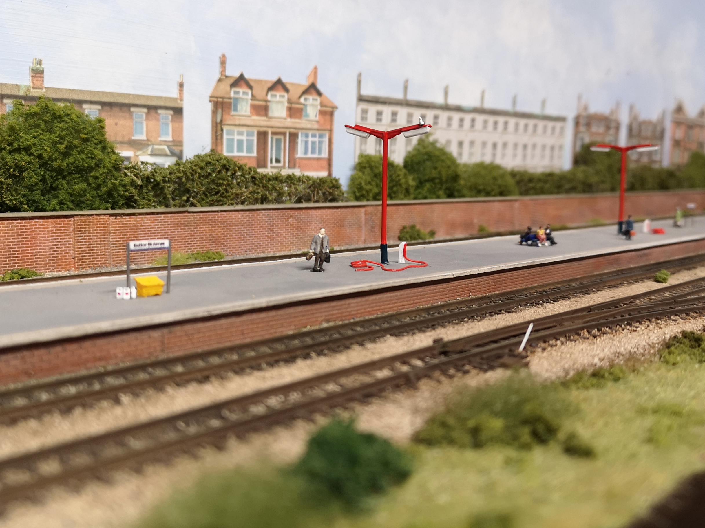

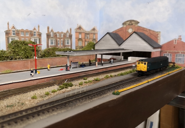

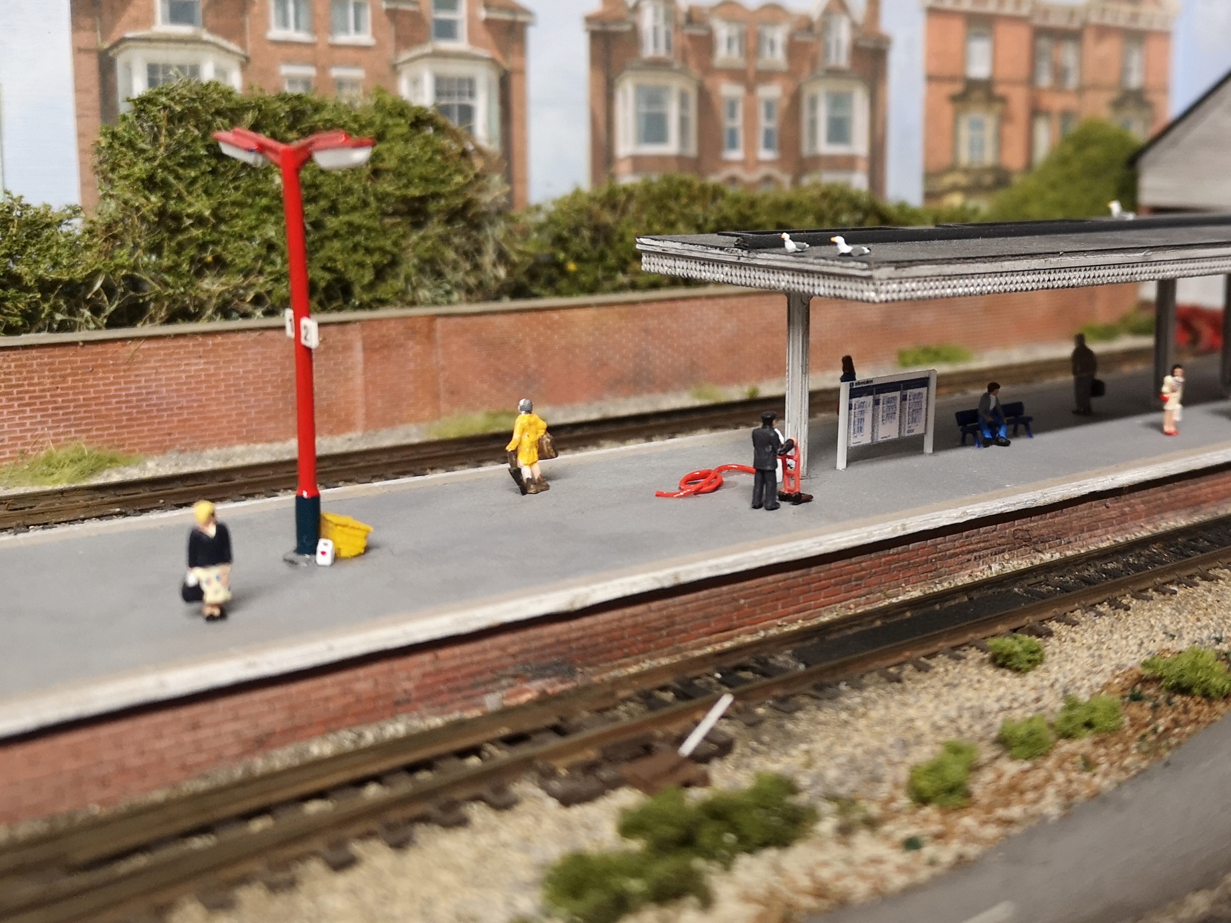

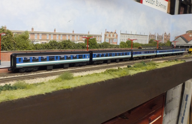

I have been beavering away giving the platform a little refresh. It's looking more Network NorthWest now with the repainted lamp post's. Also note the standpipes, grit bins, platform numbers and a arrival / departure information board. Can you spot the tail lamps? A few more extra seagulls have also appeared! In addition to the platform refresh I have also added hand point levers, clamp lock micro switch covers and pump units. Note the yellow rail safety barrier next to the stabling point. Still more to do, but that can wait for another day.
I have managed to finish off another loco and a rake of stock. Just in time for this Saturdays show :laugh:

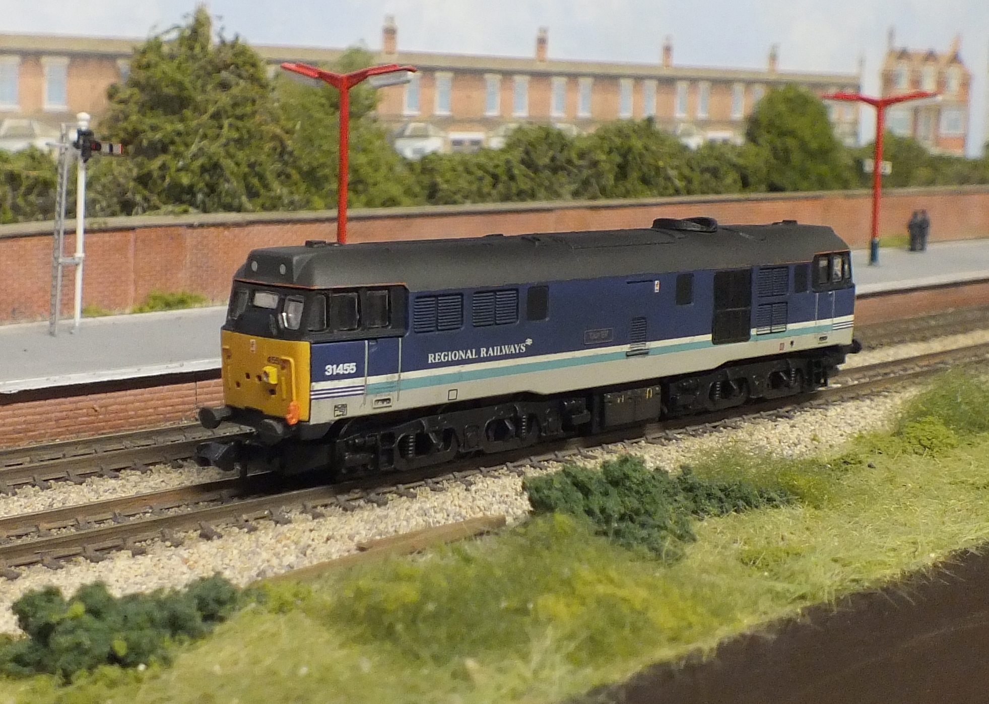

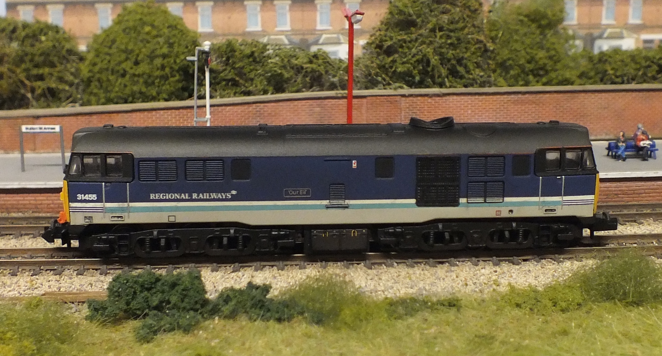

31455 'Our Eli'
Another tarted up China Farish 31, but this time with a roof fan cowling and vertical grills. I had the cowling 3D printed by a friend as this is something you have never been able to buy in 2mm. Thank you @Only Me  For some strange reason I think it makes the 31's look even more beastly! Other details include NRN roof pods, offset headlight, plated over boiler port, windscreen washer covers and ETH stowage sockets. Good old Shawplan etched nameplate too. **Dapol knuckle couplers have now been fitted**
Who needs to spend £100+ on a new re-tooled version! You can pick these up for as little as £40! (Sorry Mr P at Farish) Give them a good service, add a little detail and jobs and good en. They are still very pleasing to the eye and all my re-worked 31 fleet run like a swiss clock.

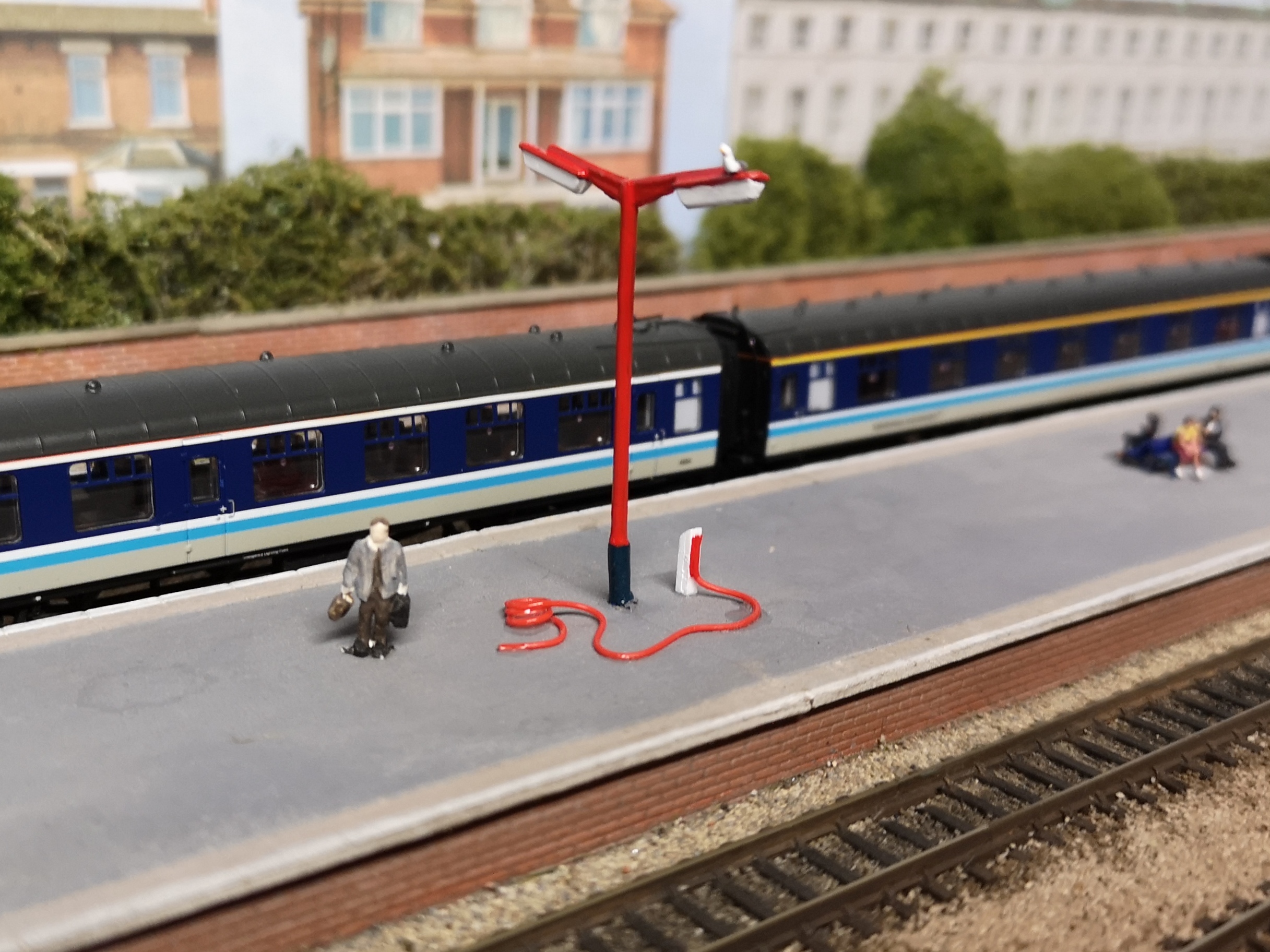

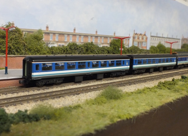

I have also completed another rake of Mk2a's. This time an ex NSE rake, but with a RR Mk2 BSO in the middle.
Nice simple job, just removed the NSE branding and added the blue stripe. These where FOX provincial white and blue transfers with the white cut away. Hardest part was getting the NSE Mk2's split from the Capital Connection set!
