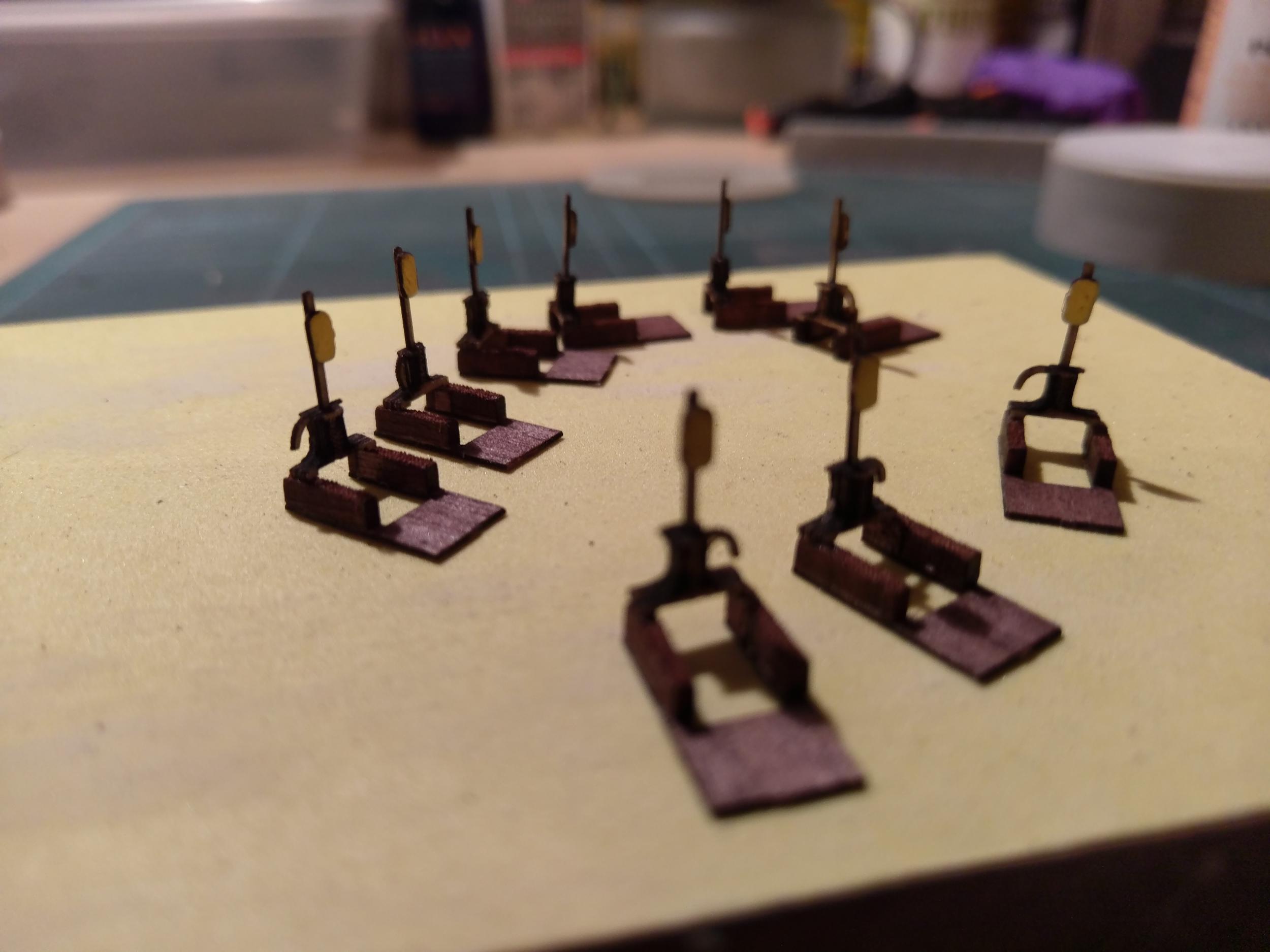

Yet again -too busy with work /grandkids/ keeping the Mrs happy to do that much - but the nights are drawing in -so I might get a bit of time to play ?? Been playing with two things -first up was Osborns switch stands -nice laser cut kit -easy to assemble with wood glue and finish with a bit of paint -hey ho you decide -----

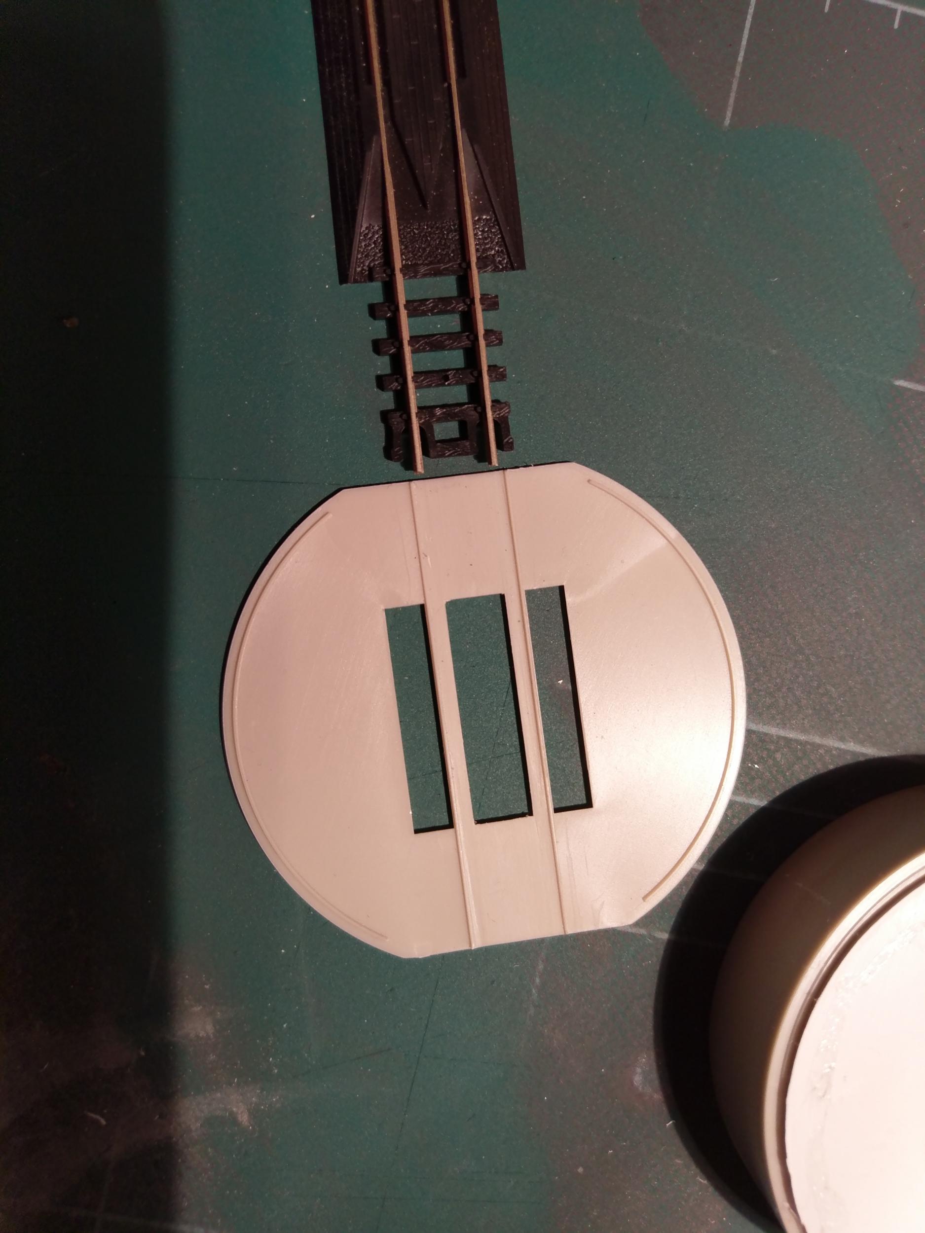

Next up the flood loader - got used to walthers kits now after the mine building- find the problem bits -work out how to solve it -but first up I think this kit is a scaled down version of the HO variant -the base section had two troughs moulded in to it for the rails to lay in (you remove 13 sleepers on peco track ) - then glue them in the troughs -easy -he'll no - not even close to 9mm -ended up removing the inner two sanding it all flat -

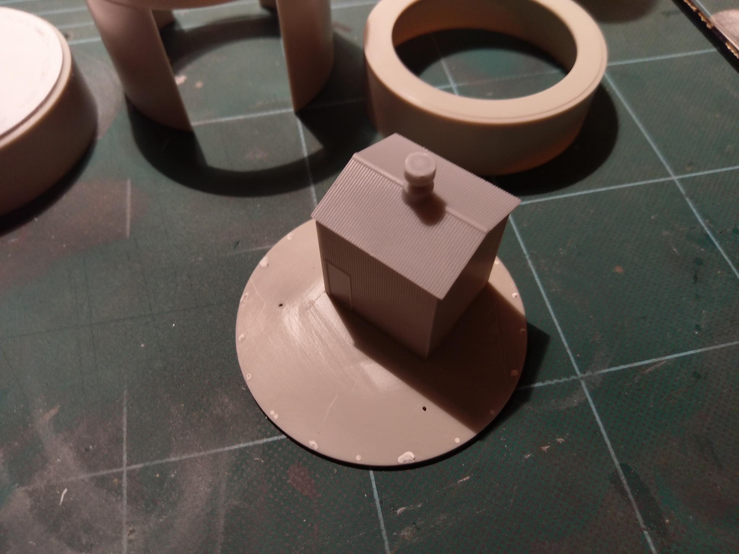

Think some super glue will sort that -just try and equal the gaps ! Next up was the roof section and loading hut -the supplied railings scaled out around 4" thick -so I've filled the holes with vallejo putty -sanded off and ordered some etched brass ones off scalelink !
The last bit -i've decided to add a loader chute inside -just because I think it would look good -watched some vids of loaders on you tube -looked at my coal railroading book again  - then cut a circle of 40 tho styrene and glued it to number 2 ring section -bought some rectangular section evergreen styrene from Preston on Saturday-plus some coppertube ,aluminium rod off the net -see if we can make something presentable ? Away on hols next week -so will be a couple of weeks before I'm posting again with the results !
