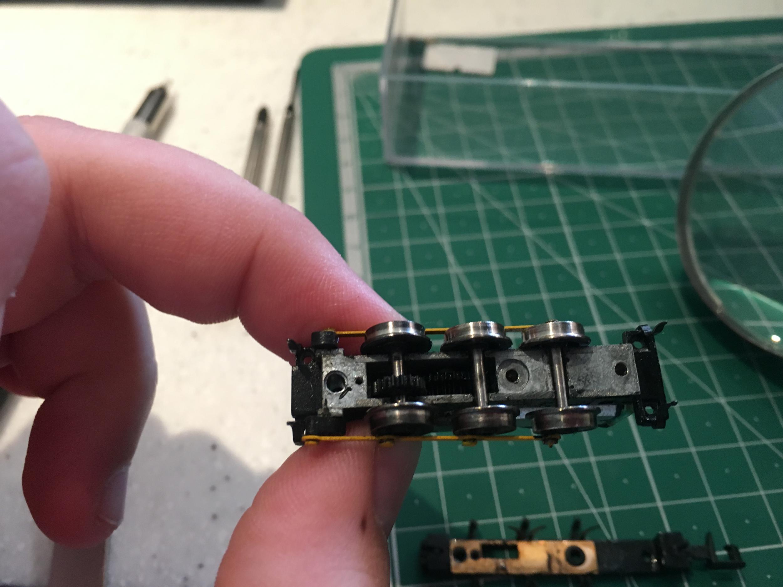

As thought, the model was swimming in oil! Because the loco had not been run, little oil had dried or burnt onto the pickups. However a clean was still required.
Upon removing the pickups, it was apparent that oil was everywhere. Whilst I could, and probably should have dismantled the gears I decided against it (I'd rather practice on a model I don't like before). The oil around the gears and chassis however was removed using the tissue and hard brushes.

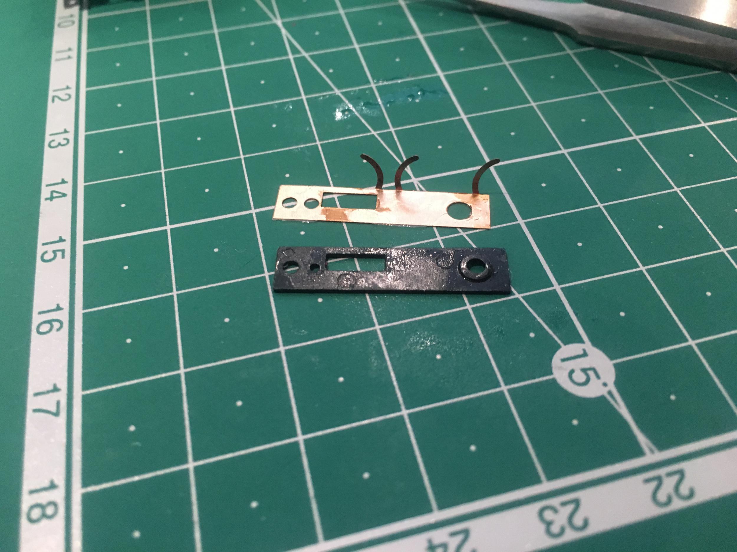

Back to the pickups:
As you can see, oil had even made its way between the plastic plate which sits in the middle of the pickup plates. Again an easy clean which could have become problematic if left.

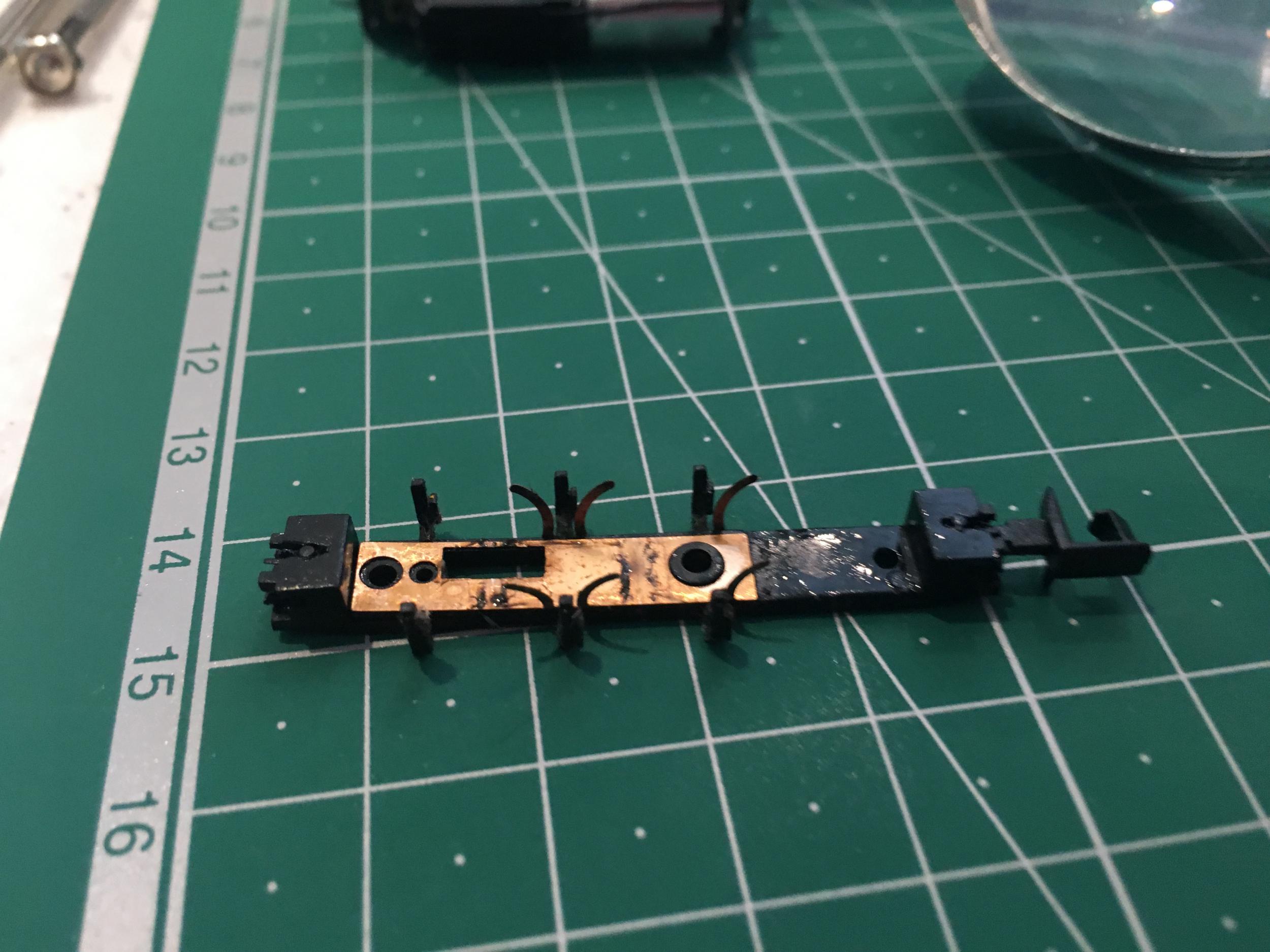

So you would assume that there couldn't be much more oil left right? Wrong, it was everywhere!

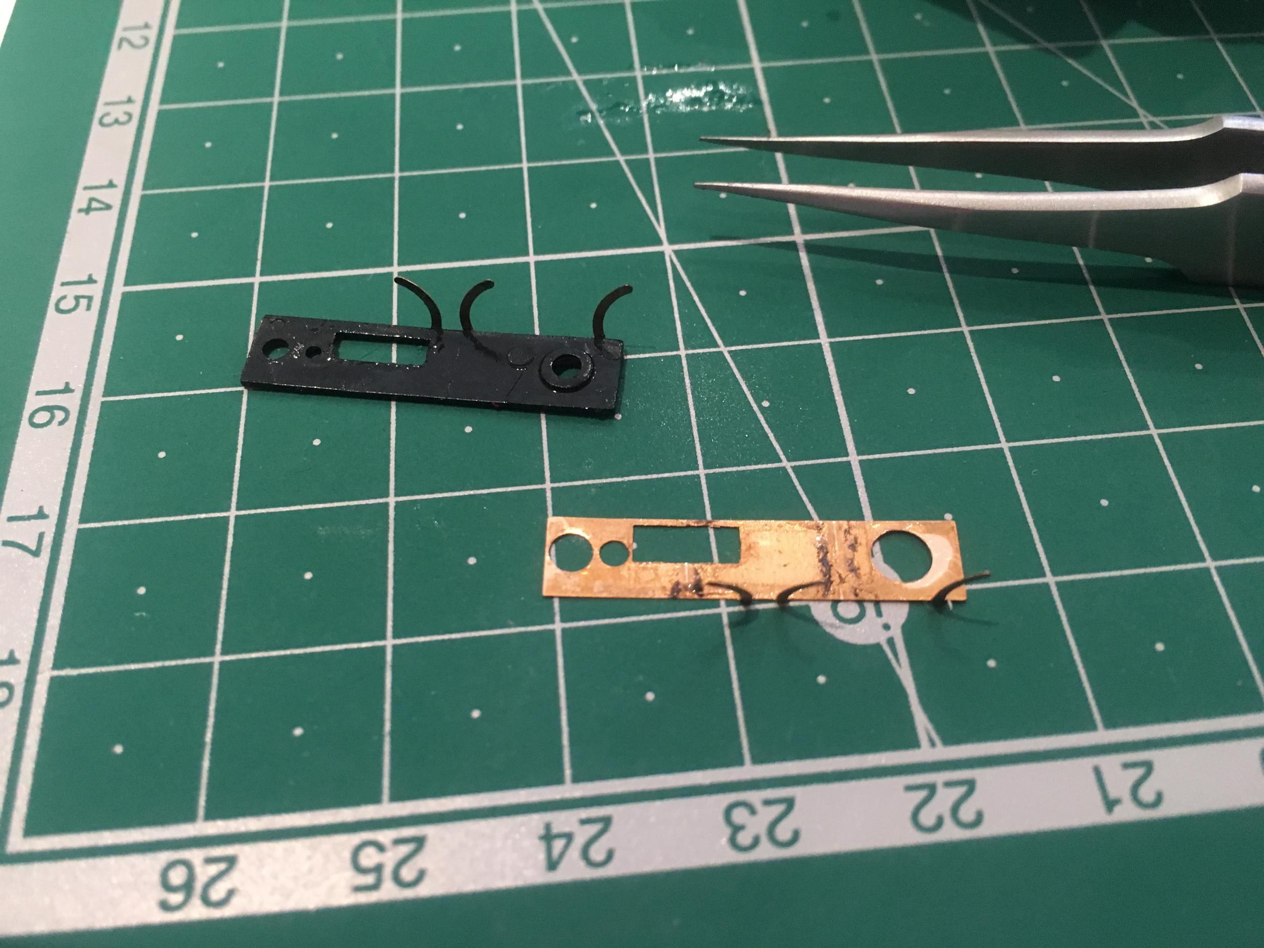

Again, the lower plate was covered and showed signs of burnt oil.
Apologies for forgetting to photograph this, but to remove the oil a tissue was used followed by the hard brushes to remove the dried/ burnt oil.

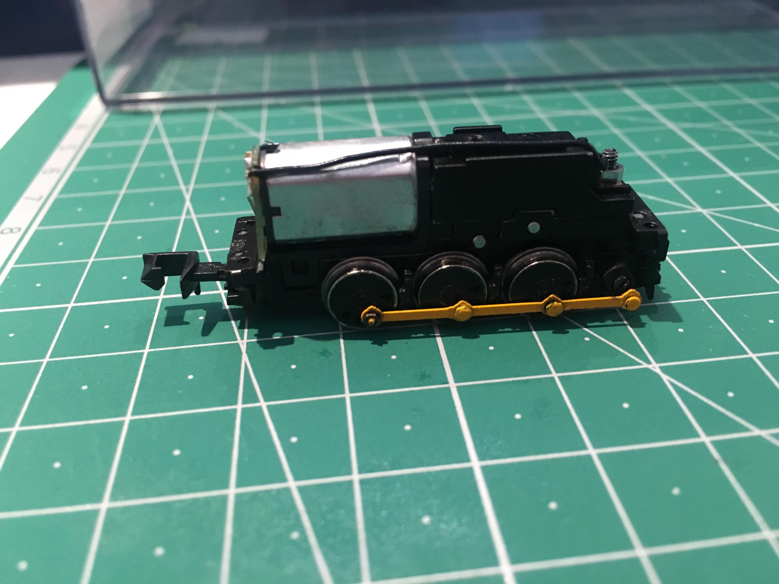

Once all the oil had been removed, the chassis was reassembled:
