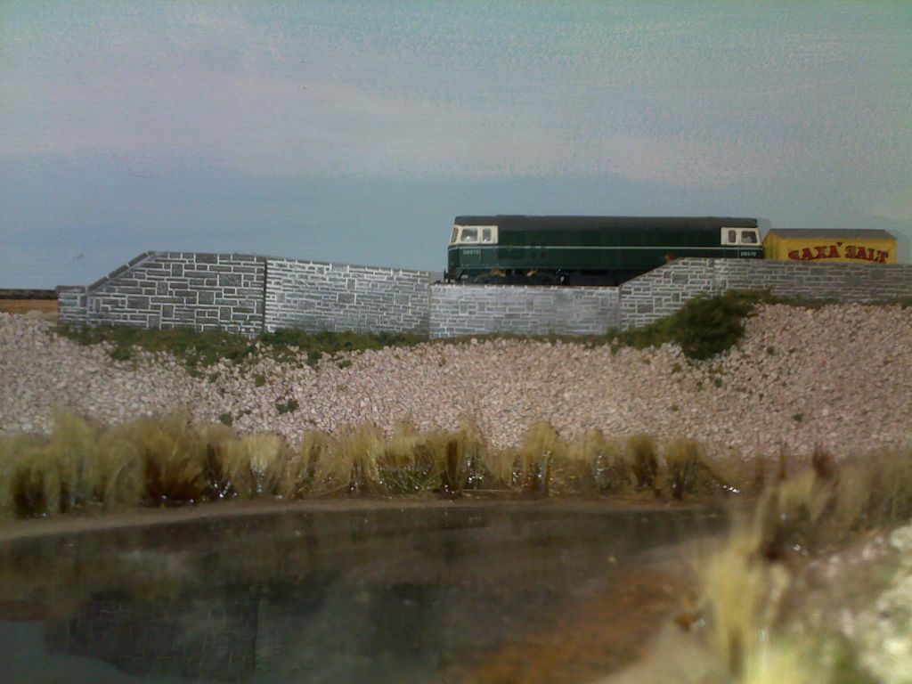

Back in the 70s and 80s I read of a technique in Model Railroader magazine which was very popular at the time. They actually suggested using a black river or lake bed!! This was then feathered up into earth colours near the banks, suggesting deep water in the middle.
The main premise behind this approach being that the colour of real water depends very much of the colour of the sky above. Once the water medium is poured or brushed on, it effectively produces a low grade mirror that reflects the sky backdrop and surrounding scenery.
I thought that made sense, and when I started my ancient layout, I adopted the technique. I painted the ply riverbed black and attempted to feather it up with earth colours to the banks. I used a brush for this, but in hindsight an airbrush would have been better.
I then applied coat after coat of gloss varnish (don't forget, at this point in history the Woodlands Scenic range was no where near the size it is now, and their water products were only just being introduced).
I always intended to add more layers of varnish, but the layout was neglected for a long time and that never got done. Just how effective this is is a matter of opinion.... I'm not 100% happy with it, but it has received the odd favourable comment over the years.
Here is a not very good photo of one of the as yet incomplete water areas of my layout. I certainly should have dusted the water before I took the picture!! I'll let you be the judge. If I was starting over, I'd probably go down a route similar to Webbo.
