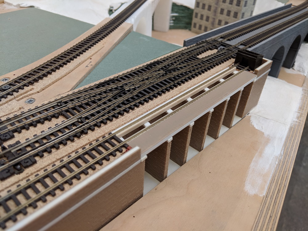

Then, it struck me; the sticking point would be the scissor crossing. In order to fit the servos & mechanism under it, I need to stick it down. In order to stick it down, I need to permanently fix the viaduct in place. In order to do that, I need to paint it. The viaduct and coal drops, whilst separate at the moment, would have been built together, and I want the finish to match, meaning the coal drops need painting at the same time. But I can't paint those until I put all the details on them...
So, in order to complete the electrics, I set about detailing the coal drops!
Here's how they have been ever since I started:

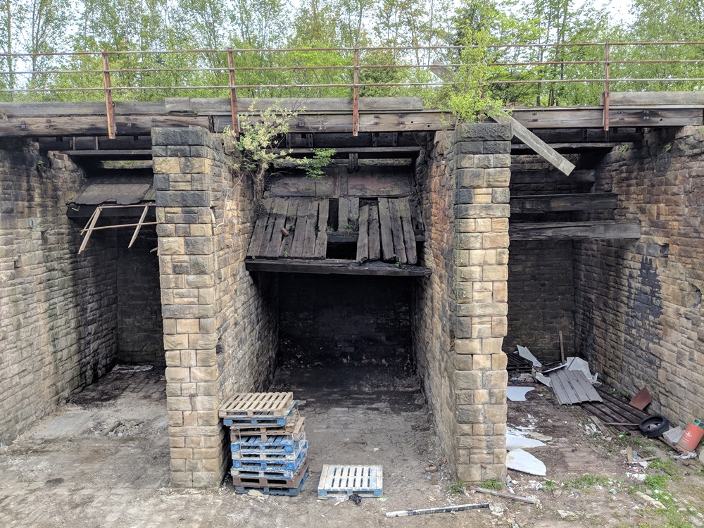

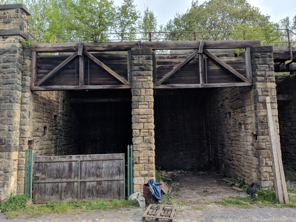

I had taken some pictures of the coal drops in Sowerby Bridge just a couple of days before, so used them as a bit of inspiration:

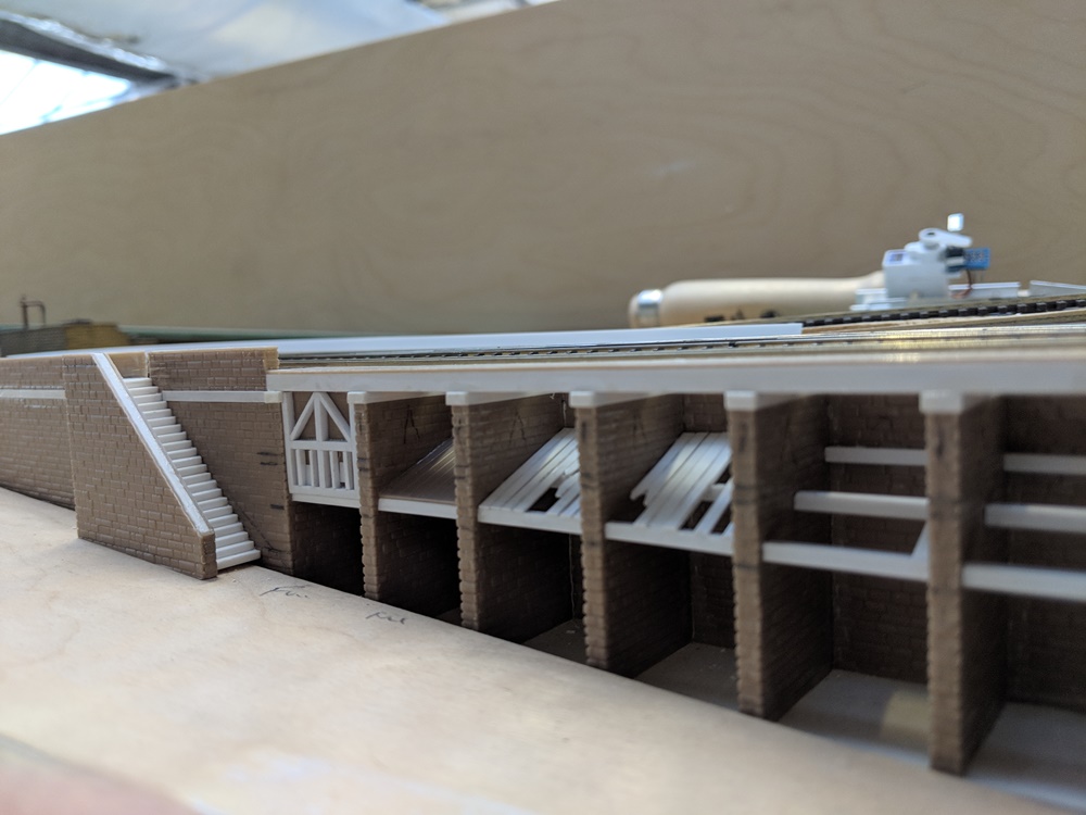

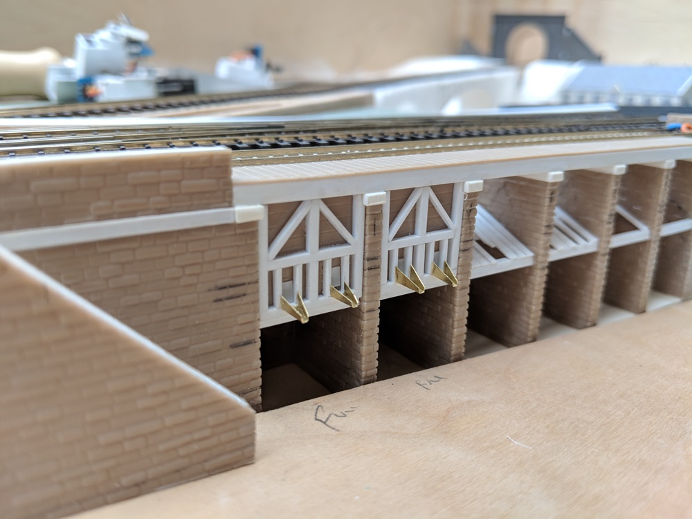

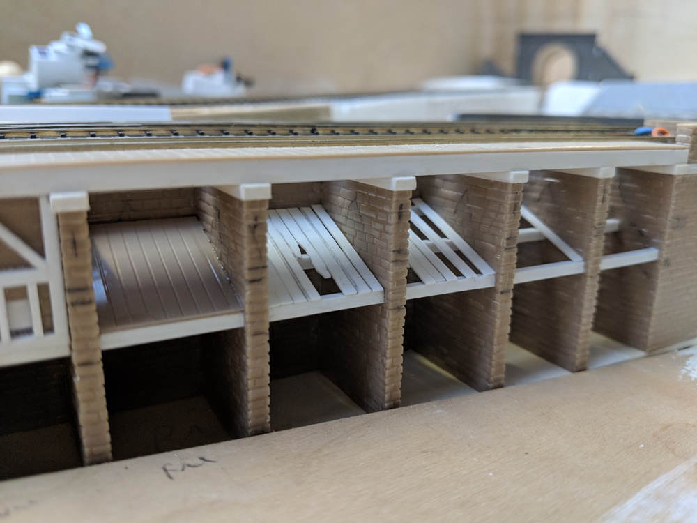

I decided I wanted just the 2 cells on the left to be still in use, with the other 4 in various states of disrepair. Using the above pictures as a guide, I constructed some innards using plastic strip:

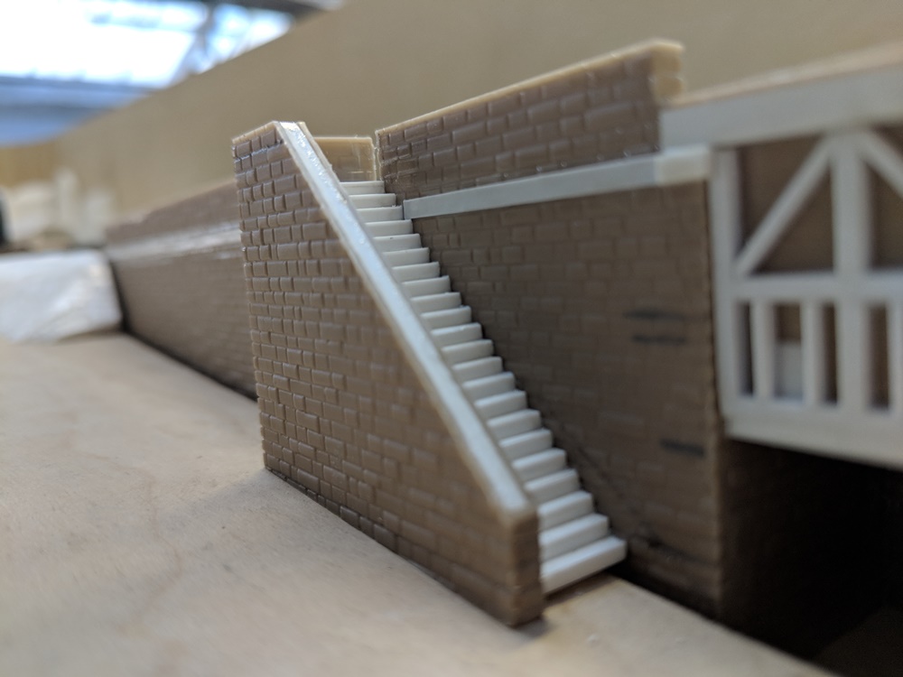

I realised that it was a long walk for the coalman from the wagon at the top down to the bottom, so I cut a gap into the wall, and added some steps too:
Once the timberwork was done on the first 2 cells, I used some 5 thou brass to make up some chutes. They were just cut & bent up by eye, as you can tell by the fact that one of them is considerably bigger than the other 3, but I don't think it's a big enough issue to try to rework it:

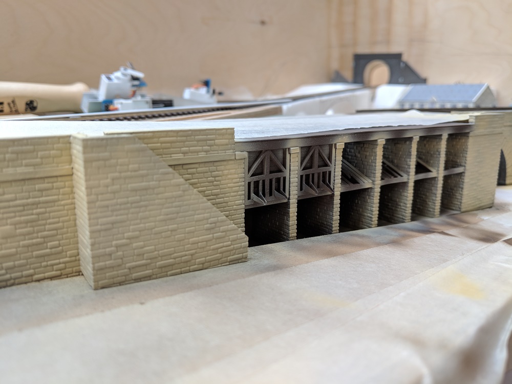

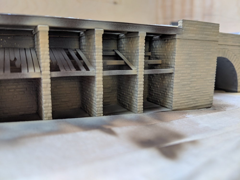

For the painting, I decided to airbrush them. I've been watching a lot of youtube videos recently of 1/35th scale armour builds, and wanted to try a similar technique, which is to spray a dark colour as a 'shadow coat', then just a thin top coat, allowing some of the darker colour to show through. This gives some nice variations of tone:
I'm not sure how much of this variation will show through once all the various washes/drybrushing has been done, but we'll see!

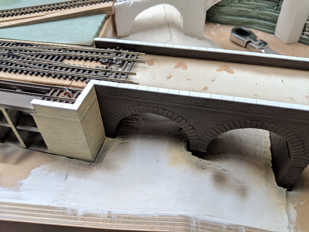

It was at this point that I noticed two things; firstly, the viaduct (which had been sprayed long, long ago with Halfords primer) seemed to be reacting in a strange way, and the paint took on a strange texture & wasn't adhering properly. Secondly, I'd got carried away with the painting process & forgotten to glue on the capping stones!
I removed the viaduct again, took off the cork trackbed, and washed it with a scouring pad. A scrubbing brush (or an old toothbrush) would have been better, but I didn't have either. This removed any contaminants that may have adhered in the last year or so, and some of the paint, so it was then sprayed with the dark brown again. Once that was dry, I added all the capping stones:
That's as far as I got, so next up I need to spray the cappings and put the lighter colour on the viaduct, then add washes & drybrushing to the whole lot, and detail paint the timber coal drop internals.
