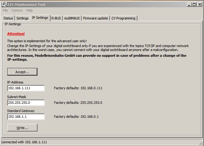

It is possible to use the Z21 with your existing router at home instead of using the Roco router.
It's not that difficult, even I did it :D.
The Z21 uses a fixed IP-adres (Factory default is 192.168.0.111).
This adres doesn't fit in the IP-range of most routers.
My router is set with IP adresses from 192.168.1.1 to 192.168.1.199
Only thing you have to do is to figure out the IP range in your router and change the Z21's IP-adres to fit in that range.
To change the IP adres you have to download the Z21 maintenance tool and intall this on a PC (I'm afraid there's still no Mac version :worried:).
http://www.z21.eu/content/download/1634/17992/file/Z21_Maintenance.zip
First connect your pc with a lan cable to the Roco router and run the maintenace tool.
Then connect to the Z21 by using the default IP adres (192.168.0.111) and go to this page.
Here you can see I just changed the 0 in the IP adres and gateway into a 1.
Once you pressed the write button you won't be able to connect again with the PC because now the Roco router can't "see" the Z21 anymore.
Now disconnect the Z21 and pc from the Roco router and connect it with a Lan cable to your home router and now you can use your own WiFi network to operate the Z21 without the original router.
Don't forget to change the IP adres in the Z21 app on your phone/tablet.
