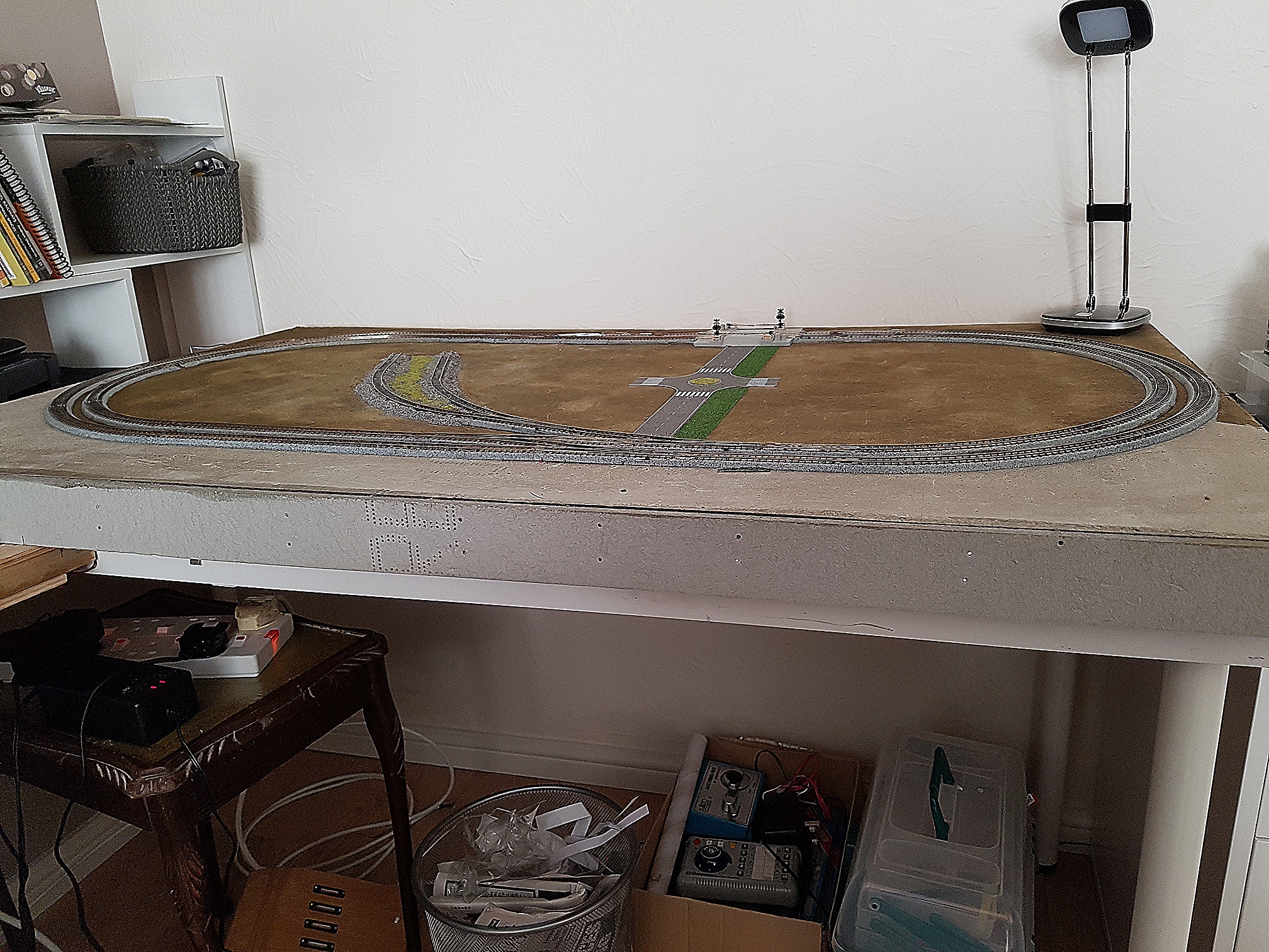

Hi,
I have used IKEA tables in building my layout.
I am new to the hobby and thought the IKEA range of table would provide a good base, and allow
later expansion with  compatible products.

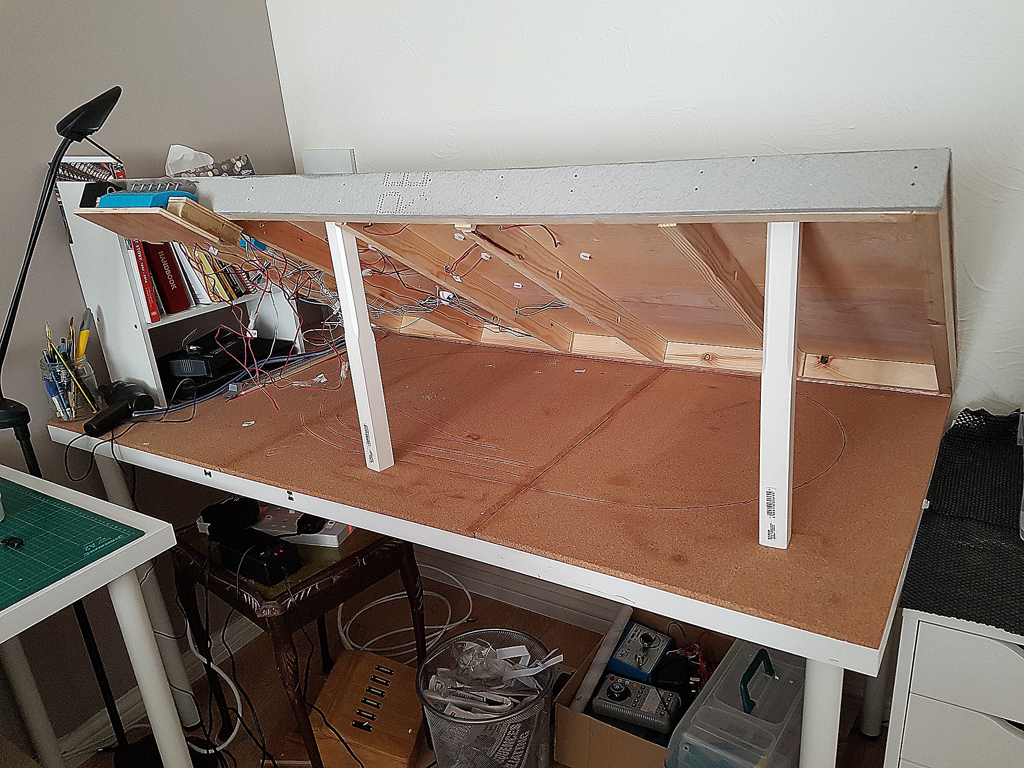

I purchased an IKEA Linnmon 1500 x 750 Table top with suitable legs.
My first attempt at a layout, was to top this with cork before laying the track.
But, I too worried about running the cables underneath.
So, I built a classic baseboard to fit, a sheet of ply and Sundeala on the top.
I hinged it at the back of the table to give me flexibility and access to the wiring.

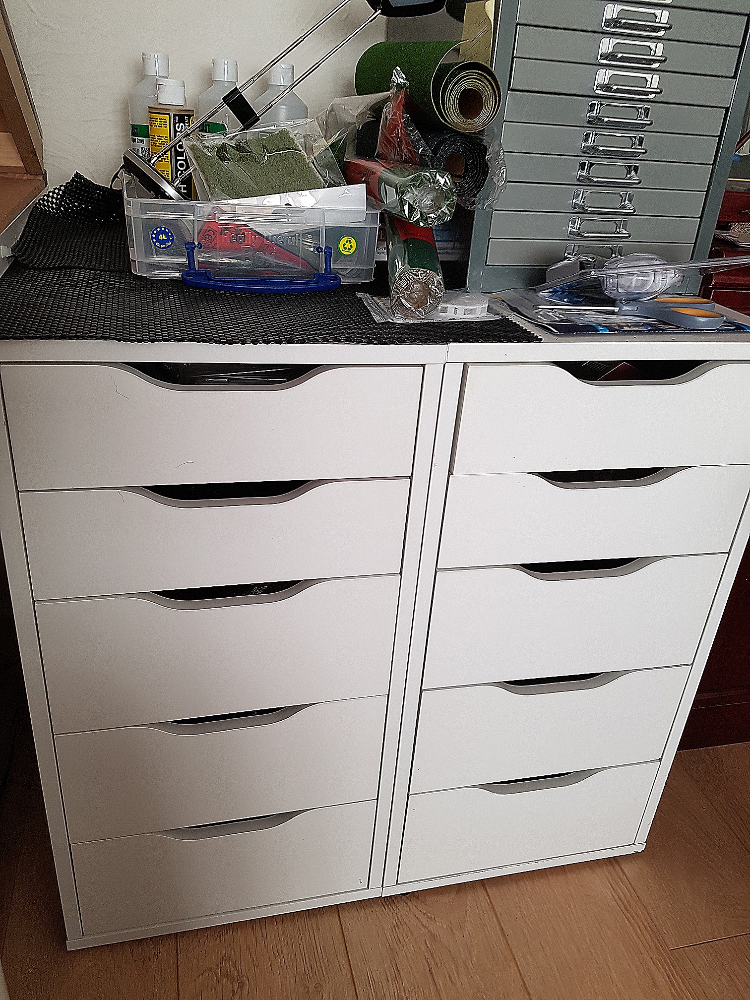

I have also found the IKEA Drawer units to be very good for storage.
HTH
Ken
