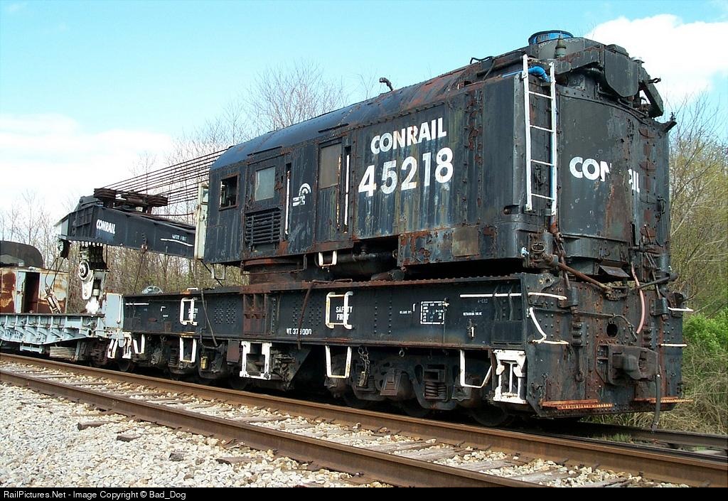

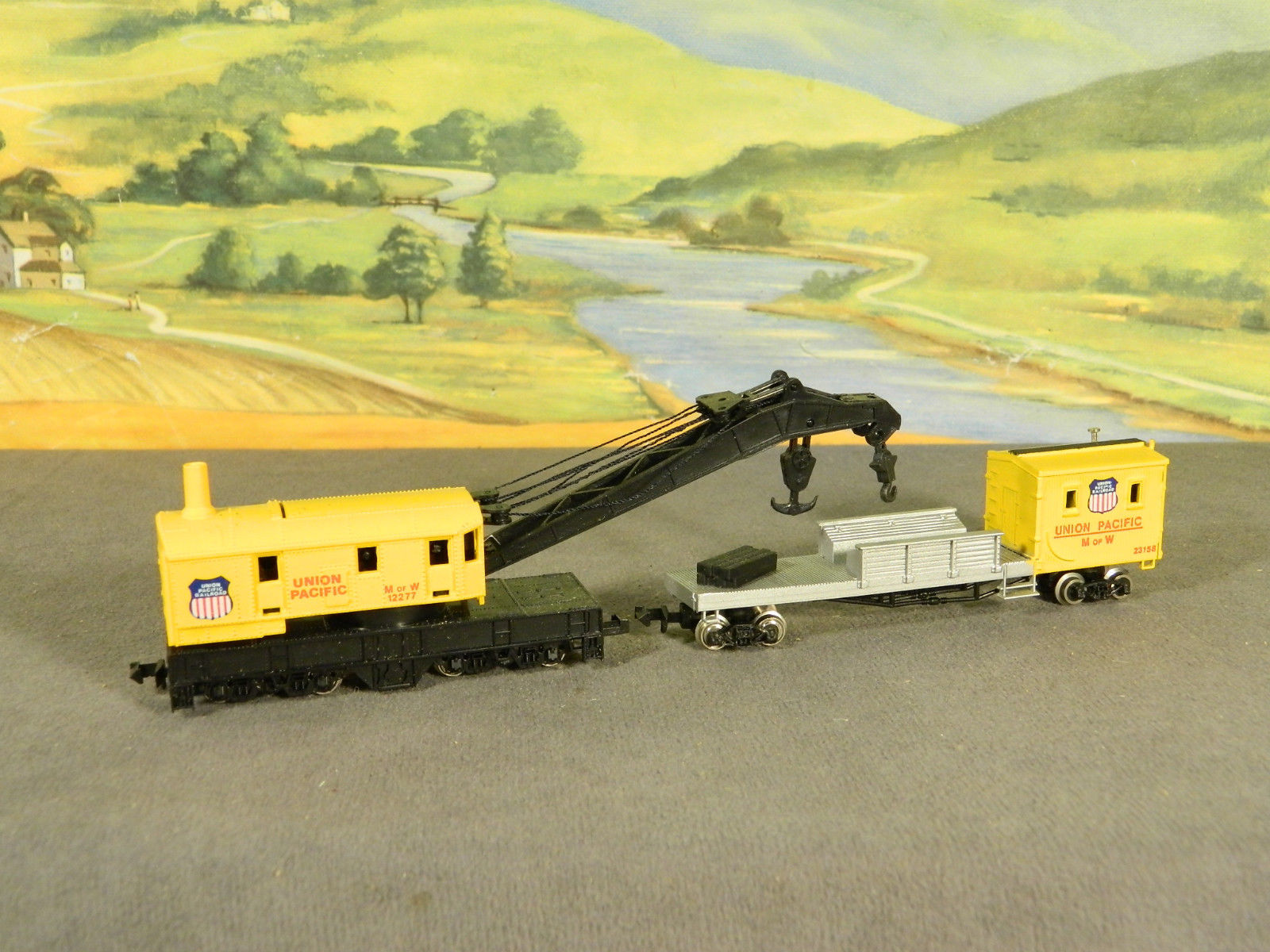

Hi WWDS, the first problem you run into is the two different modeling scales being used. The Bachmann model is 1:160 while the Graham Farish model is 1:148. Although they both run on 9mm track they are two different modeling scales. Now you would think being the Graham Farish model is a larger scale than the Bachmann model, it should fit right in, the second problem is British rolling stock and locomotives tend to be smaller in size than their American counter parts. Just compare a BR Standard Class 4 to a Pennsylvania Railroad K-4 Pacific.
The Standard Class 4
Length   60 ft 0 in (18.29 m)
Width   8 ft 9 1⁄2 in (2.68 m)
Height   13 ft 0 in (3.96 m)
PRR K4
Length   83 ft 6 in (25.5 m)
Width       10 ft 0 in.
Height      15 ft 0 in.
To my eye, the Bachmann 250 ton crane is a pretty close representation of a 250 ton rail crane.
But the model maybe larger than railway cranes used in the UK.
