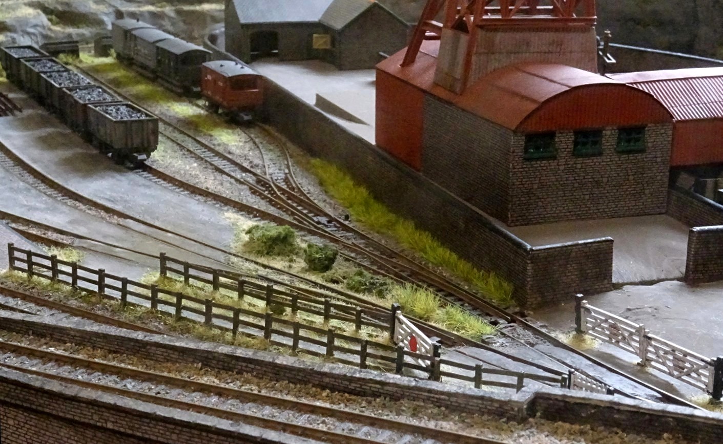

The main change to the mine is the erection of a stone-built boundary/retaining wall, typical of Victorian institutions, including my primary school, which gave me the idea. (Most of them, come to think about it!)
Doubtless there are many proprietary products that would have suited, but TBH I'm in this hobby to make stuff, not to go shopping. A tangled wooden Venetian blind lay beyond use in a corner of my garage (you know, could be useful one day, spares etc....) and a couple of its slats (strong, flexible, right profile, right width and a useful length) were pressed into service.
To get the very tight curve at one end of the site, I bent a slat as far as it would go, then Duck Taped the ends and let it soak in a sink overnight. The next day it bent further, was soaked again and the third day it was ready.
There are a couple of right-angle corners, which were mitre-cut and joined with Gorilla Glue. A couple of end-end joints were glued and reinforced with some overlapping buttresses.
I covered the assembled wall with Metcalfe stone paper, ran a Sharpie along the top to simulate moulded iron-slag coping stones, then stained with Games Workshop Earth Brown wash. The completed wall was Gorilla'd to the MDF base board, a trench being cut into any existing relief that lay in its way.

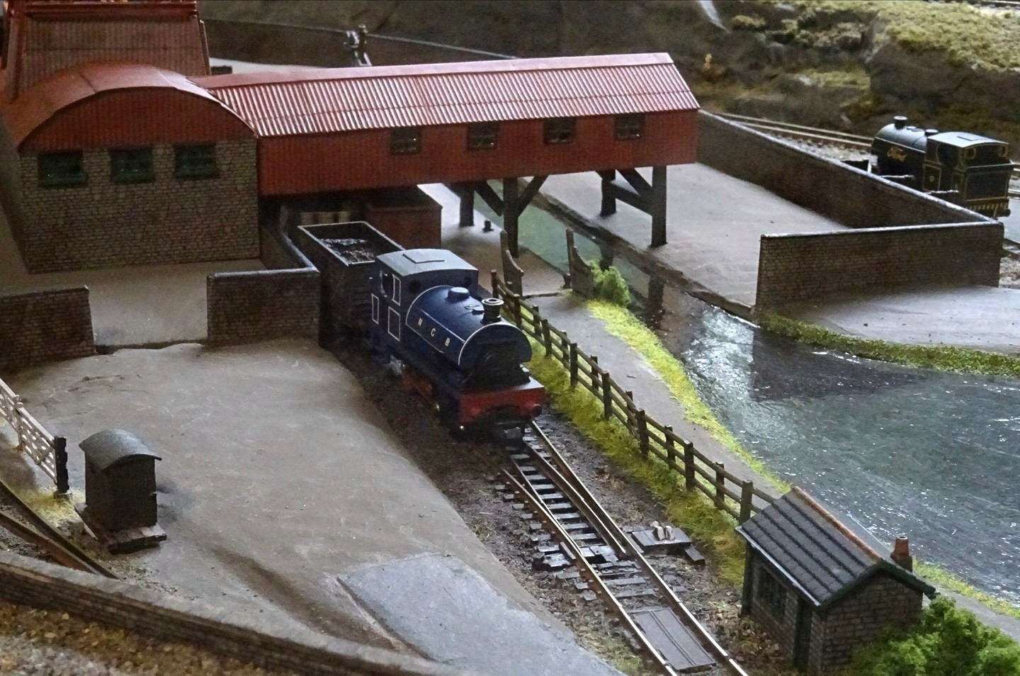

The walled area beyond the canal will become the spoil heap. I've taken the vegetation down to water level. [Masked the water surface, glued the banks and used a pipette to puff Peco green scatter onto the glue]. There's some (barbeque) ash dumped next to the coaling stage.
First movement of the day as 1455 draws wagons under the screens for loading:
The access road to the pit needs developing and some wooden gates installing.
The boundary wall runs straight along the edge of the mine site, then loops around the blacksmith's workshop/stable and back to the loco coaling point. A second retaining wall runs under the screens and turns to end at the main gate.
The grass against the wall is Javis JSTRIP6. Although I mostly use a puffer bottle with loose static grass, these are useful when you need a well developed area in one go. To ensure the tallest, upright blades hug the wall, cut the strip up the middle (no need to cut precisely straight) and place the cut edge along the wall.
It's 6mm grass, which doesn't always suit, but I read on here somewhere that beard-trimmers work on this stuff, and they do, so if you want some stubble instead, go mow the meadow!

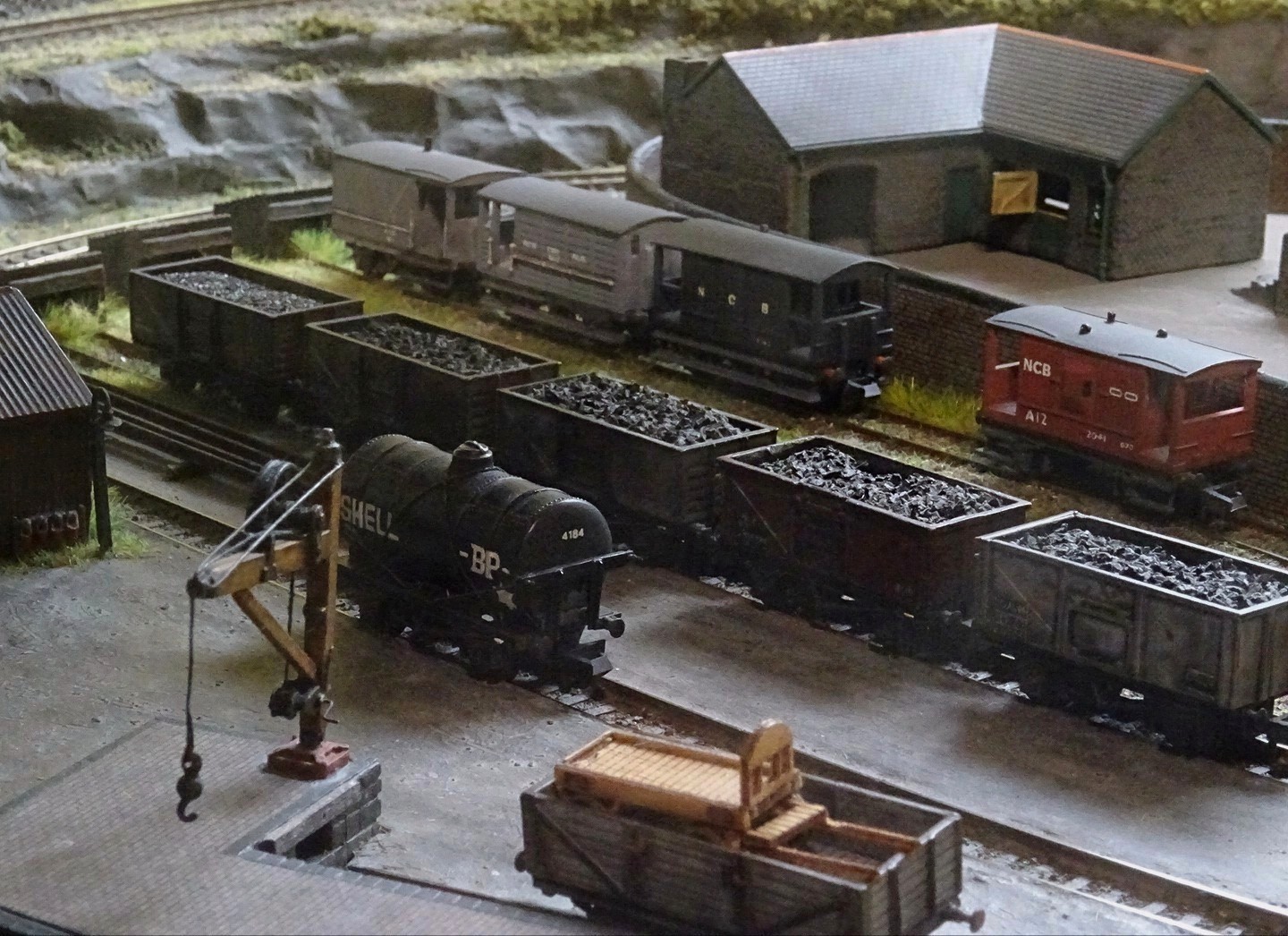

It's pretty quiet, as usual, in the goods yard:
No horses being currently available, the Ancorton cart has been craned into an elderly wagon for transfer to the nearby Lessys Mor mine. A 14 ton tank of lubricating oil sits ready to dispense. A short rake of coal awaits transfer to a processing plant, which because of challenging gradients will require an NCB brake van or two.
Oh yes, the wall. You can see how tightly it curves around the back of the smithy.
