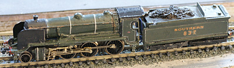

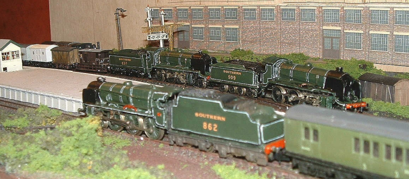

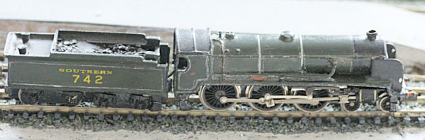

Southern  1930s, only two 4-6-0 kits, (BHE N15, Langley S15 both being Urie versions) no RTR; SR had 5 classes of 4-6-0, two of those classes (N15 and S15) had 2 types of cab roof and 6 wheel or  2 types of 8 wheel tenders "luckily" the tenders of the 2 kits are the 2 types of 8 wheelers, so "mix'n match"; cab roofs are fairly easy to hack. The H15 class differed from the N15 & S15 mainly in driving wheel diameter so find  a suitable chassis.
The other 4-6-0 I've managed to produce is the Nelson, it involves hacking a Peco Jubilee or Farish Scot, firebox needs reshaping and 8 wheel tender, for 1930s the BHE N15 tender will suit, from about 1938/9 a high sided tender has to be built, one of the class had a 6 wheel tender, 862 had a Kylchap double chimney, 1940s on most had a LeMaitre chimney.

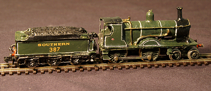

The Union Mills T9 represents the "300 series" with 6 wheel tender, wide cab and wide splashers, the remainder of the class had a narrower cab and splashers and 8 wheel "watercart" tender which is the same as the Langley S15 kit, apart from filing or milling a few thou off the cab sides and splashers, it is also necessary to add pick ups on the loco for power to the tender. Union Mills also do the class 0395 and 700 o-6-0s

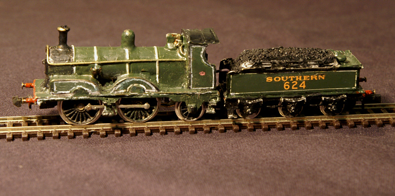

I have scratch built an Adams "Jubilee" A12 class 0-4-2 and a Drummond K10 4-4-0
A few examples
