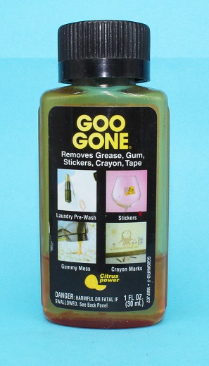

I have always used Goo Gone for removing glue residue.  As far as I know (and I don't know that much) it does not affect plastic or paintwork.  I think it is also available in the UK.  It is available in different size containers but the photo shows a small 1 fl oz bottle.
Ian

Quote from: Bealman on February 28, 2025, 10:45:37 PMThe stuff in the bottle looks pretty gooey itself!
I agree!  I have probably had this bottle for twenty years and I just keep topping it up from a larger container because the small bottle fits neatly on my workbench.  I never noticed the grunge in the bottom, but the stuff still works.
Ian
