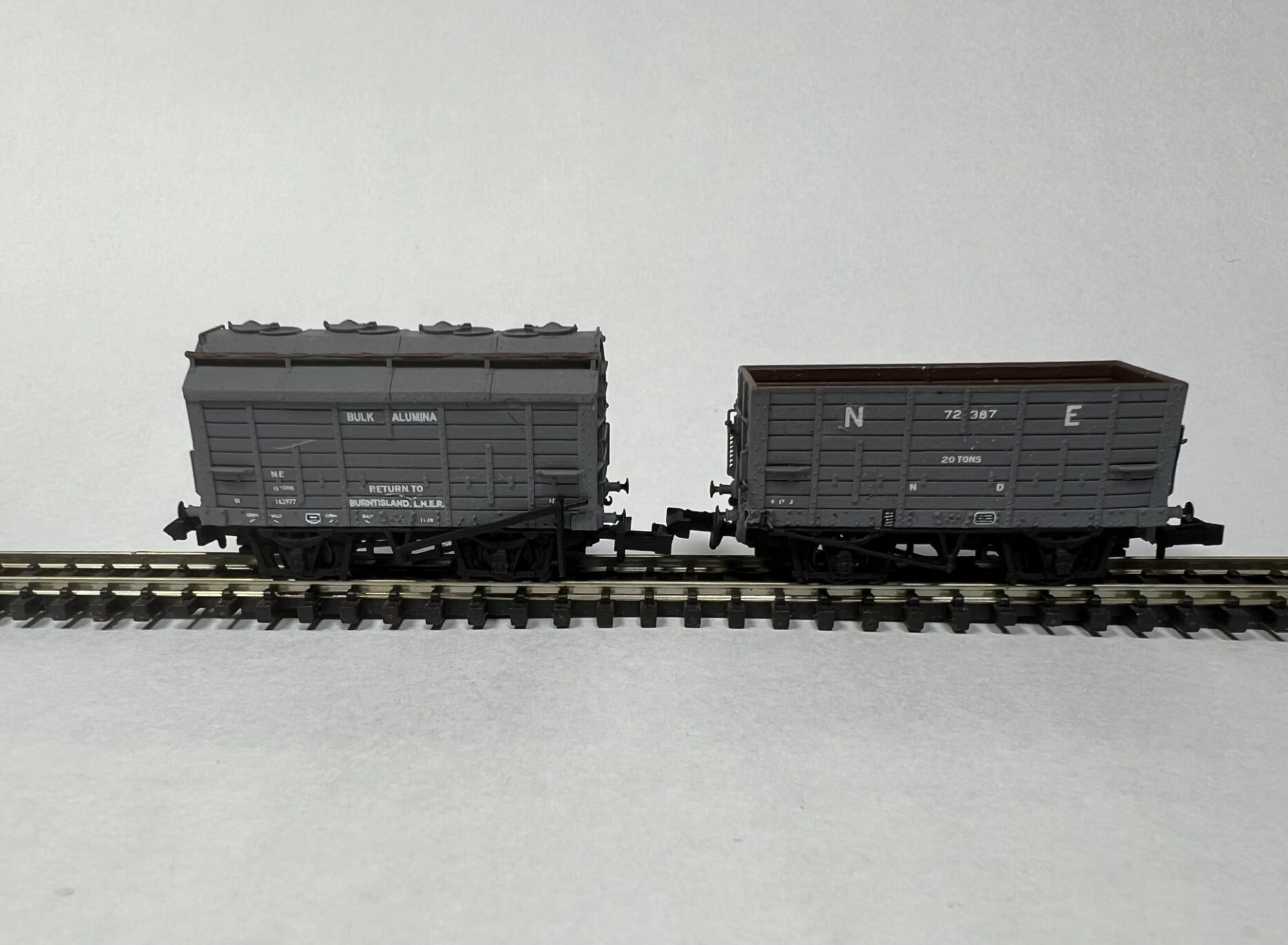

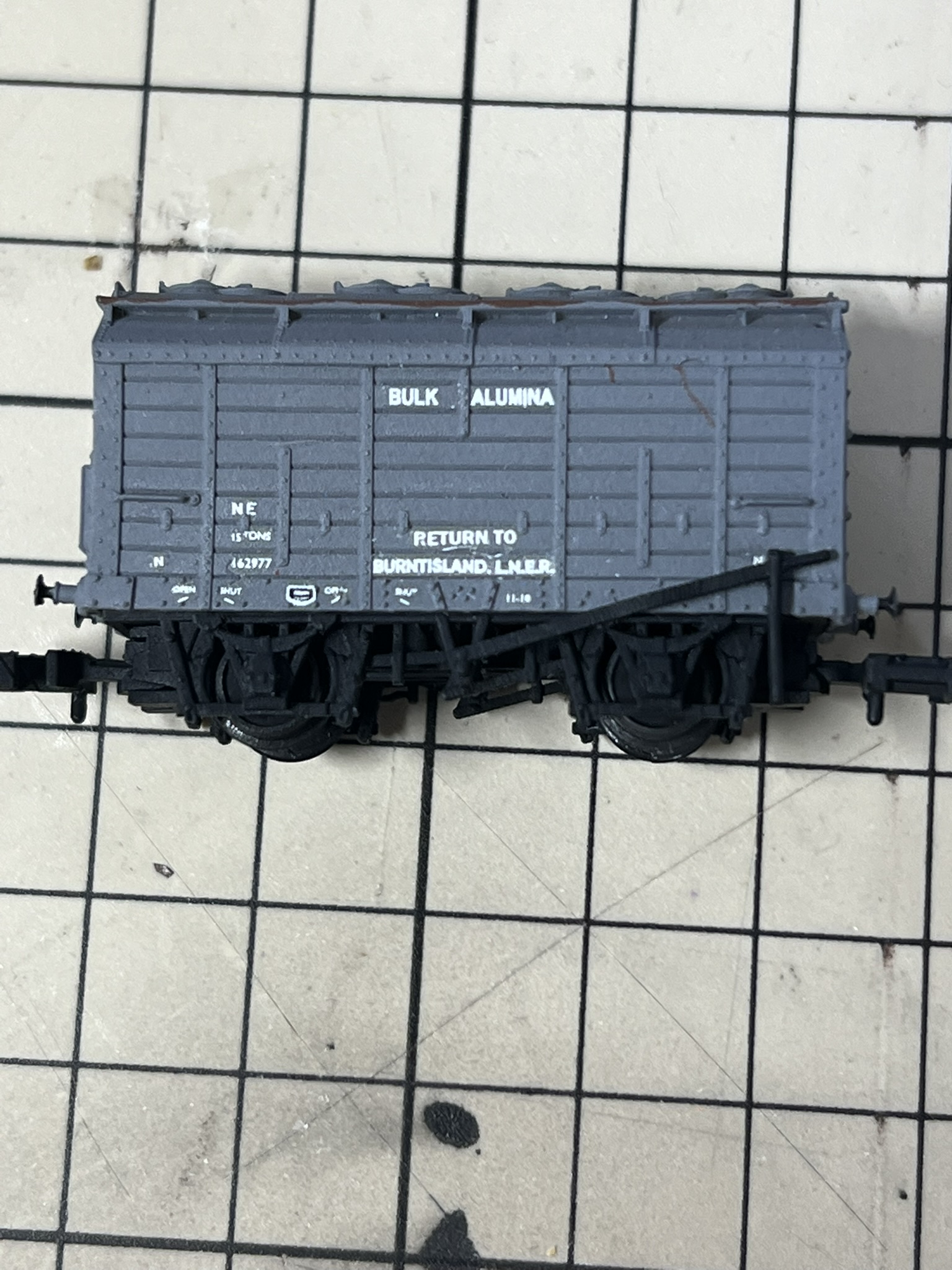

Both the P6 and the Alumina mix Fox, old NGS(Modelmaster) and Coventry Railworks(Railtec type).The following 4 pics were all taken before the final varnish coat.

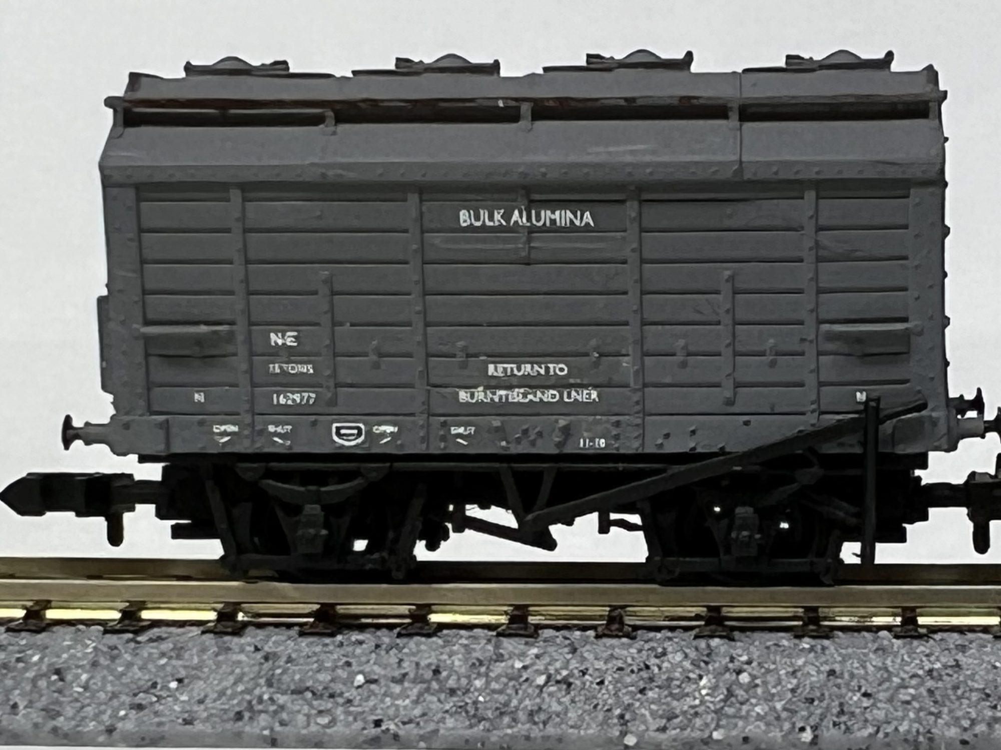

This shows a problem on the Alumina ( to match a prototype photo I replaced "Empty To" from Empty to Burntisland with a "Return To" form a Return to East London which involved cutting through a transfer) and need to improve my technique ( another forum member suggested I use a razor blade next time ).However the final varnish almost completely fixed that.

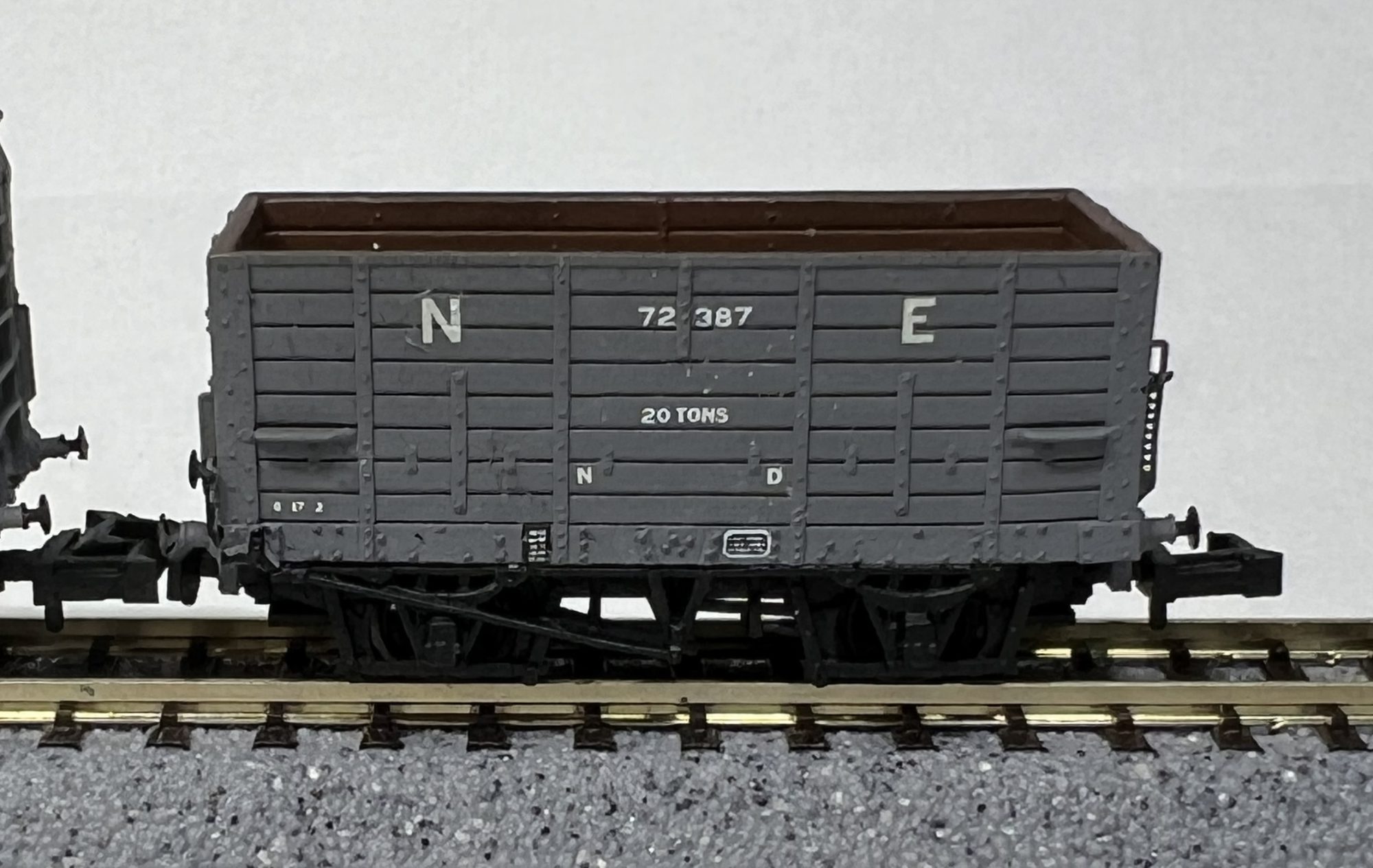

This is the P6 close up

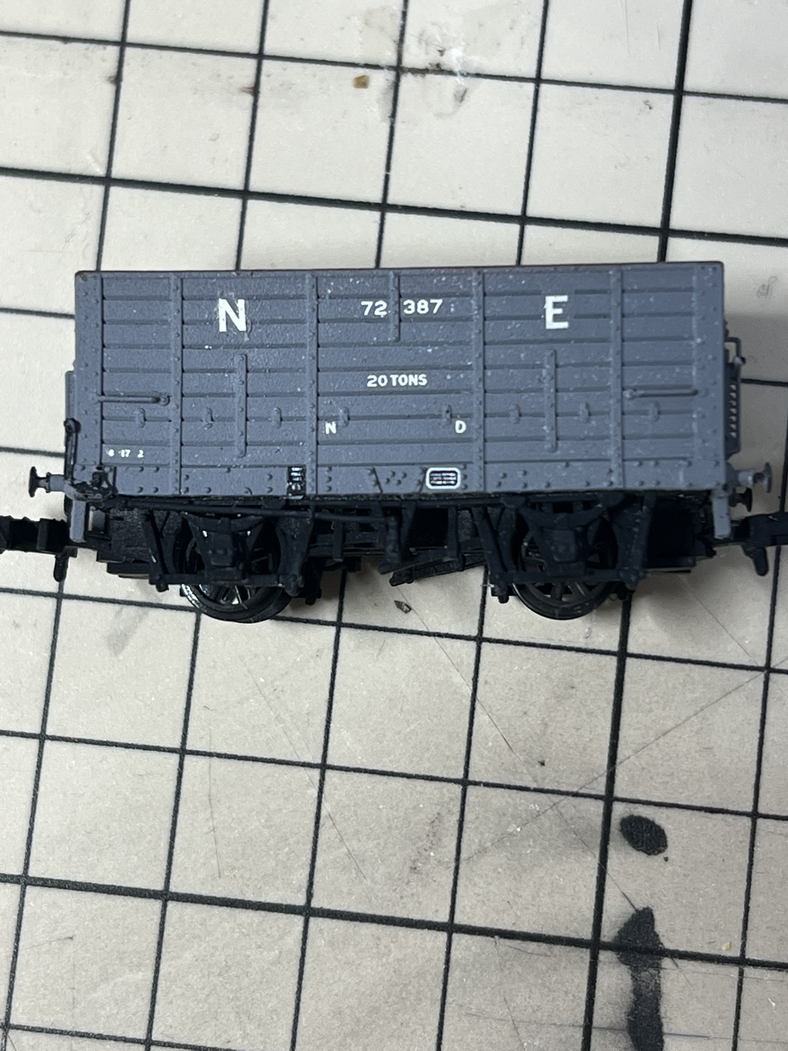

However you can see an issue which is highlighted even more on this next shot. Fox, unlike, say Railtec, is not "spot printed" ( is that the correct term?) and so I am left with film surround rising up ("silvering") because I did not gloss in this case and despite using the Softer.

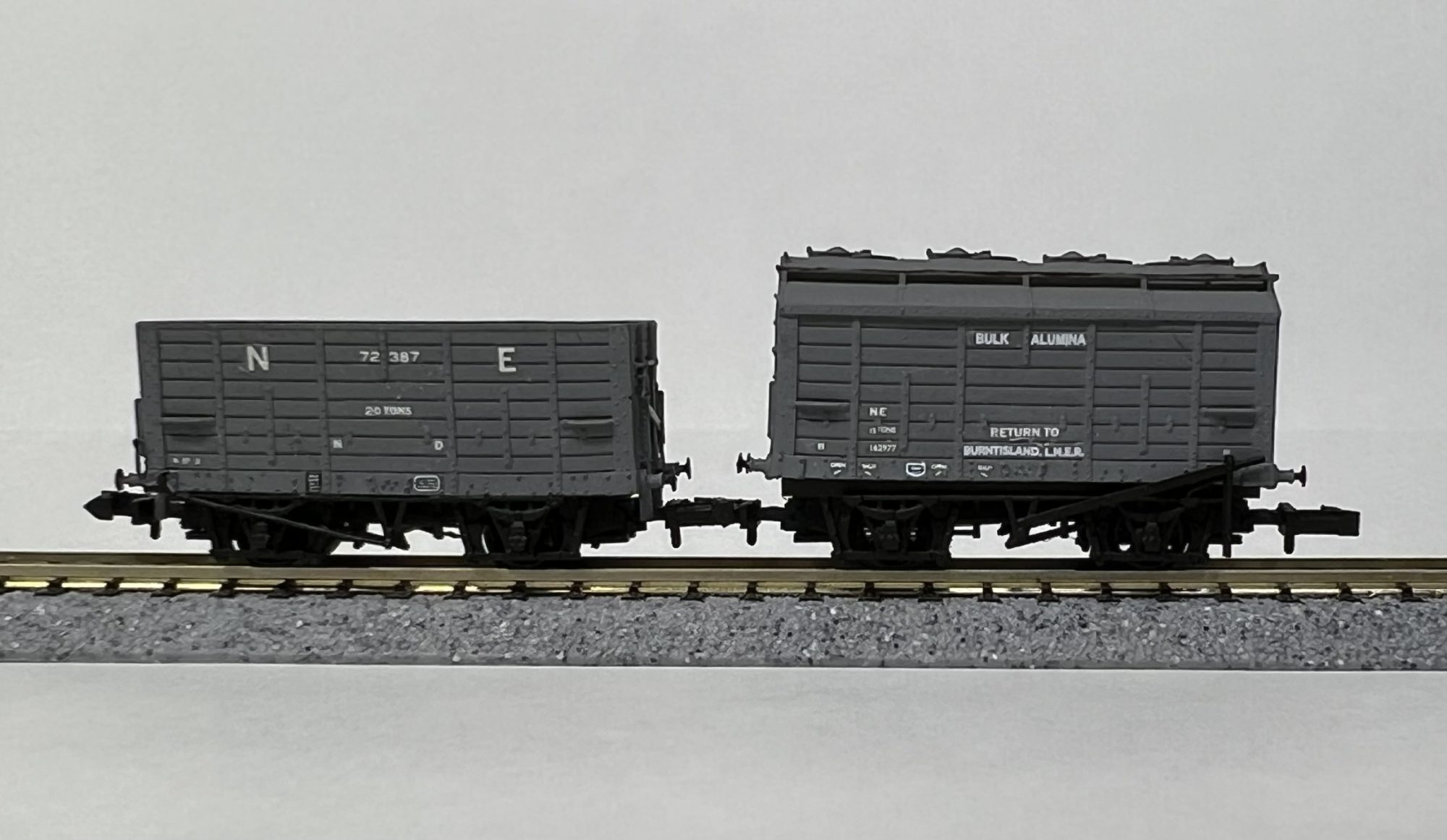

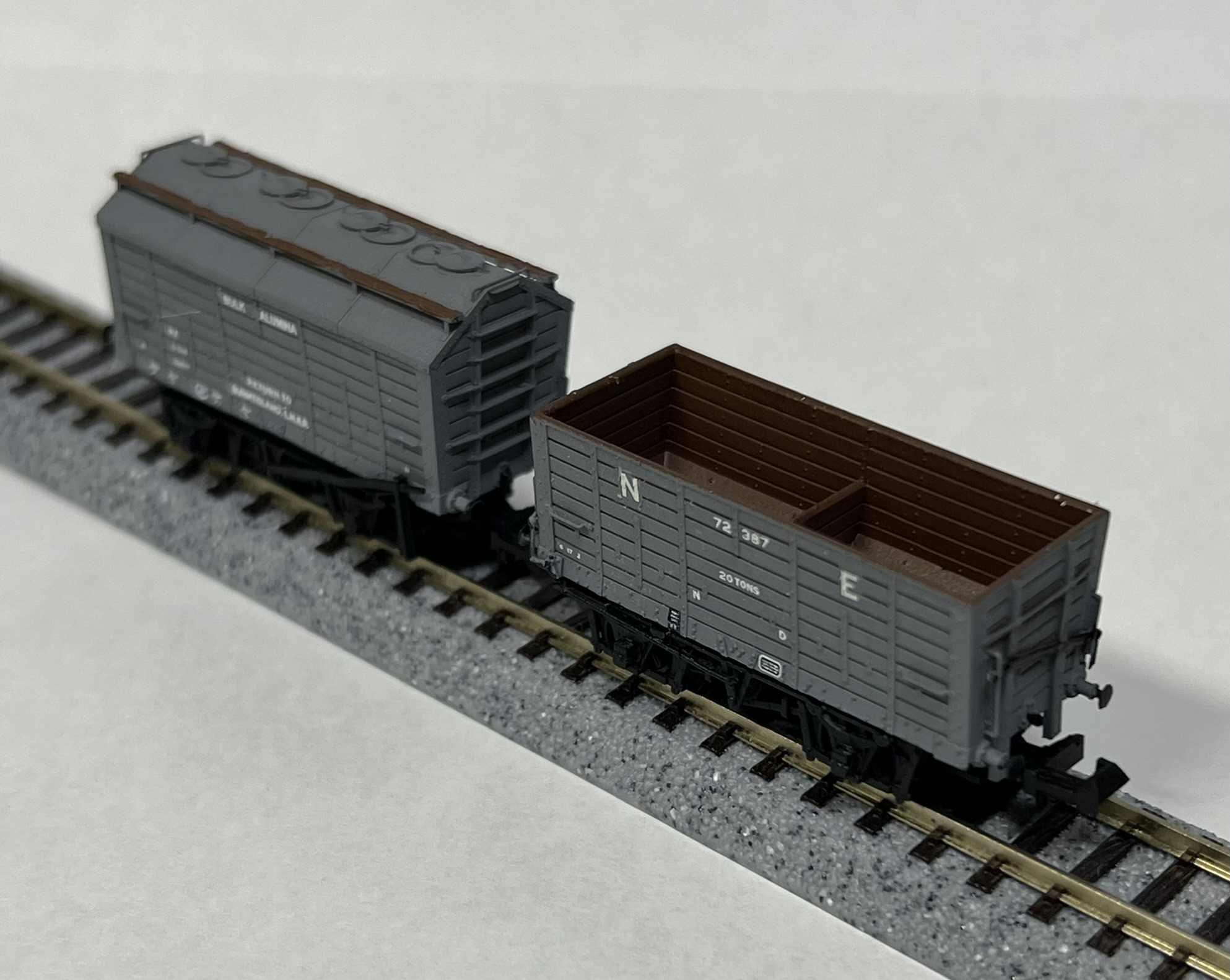

Now applying the varnish coat and you can see the final result clearing up most of the defects.
One problem I have just spotted is some of the white spotting one can get from matt varnish even when lightly applied... However, finally, from "normal viewing distance" I think they look OK. Although there is still a tiny bit of defect under that N and due to the "Return to" cut.
And I just noticed how skewed the Northern Division "N" is. On which subject I have actually just ordered some small letters from Fox to enable me to provide wagons from the Southern and Central Divisions of the NER.

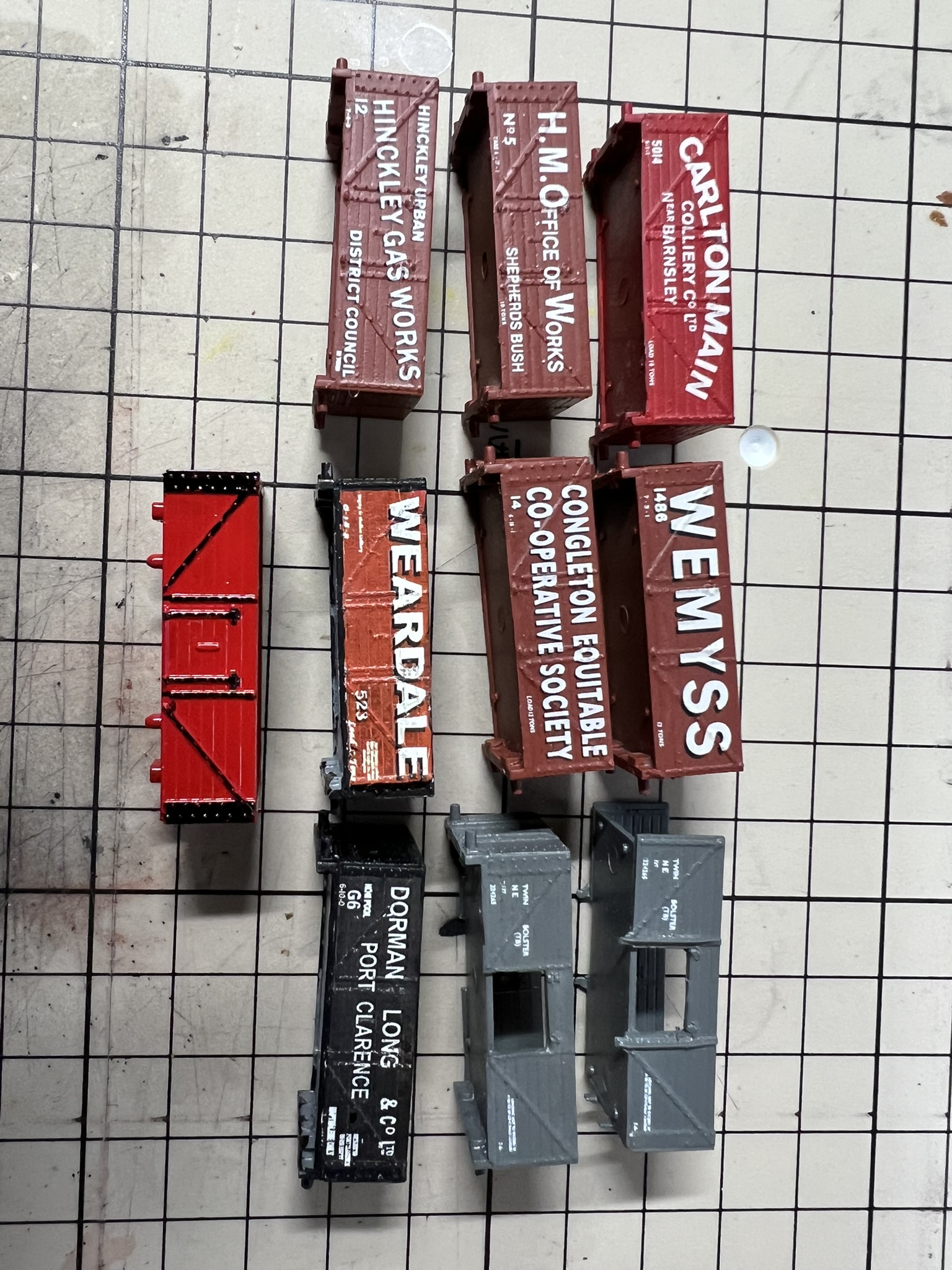

Going back to the above - use of gloss paint for the base layer - it really is worth following that recommendation.
For example this batch that I have been working on the last few days was much easier using gloss.
Based the NGS RCH Kit:
* Carlton, Hinckley, Wemyss, Congleton and HM Office of Works are all old NGS (ex-Modelmaster ) sheets.
* Dorman Long and Weardale are Robbie Burns' ( which are a different technique where the white is achieved with a transparent transfer on a white background ).
Then two LNER wagons with doors removed are the beginnings of a pair of LNER "High Sided Twin Bolsters" which were introduced as an emergency wartime measure (Hytwins under BR) - these are end door wagons with end doors, and generally side doors, removed and bolsters added. In this case an LNER mineral and an RCH for the base a (although there were a number of other combinations produced). Fox produce a set of transfers for these that match the lettering variants on pages 239 and 240 of Taplow LNER Wagons Vol4B.
Finally I am trying something new with a PECO 10ft mineral wagon - picked up an extra fine tip marker and a super fine tip brush pen that are produced under the Mr Hobby Brand for Gundam kit builders. Makes painting the ironwork much easier. Next task is transfers on this.
BTW - all these are currently on their first side having been just varnished except the red one with iron work. Next step after the red one is the other side.
