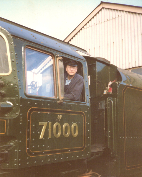

Hailstone
when the Duke came to Didcot, it was to enable it to be tested by BR as it was the first Caprotti locomotive on BR metals since the end of steam. it is many years since this happened so please excuse my inability to remember which year the following happened. the Duke was to do a loaded test of I believe 10 coaches plus the ex Western Region Hawksworth dynamometer car the the Duke group owned, to run between Derby and Sheffield (to this day I cannot remember which direction!) the net result of this was that the Duke managed this in a time that was only 5 minutes outside HST timings for that route! the chief engineer at the time Gary Shannon later asked me on a day that I was driving it at Didcot to run the water down to one third of a glass but keep as much pressure as possible after coming off the demonstration line so that he could test the rate that the injectors were working at, as it seemed that on the test run it was getting through a lot of water, and both injectors had needed to be employed to maintain the water level. I cannot remember now what was decided, but they were thinking of increasing the cone size on one of the injectors.
the picture below is a very happy Hailstone about to leave that shed
Despite being labelled a Western man, I love Standards!

@Hailstone
That was an honour, and it must have been a fantastic experience.
The RCTS history says that (BR trials post preservation) 'trials....showed that the steaming performance performance of the engine had been so improved that the injectors could not keep pace.....these have subsequently been uprated'
