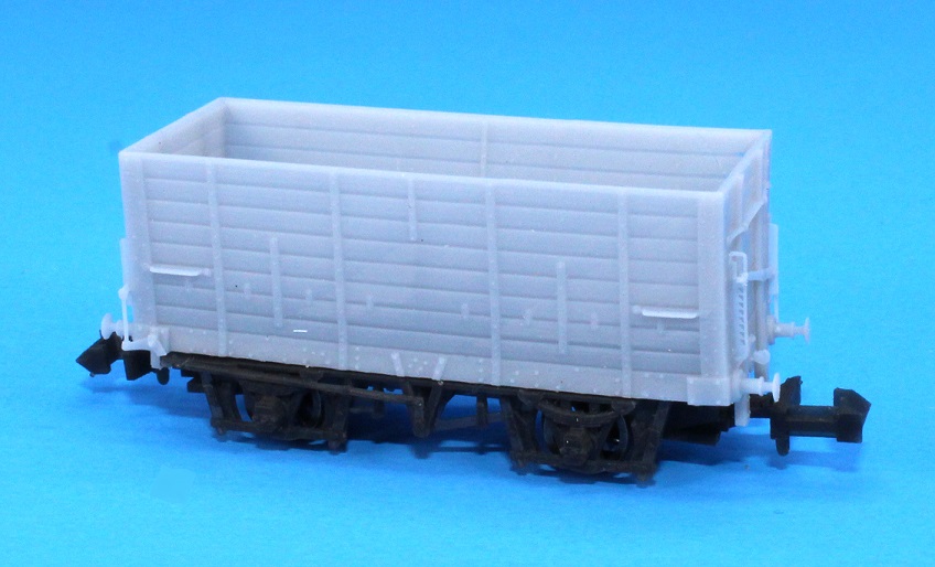

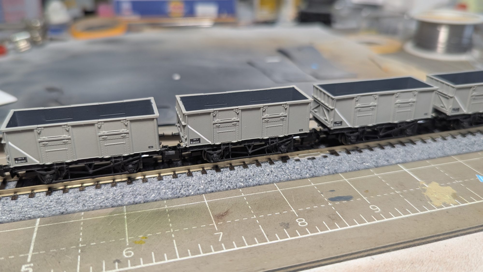

Today I finished work on a set of 24.5 ton mineral wagons I ordered a few weeks ago. I am quite impressed with the quality of these prints, however I did discover that the integrated NEM coupler pockets were not very good.
The flexible material on the chassis I think works well for all the fine details, but it did not seem up to the task for NEM pockets. The motion in the couplers felt sticky. The parts flex too much to keep tolerances and ultimately proved to be too delicate as I damaged one pocket on every wagon by clamping it in an alligator clip (lesson learned there).
However, I'm kinda glad I went with my backup plan of replacing them with Dapol NEM pockets. I tore out all the printed pockets (which were weak enough to just pry the bottoms off with my fingers). I then cut and filed off all remnants until there was a smooth surface to mount the Dapol ones. I also used Peco wheelsets in place of the included printed ones.
There were a few defects on the wagon bodies but nothing too noticeable. They were fairly tricky to separate from the chassis and to reattach later, being worried about breaking parts as they are held together with quite a lot of friction. However I was again impressed with their lack of brittleness and had no further damage occur during the process of squeezing them back on.
The only other downside was the shipping method chosen by eBay for delivery to the US. I would have been ok paying more for a service that had more reliable tracking.

Quote from: bigdawgks on April 04, 2025, 12:19:13 AMhowever I did discover that the integrated NEM coupler pockets were not very good.
Hi all,
I was beginning to think it was just me!
I agree with all the points raised.
But I decided on a different approach to finding a solution.
I've coated the whole model in extra thin superglue.
This stabilised the print and stopped it being as flexible.
Not had chance to run the rake yet, but will do shortly.
