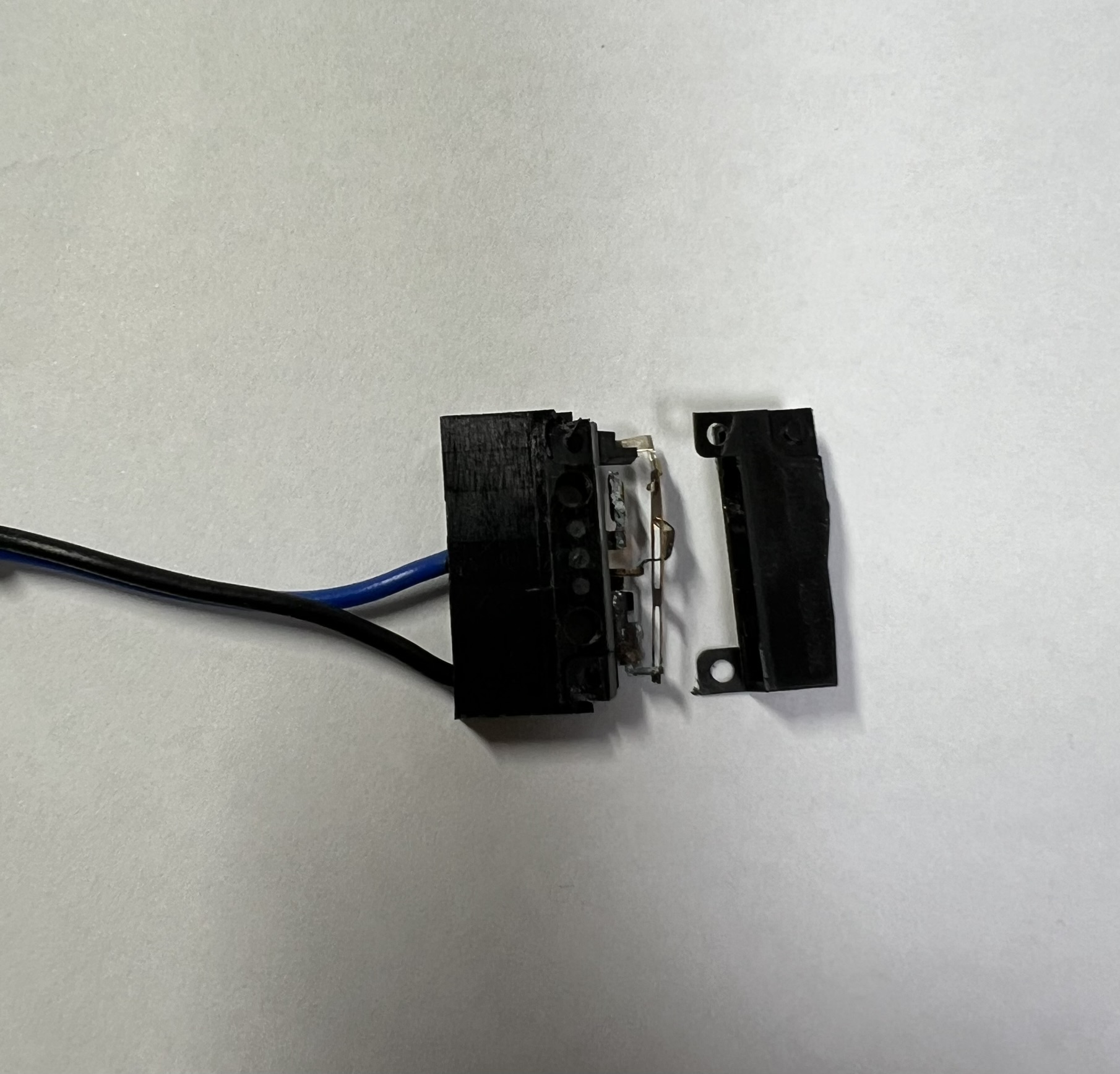

So the washing machine (around 5 years old so out of warranty ) starts stopping intermittently, mostly part way through the rinse cycle and occasionally at other points. It goes into a "temporarily stopped mode" ( best translation I can manage ) and can be restarted where it left off with the start button. There are occasional error messages indicating a problem with the outbound water filter, but not on every occasion. The lady of the house is not happy at all. So it falls to me to check the filter (no problem) and then read the user manual - a potentially huge translation task which in this day an age is quickly resolved with computer equipment and software. However I cannot find the fault. So book with Hitachi to have them send an engineer.
Takes them a week or so to get a chap onsite ( are they trying to persuade me to purchase a new machine? I ask myself ) - he does his best to diagnose but finds no fault - and the machine runs flawlessly while he is on site. He does suspect a microswitch which detects that the outbound filter is not correctly inserted but is not certain, fiddles with the actuator lever and says it should be fine. Says if problems return to call him back. I reckon he already knows what is wrong with it.
And you guessed it problems got worse. So call Hitachi again. They say a couple of weeks (again I suspect they are trying to get me to buy a new machine). Lady of the house gets agitated. Due to level of agitation they magically reschedule and the same chap gets here after a couple of days although that involved my good lady hanging around all day waiting as an accurate time could not be provided. Although at least he brough the correct part based on previous suspicion.
Anyway today he changed the microswitch. And all is well with the machine and peace descends Chez Mason.
Except for 2 call out charges and a microswitch which cost 20,000 yen in total ( around 100 pounds ). Actually the cost was a relief - next swap out would have been the computer board ( yes i know its just a washing machine, but... ).
What is irritating me is:
1. what feels like possible deliberate delaying tactics to try and get us to purchase a replacement for an otherwise perfectly good machine.

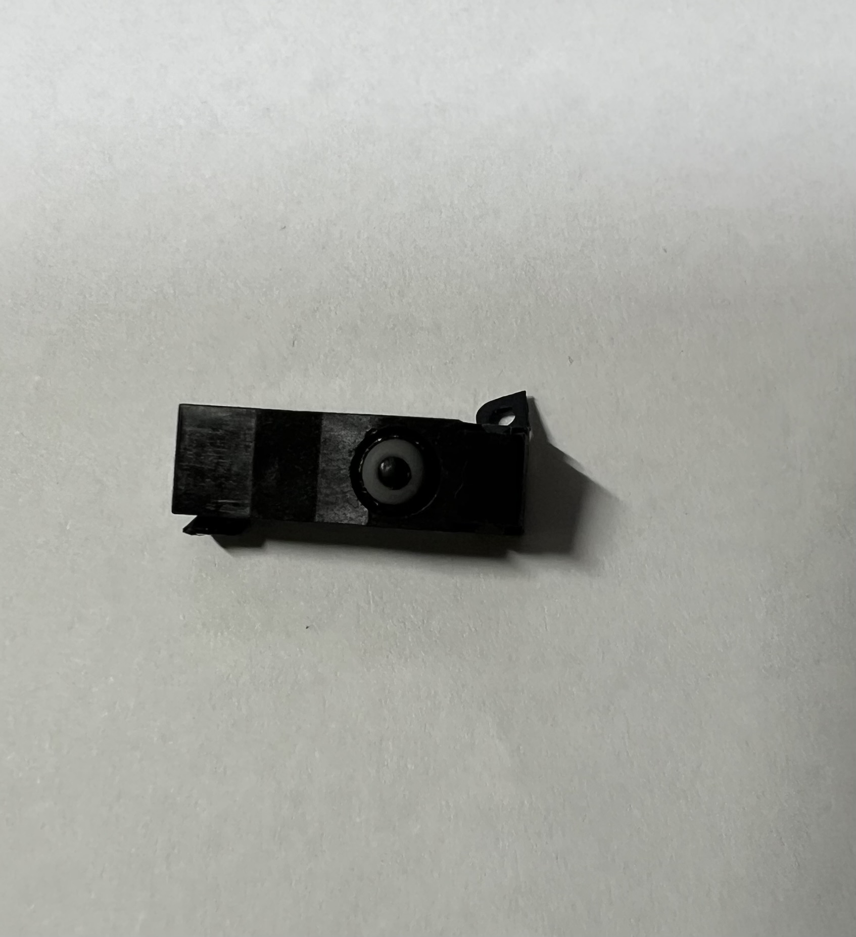

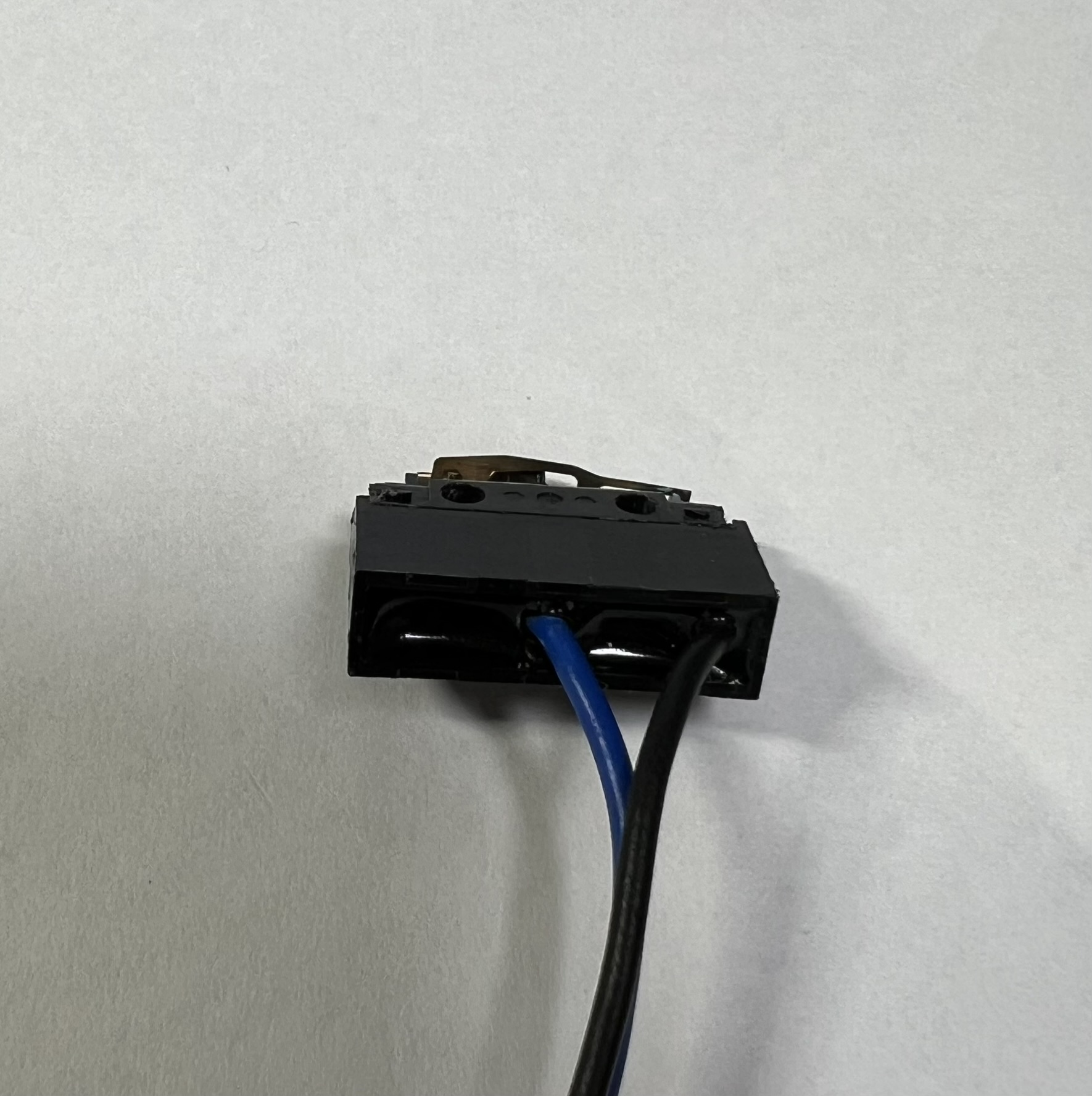

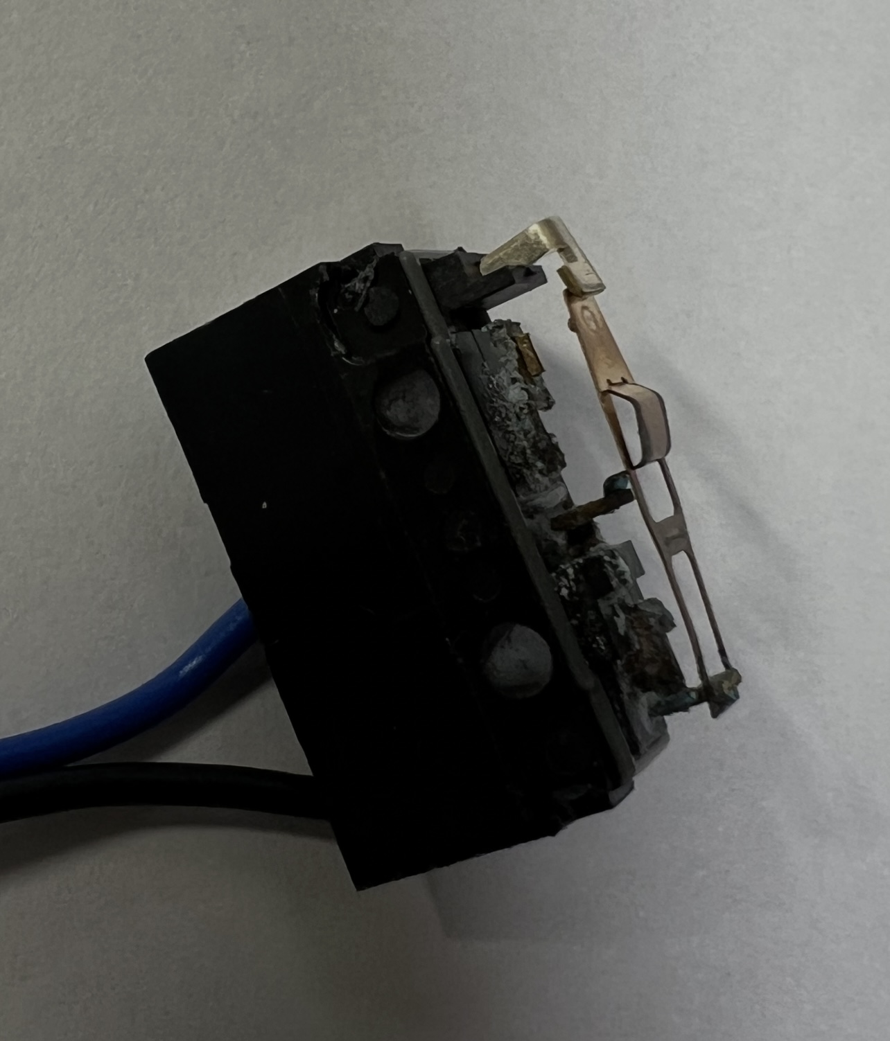

2. The nature of the failure - see the pic below after some disassembly of said microswitch - seems that soapy water has seeped into the switch assembly and contaminated the contact set with dried soap crud .... one hopes it is only a low voltage sensing line. But still there must be a better design by which this could be sealed. The back is potted and the actuator on the cover looks waterproofed but the centre joint must have allowed ingress. Not good. Pics to illustrate below.
Opening the switch on what seems a not very well sealed joint:
The crud inside - no wonder it was intermittent:
Potted rear - well sealed:
Sealed actuator "nipple" on top:
