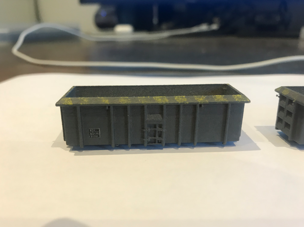

At the Newbury show this weekend I met @RussellH who was exhibiting and had a very useful second hand stand.  Amongst the items on sale were a cross section of prototypes and seconds from the 3DR range of prints.  Several items were purchased including something special, but more of that later, and these included some ASW POA Scrap Wagons.  These are designed to sit on PECO chassis and are an interesting subject for a modern image rake.
The plastic (not FUD) takes quite a bit of preparation being a powder laid down in layers and sprayed with an adhesion agent.  The result after the excess powder is burnished off with a toothbrush and a fibreglass pen is a sandstone type surface that requires careful preparation.  The plastic also drinks paint, which is great for a rust finish essentially dying the surface that when over panted and scratched back gives a good rust aged effect. Some additional painting and handmade decals and the results are quite acceptable.

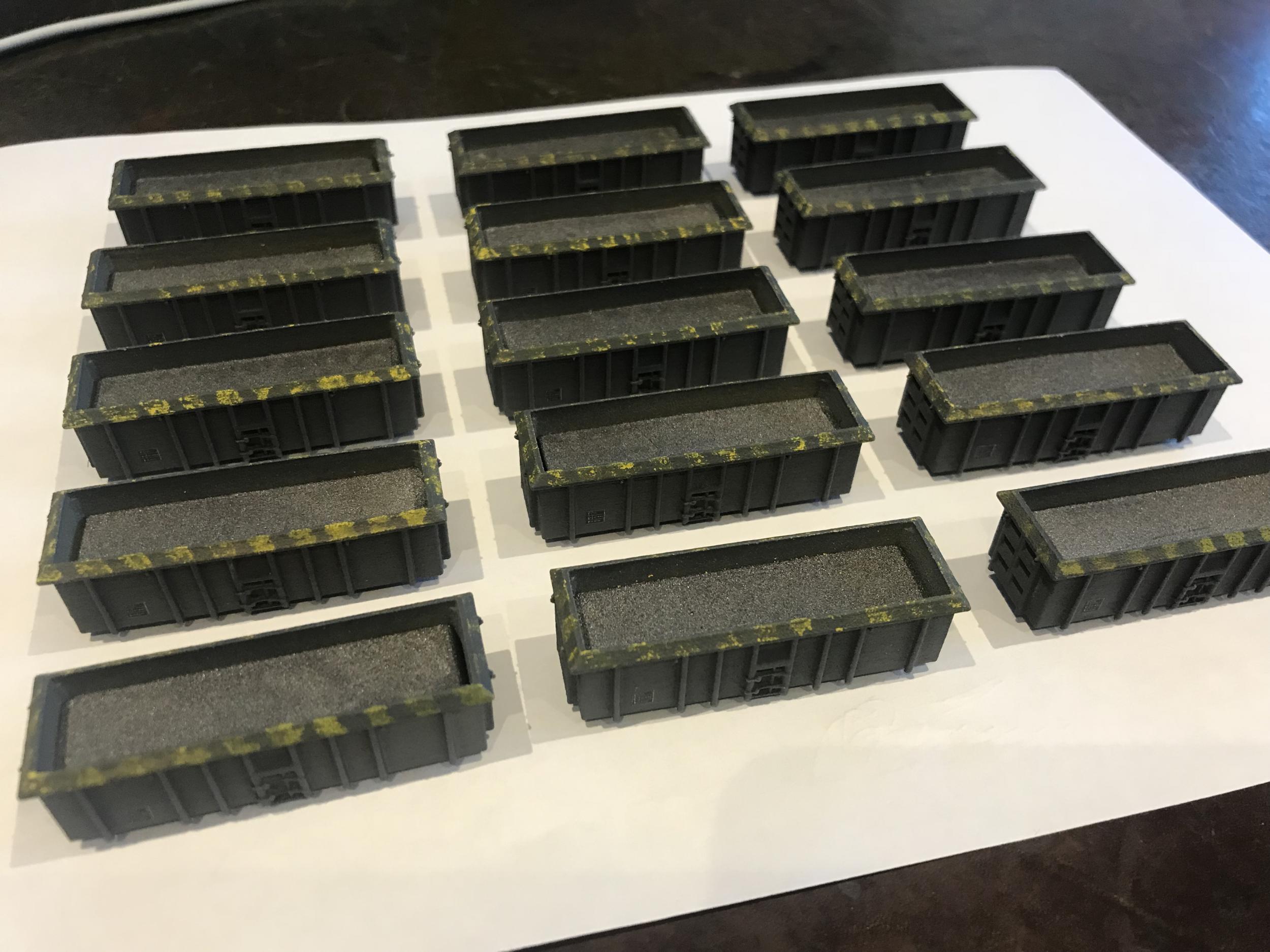

Scrap load added and rusted
A little rust
Some more rust
And now dry

What do you use for your scrap? Looks good.
lathe and mill scrap from steel materials.  There is nothing as accurate as real rust, but you have to seal it with a matt varnish to seal it or it will crumble away completely with time.
