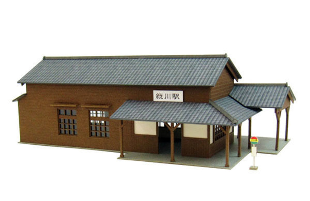

At the top the the temple station will be a rural platform from green max and a sankei kit :
