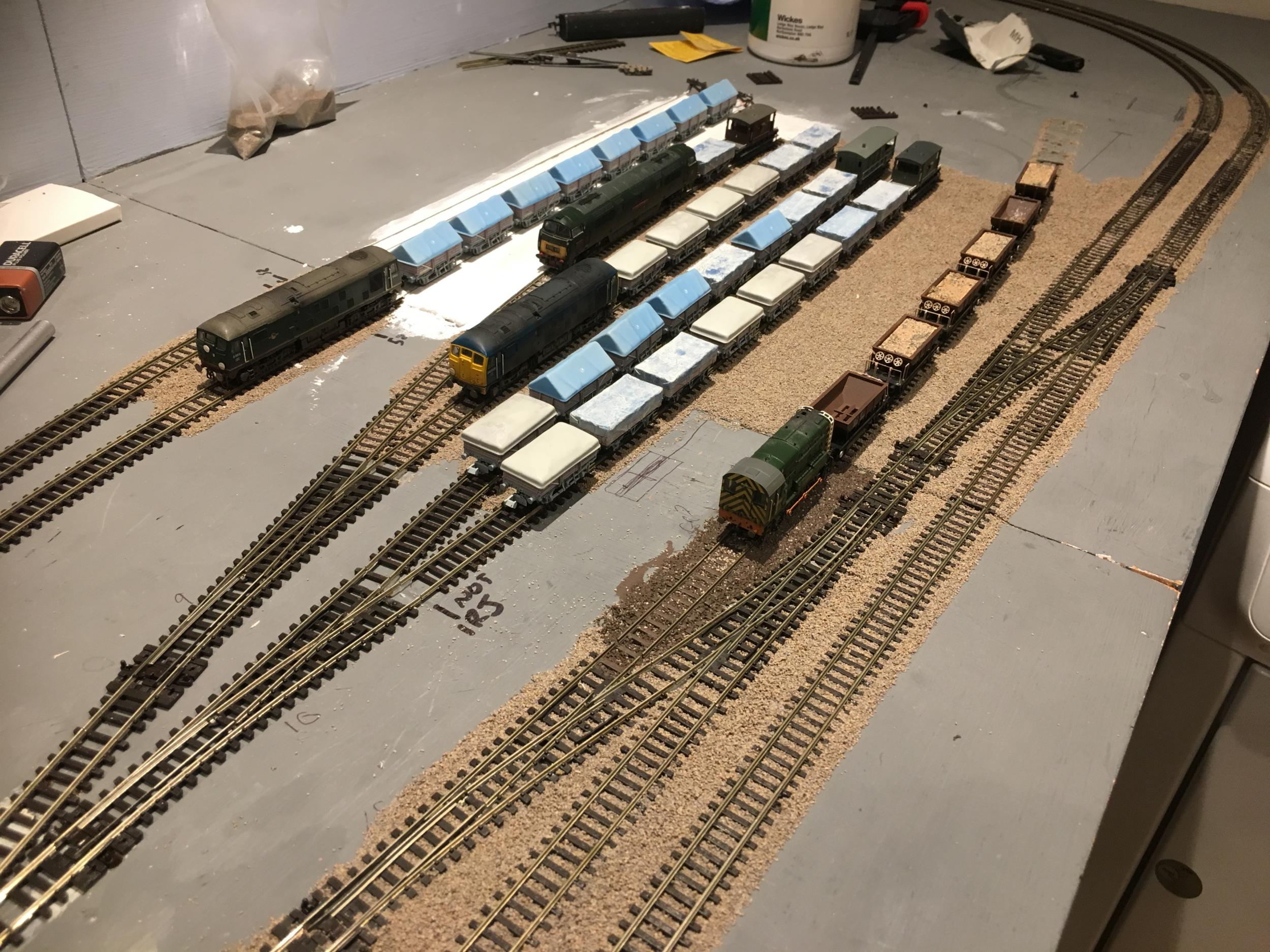

Hi all, some positive movement on the layout, all connected together now and four working boards.  Need to add one more cross board dropper set for the UP FY to work correctly as missed a few wires off...With that in mind I've added the layout to Train Controller at present (itrain to follow!) for testing the block detection, pleased to say that it happily couples and uncouples automatically by computer control now.

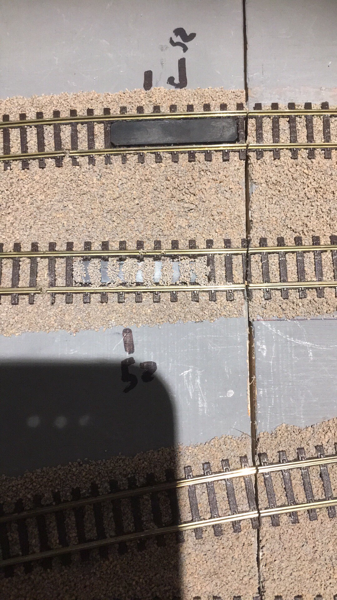

Pictures showing magnet tests.. settled for the flush look one with some added ballast to try and resemble sleepers which I've cut away to mount the Dapol Easi Shunt magnet flush with the track, once its all painted weathered and scenery added it will be difficult to tell where they are...
This picture shows the wagon space in the fiddle yards...

Glad all works OK and encouraging to see slow forward motion over the magnet does not result in uncoupling. (2nd vid)

Nice bit of camouflage Paul, great to see you're getting Train Controller to work.  I find the Dapol Easy Shunts really good to work with and providing the train maintains a forward (or even backward) motion they don't uncouple over a magnet, it is only relieving the tension by stopping and reversering that starts the uncouple action.
