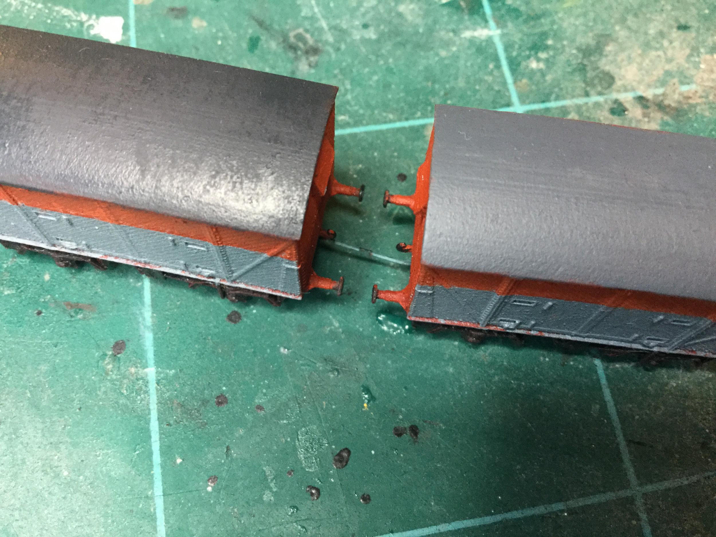

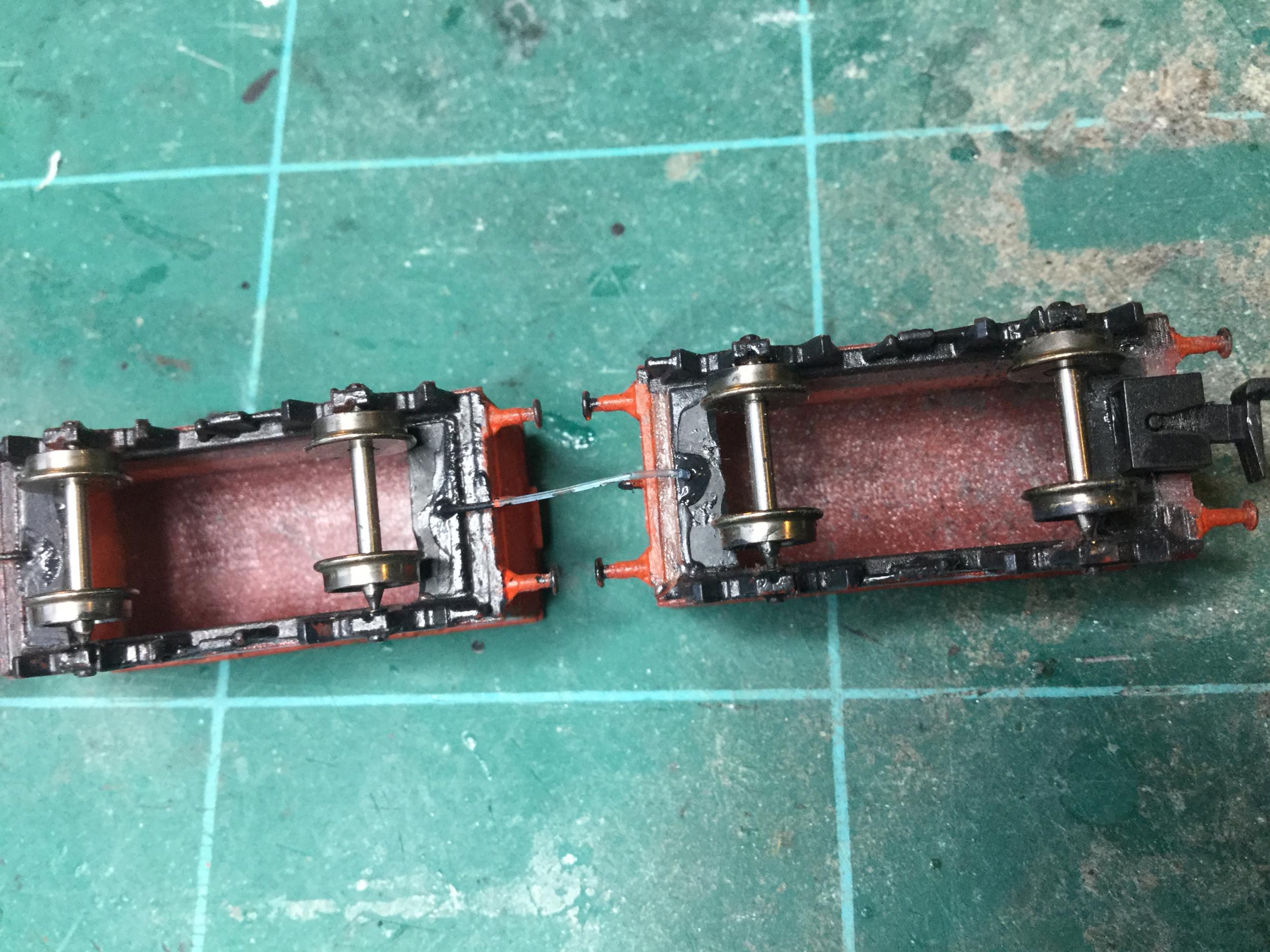

I have some 3D printed wagons that have no pre-supplied or fitted couplings. I wanted them to run as a fixed rake and talked the options (brass ‘staples’ etc) over with @PostModN66. The inability to fix a staple from above, and wanting to avoid the cost of fixing NEM pockets led him to suggest 20lb strain fishing line. It is flexible for curves, and yet has linear rigidity for propelling moves.
A simple ‘staple’ of the fishing line, inserted into holes drilled into the superglued plasticard inserts I had intended to mount the NEM couplers on has sufficed. The spacing shown allows running both pulling and pushing around 9 inch curves. I have a video I will post next of them running, although foolishly I didn’t video them pushing, but they happily did so.
