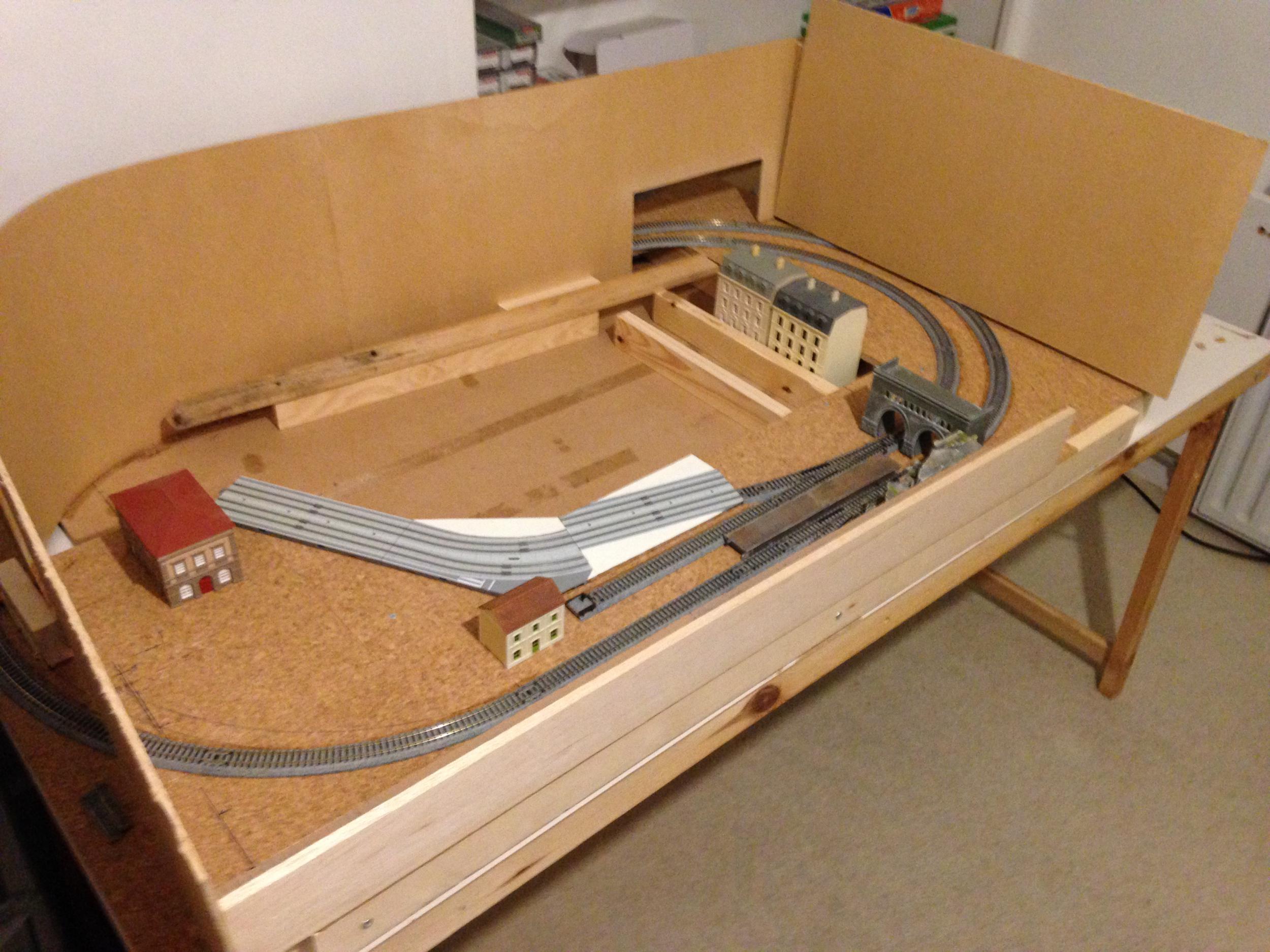

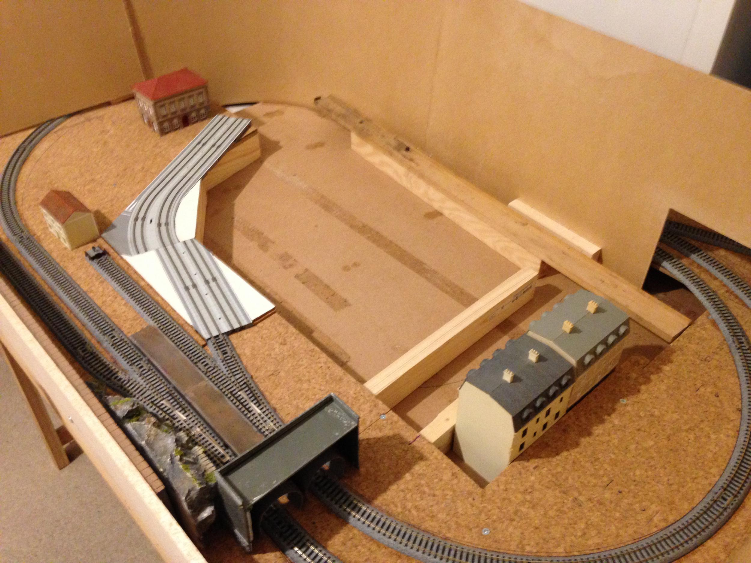

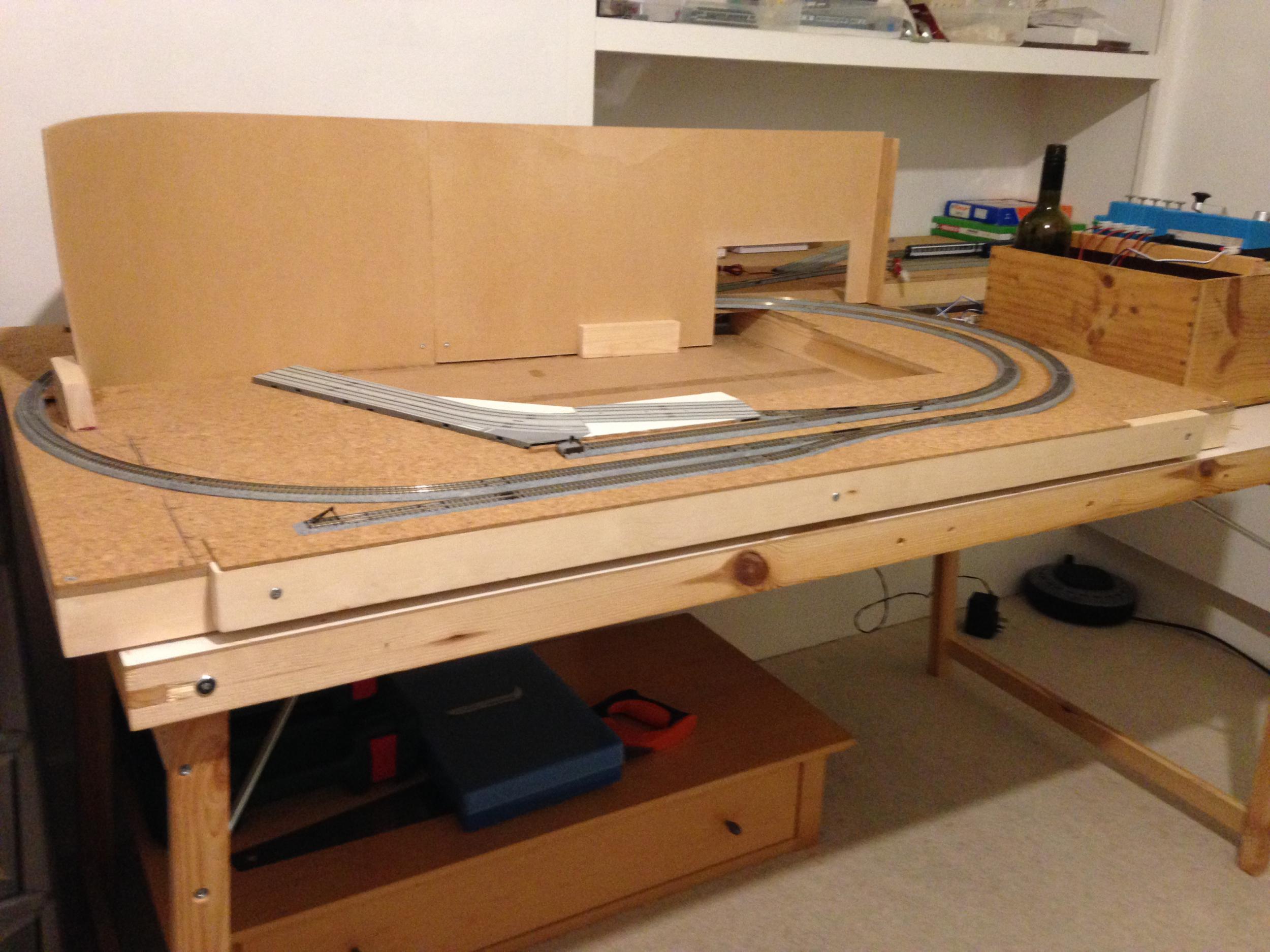

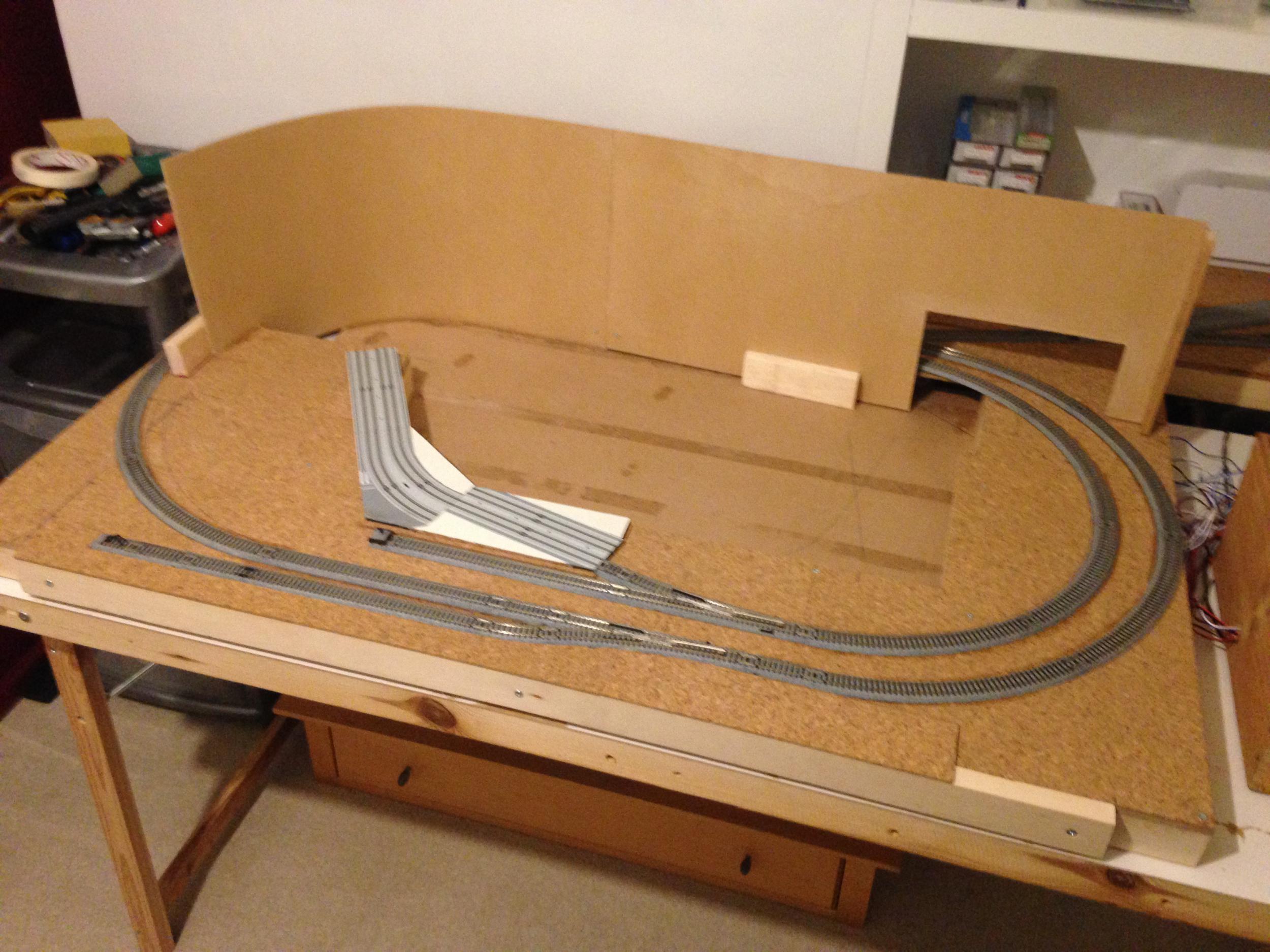

The layout as it is to work on ...

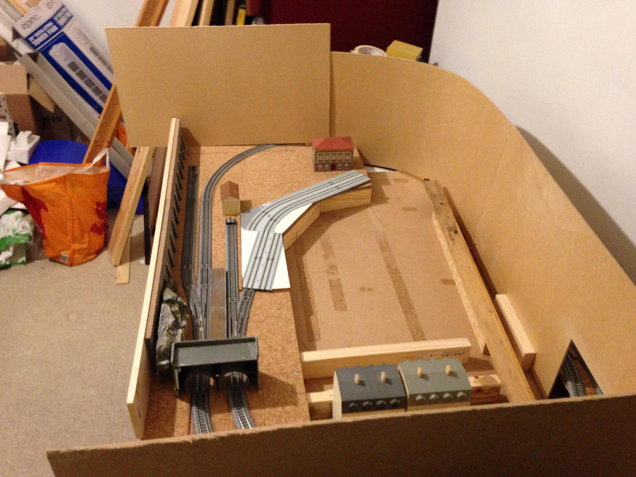

Precarious pics as nothing stuck and backboards need cutting so just to give you an idea of what it might look like. Wall and rocks at front and sides, harbour wall at back against skyline, not a lot of track will be seen because of the tunnels but enough I hope for my (and others) interest but trying to concentrate on the scenery. Need to make the edges safe before the 'you need to make the edges safe' delegates arrive  :D)...
Pic of back of sky as the layout might be incorporated into the future 'proper' Port Regleun one...

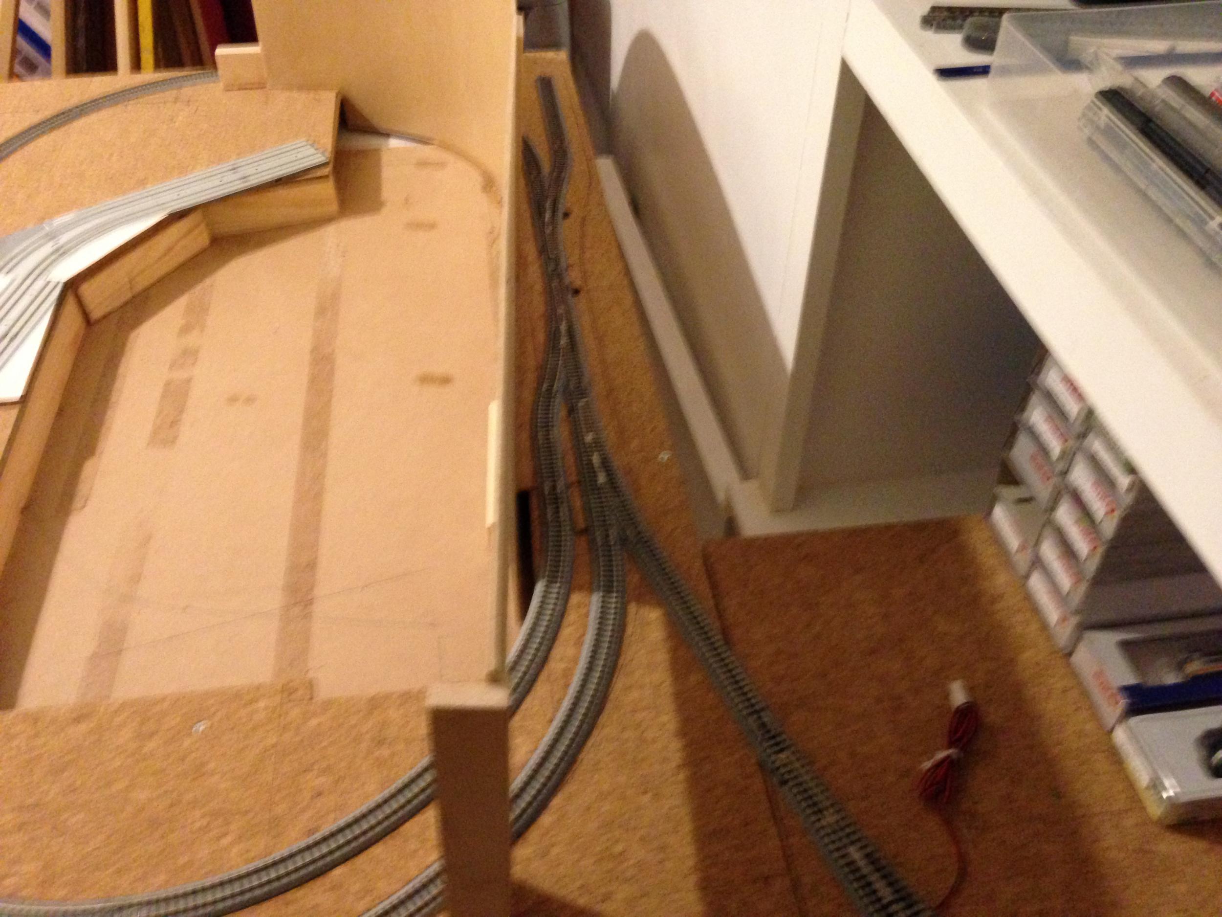

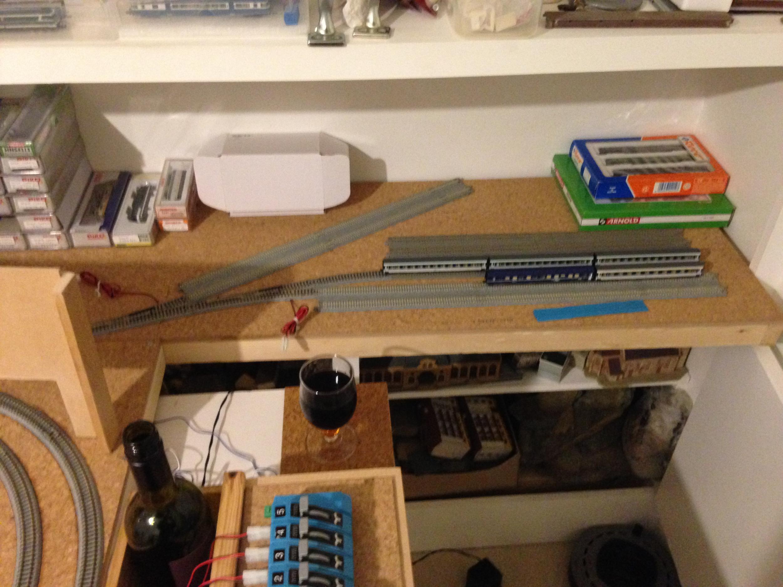

Temporary fiddle yard...

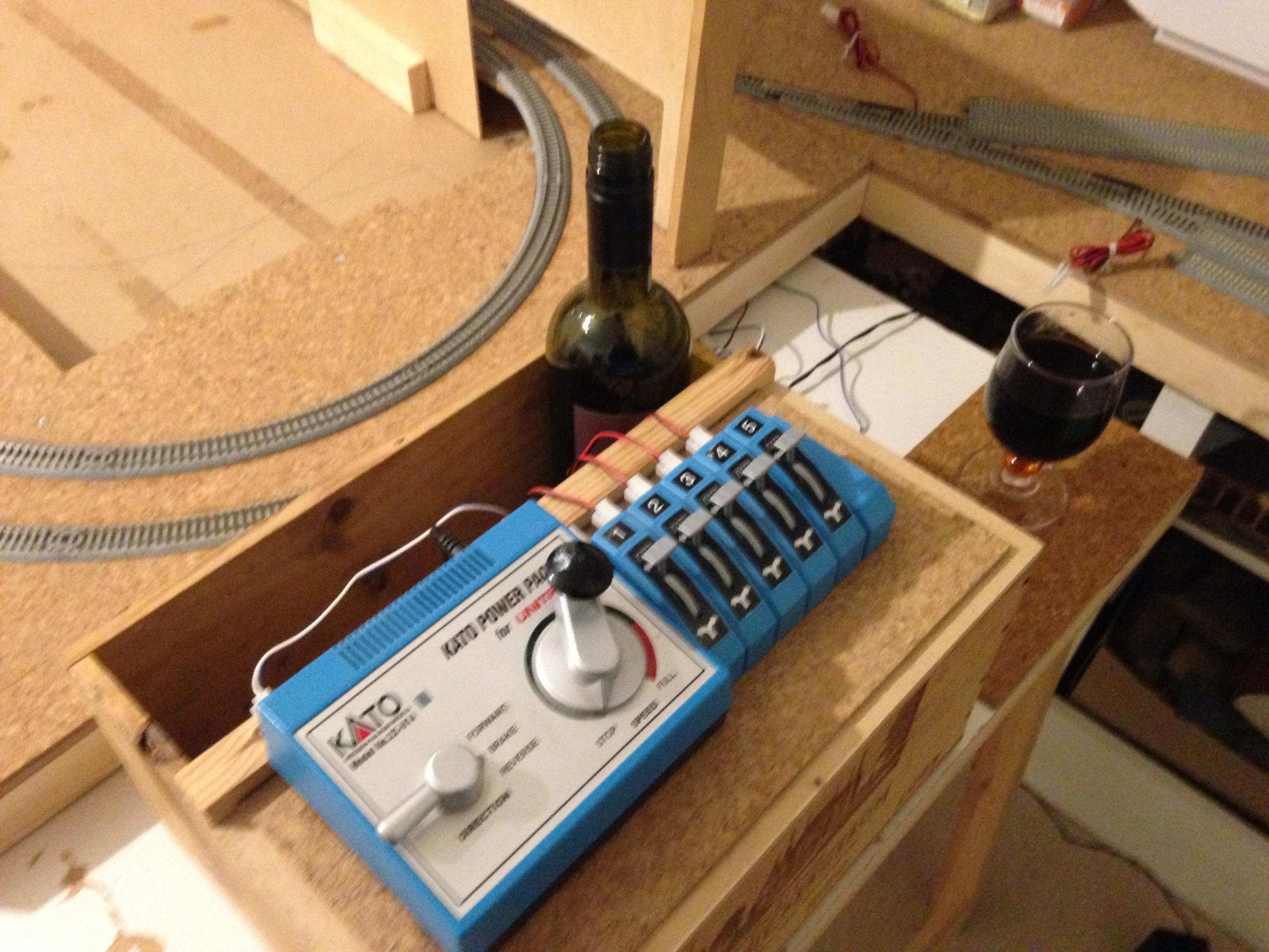

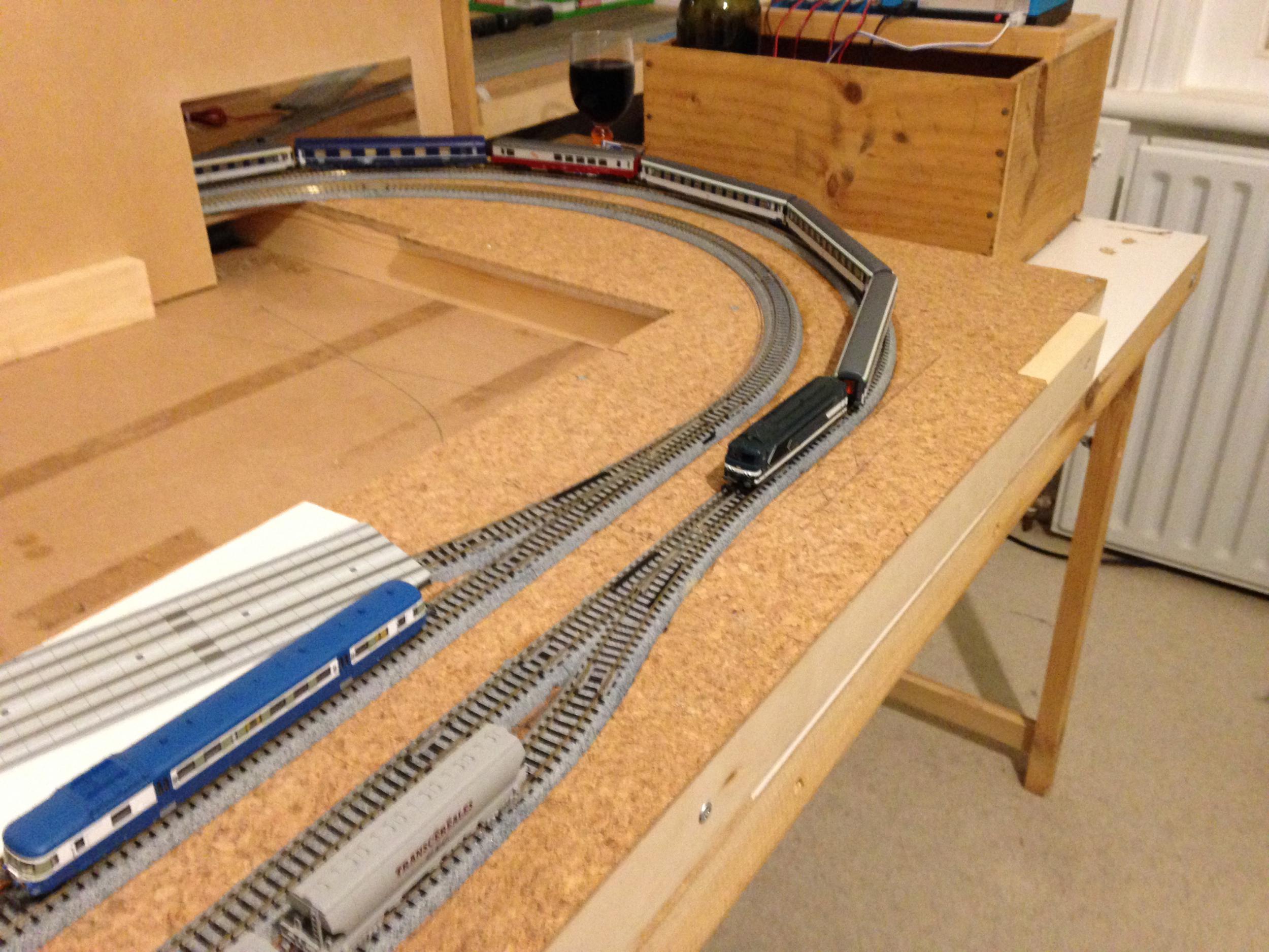

Wired up controller (no pics of the really wired up controller but it does show his refreshments  :))...

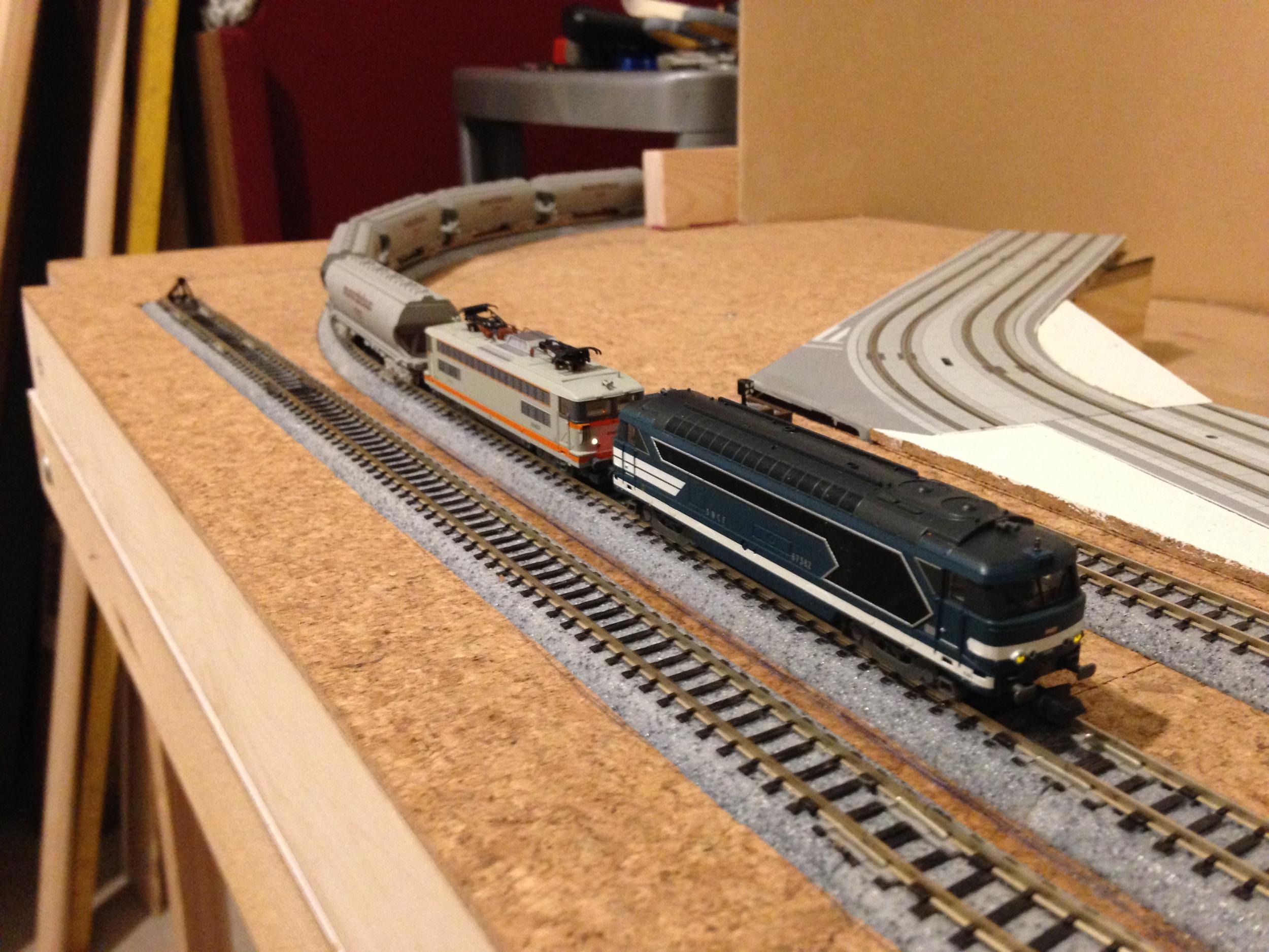

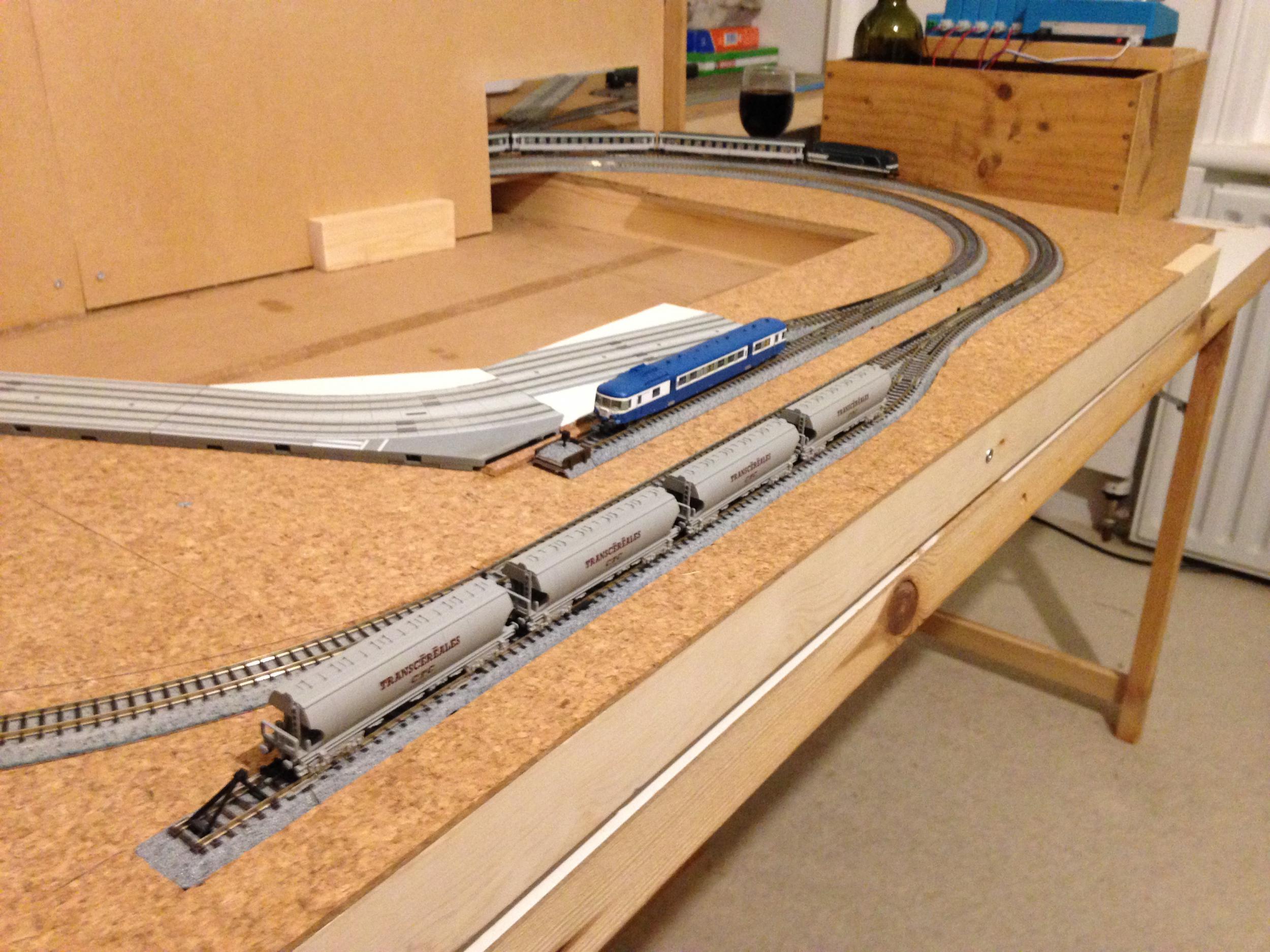

Few train pics. The line is non electrified (not to spoil the '60s running) so due to the bridge problems a redirected Transcéréales freight from Western Brittany is pulled by BB67382 from St. Brieuc to Lamballe where the BB 25561 electric locomotive will take charge again...

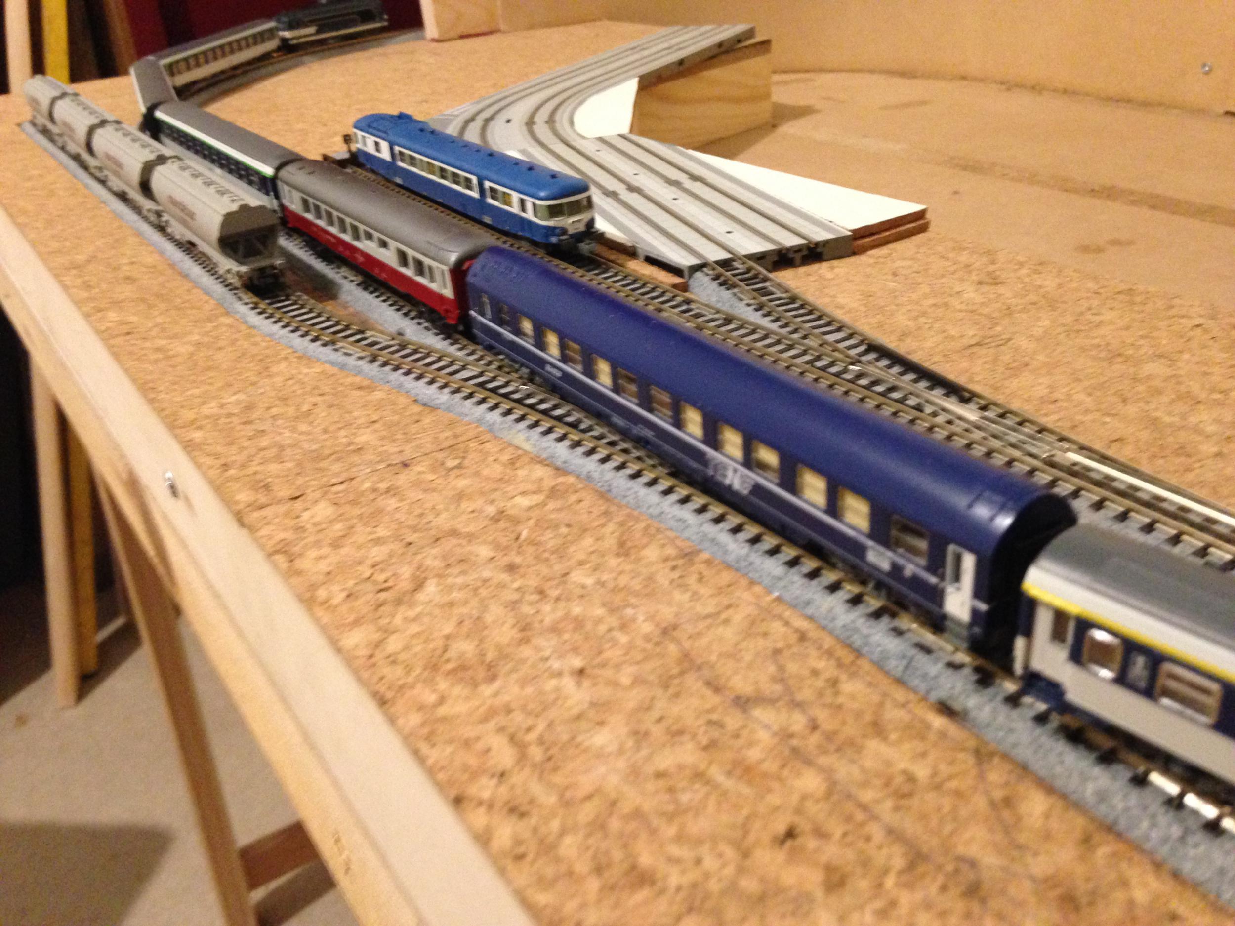

The TSC to Erquy railcar waits in what will be a station while one of the last 'ski trains' to Bourg St. Maurice and Grenoble via Chambery appears...
The ski train, consisting of 3 Piko 2nd class couchettes, 1 Arnold TEN sleeper and 1 Piko 1st class couchette would eventually appear through the double tunnel mouth shown earlier. The real 'fictional' (if that makes sense) point is just inside the tunnel mouth which cant be modelled as Kato don't do curved points. The British and Irish tourists from their respective ferries are all enjoying a few drinks in the Lima Gril Express car not bothered that their train has been redirected another way due to a different bridge problem or that I cant find the Piko Bar Corail coach that looks better..

Great pics!! It's going to be a really nice little layout.  :thumbsup:
I like the idea of the tide being out, you can model pools and boats sitting on their keels, etc. As you say, if it turns pear-shaped you can always bring the tide in.
Glad you pre-empted NewportNobby with the proximity of the track to the baseboard edge! He'd be the first to be on your back about it!  ;)

This looks fascinating.  Great idea to have it set in France as that is a little bit different.  I look forward to lots more pictures.
Two very interesting specifics:
Clever use of a 15 degree Kato curve after the #6 turnout to have a closer track spacing for the 'front siding' than with the normally-used 718 radius curve.  I'm guessing it is either a 282 or 315 radius curve.
Excellent drinks cabinet built into the back of the control panel.  And a prototypical refreshment as well.  According to the late (and much missed) Mr Hardy, "Un bon petit coup de rouge!" was quite the thing in steam days, but rightly stopped with diesel and electric traction.

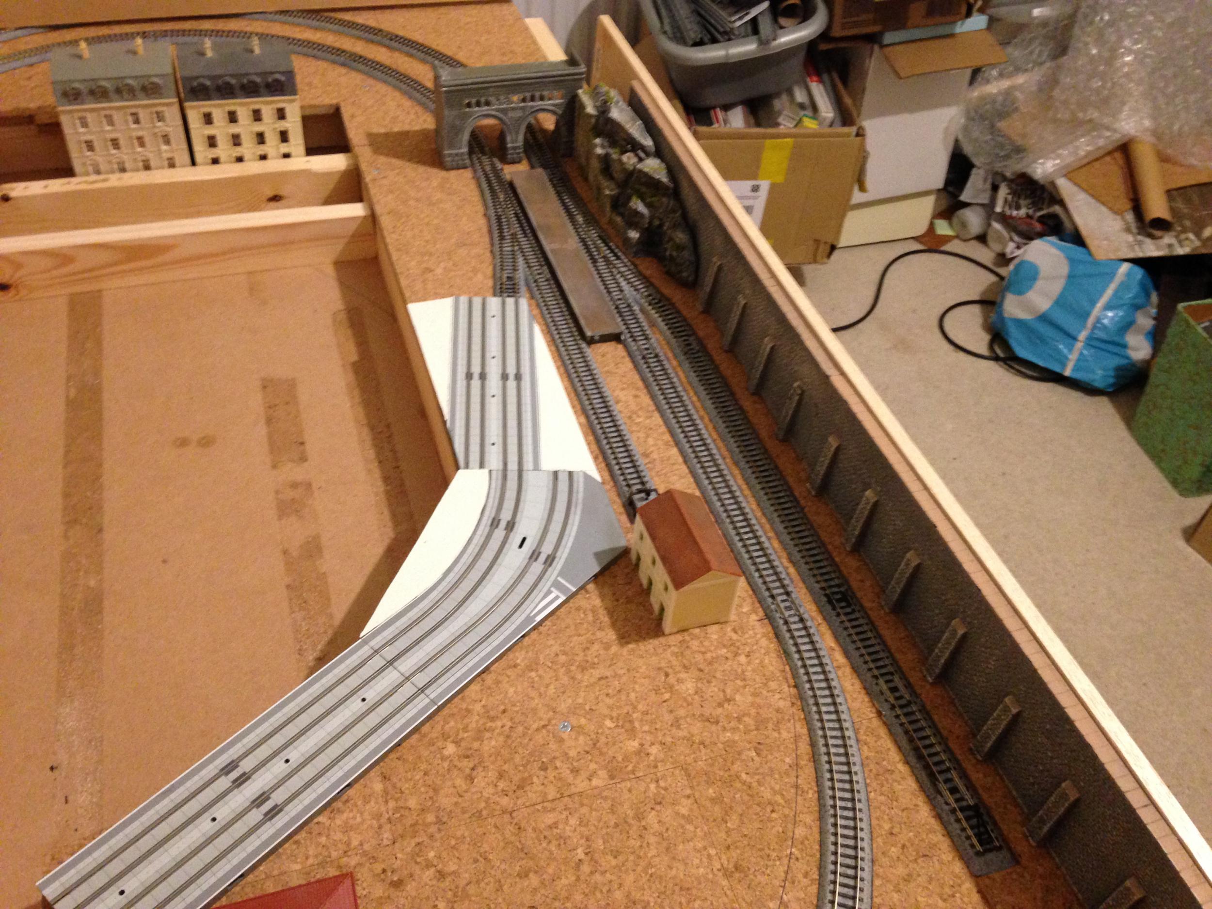

It has taken me ages to get my head around a small layout as it has never been what I really wanted but after great inspiration from the other small layouts on here (you know who you are) I'm really looking forward to the scenic side while watching expresses trundle through and operating a few local trains and a bit of shunting while waiting for things to stick.

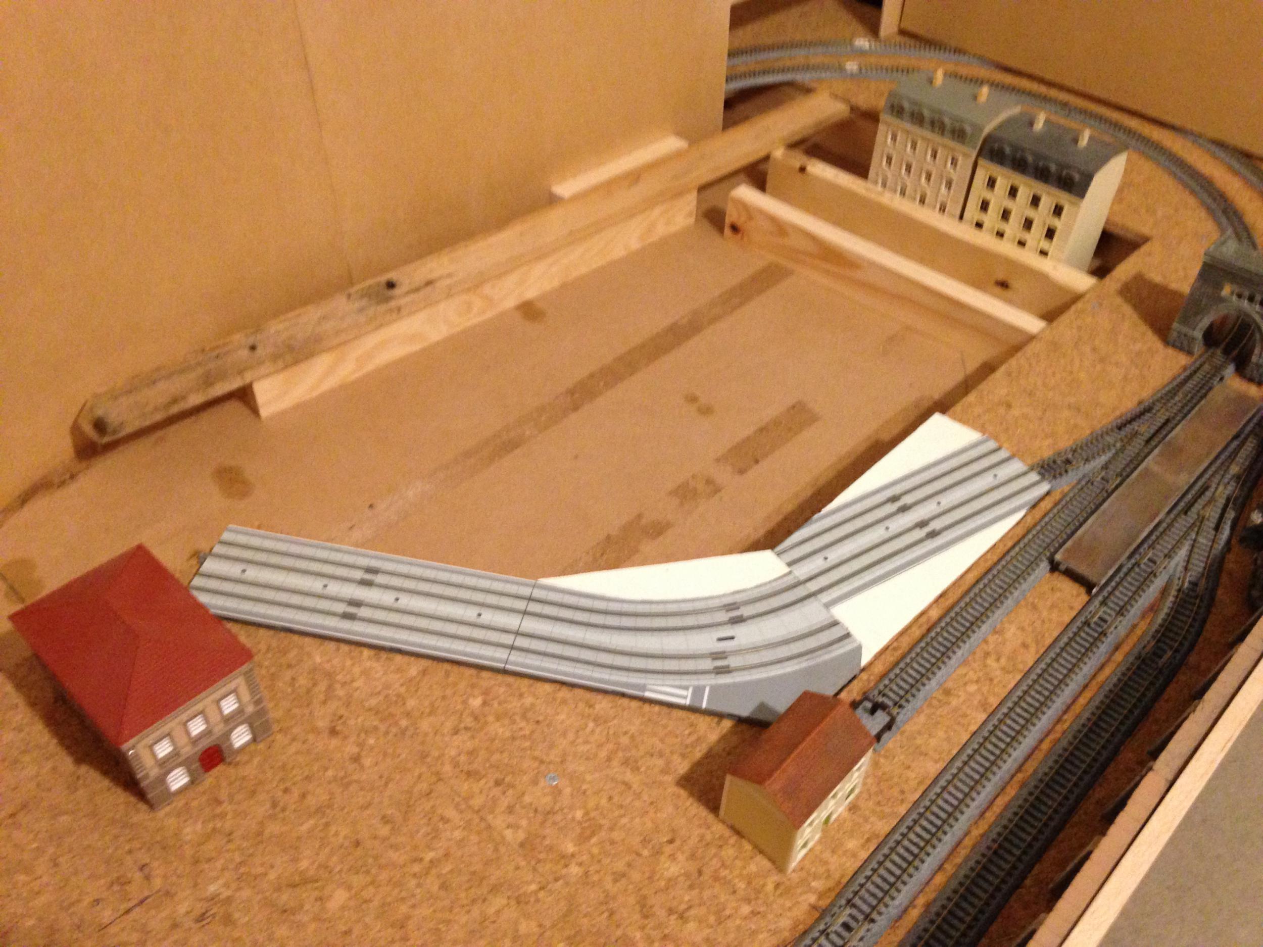

Bit of additional info....
The points are all Kato #6 ones as didn't want to risk the #4 troubles. I do have some but on a sort of test ages ago the railcar never liked them. It meant space constraints but I prefer easy running.
The siding against the harbour wall, if anyone confused, will just be a single track. I've used the Kato tram track so I don't have to do the filling in myself. Tried that once and it looked awful. The surrounding tram track will be filled and all painted grey.
The siding will be mainly for loading fish but will be useful for supplying goods for the market and various planned festivals......
Regarding that, the 2 Vollmer? buildings on the other side are 5 storey town houses. These look too big for a small harbour so one of many experiments is to have them on the level they are ie. the sea bed and build up the quay so they are 3 storey which is more like my memories and certainly the pics on line. The third floor has one ornate window which can be adapted into a door (I hope). They'll be bars/restaurants so I think with canopies to protect the clientele they should look OK.
Also, another experiment, the bit in front of the 2 (maybe more) buildings will be a lift out section of the quay with different replaceable sections, various scenarios (market day, Celtic music festivals etc.). Also, although the harbour wont have changed much over the years, it means I can have different trends/signage etc for the different eras.
Might be easier and neater to just saw down the middle?

« Reply #10 on: March 13, 2018, 12:43:43 pm »
Hi Steve,
Thanks, know what you mean but bit late. The white bits are cut cork tiles (x2) which are flush with the tram track. Have run out of grey paint so a sort of primer.
More cork will be used to fill the area in front of the tram track toward the camera and going round the harbour walls so it's all hard standing pedestrian access.
I might just fill the short bit of track, top left, and leave the long bottom right bit as rusty disused track with an imaginary tarmaced over point.
Cheers weave  :beers:
 :laughabovepost:

A nice layout. :thumbsup: One thought, the quayside track, would it be possible to extend the siding a bit and put a second RH point to the inner track? It would give a little more storage. One mistake I made was not making a suitable refreshment bar :beers:
