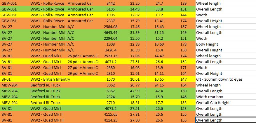

I have recently stumbled on the above range from Miniature Figurines (MiniFigs), I have known of MiniFigs for years, but did not know that about 10 years ago they started this range aimed at 10mm wargamers and N Gauge market. So this week I ordered a few to measure and see, here are the results:
WWI Rolls Royce missing turret which I need to report hence height issue, otherwise good.
WWII Humber Amoured Car was good but a bit short.
WWII Artillery Quad not so good length close to Mk1 but detail all wrong shape looks a lot better than Gramodels version.
Modern Bedford RL truck good to scale and reasonable shape.
This range is now owned by Cavalier Books and can be brought online at http://www.miniaturefigurines.co.uk/Home.aspx payment takes you to cavalier books very chunky process but bear with it. The ranges are listed under MiniFigs 10-12mm down the left hand side, I can not vouch for the rest, the order arrived in a speedy time. Aircraft are also covered but some may be in a smaller scale, I am happy with them, whitemetal castings reasonable clean and in multiple parts.
