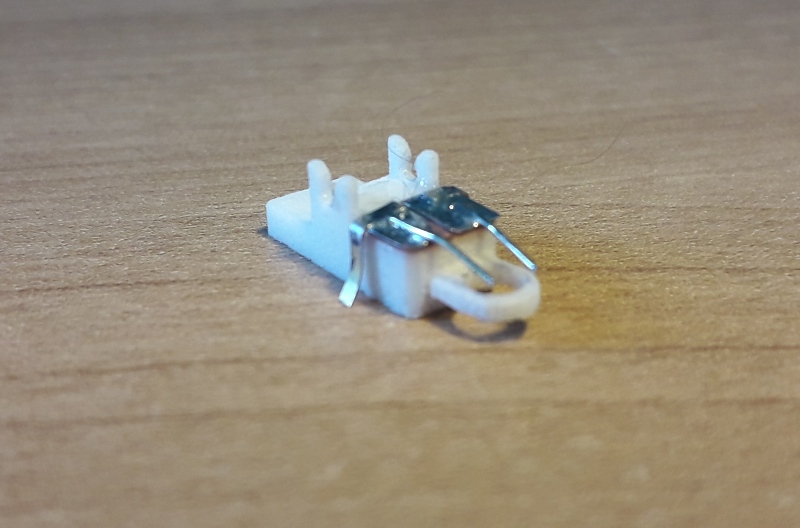

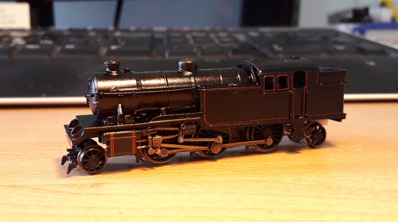

I've started on the red lining on one side last night.
I also knocked up the pickups for the rear pony truck and played around with these until I was getting good contact with the wheels while allowing them to still turn.
The pony is printed in Strong White and Flexible (about the only thing I use this material for) and has had the holes opened to clearance using a drill in a pin chuck. The rear overhang for the coupling pocket is slightly too long and so will need trimming back by about 1mm to clear the bottom of the rear buffer beam.

I've got a little further with the V1 build, it now has it's identity.
No. 2911 was briefly allocated to Kings Cross shed for seven weeks in 1931. Since taking the picture, I've moved the numbers around as I wasn't happy with their placement. The red paper to the left is clear decal paper that I've sprayed with the same colour as I did the lining. Once it has dried I'll use my bow pen to draw in a black line and carefully cut the paper to leave a thin red line either side of it. This will form the boiler bands for 2911. I've not attempted this before but have seen it used to good effect on some very nice 2mm finescale scratch builds.

« Reply #380 on: June 11, 2018, 03:19:58 pm »
Some progress on the V1 test build/paint. Having seen Tim Watson's magnificent 2mm scale P2 build, I thought I would try his technique for making the boiler bands. This comprises spraying a piece of clear decal paper (Microscale in this case) the colour of the outer lines and, once fully dry, ruling on the center colour using a bow pen. Once this has hardened, the decal is trimmed to size using a razor blade and applied to the model. Keeping the outer lines a consistent width is a bit of skill but I'm happy with me first attempt at using this technique.
It occurs to me that this could also be adapted for use as cab and tender lining and, although the corners would still need to be carefully brush painted, it would be easier than trying to line three different lines using a bow pen!
