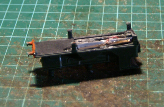

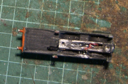

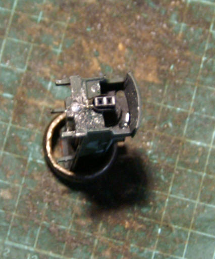

As Malc says, I've fitted working tail lamps to all my rolling stock where needed, coaches, cct wagons, guards vans, etc and also on the loco's themselves (both front and back).  It is a lot easier for me as I'm DCC so power is always available.
Most are done with an LED and a bit of fibre optic, in the early days I used a standard LED + heatshrink tube and a bit of fibre optic but now I use the 0603 SMD LEDs.  They're fiddly to work with but you can get them now with leads already soldered on which helps if you're not good at soldering.
I must admit I now make use of the type with leads already fitted for the dual colour leds, red/warm white for steam loco tenders, red/green & red/yellow for shunt signals etc.  For steam loco headlamps I still use separate warm white and red LEDs as I fit them with a little handle so they look right on the front of the loco.  Below are a few examples.
