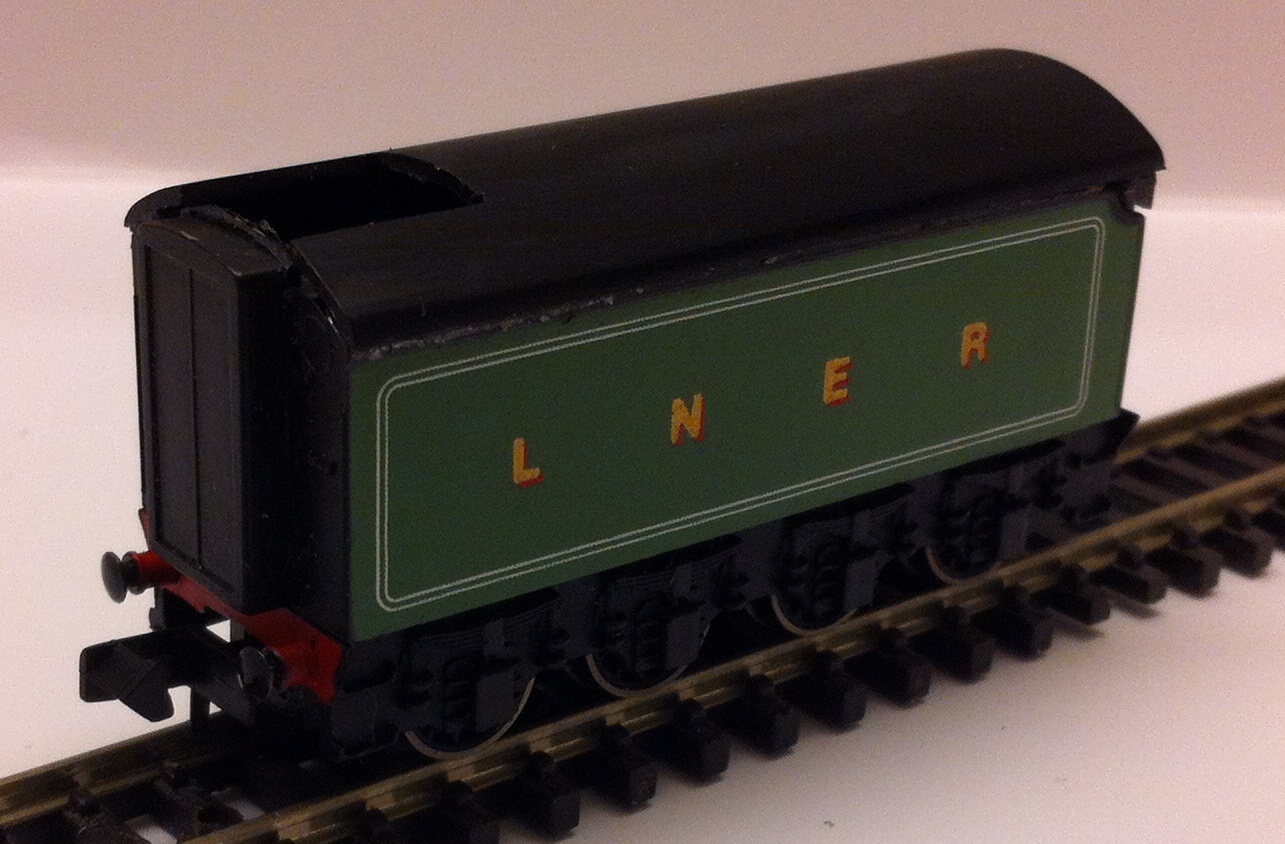

it only carried water, so a little conversion is in order, cut out the coal bunker and replace that section with part of a roof carriage or wagon roof. should look ok then
I have the same project on my 'To Do' list. Here's a snap of a OO model at an exhibition somewhere in the West Country a couple of years ago. Can't vouch for its authenticity.
HTH, Brian
like i thought, basic water tender, so i think by cutting out the coal bunker, replacing it with a roof off a wagon or coach, then adding a 2nd corridor section on the front along with the numbers 4472 on the sides, should be spot on i think?!

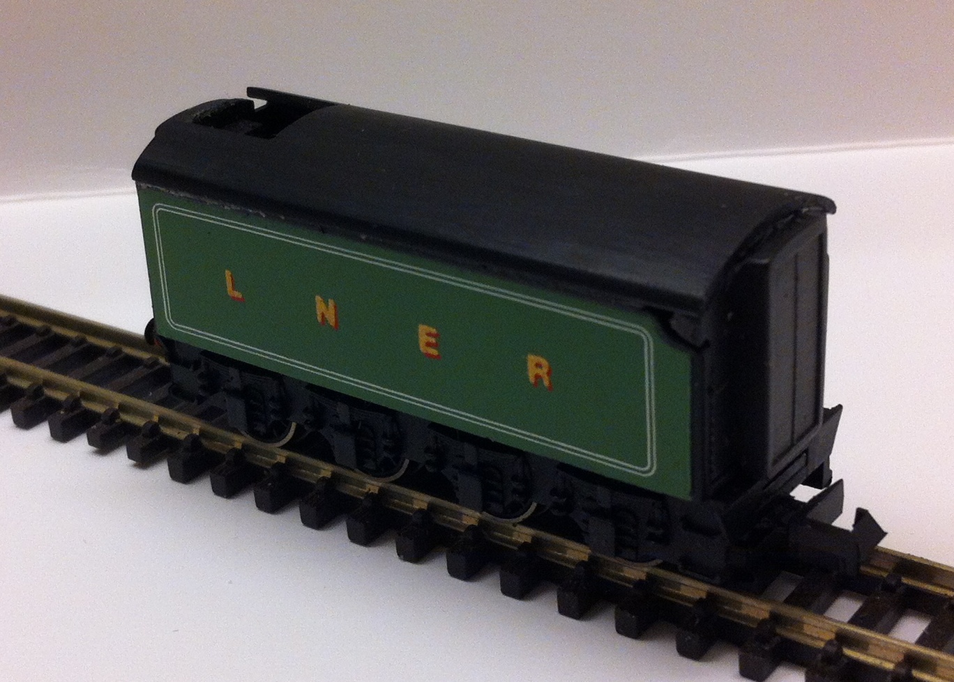

Oops, I rather think i'm inventing a 'never ran' example. Ive actually got Farish 60103 Scotsman in BR green with double chimney and no deflectors - i'm not sure what they based their production model on. My research has shown that when Pegler bought it, it was BR green with a standard A3 NON corridor tender, double chimney and deflectors. As I am very specific not going to repaint the loco / tender as bought, im going to have to repaint my new tender in BR green. I think it has to be a ficticious example as so far I cant't find any picture of a double tender Scotsman in BR green.....
My Tender in the photo is a chinese tender chassis with a Poole Tender Top, a DMU roof section and ive made a resin corridor front from a silicone mould off the Farish rear. Just needs the front buffers, and a tiny bit of filler to end up in Apple Green, I may add tin plate sides with double sided tape to paint in BR Brunswick Green ... we'll have to see...
