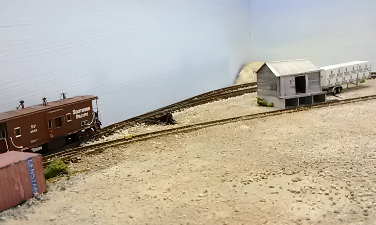

Hello, Webbo.
Your farm scene is looking mighty good!! Because of your inspirering new scenery, I finally started to work on my scene.
Thank you for complimenting my ground cover.
I made my sand by using plaster with tiny bit of art sand.(I think it is for a sand art craft or something...)
And  I coloured it with $0.79 paints.
On the real locations pictures, soil is almost ivory colour to me. I remember if you see with your nakid eyes on the actual location, it was more light red/brown-ish colour. Maybe something to do with sun light.
I used sand for real locomotive but grains were too big on N gauge. The Art sand itself was same, too big.
Then I bought Arizona minerals and sand's low desert soil and it came out too red-ish colour. I I'll leave it as is for now.

About dirt, I forgot to mention that you can use a product that fix dry wall. The one comes with paste type.  In US it's called "patch'n'paint'. I don't know what it called in there but it drys kind of rough surface.(unlike plaster that cure totally smooth.) I used it to fill any gaps on the ground and paint it.
Also, I heard some people use grout. The one use for floor tiles. It seems dry out sandy texture.
In bigger scale, they just put real sand or dirt then looks good but in N scale, we need to find something like ...almost powdery materials to achieve the fine texture.
Speaking of space/composition.
My Team track is like this.
You would said nothing there!!
Yeah, nothing there.
Real Team track that I wanted to imitate... like this.
https://atsfinroswell.files.wordpress.com/2015/05/team-track-in-van-nuys-ca-may-19731.jpg
When I saw this picture, I thought " Hey, I can model this!! ".
Wonder of the Prototype railroads. They would do nothing if they can get away with it.
The answer for the quiz.
Drum roll....drum roll....
The answer is " Toilet paper core".
I applied the patch'n'paint, sand it and paint it.
You can't see closely. It's quite crude but good enough for a background structure.(to my standard anyway.)
