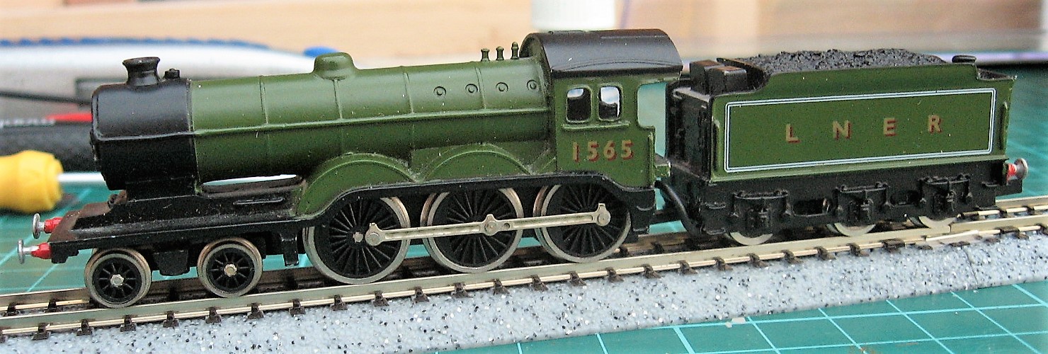

So... this smart little thing arrived today,  £35 on eBay as spares/repair due to disconnected wire.  I took a chance as always wanted one of these - my favourite loco as a kid was my Triang B12.
The first UM loco I've ever encountered "in the metal" so-to-speak.  Heavy ain't she?!  I can see the design influences from the good old Peco Jubilee (another loco I've re-acquired recently to satisfy old memories of my British N days).
Up and running in a couple of minutes of course - am I correct in my diagnosis that the wire is simply held in place on the loco by passing through the small hole and secured by the rear chassis plate screw?
A bit hesitant at first, but a tiny touch of Power Lube on the loco axles under the cover plate and away she goes.  Might need a new traction tyre at some point, there is a slight wobble.

...am I correct in my diagnosis that the wire is simply held in place on the loco by passing through the small hole and secured by the rear chassis plate screw?
Yep, absolutely correct. I try and make sure that there's a good length of exposed (soldered) wire in there as a short length may result in pick-up problems. Aside from that, if you take the loco body apart, make sure you put the driving wheels back the right way up and the right way around, otherwise nothing will work. Don't ask me how I know this...

... make sure you put the driving wheels back the right way up and the right way around, otherwise nothing will work. Don't ask me how I know this...
Yep, first thing I checked when she didn't want to run after replacing the wire.  I'm familiar with the arrangement, same idea as the Peco Jub.    As I say, just wasn't picking up well through the driving axles but a pinch of Power Lube sorted that!
