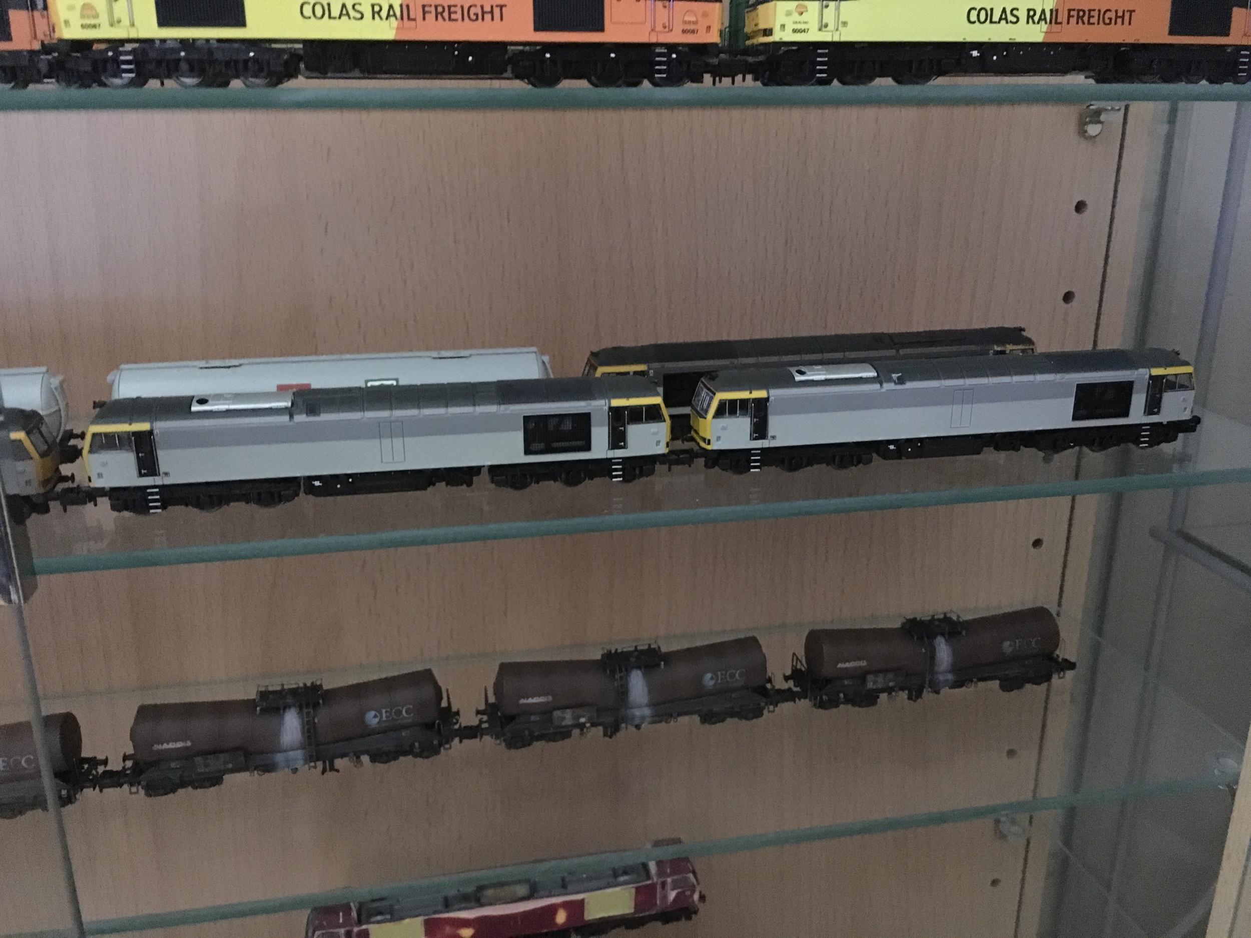

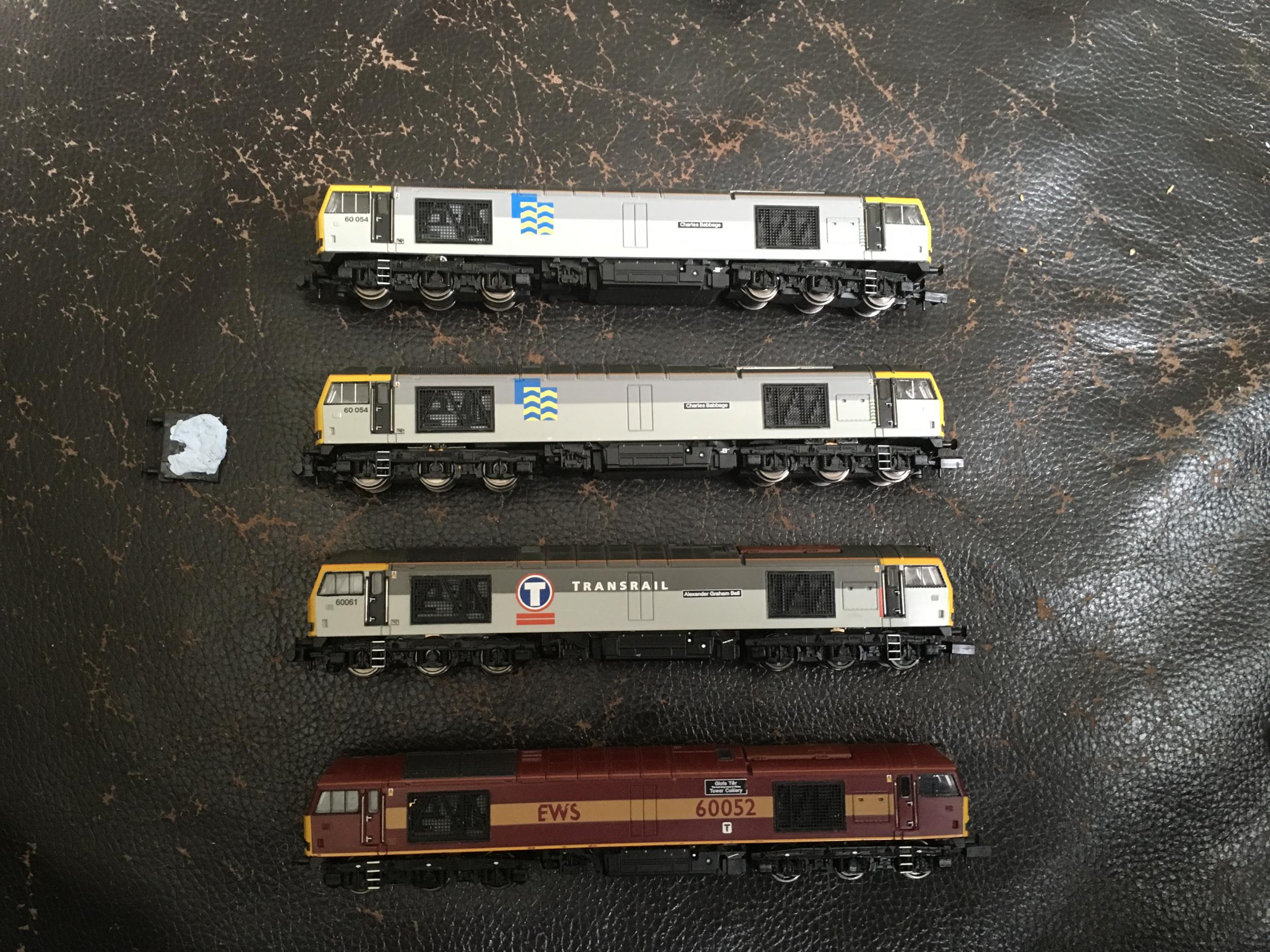

Been messing with some more locos lately, yes they are all 60's
Thought I'd add to the collection with a few more using a mixture of precision labels/ railtec transfers and soon to be used Fox transfers.
With the distinct lack of DB red 60's on the market I've been concentrating on making up some EWS ones instead and today I took delivery of the two first two tone grey donor locos to be renumbered.
I've also made the decision to not just concentrate on the current locos liveries but try to recreate them as best as possible.
You'll notice I've modified a 60078 next to the modified 60052 to remove the mainline markings and numbers to replicate the pinstripe line and also add the beasties. I've even gone as far as painting part of the roof silver to replicate the current roof on the certain panels and weathered those panels with mig powders to represent rust on the aluminium panels.
As for the 60052 base model you can see I've changed the number and added the plates to recreate 60065 Jaguar including the faded numbers.
I've also taken receipt of 2 of the 60054 models with the nearer right top grey colour to recreate some of the current 60's in grey.
This time I've used instead of enamel thinners to remove the markings I've used T cut as you will be aware is used to polish your cars but if you didn't know is a good cutting compound for removing ink from the models but minimising the risk of damaging the paint work if you aren't as careful as you should be.
 The top two are what I started with. And in the next picture you can see the results using T cut.

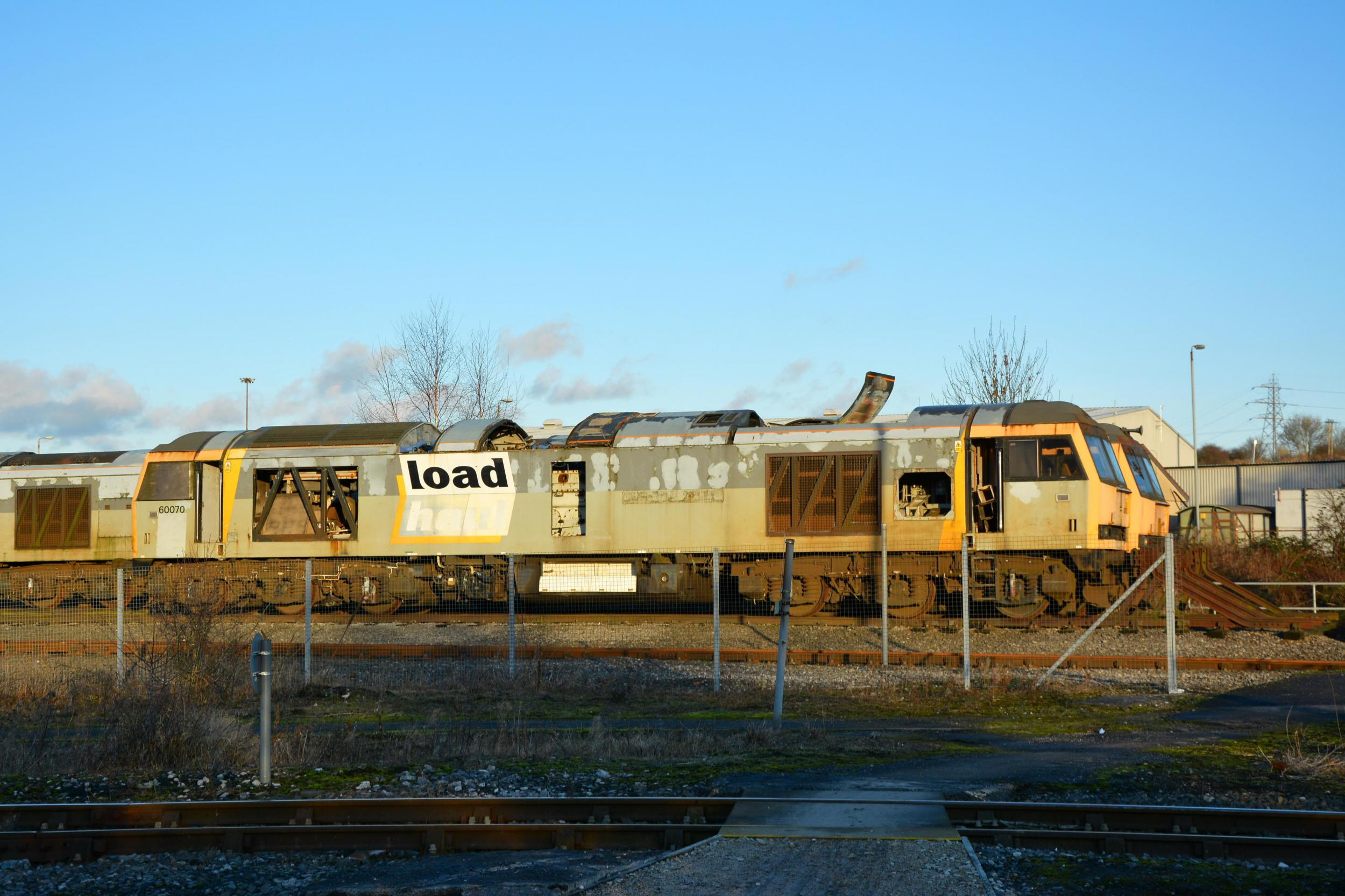

I'm hoping with one of the 60's to recreate 60070 which was my last class 60 I needed a picture of and I got yesterday at Toton.
I've already got some faded loadhaul transfers from precision labels and some of the standard  Loadhaul transfers from Fox. I'm going to use a mixture of both to try and recreate it best I can but obviously in a condition that if it were still to run it would have all the panels intact but could still look this sorry with faded markings on the side.

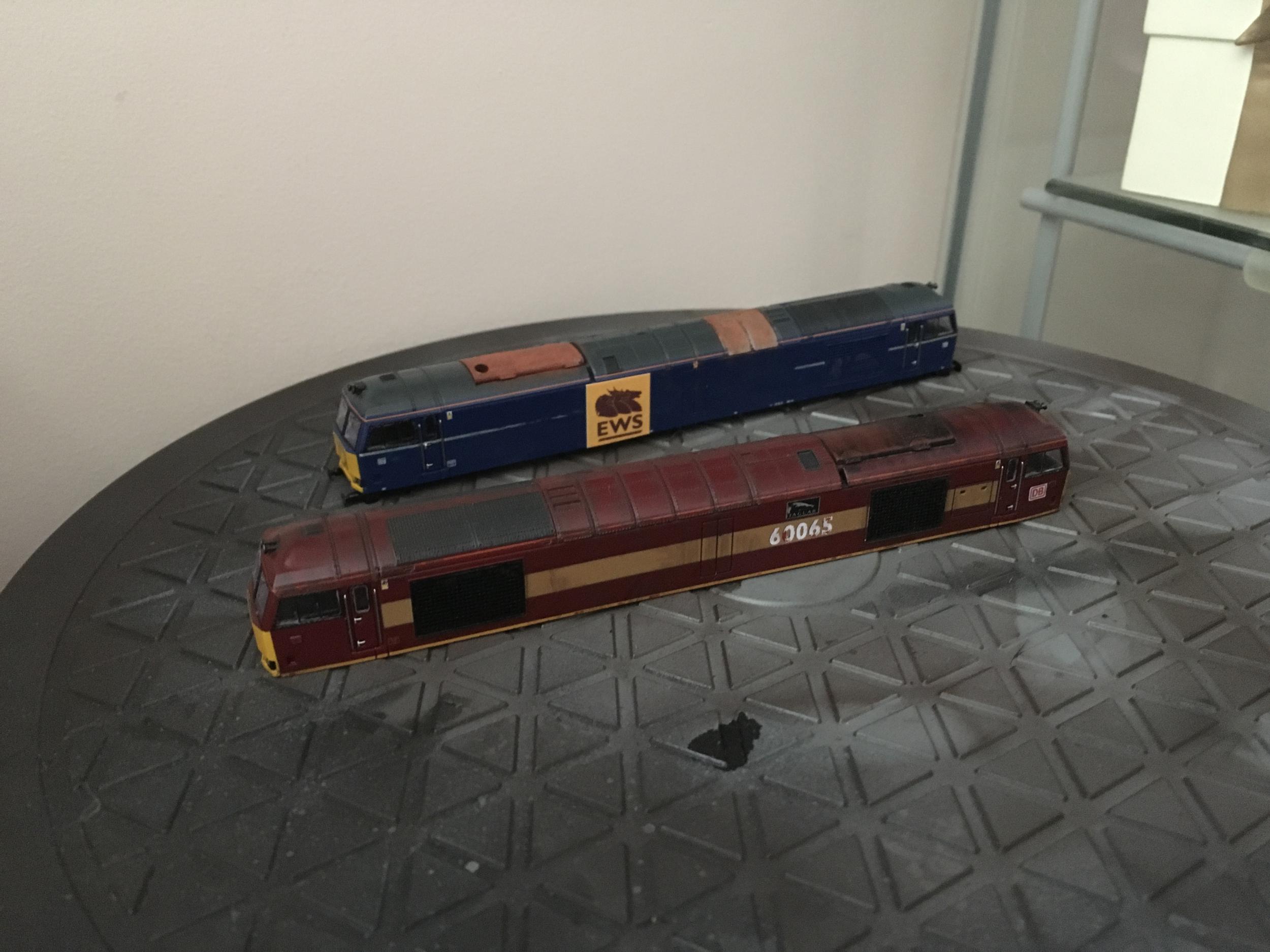

Well since my last update things have been a bit quiet as I've been messing with the new layout getting it working and slowly getting the fleet converted over to dcc.
I have done though a renumbering job on a 60052 body I had. Renumbered to 60093 including the white kingfisher logo on one side like the real thing had applied.
I have as well taken the plunge to try my hand at repainting some spare 60 shells I was wanting converting over.
I stripped a 60061 body back to the bare shell using the Dettol technique as well as a 60078 body as well. Making sure to remove the glazing and grilles so to help with the painting.
I've gone for doing 60022 in its ghost livery and 60033 in the corus silver livery.
I've used Wlkinsons grey primer for the shells and after a failed attempt getting the yellow ends right I'm at a stage I'm happy with.
I've received the transfers set from Fox for the Corus livery and some cantrail lining I've also got the 3D plates from Railtec which should be arriving any day and when they do arrive I'll be getting on with putting down the gloss coat on the soon to be 60033 so I can get on with applying the transfers. As for 60022 I've spoken to railtec about getting the numbers set for 60022 taking into account the spacing between the numbers on the sides.
I've also got in the works a DB 67 which I'm waiting also from Railtec for the new numbers and new wordings applied to the sides and that will be getting gloss coated at the same time as 60033.
I did run into a bit of a problem when removing the DB schenker markings off the side as I didn't take some helpful advice from a friend.
But after getting some replacement DB red acrylic paint I'm pretty much happy with the look of it. You can still just see where it's marked but I'm hoping the new transfers will hide those bits and with a bit of weathering it'll be hard to spot.
