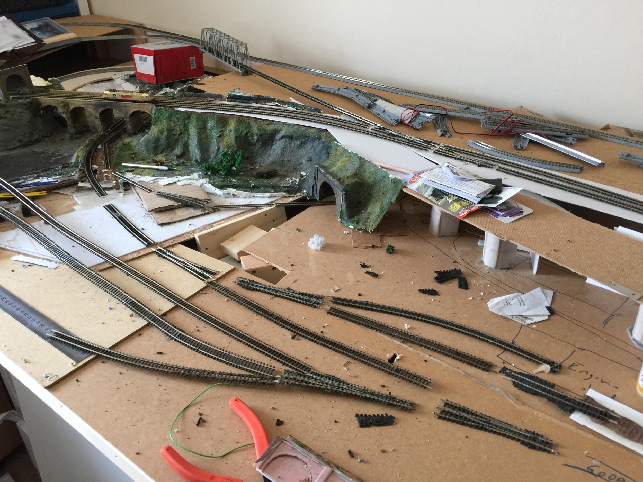

So, on with the reboot of Ivebridge. It's a little smaller than it was as it's sharing my office, but I'm using the rebuild as a chance to improve the running (and simplify control a little). It also gives me a lot better chance to redo all the pointwork to make it practical to do servo control.
Having done the new track plan I'm now partly ignoring it and laying out a rough idea of where everything will be. Main lines run in a loop on the top level with a branch off to connect to the goods line (also a loop, but at the lower level) and goods yard at the front.
A small narrow gauge layout loops around under the bridge with a siding going off to the shared engine shed.

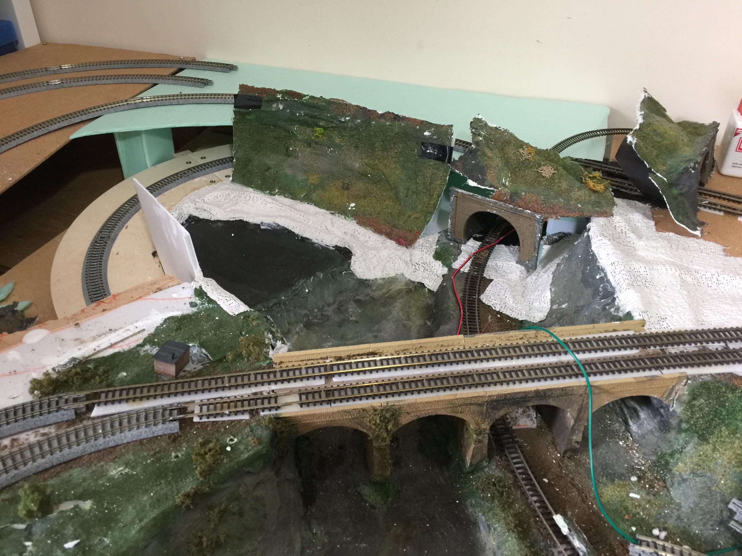

A little more progress. This section is mostly hidden track behind the bridge where the main lines are running back from the loop and the branch line winds down to run out.
I'm recycling as much material from the old layout as possible, thus the tunnel bits and panel (which will be removable for track access), I'm extending the river back into the board slightly too, with a small weir into what used to be a pool at the bottom of a waterfall and running back around the corner with banks/hills to hide the branch line loop down.
Once all the track is pinned down (the Z gauge rails still need to go in for the narrow gauge line) I'm going to build up the hill sections around the tunnel mouths and fix them in place and fix up the other joins to the removable panel, plus a serious amount of foliage to cover it so hopefully you'll not be able to see any joins ;)

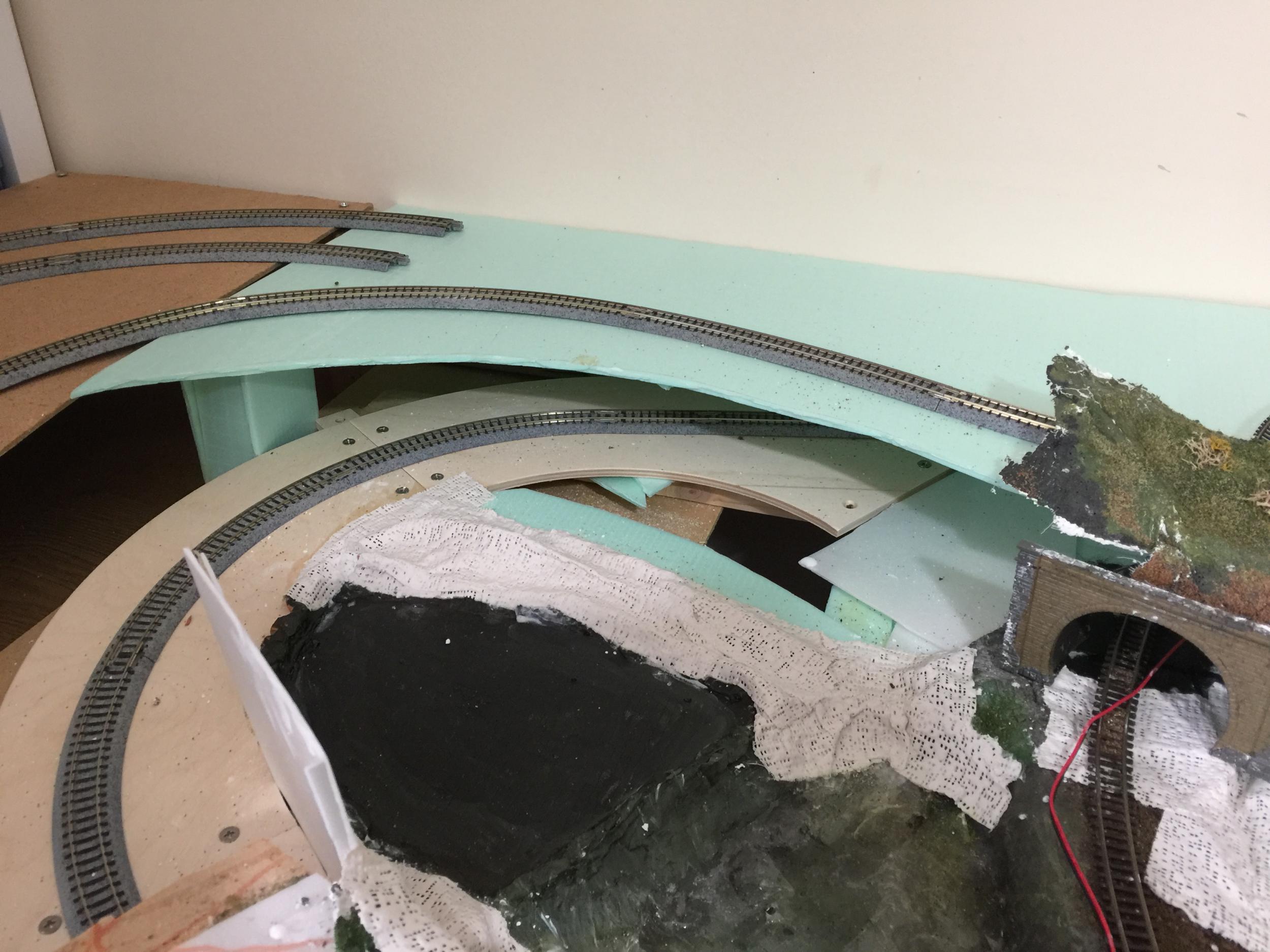

Here's a rough approximation of how the narrow gauge loop will run (it loops around the back) using Z gauge track
and yes, that is a home made N-Z crossover. Because I'm an idiot and wanted to make life difficult for myself :)
it's effectively insulfrog (well, balsafrog TM) and I'll be doing an isolating switch to only allow power to one track at once just in case. It should be enough for goods trains to run over in both directions in theory. The balsa will be painted black before I ballast it all
