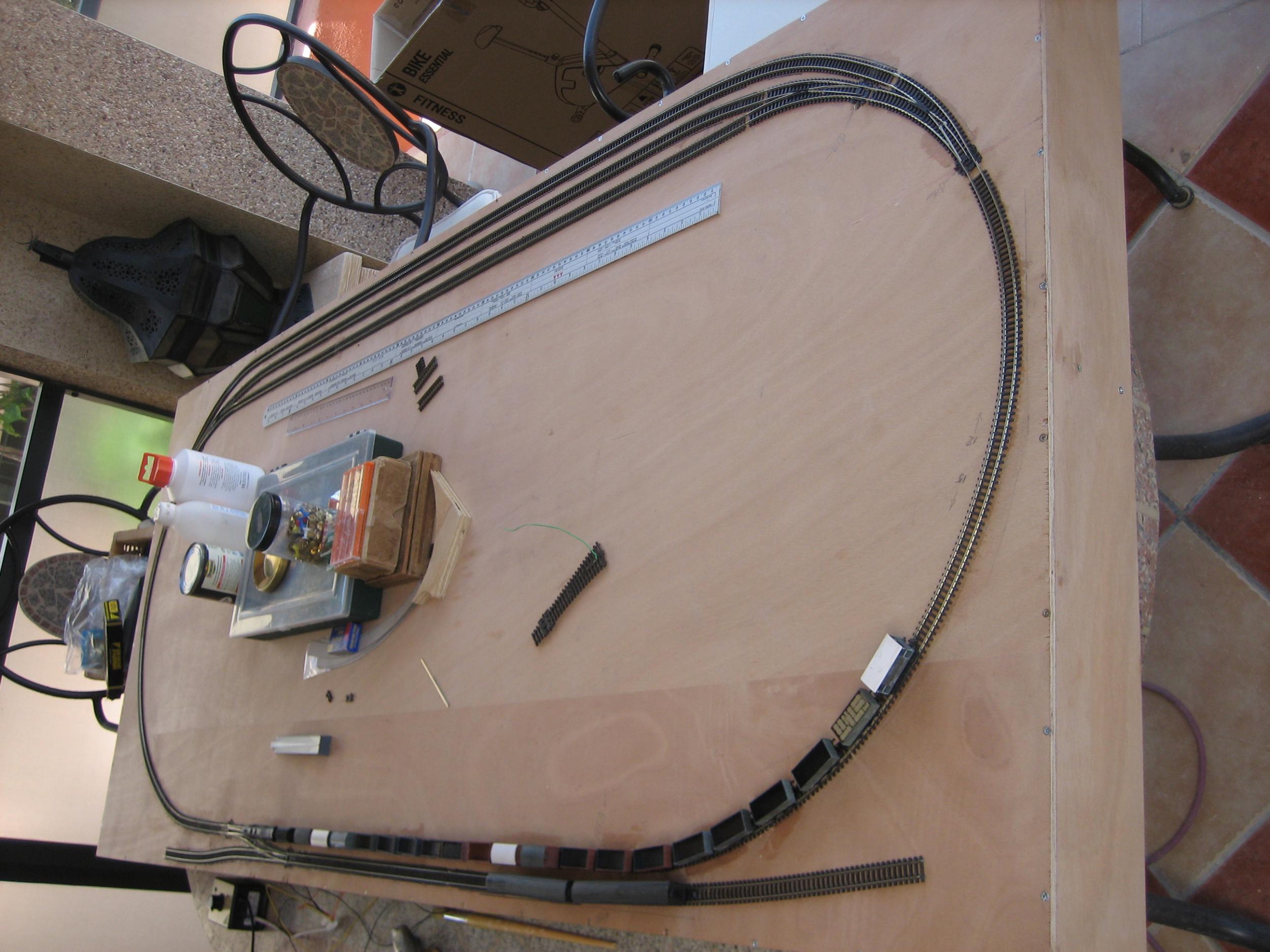

Time to display my efforts in front of a wider audience? Perhaps I should have posted my plan for comment but too late now!
Iíve read a lot of posts and replies by other members and, hopefully, learned a lot from them.
The layout will be a double track oval, BR Midland Region steam, on an1800 x 800 board. The board is 8mm ply construction. A simple station on a curve, a lay-by on the outer circuit and a basic goods yard on the inner. A total of six hidden storage loops, three to each circuit. The outer circuit is complete and hopefully Iíll attach a couple of photos to show this.  I ďchickened outĒ of laying a gentle continuous curve in the scenic section as Iím trying to limit the minimum curve to ďsecond radiusĒ in the hidden area and Iím not too confident about my track laying ability.  Iíve used Setrack curved points for the storage loops and will do the same on the inner circuit.  Visible points are Electrofrog medium radius and Iíve soldered a wire to the frogs in case I need it!  All track is code 80 flex as I obtained far more than I need at a good price from someone moving to 00. I read the arguments for and against cork underlay and decided to lay direct onto the board using Copydex.  Test running, forward and reverse, with a GF (Poole) pacific and fifteen wagons and so far all is well.

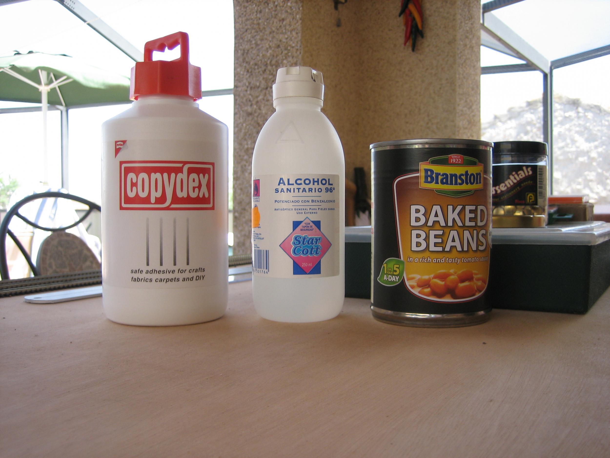

Nice start. What are you going to do with the baked beans can ?  :confused2:
As the track is being glued down with Copydex I assume the beans are just to add weight in the drying process.

« Reply #4 on: June 19, 2017, 03:32:49 pm »
Better solution - empty the can, fill it with water to weigh the track down and have the beans on toast while waiting for the glue to dry...

« Reply #5 on: June 19, 2017, 03:52:34 pm »
Doesn't take long for the glue to dry here Bob. I've tried the beans and spicy Spanish chorizo but not out of the same can.
