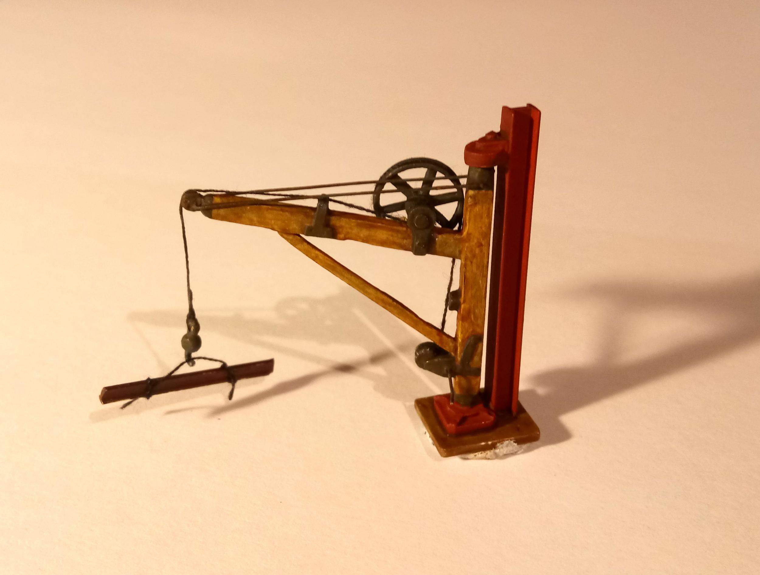

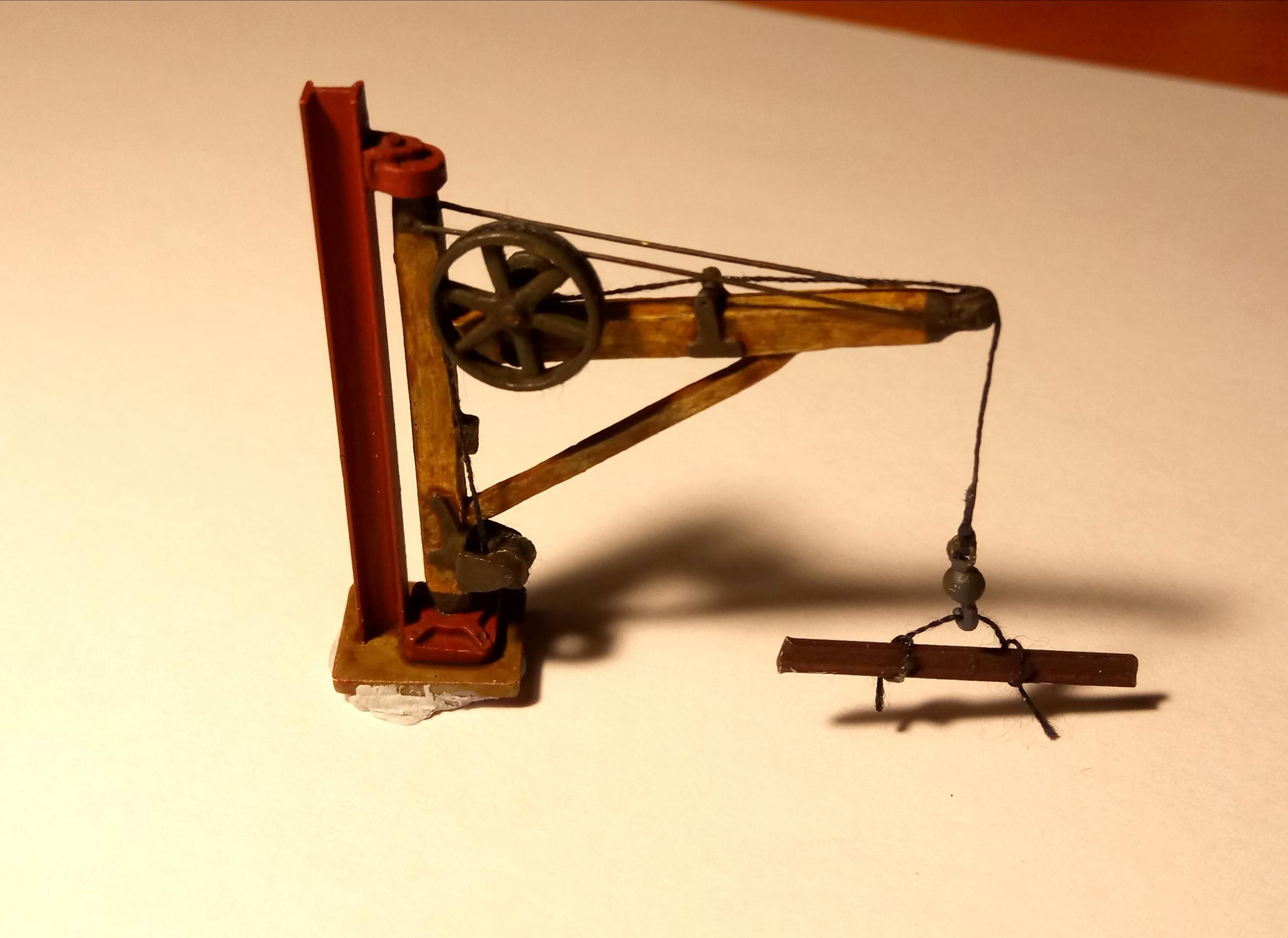

Several years ago I bought a Langley Models whitemetal Gibbet Crane (A97a) but without a particular project in mind. Moving house recently re-surfaced several "useful one day" items, so I decided to build this as a canal-side goods hoist for my colliery layout. Theres a similar crane at Audlem that looks very impressive, but it's actually a static transplant from inside a railway goods shed.
You can get the kit for £4.50 + P&P and it comprises 6 components and a piece of twine. Just Glue/Paint/Plant then .... well, maybe not...
I didn't want to begin until I'd got my head around the way the rigging worked. There's a rigged example at the NRM, which I'd foolishly only photographed from one side:
Flickr provided the reverse view, but it still puzzled me - what were those loose ends of rope about?
A discussion on the Scale four website provided some useful information and links, including these to a crane rescued from the Stranraer Goods Shed.
I decided that my bottom crank and windlass would wind one rope connected to the large pulley wheel. The large wheel winds a second windlass, with a second rope, along the jib to the hook. There's a ratchet wheel on the lower windlass assembly, so I assume that the weight of the load/hook unwinds everything once the brake is released. I realise I should have checked my logic with you guys at that point!
My example had a lot of flash and distorted bits, so needed quite a bit of shaving,  filing and filling to get everything clean and ready. I couldnt see how the windlass location would allow a rope to wind cleanly to the large wheel, so modified that so it could be offset in-line with the wheel. Naturally the moulded crank handle broke off with handling, so I replaced this with bent wire.
Most of the examples I found (and indeed the Langley OO model) had tie-rods from the vertical post to the end of the jib, so I drilled through both and fashioned rods from handrail wire.
As I wanted it free-standing, and I wasn't convinced an unsupported gibbet would have been much use, I did some head-scratching, and decided a vertical RSJ would be plausible at a colliery, and trimmed the wall-mounting pivot to secure the top of the vertical post.
Dark-grey primed, then the woodwork white washed, then brown stain (Games Workshop Sepia) painted all over. The support girder was finished in Halfords red primer, also stained.
So, price-of-a-pint for about a week's fun, so very good modelling value for money!
