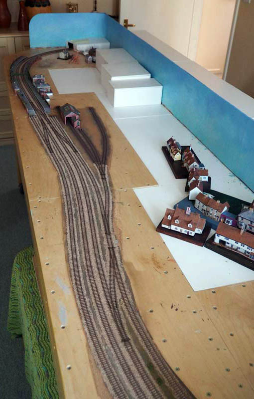

Pausing only to say thanks for the kind comments...
After a pleasant few summer weeks’ work in the garden and with the baseboard complete it was time for…
TRACK LAYING.

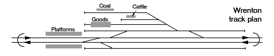

The intended layout was a fairly classic design, I think. It has double track roundy running lines, a refuge siding on one side, a goods yard on the other and a fiddle yard hidden behind the back scene.

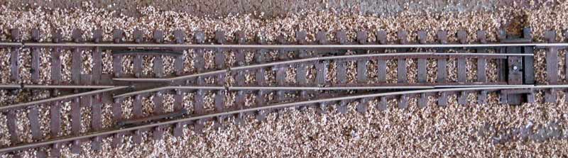

I used Peco Code 55 with electrofrog points layed on ⅛” thick cork using PVA to fix it. Every piece of track no matter how small had droppers soldered to the underside of the rails and connected to the power bus. Control is DCC using a Prodigy Advance 2.
The points are operated by Cobalt motors. As they require that the spring in the points should be removed I also cut away the housing for the spring along with quite a lot of other plastic around the tie bar area. The dropper from the stock rails was bonded to the blades (strictly speaking the closure rails, I believe). I cut through the closure rails close to the frog and switched the polarity of the frog using the switch built into the Cobalt. Here’s one of the points after ballasting:

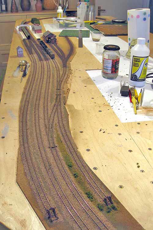

The track in the scenic area was laid by September 2014 and ballasting was well under way when I took this photo at the end of the month:
I used Woodland Scenics fine ballast, mixing two parts of buff to one brown. It was fixed with WS Scenic Cement – no need to thin it or pre-soak the ballast as is the case when using PVA.

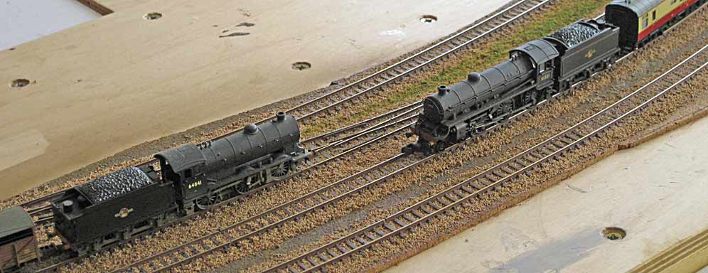

And now there were trains:
The next two photos show how the layout looked in mid-October 2014 with the ballasting complete.

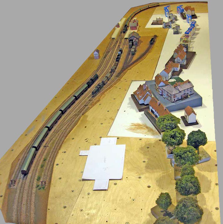

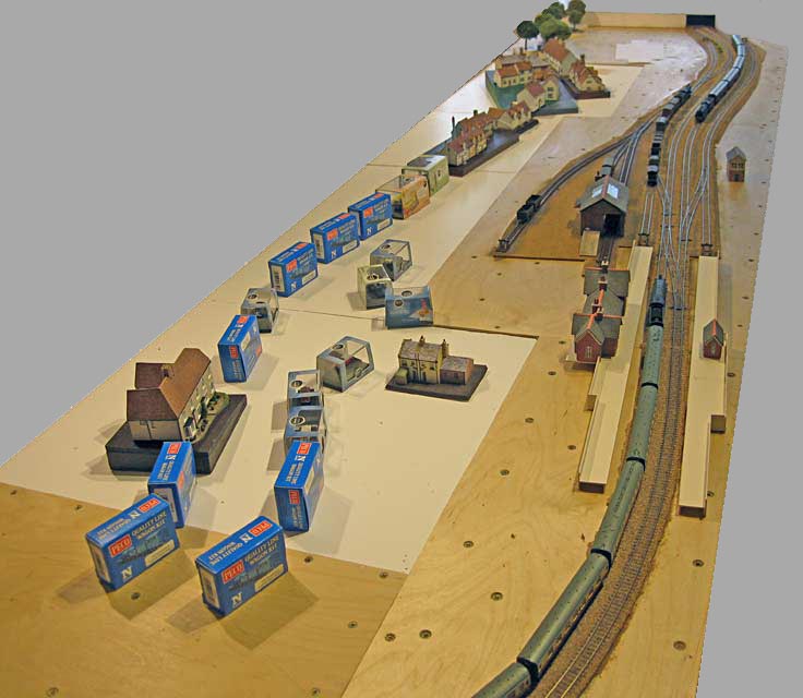

In order to get an idea of how the buildings of the village could be arranged I placed those already built and used small boxes (which will probably look familiar to you) to make up the numbers. I’d made up a couple of Metcalfe kits – the country station buildings and the goods shed – and also some crude (and short) platforms. These would be replaced with scratch built structures in due course. The white shape in the foreground of the first picture is the footprint of a church. Clearly too large, the church had to be shrunk somewhat, but that’s another story.

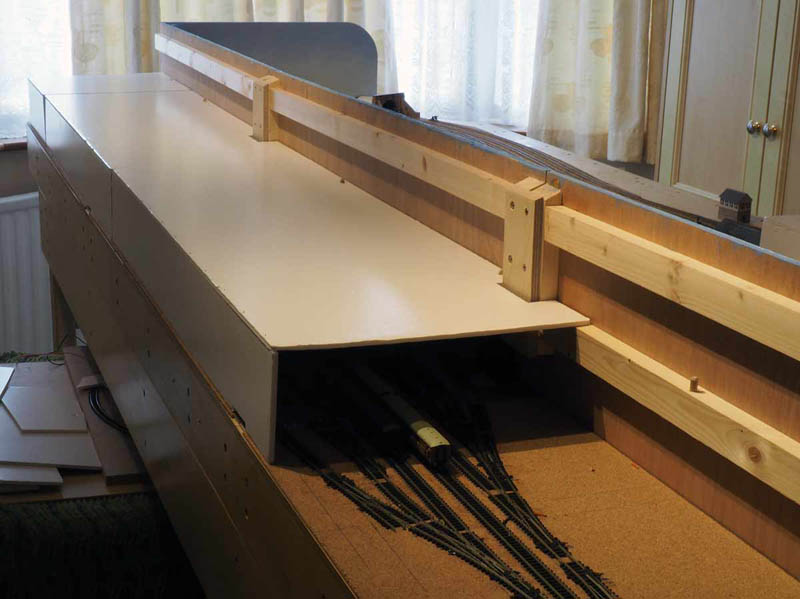

There was one important change of plan during the track laying process. Although I had worked out how big the baseboard could be to fit comfortably in the room, a way of lengthening it slightly came to me while I was laying the track. At one end of the room is a curved bay window. Routine access to the windows wouldn't be compromised if a small, round extension was hinged to the end of the baseboard so that it could be lowered out of the way when necessary. Tight fitting hinges were used to minimise risk of mis-alignment of the track. The extension is supported by a couple of wooden brackets which are also hinged to the end of the main baseboard.
The back scene will go at the end of the baseboard proper and the extension is usually protected by a suitably shaped removable cover made from 5mm foam board which is held in the right position by the two small white pieces visible in the photo.
This small extra length allowed the visible track approaching this end of the layout to take a gentle curve instead of a sharp left and it also added a few inches to the length of the fiddle yard sidings.

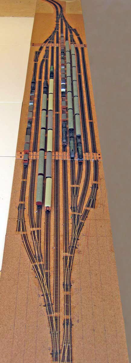

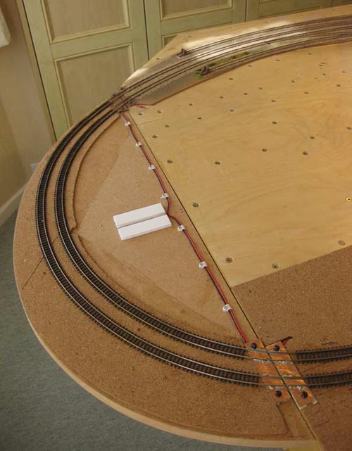

Talking of the fiddle yard, here it is:

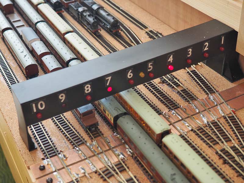

At the ends of each road I included a short isolated section, long enough to comfortably house the longest loco. The power to these sections is routed through the auxiliary switches in the point motors so that the whole route to the main line has to be set before the section is powered. This prevents accidental starting of trains when the required route isn’t set and, more usefully, stops a train when it gets back to the fiddle yard if another route has been set for the next departure. I find this makes operation easier as I can be driving a second train without having to worry about stopping the first one!
In order to help my ageing eyes to see more easily which route is set I added an indicator at each end of the fiddle yard. The LEDs are fed from the track feeds to the isolated sections. Red indicates go in this case – Maplin didn’t have enough green ones in stock when I went to buy them! The numbers on the display match the route numbers on the controller. Add ten for the routes at the other end of the fiddle yard.

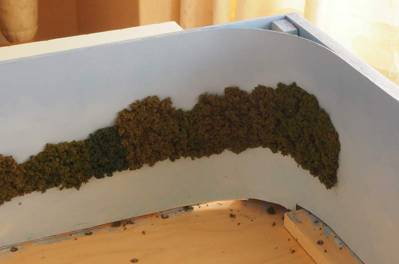

The back scene was made by fixing ⅛” plywood to the baseboard cross pieces with  about a foot standing above baseboard level. In order to achieve rounded corners I glued Daler board to the ply. This was in turn covered with lengths of thick paper which hid the joints. Not a very elegant solution but it seems to work. A suggestion of sky was then painted using artists’ Alkyd colours.
The Daler board corners can be curved to quite a small radius. In this later photo the corner has some clump foliage glued to it – they are very low relief trees! And I'd re-painted the sky.
In order to keep the thin ply fairly straight two lengths of  timber were fixed along the back. These were screwed to the ply before the Daler board was glued into place. The lower of the two serves a double purpose, supporting some covers made of 5mm foam board which keep all the stock in the fiddle yard relatively free of dust.
