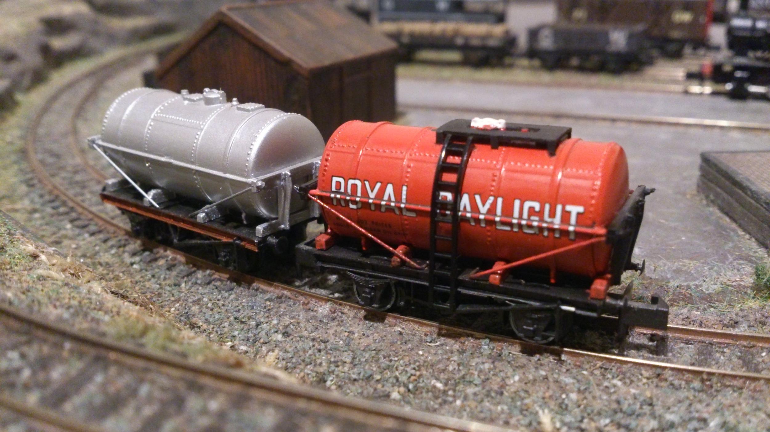

Anyway, back to the kit. Here's one completed next to a ready-to-run example, which I detailed based on a preserved example (Severn Valley, I think).
The model is quite heavily rivetted, and if you're working with the kit, you can keep or remove these as your prototype demands. These tanks were often assembled from three rectangular panels rolled into hoops, originally rivetted, but later welded together, with dished ends. Viewed from the end of the wagon the horizontal seams were arranged alternately at ~10 O'clock and ~2 O'clock. The kit (and RTR models, if you're careful..) can be improved by filing off the central horizontal seam on one side, and the two outer horizontal seams on the other. I've done this on the left hand example above. Incidentally, the Farish models get this wrong too, with identical  seams on both sides.

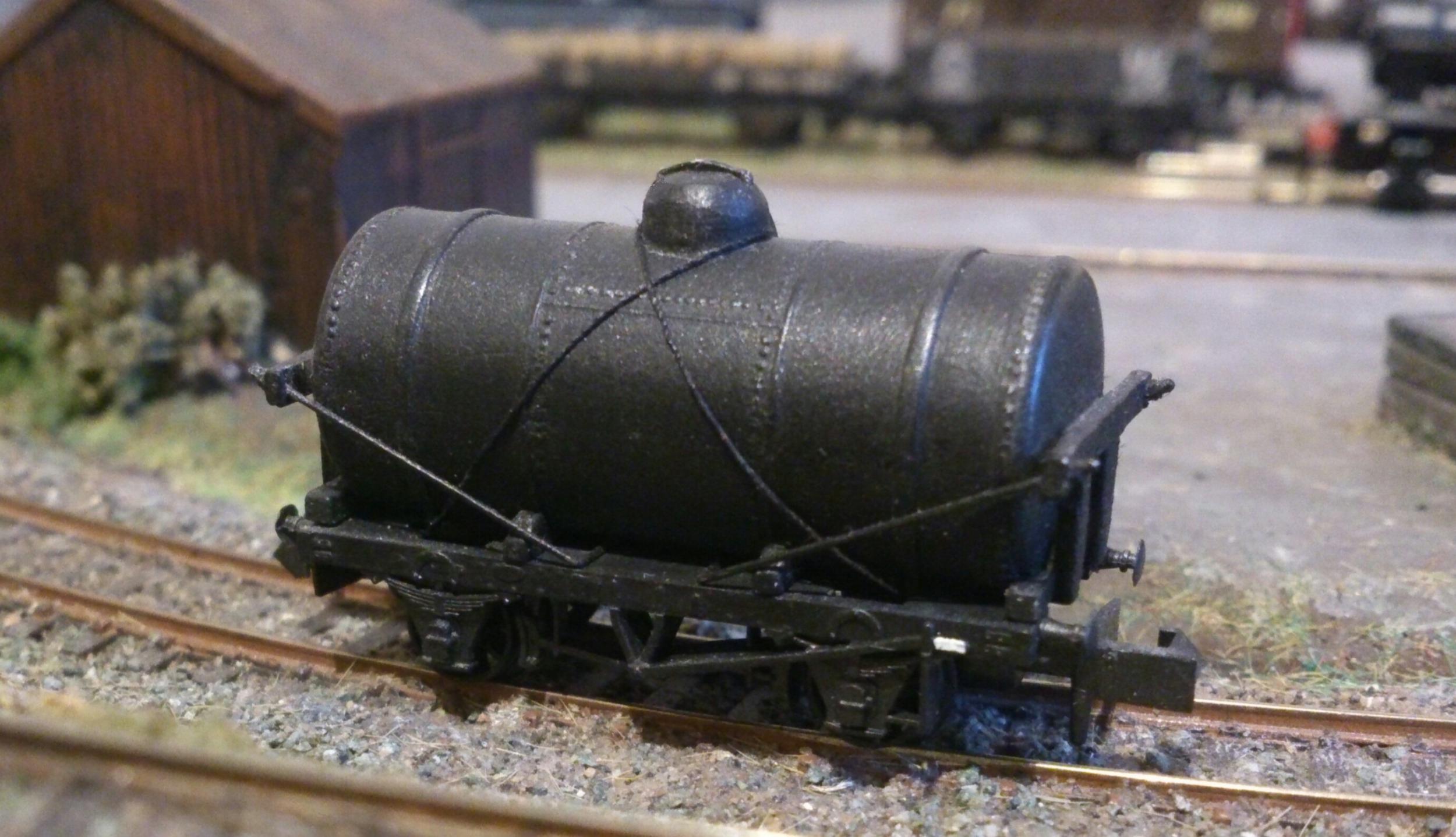

This model is based on a 1927 Railway Clearing House design. Their previous standard tank design had a large central turret for the filler, and the tank was secured to the chassis with diagonal steel hawsers, anchored close to the outer ends of the W-plates.
Here are a couple of examples of the latter I built, one from the kit and the other by judicious surgery and touching up of the Shell-BP RTR model, the turrets being filed from scrap sprue. The hawsers are loops of painted cotton, fed down through the wheel holes and superglued to either side of the coupling pocket.
Going one step further, you can easily model a Victorian-era wagon similar to this example by adding a fatter turret, substituting a "wooden" chassis and spoked wheels:
