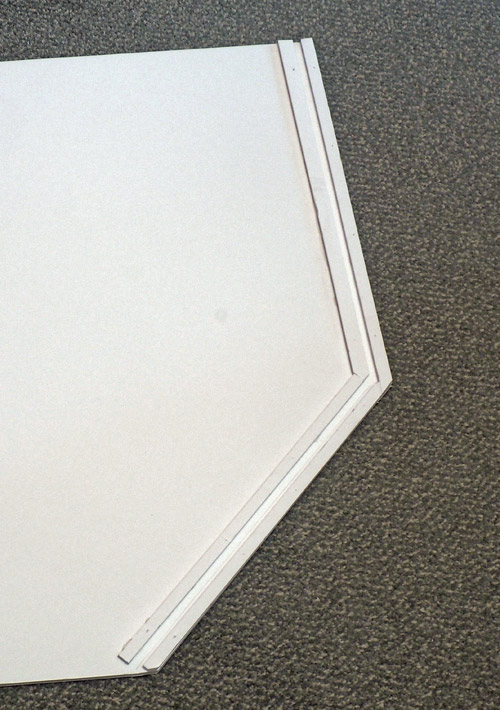

For a long while I covered the layout with black bin liners. This kept the dust off and the light out. I think the latter is as important as the former. With lots of home printed textures on the buildings I didn’t want them fading too soon. As a precaution I always use the printer manufacturer’s own inks – considerably more expensive than the so-called compatibles but much more likely to resist fading.

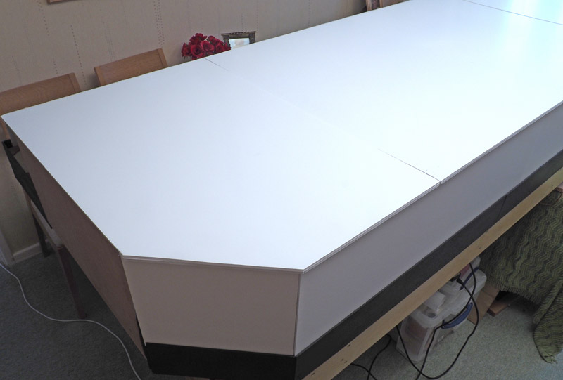

The liners worked fine, but there was always the risk that they might catch on something fragile when placing or removing them.  So I  made up this cover using 5mm foamboard.

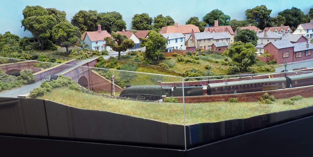

To support the side panels I added some strips of 3mm mdf to the sides of the baseboard to form a channel into which the panels would sit. I also wanted to support strips of acrylic glazing which would stand about 2” above scenery level to protect vulnerable parts at the front of the baseboard from visitors leaning across the layout to point out details of the cottages. I plead guilty to having done it myself. I’ve had to replace the tops of the station lamps a few too many times!

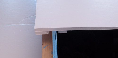

I cut three lengths of mdf for each front face of the baseboards. One was 1½” wide, the second was 3½” and the third 4”.

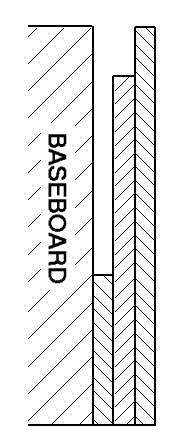

Here’s a cross section drawing showing how I fitted them to the baseboard.
The deepest channel takes the glazing. To add the cover uprights the glazing is removed and the foamboard sits in the wider, shallow channel at the top.
The covering foamboard pieces have narrow strips of board added front and back to form channels.
These locate the boards over the front foamboard panels and the backscene.
It only takes a couple of minutes to remove the cover and drop in the glazing.
So hopefully Wrenton is now protected from dust, light and fat bellies!

So I thought I'd prepare a couple more photos of the layout as a break. First a similar view to an earlier shot, though that one was taken before this area was 'complete.' The 4MT pops up again, pulling northwards out of the station.
As it passes between the road bridge and the tunnel mouth a rather too clean B1 emerges. The road over the bridge is rather narrower than I intended - I forgot to make room for the pavement! I guess it needs a line down the centre of the road - another job to do.
