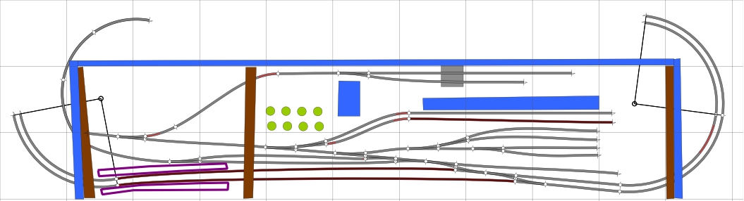

Here is the track plan

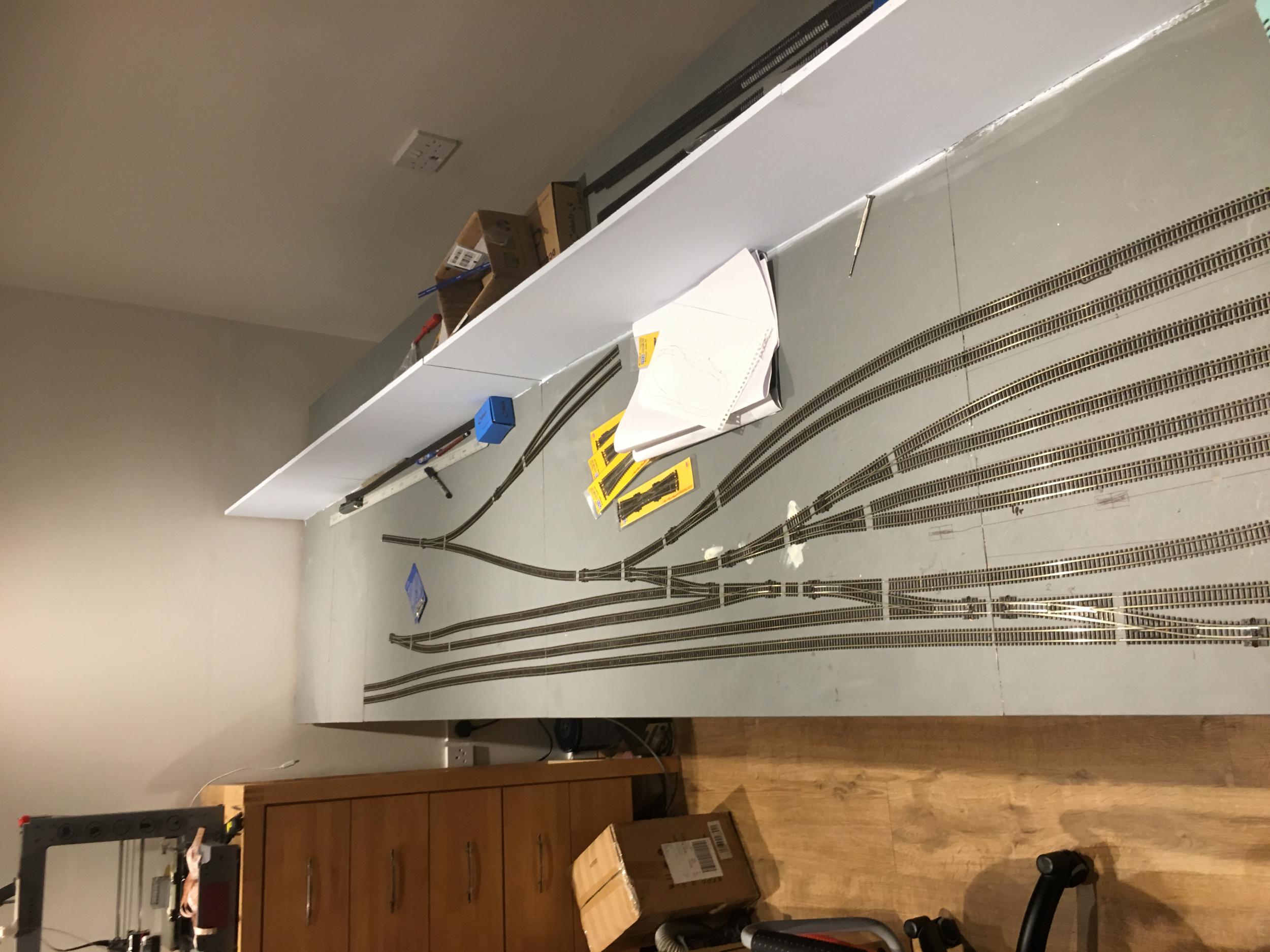

The layout boards are those I was originally going to use for the first plan, so sticking to 11ft x 3ft over four boards for portability I began to lay the track, all points are medium or short Peco code 55 Electrofrog and each is coupled with a DCC Concepts Cobalt IP Digital point motor.

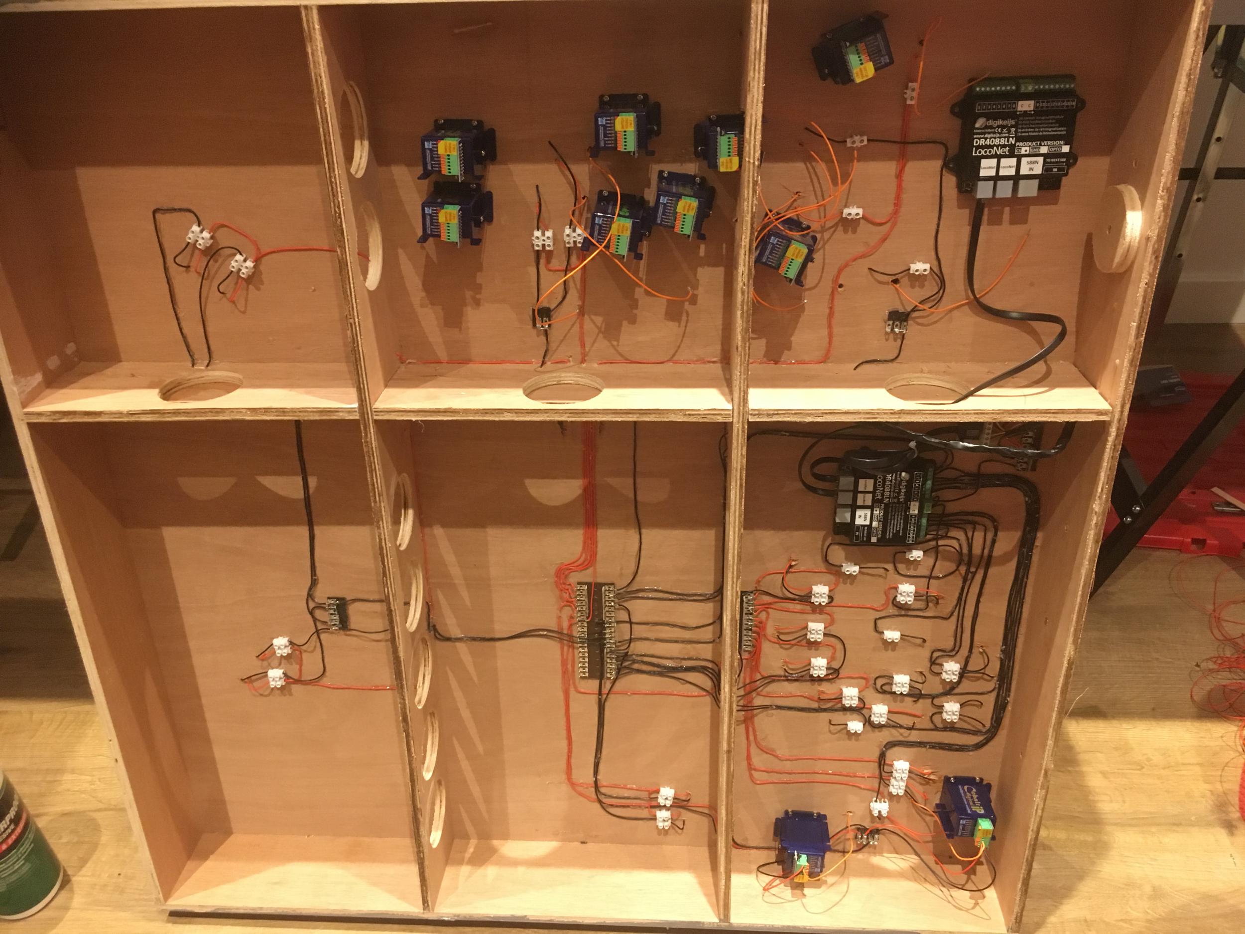

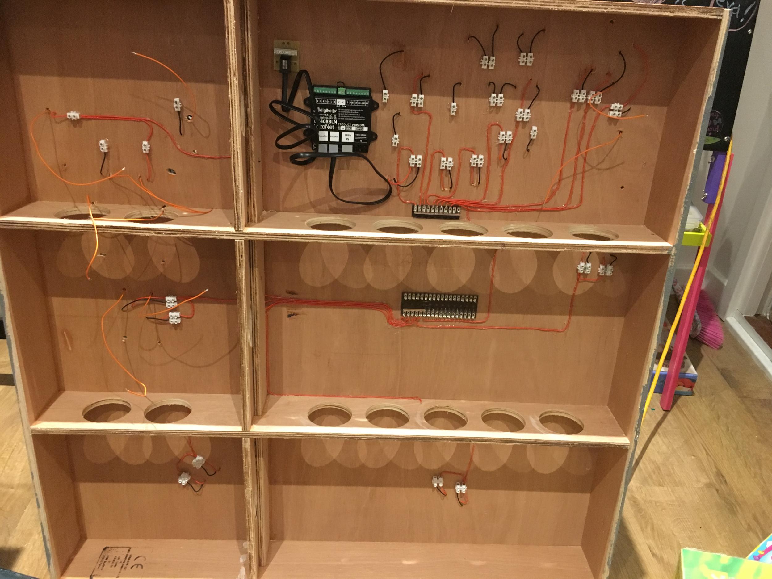

I want to try and make the layout as automated as possible, so for that I have two Digitrax DCS100 Control stations (one is used as a booster), these talk via loconet to a Digitrax PR4 (usb to loconet) device which allows for computer control using itrain or Traincontroller, the layout is built so each board is self contained with one or two block detectors located on the board to minimise inter board connections.  the layout is to be protected by a Digitrax PM42 power manager so that each board will have its own circuit breaker to avoid shorts and decoder destruction.

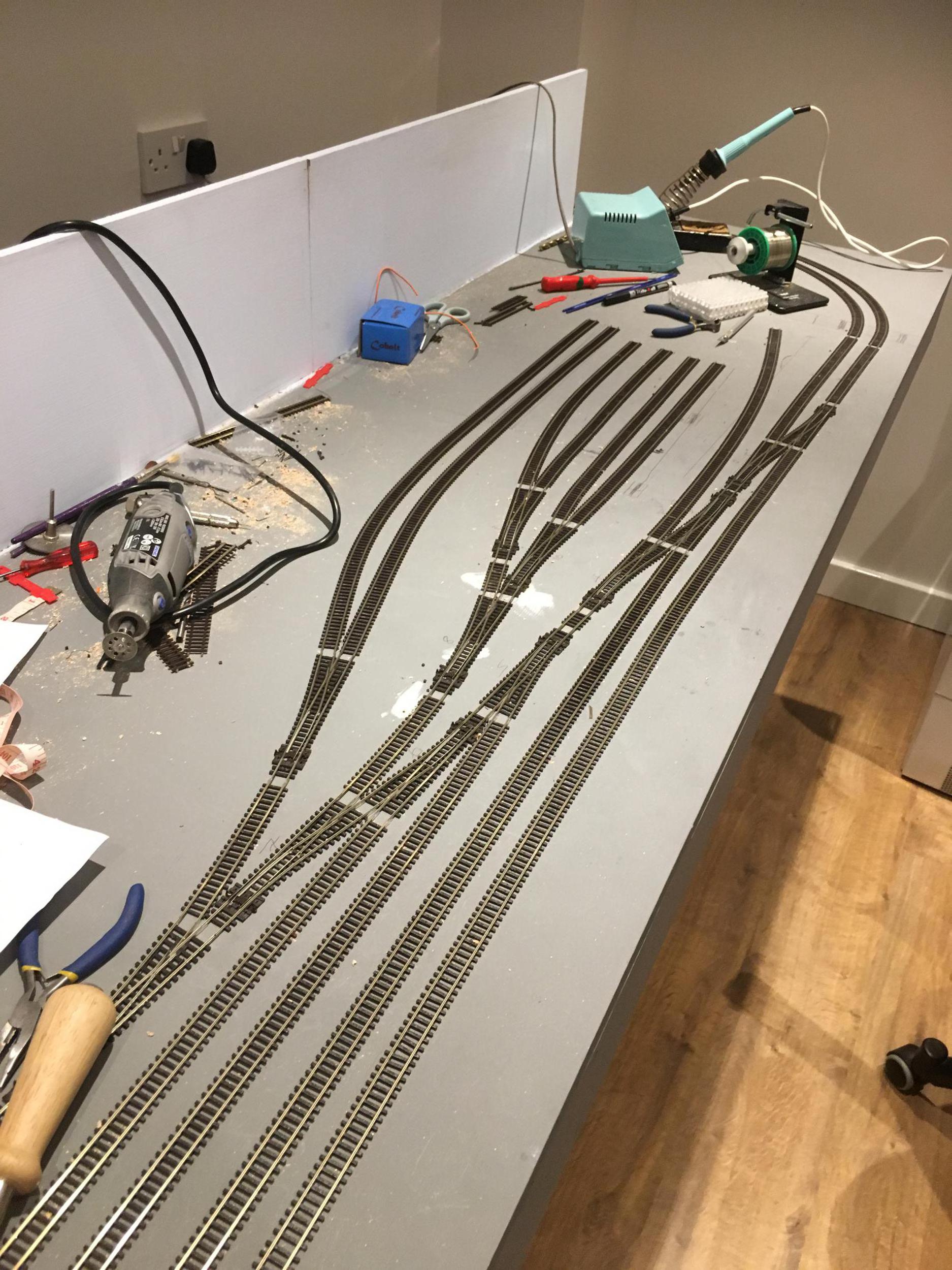

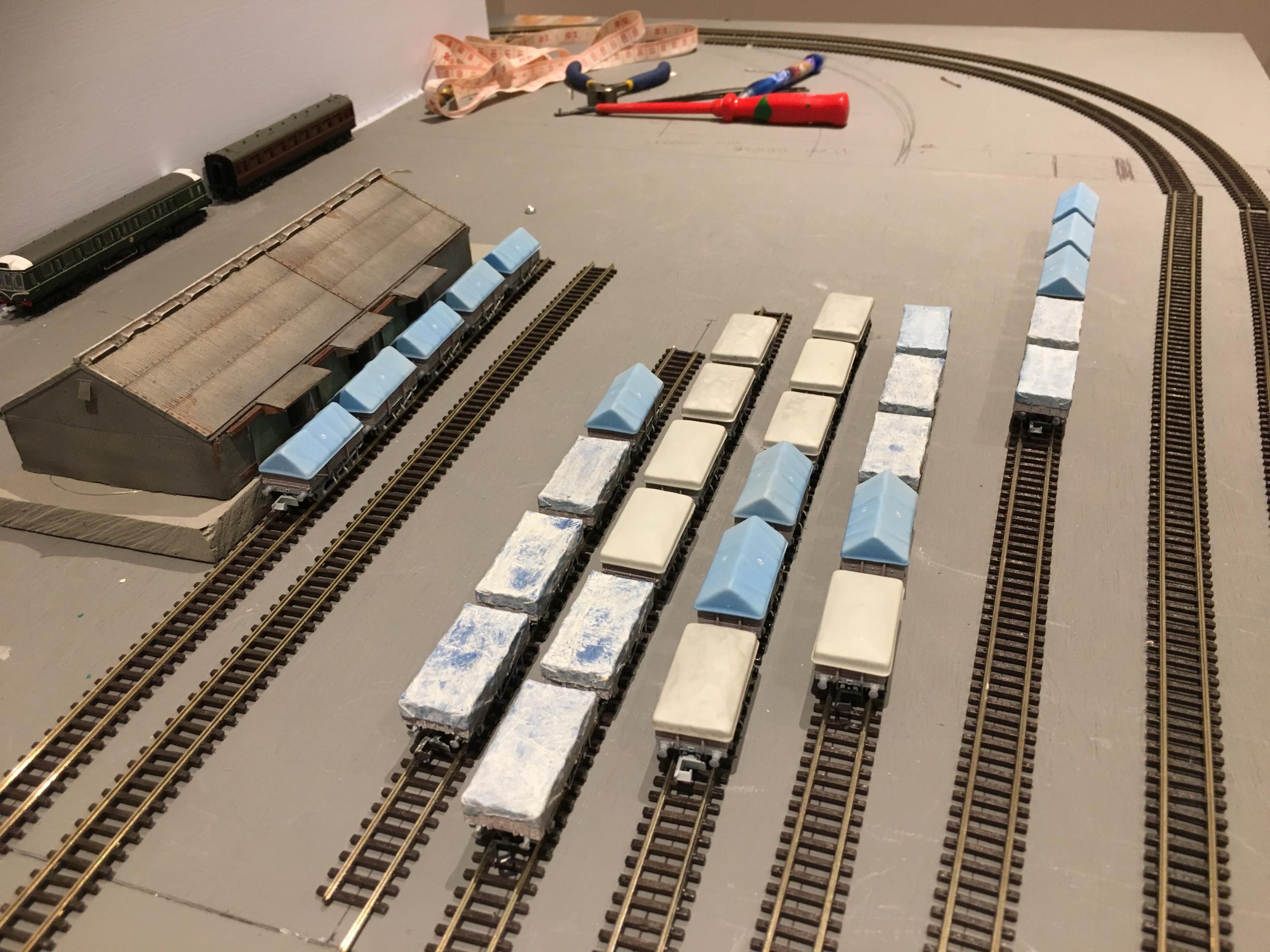

Below is the yard for the Clay sidings, some stock loaded on in order to work out where detection sections need to be and for placement of dapol uncoupling magnets...Whether or not this will work under automation is yet to be seen as each board has an unfortunate amount of wiring to install and glue down.
Currently it has taken three weeks of evenings to wire the first board due to the complexity of the block sections
(DCC is two wires someone once told me!!)
So there we have it a wired board one!
Not a lot of track for all that wiring eh!???  :o :o

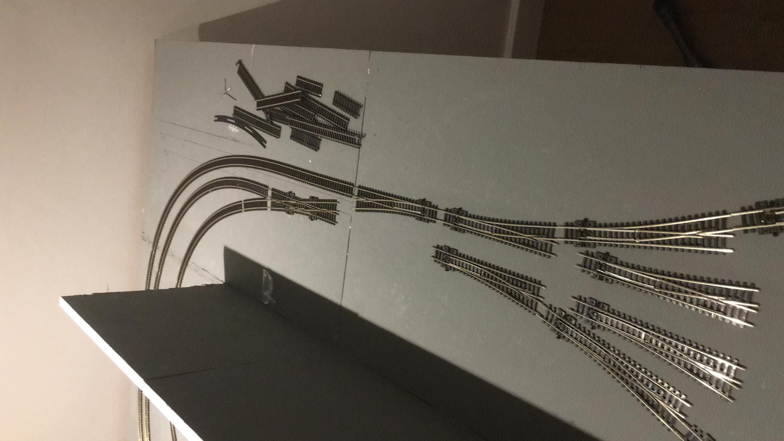

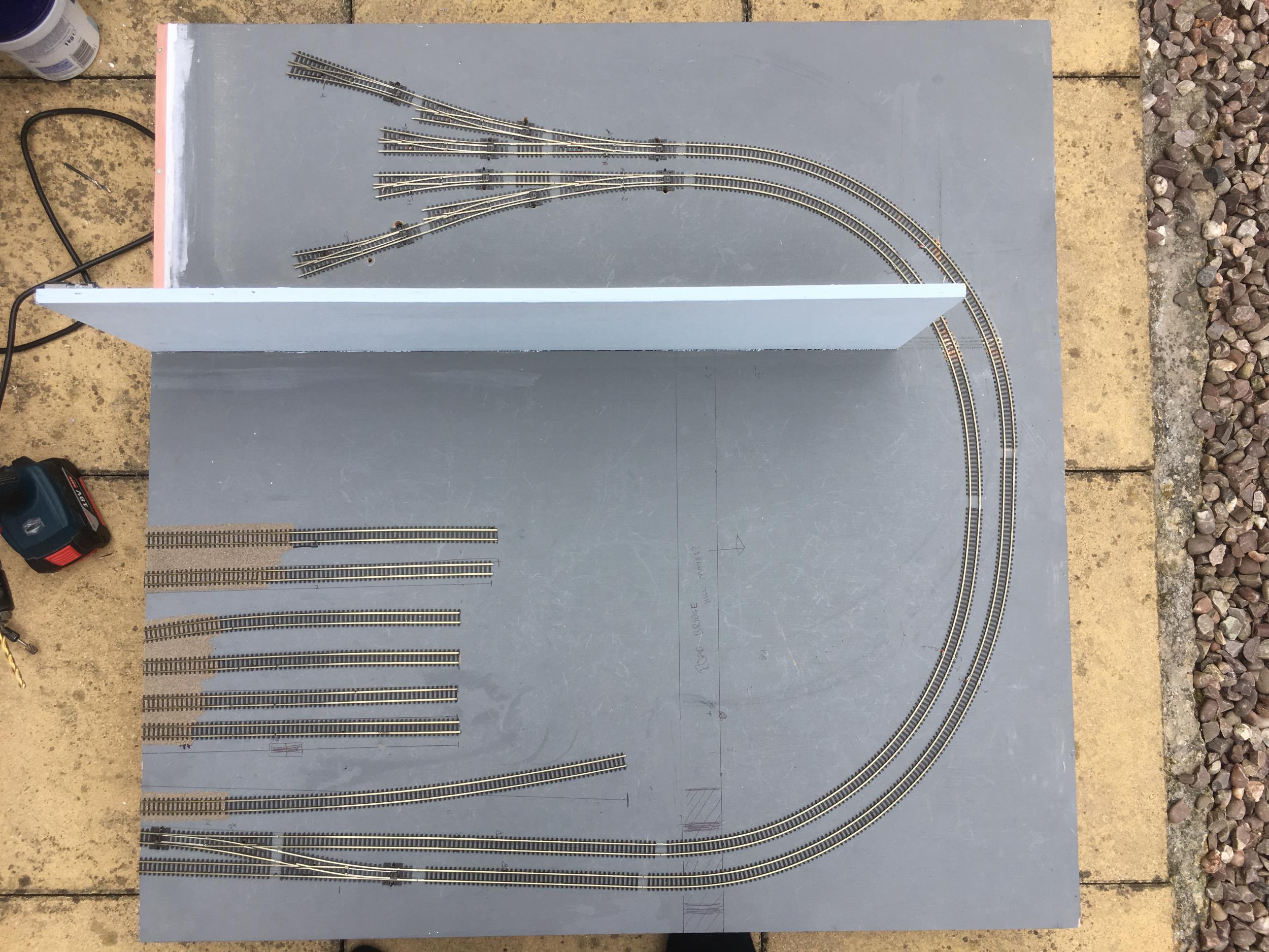

Here is a picture of the as yet unfinished Western end of the fiddle yard, I have yet to router out the edge of the boards and install copper plate to solder the track to

You might me wondering why there is only a small amount of ballast present, I did this to set the track in place so I could then razor saw the track as it crossed baseboard joins, I've found this to be just right for setting the track in place prior to cutting on other layouts.
More updates as I move forward, for now this is the only movement on the layout as board one is wired I was able to check the track polarity and move the first two points.!!

So a bit more work over the last few evenings, installing Copper strip on the edges of the fiddle yard boards to stop rails coming away, then soldering the track to these in situe and once cold using a razor saw to cut through the board joins.
Only another 120 solder joints to make !!!....
