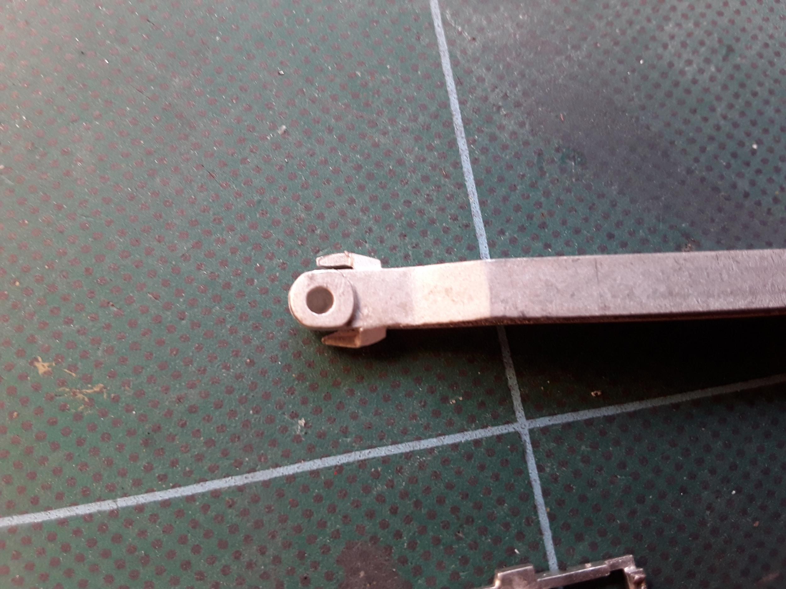

I was finally convinced enough to take the plunge and go buy an n scale kits 53' all purpose spine car kit -mainly because I wanted something different on the layout- and because I've not seen one in rtr form ( I'm sure somebody will either put me right or agree ???. Anyhow it arrived day after I ordered it ( posted same day 1st class no extra charge-its in the kit price ( suspect it's UK only folks? )
It comes with a colour assembly sheet ( it's not that complicated an assembly in my eyes )

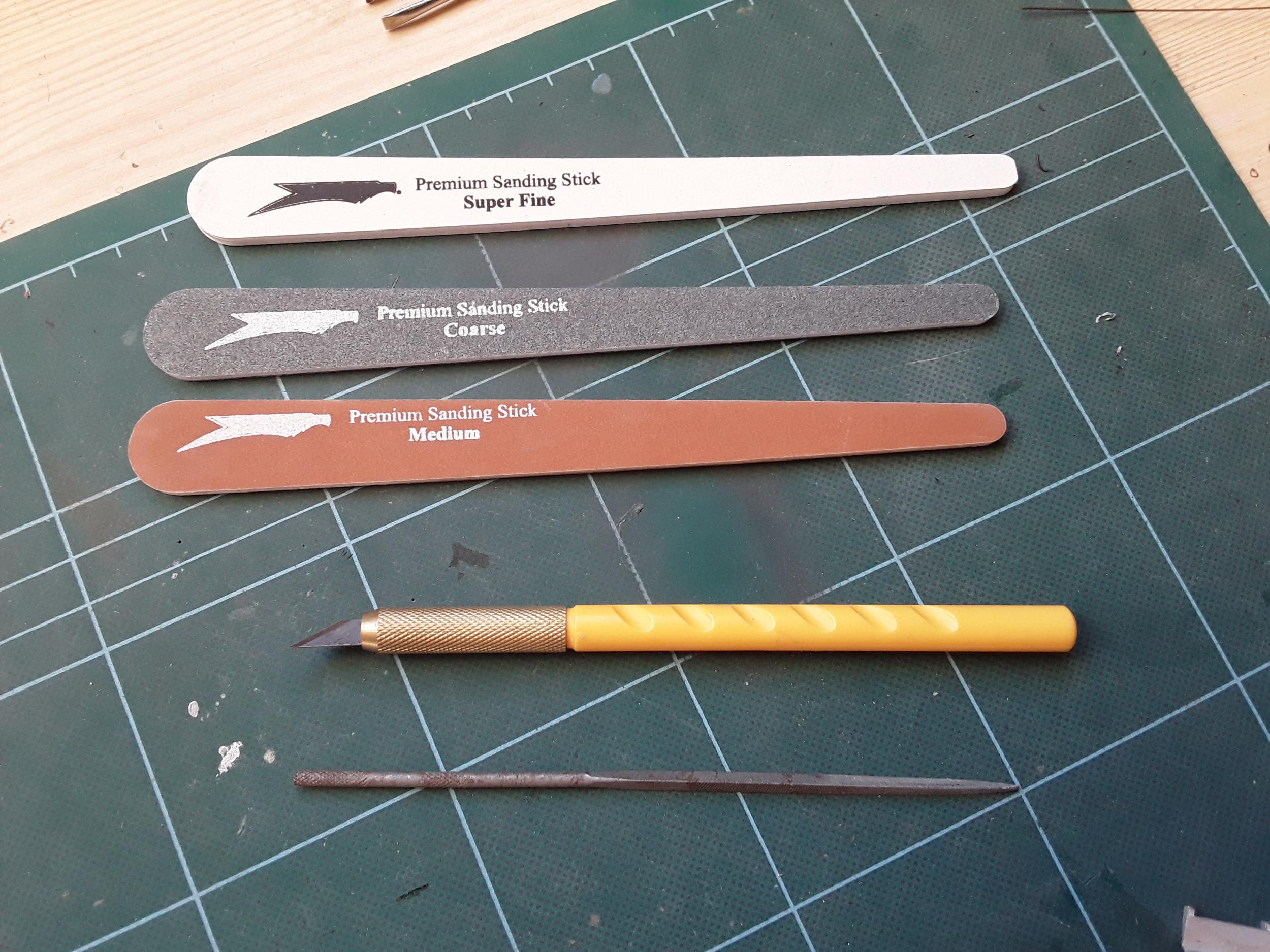

Being an ex 1/35th military modeller -i've come up against white metal, etched metal and resin parts before - so no shocks here. The kit is cast in pewter ( no lead involved) which is fairly easy to work with basic tools - my toolkit for this one -

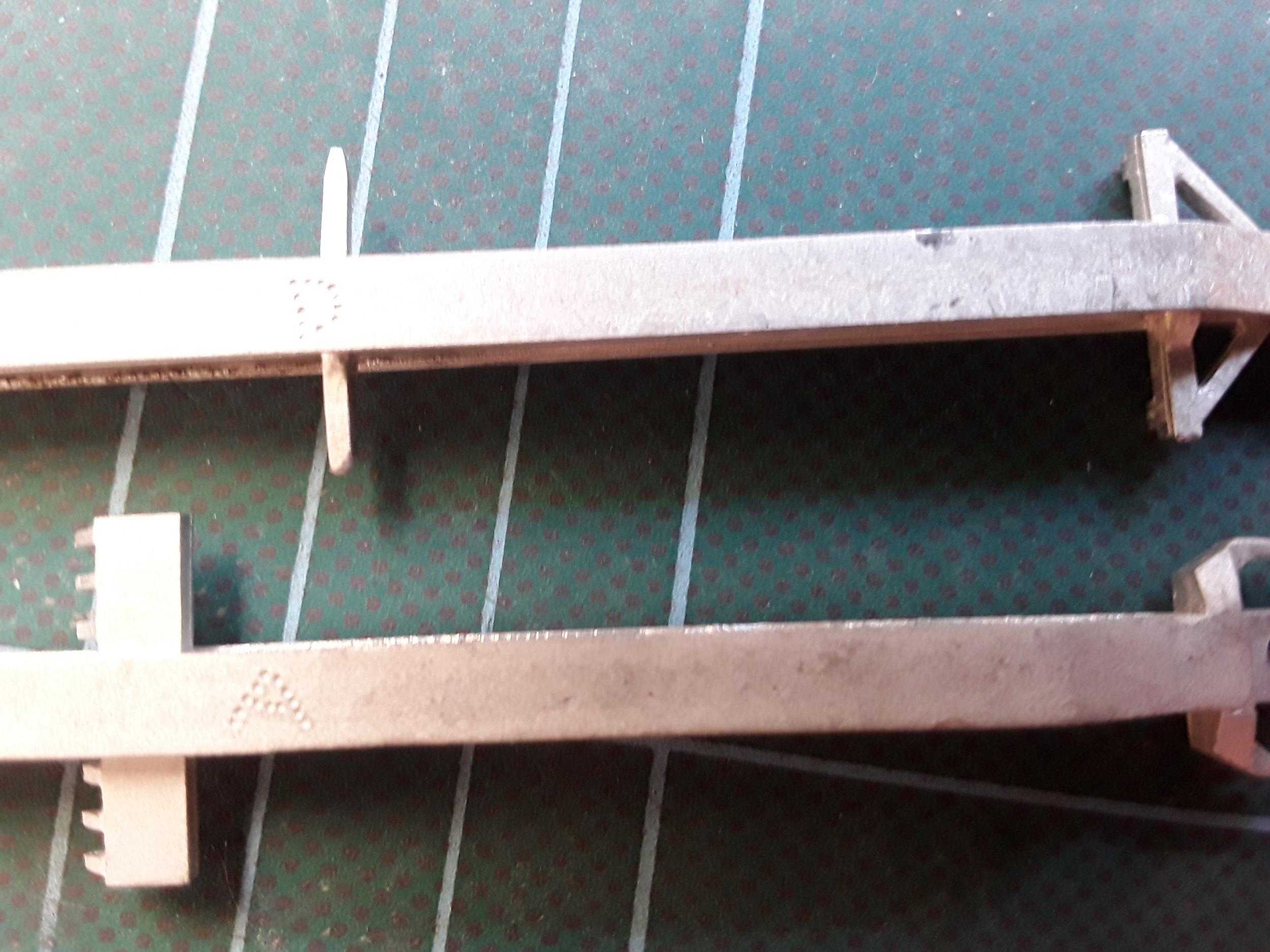

The spine parts are identified on the bottom with letters which is important (a) for the formation of the 5 car set and (b) not all of the spines have the same equipment fitted to the sides !

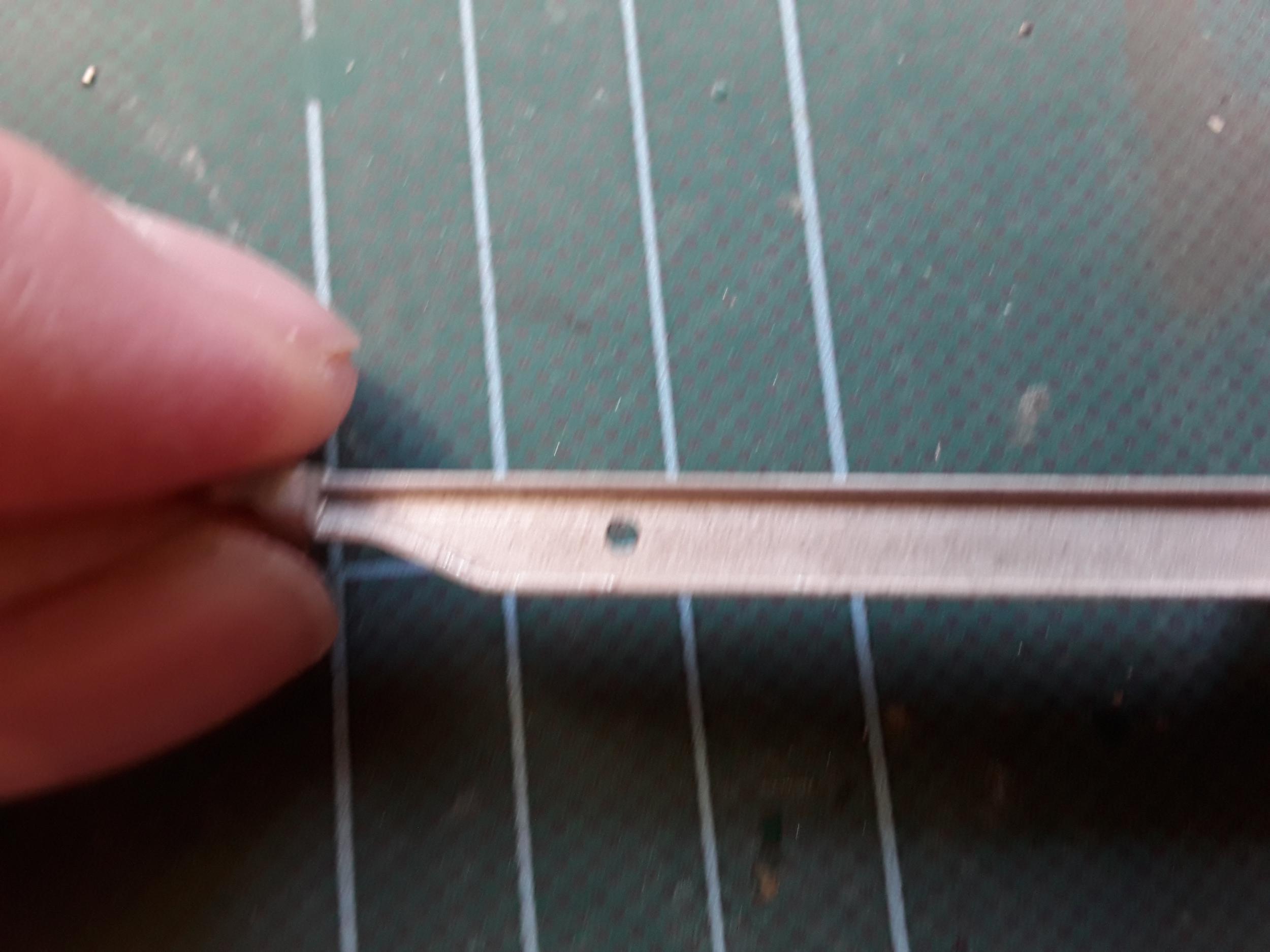

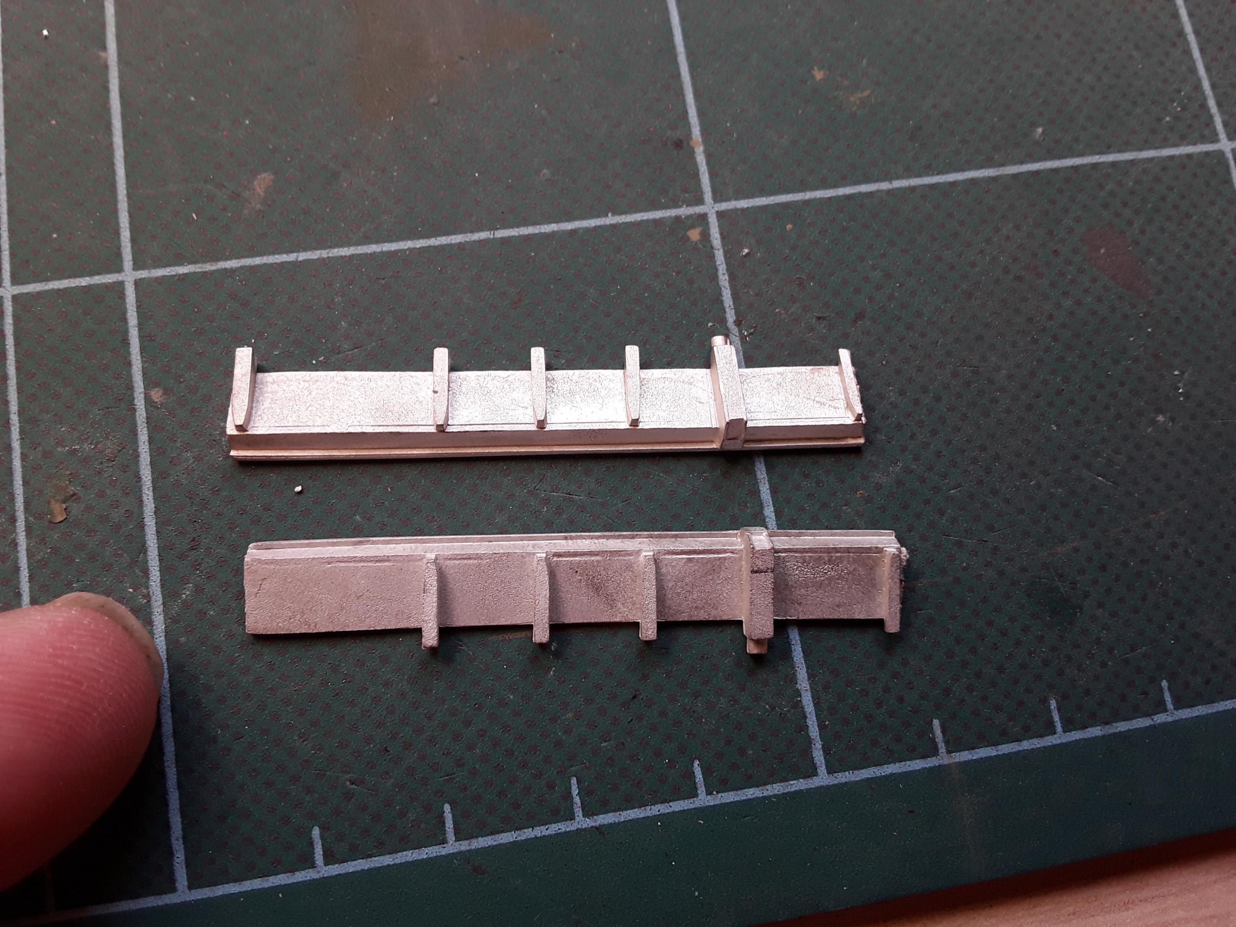

The main spine parts are one piece castings to which you super glue the wheel troughs and brake cylinder details. The troughs are in two types -two sets for the end cars and 3 sets for the others. Easy to identify by a support arm missing ( it's cast on the spine)  I will say out of the whole kit only one spine had the holes drilled out ready -the others are marked ready for drilling ( don't know if the supplier does it and forgot or what ?) But I need either a 1mm or 1.5mm drill bit and sort it .
So I've set about cleaning up the bits and bobs with my tools -knife to scratch (cut the flash / runners- file to smooth and grit stick to polish ready for paint !
The kit requires you to supply bogies/ paint / decals ( transfers) . Micro trains are recommended and the two types required are on the bottom of the assembly sheet ( one for each end with couplings and 4 without coupling for the connection points. The standard microtrains mounting pin hole is cast into the pine units as are the articulation pins and sockets .
The smaller parts -air tanks / trailer mounting ( fifth wheel to us ) walkways -etched stainless ) are mostly clean -the etched walkways  need bending up - But I'll get to that.

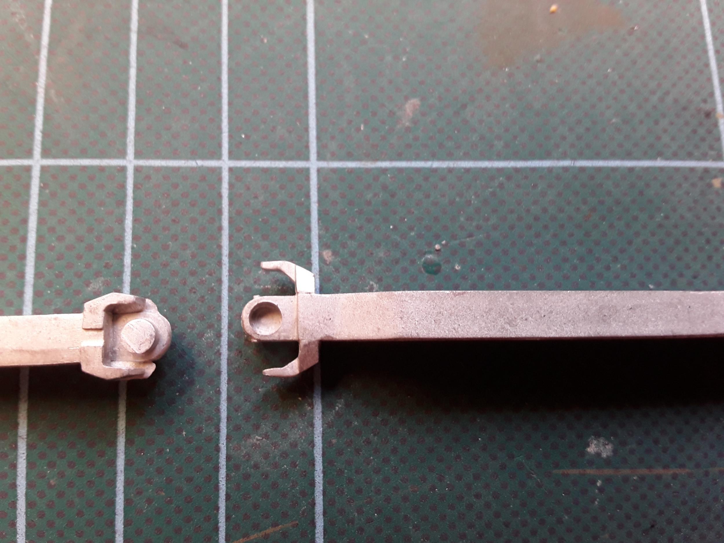

Had a bit of time today -with the weather being so cold -i couldn't play outside for long -so I went to the cave and had a play ! Managed to clean and fit the the end unit  'A' together with all its bits ! Bit of fettling and all went together really well . Superglue and a bit of patience and Presto one spine done -i'll leave it for 24hrs then treat it to a cleaning job and a nice coat of white Halfords acrylic paint . Managed to get two more done before a bit of cramp set in and finished that for today . But up to now I'm impressed both with the quality and the fit of the kit - decals arrived from Osbourne's this week -still waiting for the trucks and couplings -but no panic yet ! Anyway a few pics of  spine 'A' for those interested .....
