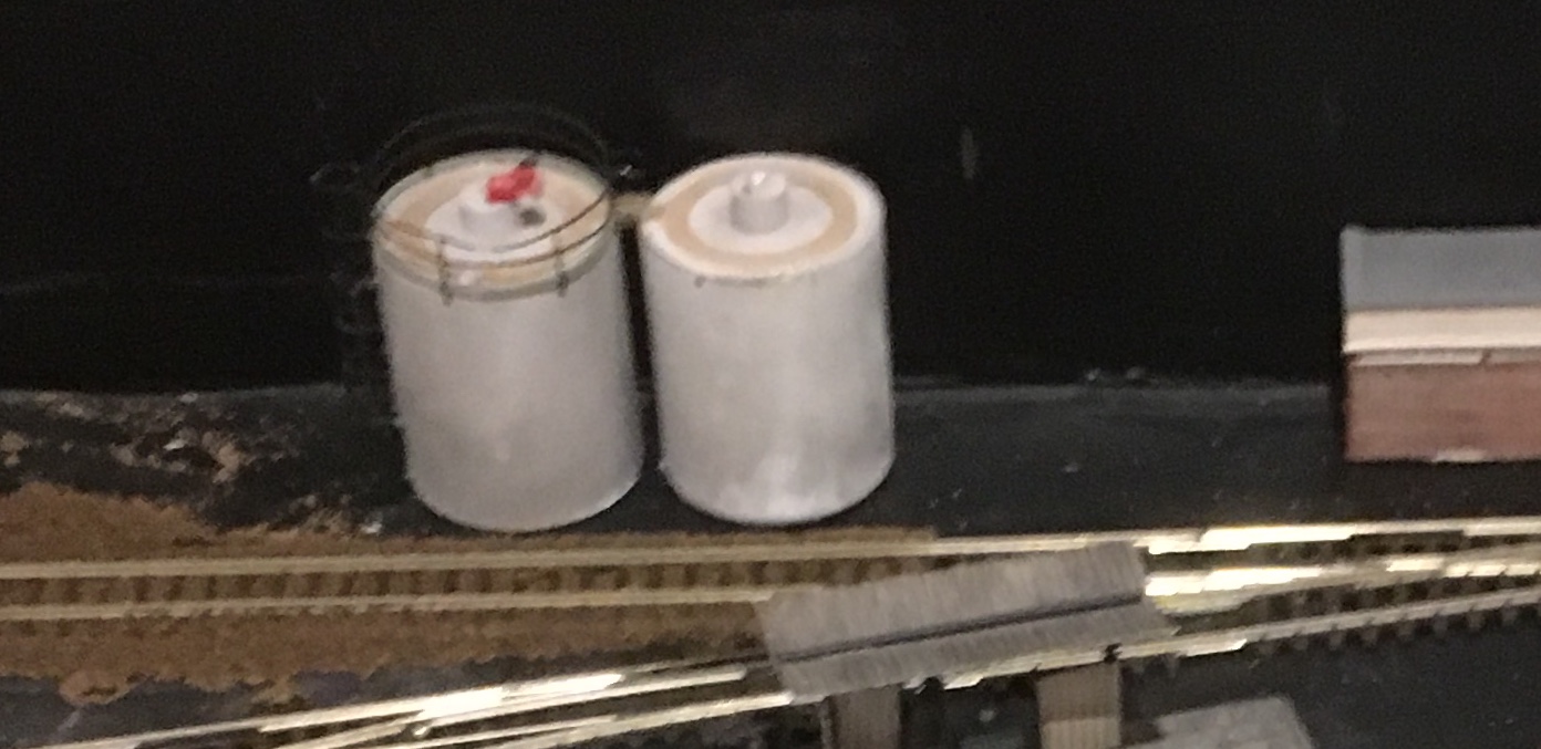

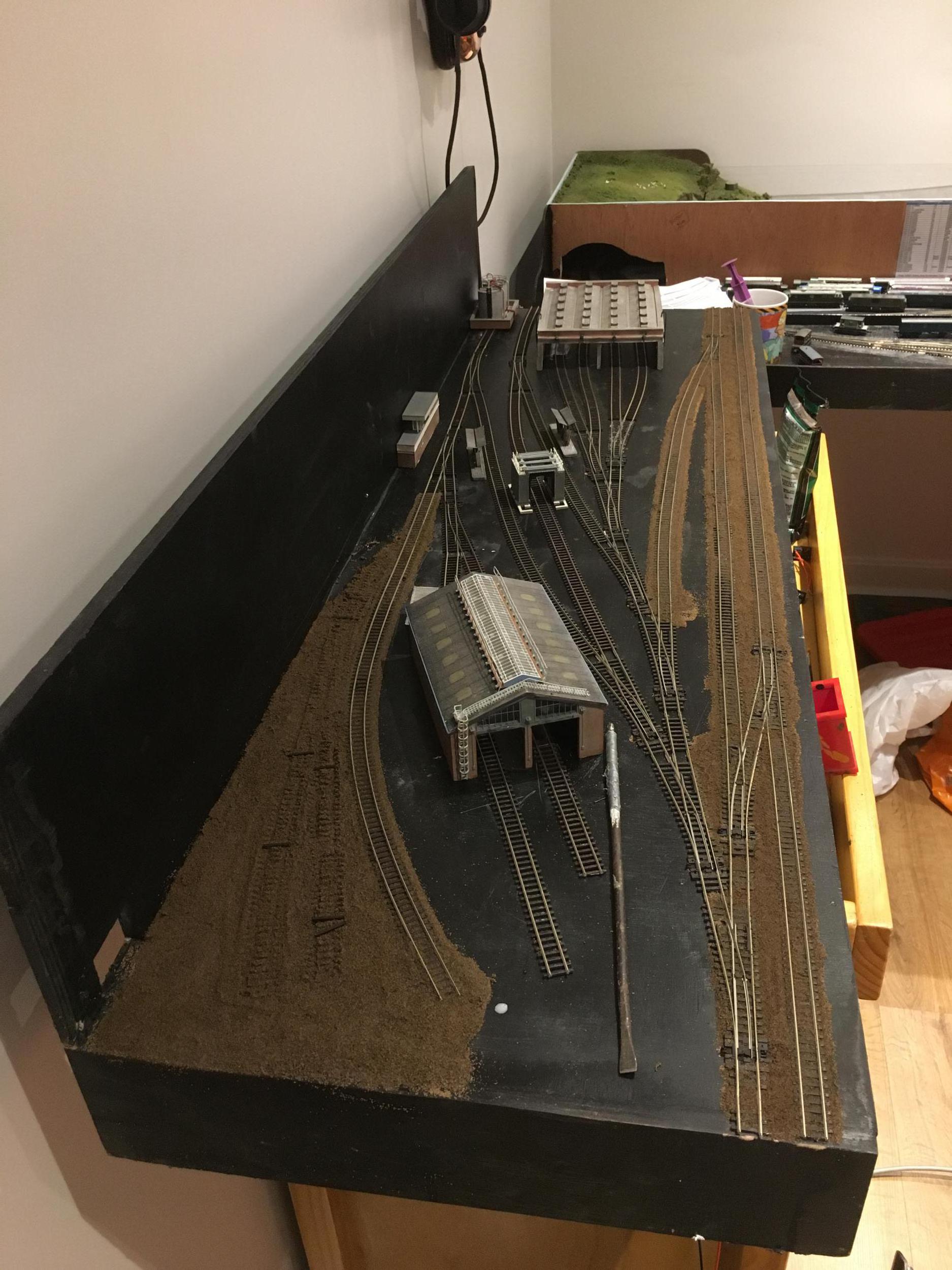

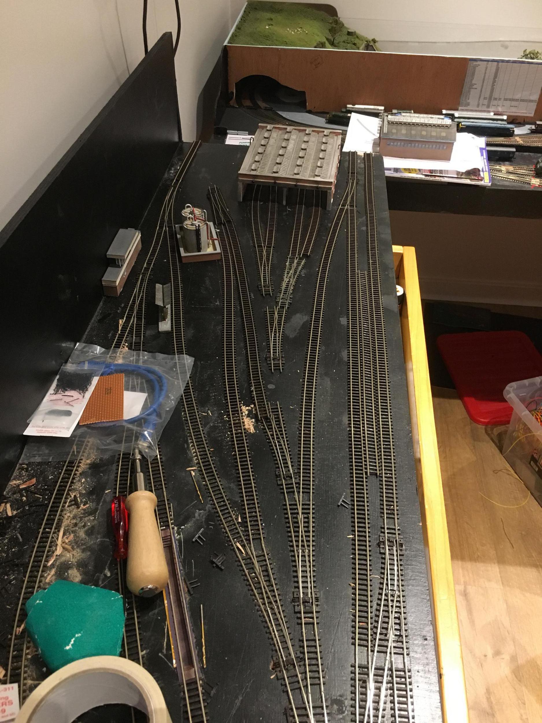

So there has been some progress on this new board, decided that the Depot will be called "Broom Hill" a pun from "Brush Lane", the track is now laid and all wiring has been soldered under the track on this layout.  Point holes all been cut and wires soldered to all the Frogs to ensure good power is supplied across all the track.  Point motors will be seep and the system underneath this time will be Digikeijs from Holland using block sections and of course a DCC control unit (DR5000).. It will eventually be computer controlled and is the first board of five for my train room.
This picture was my first attempt at putting the scenic pieces on the board and nothing quite fitted how I'd imagined!!..., I wanted a run round loop by the fuel filling equipment so changed the design a bit, which meant the fuel tanks no longer fitted on any of the open ground !!...
......cue the saw and a large screwdriver to extract them from their resin base....
Can you have too many Westerns ?? - Also note I've cut down the Farish Scenecraft Fuel tank retaining walls so now they sit nicely between the back-scene and the rear track surrounding the Fuel tanks.
Mick I need to Snaffle your Desert Sand One away :D!....
Ballasting has been started using Woodland Scenics Dark Fine BAllast, I'm not sure if I like it but as I've started thats what it will be finished with!.... There will be lots of brushed on colours, so it may turn a grey colour anyway!...
I have found this to be my new favourite Glue for ballasting, a 50/50 mix with water and a few drops of washing up liquid to make it flow into the ballast well, I use a children's medicine dropper (comes free in a bottle of Calpol!!) to apply the mix to the ballast...
Finally last night I started the hard standings, these are to be made using DAS Clay, as I find it easy to work with and reshape as I go
http://www.ngaugeforum.co.uk/SMFN/index.php?action=gallery;sa=view;id=56485
And a picture with the first Farish two road Depot Attached

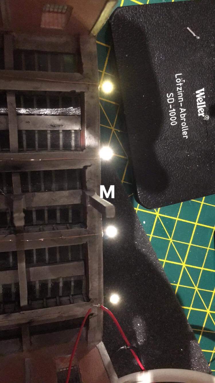

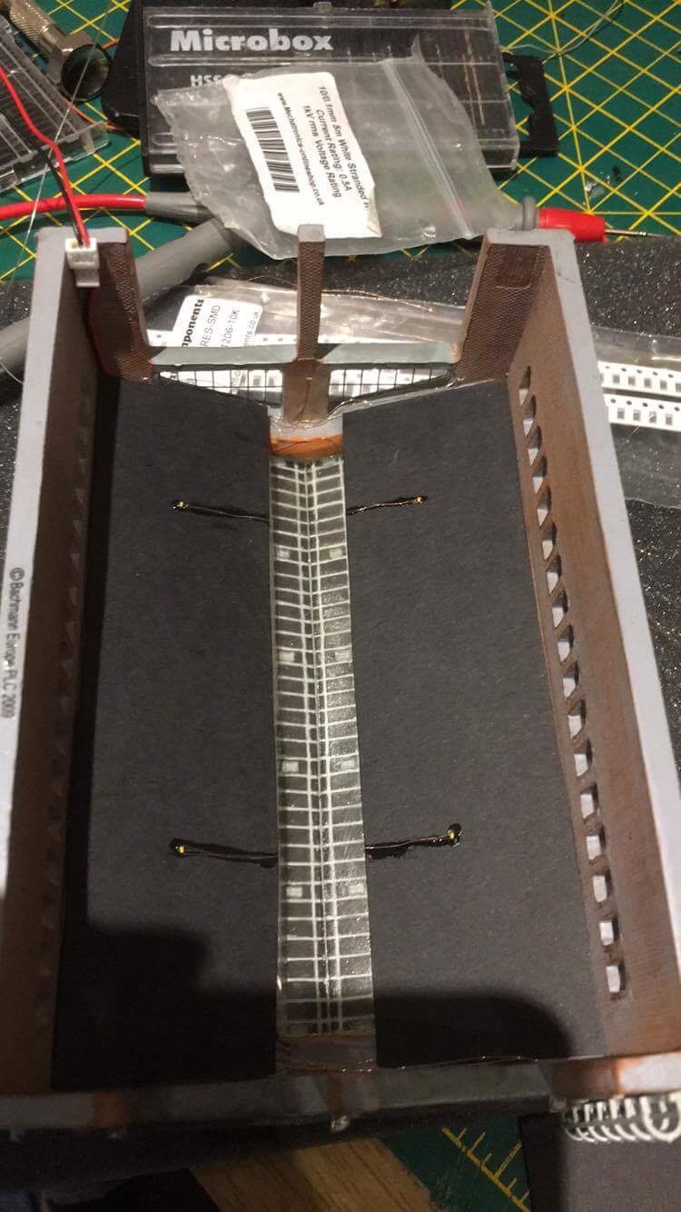

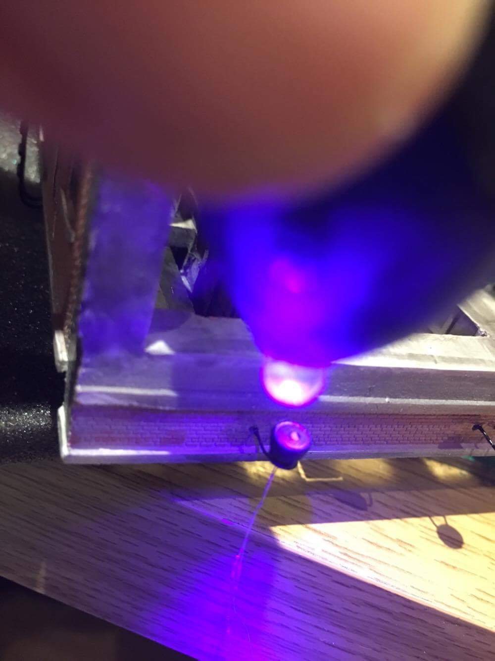

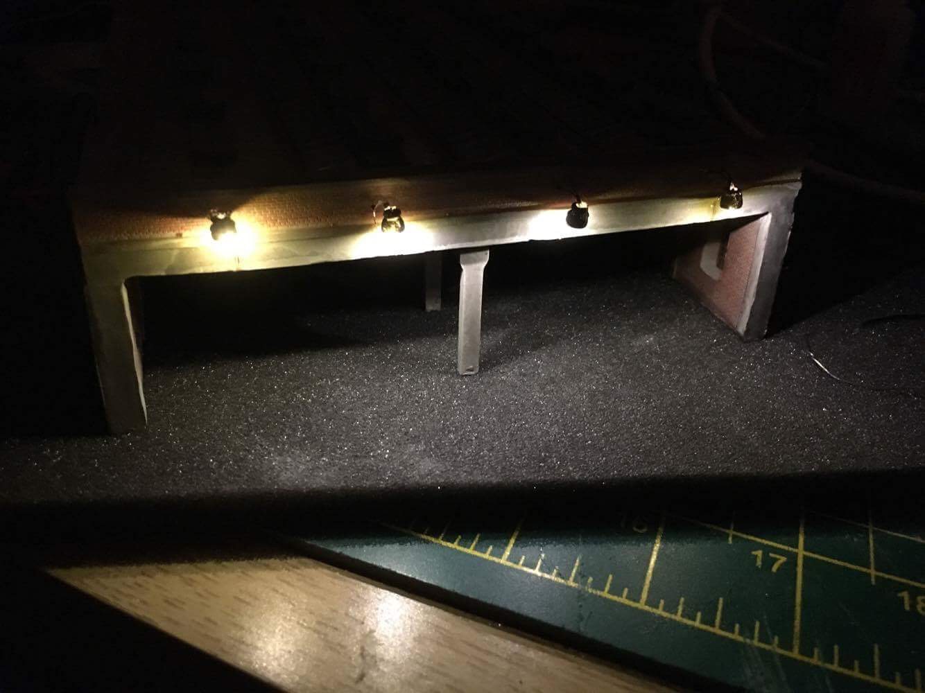

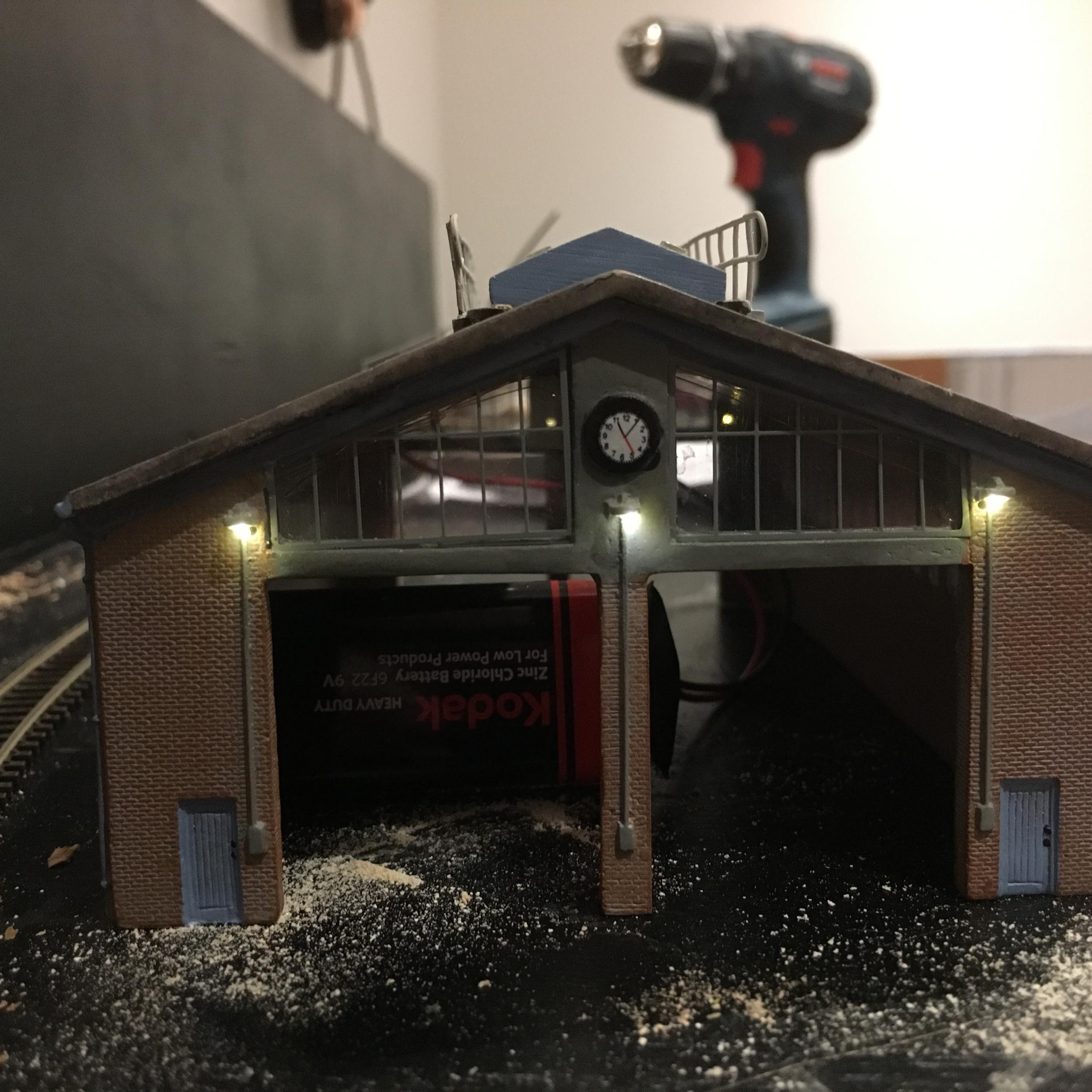

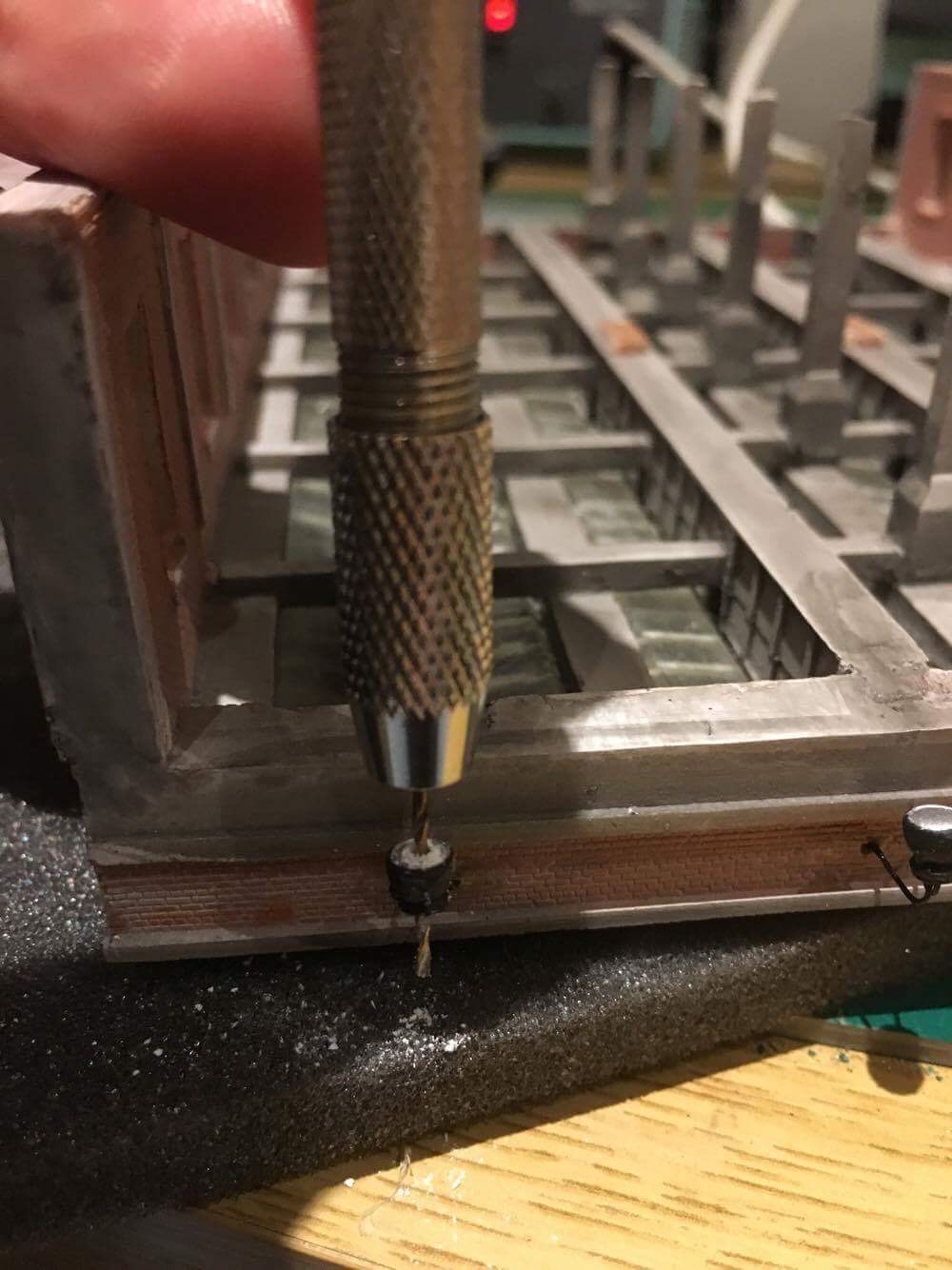

Lets now move on to lighting.... Gotta have lighting in my depot... I've found this stuff on Ebay, called "FIVE SECOND FIX" its a UV curing epoxy and sticks leds in places where before lots of swearing was required!... So heres how I lit the four road servicing shed..
Pin drill small holes through each of the pre fixed "fake" lights
Push through a pre wired 0604 smd (ebay 9.99 for 20), apply some of the goop and UV it for 5 seconds sticking it solid
Light Number one... quite fiddly but well worth it..
Ok so thats all four in....
I think this will look great when its put on the layout!...

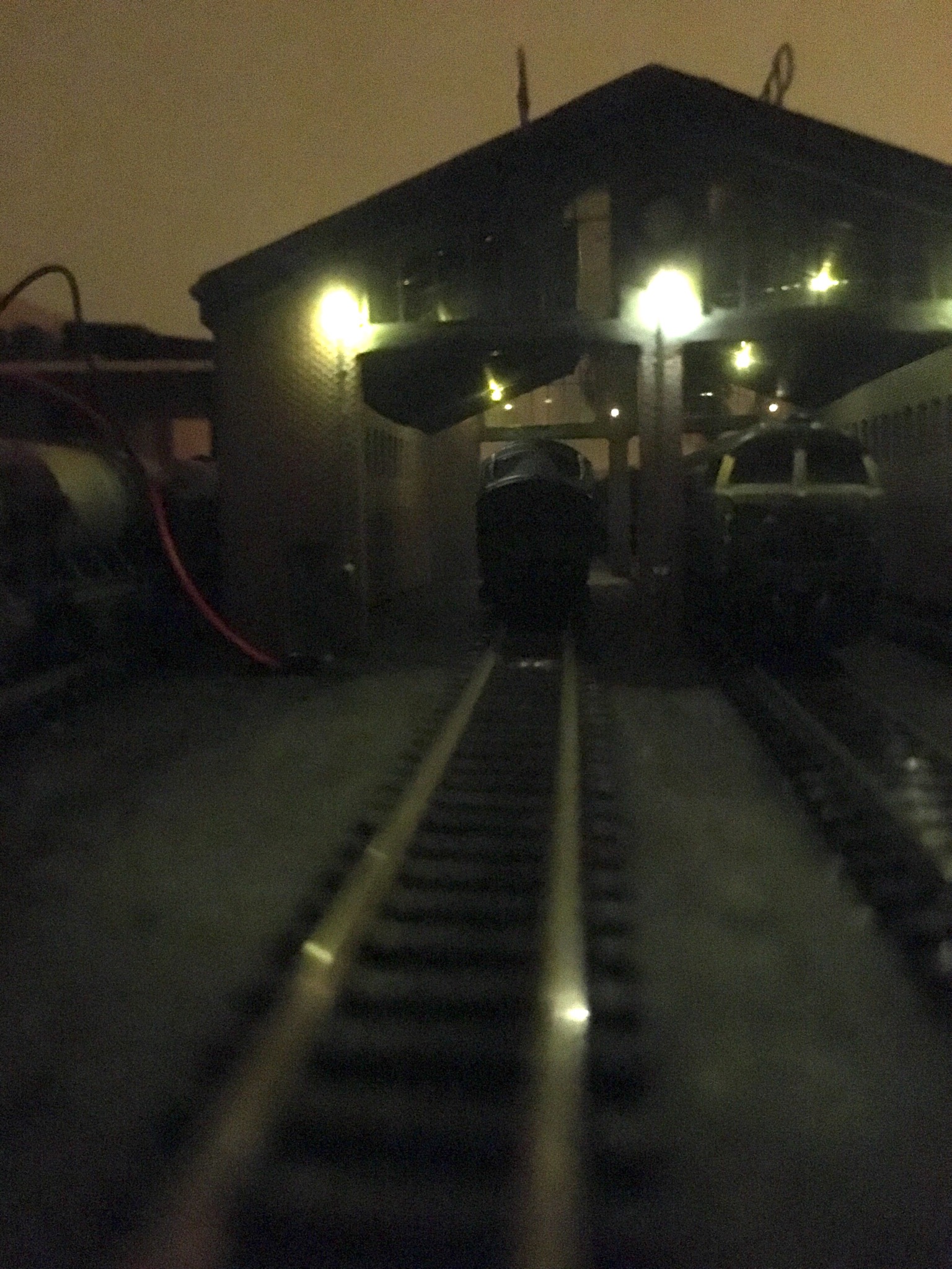

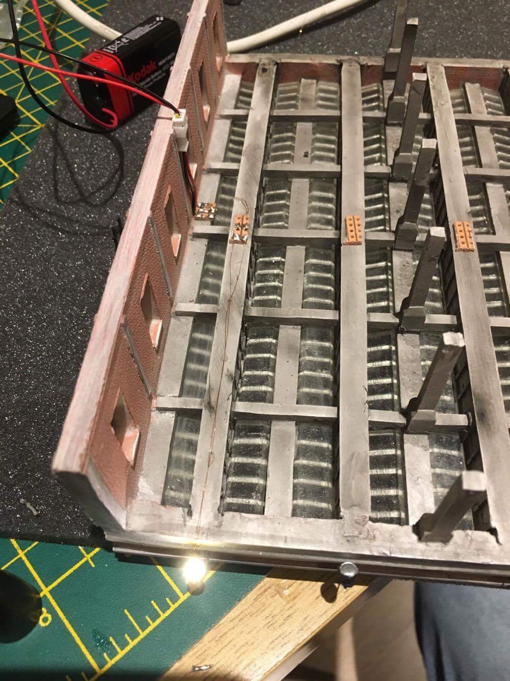

The two road servicing shed has had much the same treatment
Cue Poor picture with locos in situe!!..
Both the sheds have also had lights installed inside for completeness.. The sheds have removable connectors for easy maintenance and removal from the base board

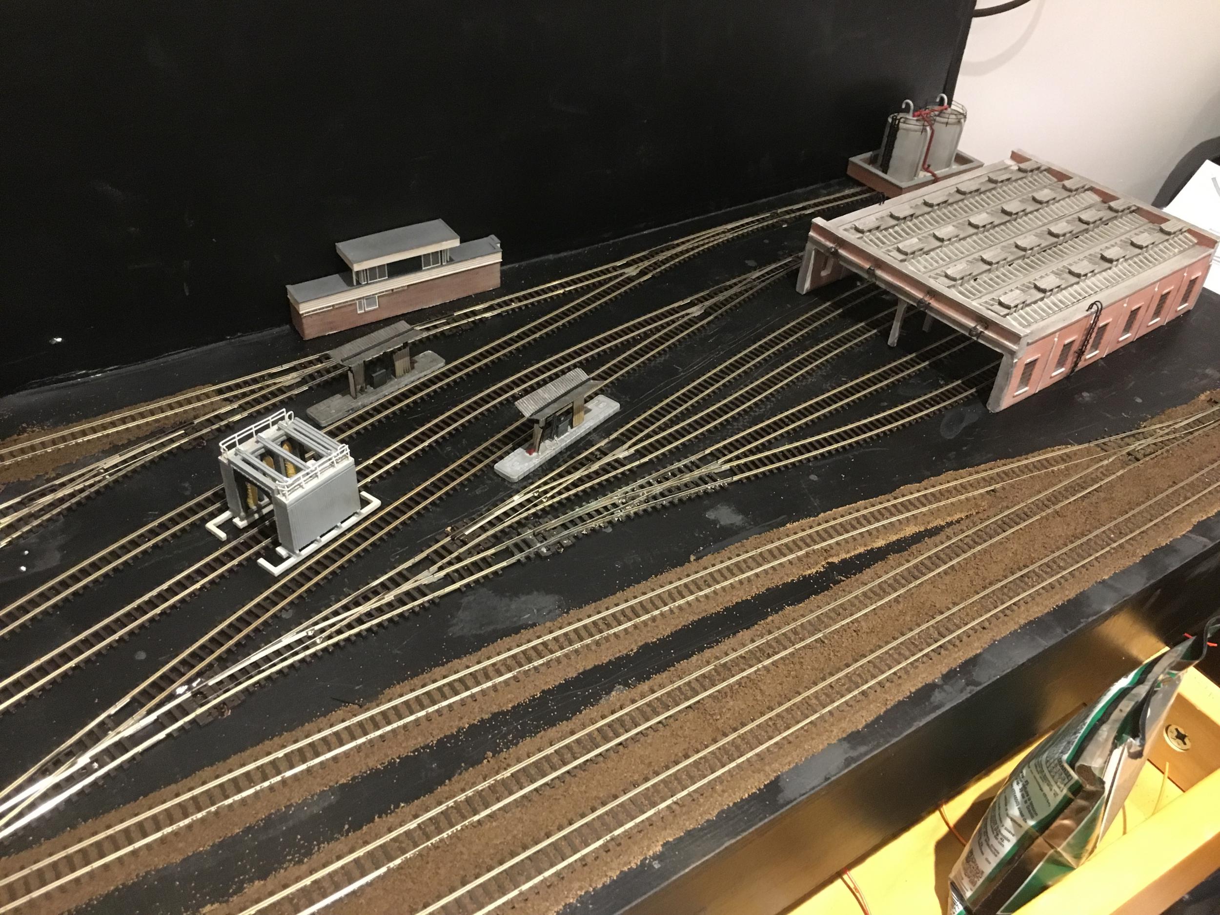

Not much to report today, ballasting ongoing PW using a borrowed 04 and some seacows to move ballast from further up the line, layed the paths between the depots, the four road depots hard standing and levelled the area where the fuel tanks sit.  Testing paint colours on the hard standings

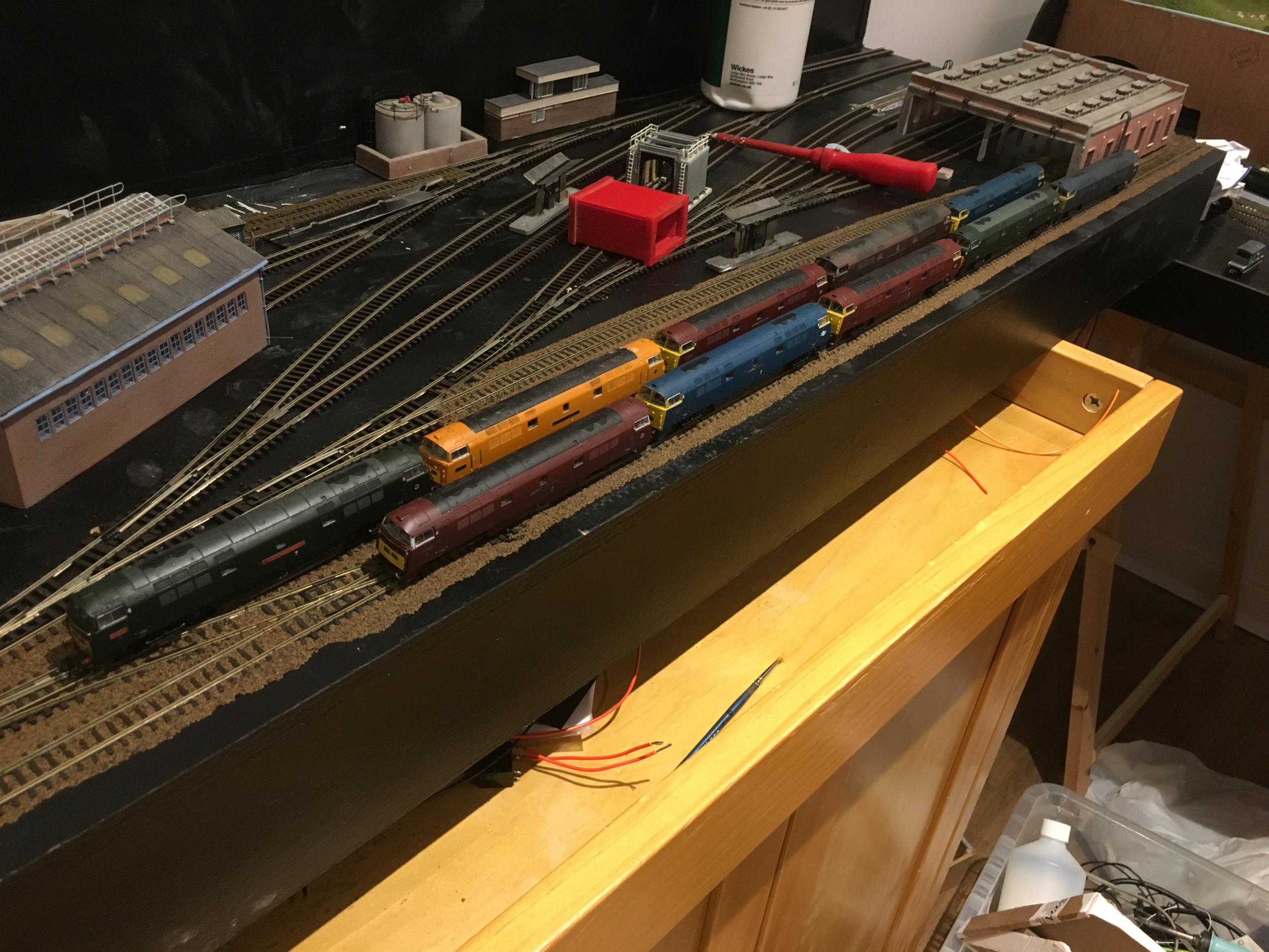

A little more work over the last couple of nights, sees colour come to life and tidying of the ballast, Im after ideas of how to blend the ballast as I think it's too brown now!!

Yeah, I can see the worry....
But looking at the backscene, you may need LED thunder and lightning effects
