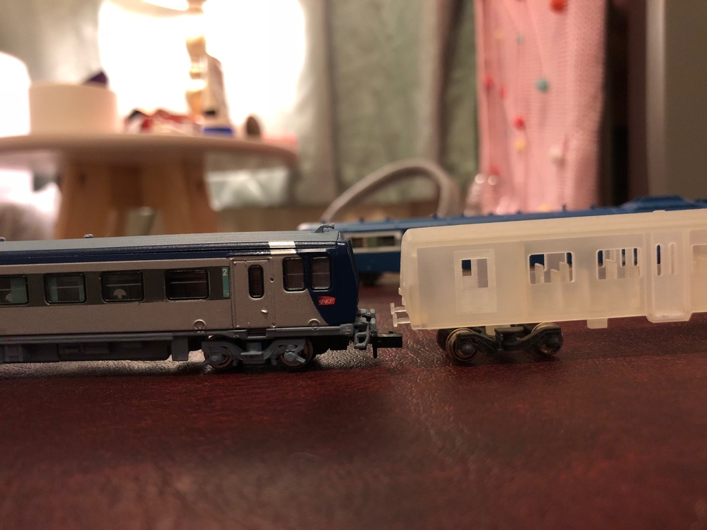

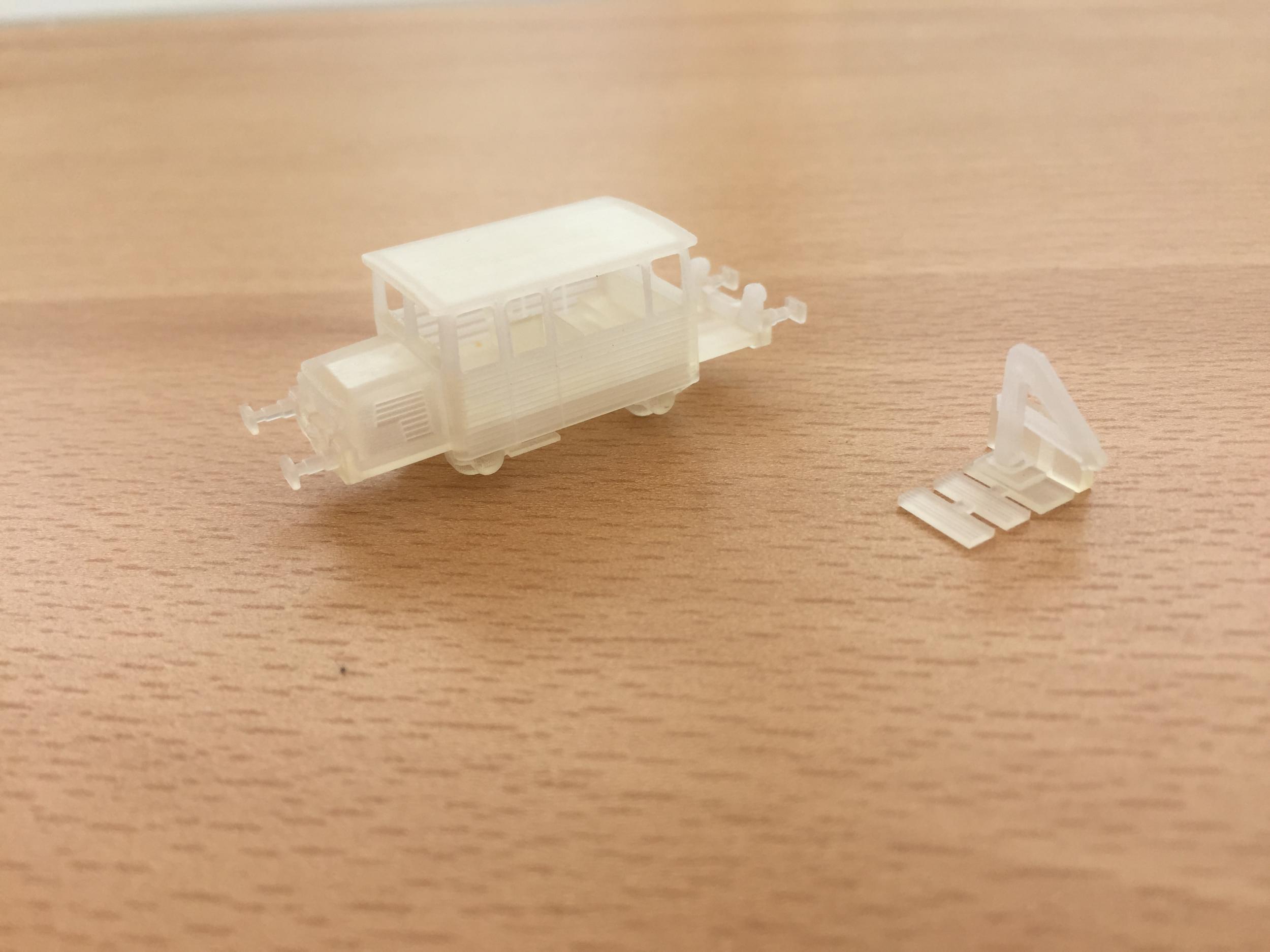

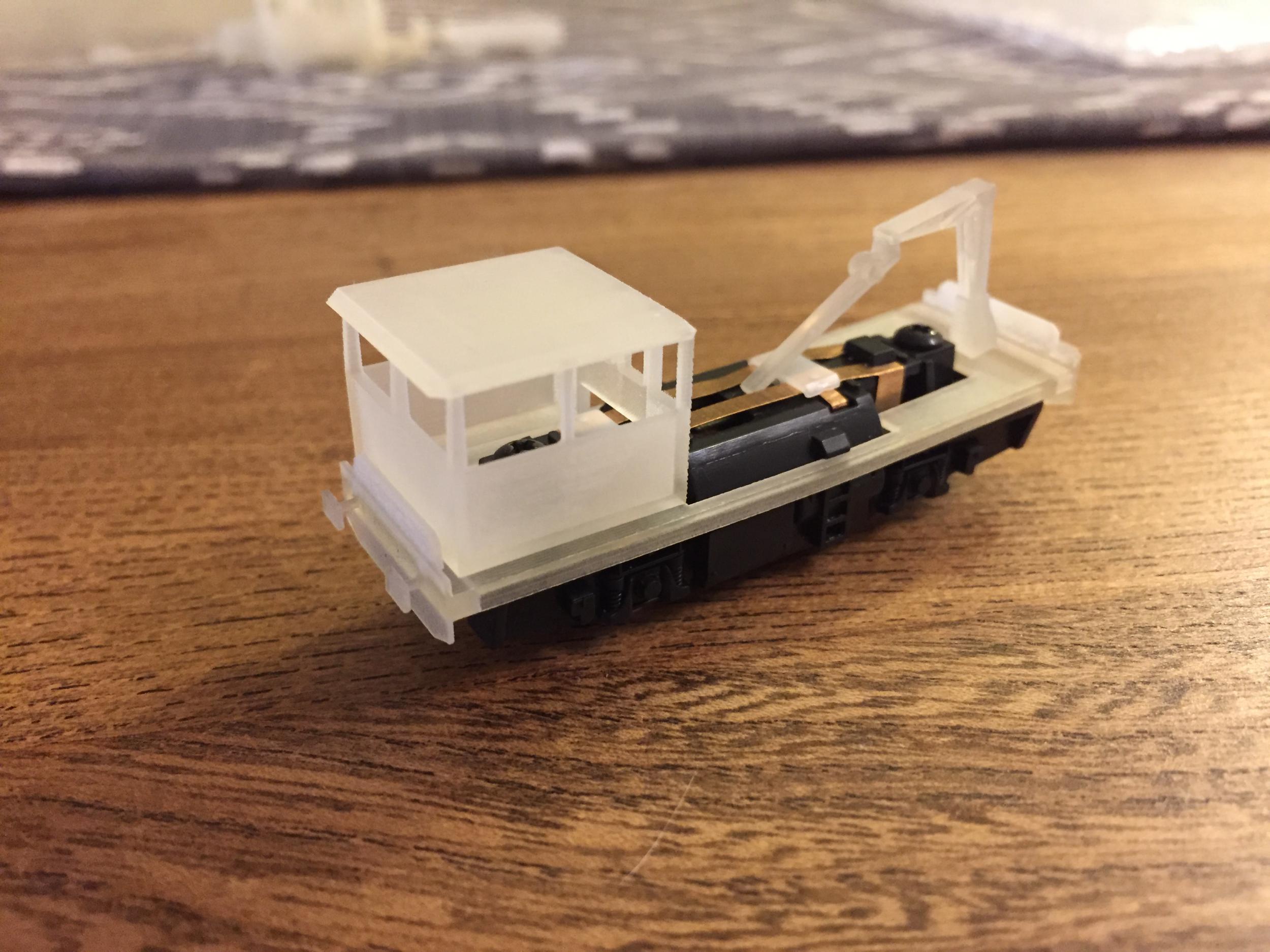

I have recently been doing a lot more in the world of 3D printing with my attention focussed on a few pieces of SNCF rolling stock. So far I have made representations of the DU65 (a new version without the windows that blighted the older version), the XR6000 trailer and the DU84.

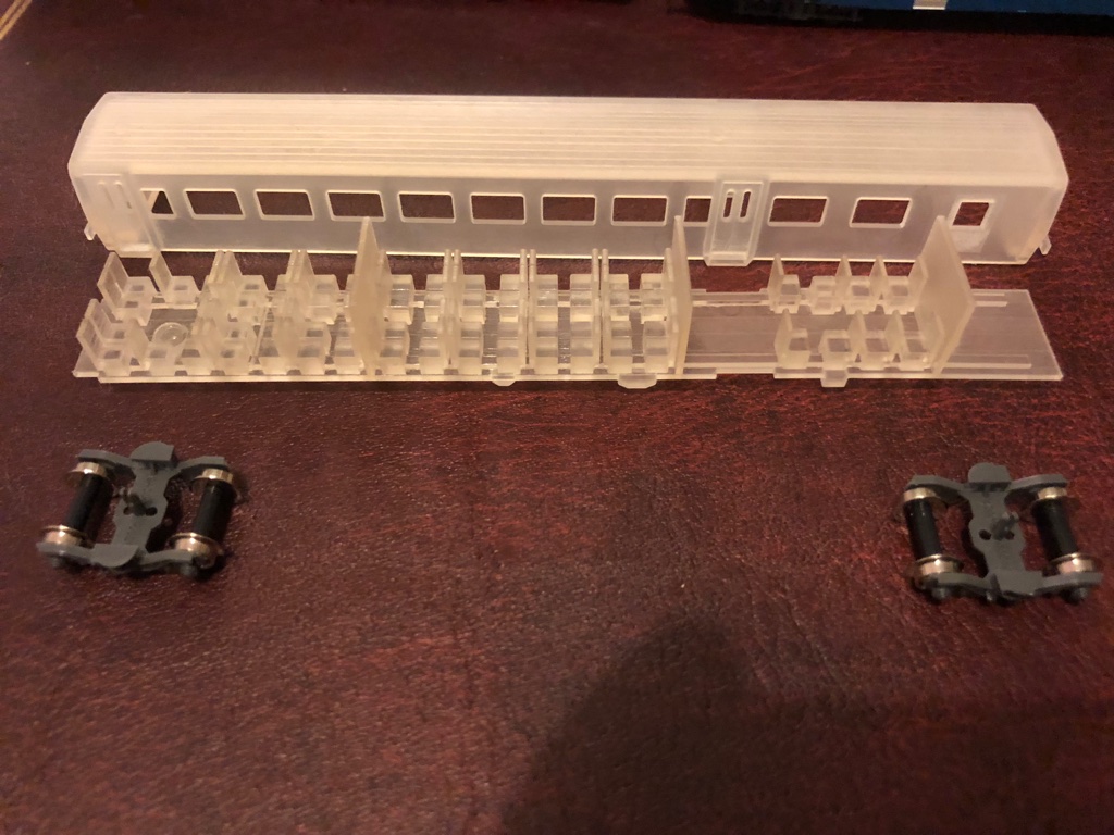

The XR6000 was a big challenge and took some time but I am happy with the result. I am just finishing off a chassis that will allow it to use Piko Corail bogies.
The DU65 features the windows popped through and a chassis is now available for static modelling of the vehicle. The chassis also includes interior details. If anyone knows of small diameter n gauge wheels then I would be most grateful if you can let me know where I can get them.
The DU84 runs on a Kato 4 wheel chassis which is a bit high for the vehicle but it's a compromise as it's a cheap and reliable chassis.

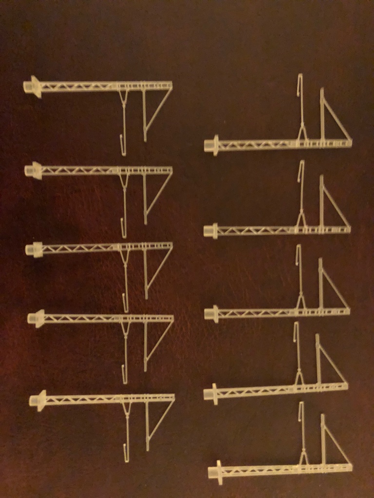

Coming soon is 1500v DC catenary.

They look good to me Stephen. You have captured the pent roof of the trailer car well. As a chassis I would look at the old Lima Corail Vtu75 coach, available cheaply secondhand (third or fourth hand probably) shortened at the outer ends, and with 5mm removed near the middle of the underframe. This would give you a nice array of under-gubbins on the chassis too. The coupler arm extension on the bogie could be dispensed with entirely at one end and an NEM pocket fixed to a shortened extension at the other end would give a range of coupler options.
The chassis is 165mm over buffers, and the true bogie centres are 114.4mm, although Lima use a false centre to improve cornering ability.

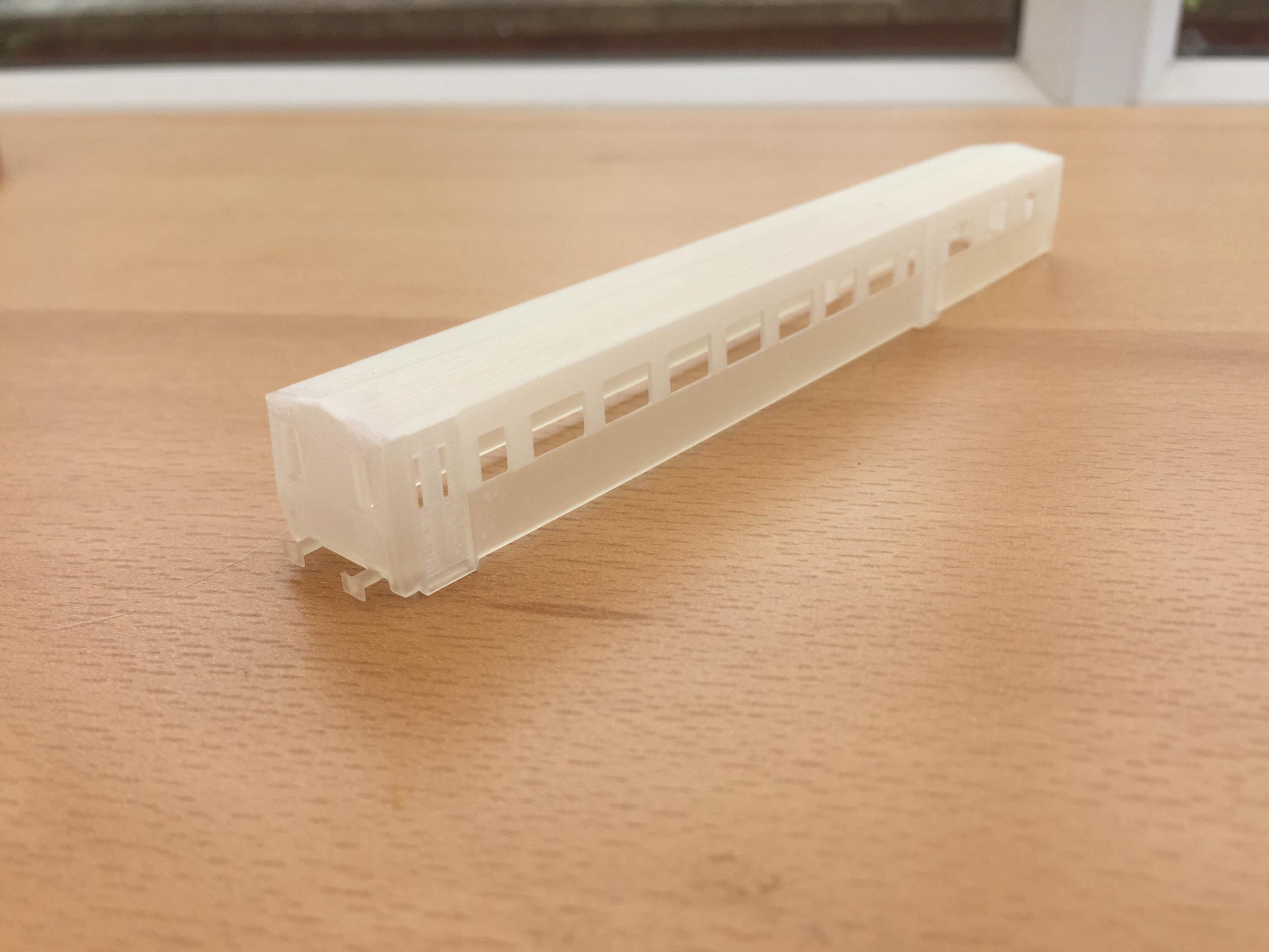

I have been working hard on amending some of the issues with the original XR6000 trailer. The original version of the model was 4mm too long and 1mm too tall. This all meant that it was just out of proportion when next to stock that it should run next to. Further to that the walls were very thin and as such it was not as robust as I would have liked.
The new model is a completely new design from the ground up. I found this easier to do than to modify the original design. This has allowed me to incorporate thicker walls, correct dimensions, better angles on the edge of the roof etc. I also took the liberty of installing seats on the chassis.
The test print turned out well but the ride height is slightly too high. This was due to the pivot being slightly too long. This has now been corrected.
The new versions of the test print will be arriving shortly so that will be exciting. I have also had a go at 1500v DC catenary.
I am hoping to create a wide variety of mast types.
