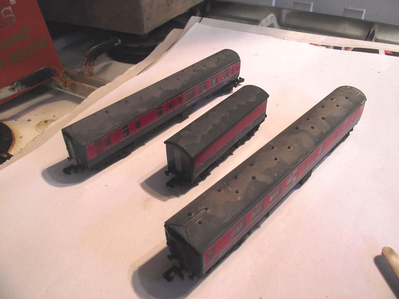

Second try, this time trying out darker colours and working through a batch of coaches! Used a much darker metallic shade for the base colour. Once that had dried, applied a bit of the rust spray, and left that to dry.
The result was rather bolder than before -- the original coach is at the back, the two in front are using the darker colours. Not sure it's necessarily better, but being able to weather coaches to different degrees will certainly add variety to any train, so I'm calling this a win/win!
The basic method was as described earlier, the main change being that I dry brushed a bit from the Tamiya weathering powder B set (snow, soot and rust). I was a bit worried that two bold colours might look a bit 'comic book' without some attempt at blending, which the powders helped to do. Once dry brushed, some matt varnish was added to keep everything in place. This is of course the Electra Graphics 'Trib Train' set of vinyls, which will probably need some matt varnish and/or weathering on the carriage sides to really look finished.
The salt crystals do result in some interesting effects, very suggestive of paintwork peeling back where rain and time has done its worst!
Together with the weathered bogies, I think these old GraFar Mk1 carriages have really been given a new lease of life!
So there we have it. Quick and easy way to distress old rolling stock: a few minutes to spray each coat of paint, an hour or two drying time between coats (using enamels, anyway) was sufficient, except of course for the final matt varnish that will probably need to be left overnight to get really dry.
If @Zwilnik is right and the Bachmann/Farish version is a print, I'm even more pleased with how easy this job turned out to be!
Cheers, NeMo
