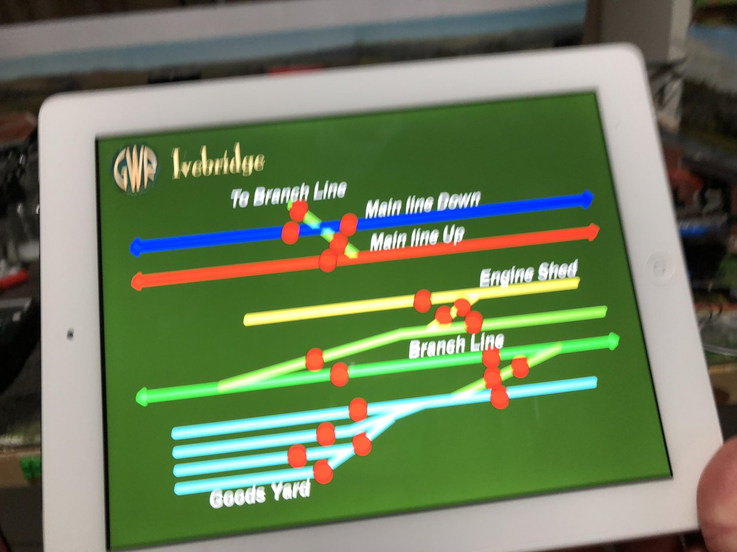

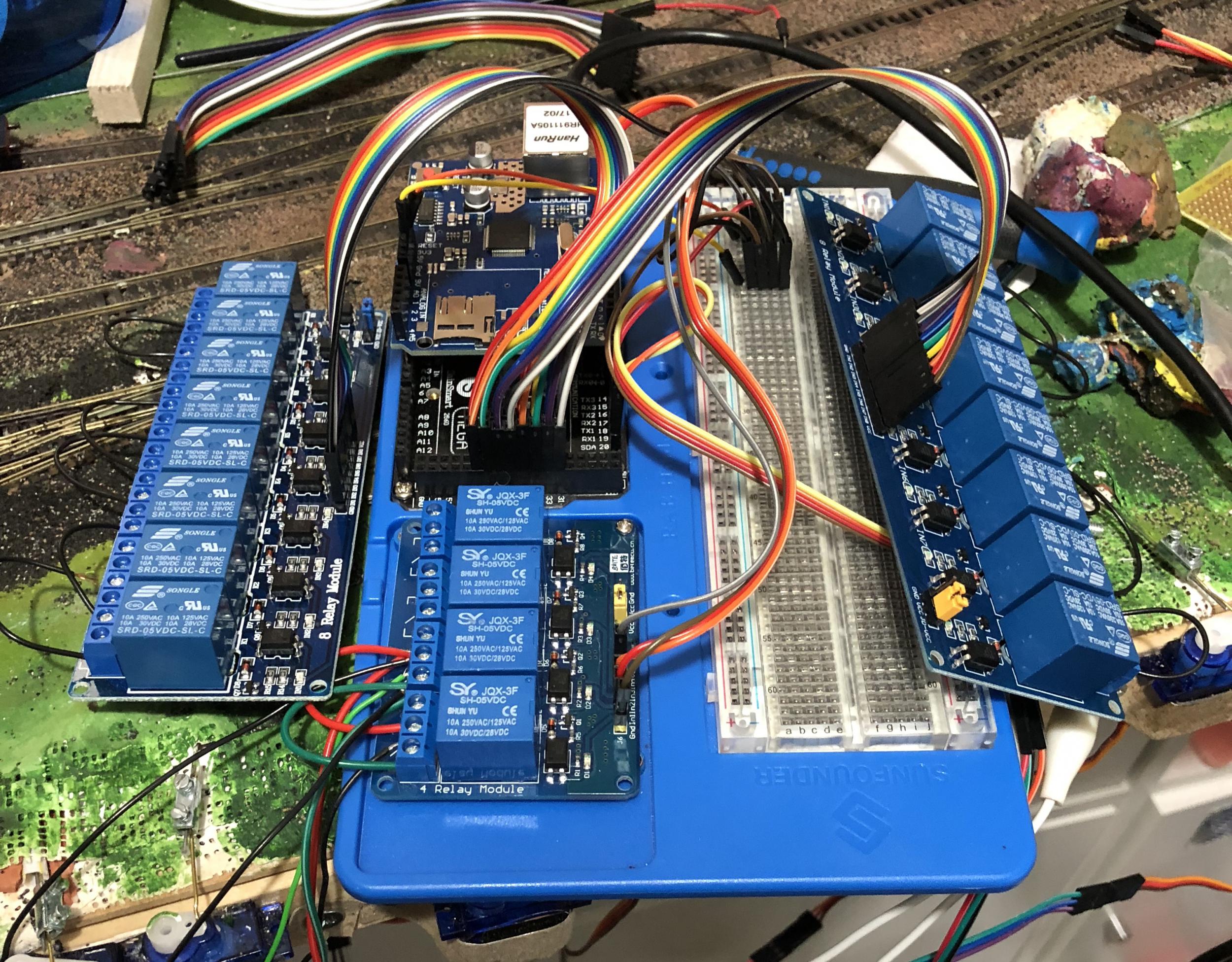

Ok so messing about with electronics over the long weekend so 8 of the 11 points are now servoed up and connected to the arduino via a servo controller board. Iíve also added a couple of banks of power relays that will be used for frog polarity switching on the 3 way point and selecting which line each of the 3 controllers is operating.
Final bit bolted on today was an Ethernet shield. This turns the arduino into a web server so now the whole monstrosity can be controlled by simple html commands. Which means I can slap together a simple Unity app to control the whole thing from an iPad.
Both the gubbins and app are early stages but Iíve already got smooth point control happening :)
The Gubbins.

Offline daveg
  • Trade Count: (+5)
  • N Gauge Society Number: 22509
  • Posts: 4773
Re: Ivebridge
« Reply #143 on: May 31, 2018, 07:33:02 am »
 :jawdropping:
Amazing!
I can only manage working with a pair of wires but they can be red and black AND blue and brown!  :dunce:
Really quite impressive stuff.
Dave G

I like the control panel but 'The Gubbins' will cause me nightmares tonight :uneasy:
Offline Zwilnik
  • Trade Count: (+4)
  • N Gauge Society Number: 19730
  • Posts: 1777
Re: Ivebridge
« Reply #146 on: May 31, 2018, 12:17:31 pm »
It looks a lot more scary than it is (and compared to the original it's quite neat ;) ). Once it's actually finished though it'll all be hidden away in a box.
